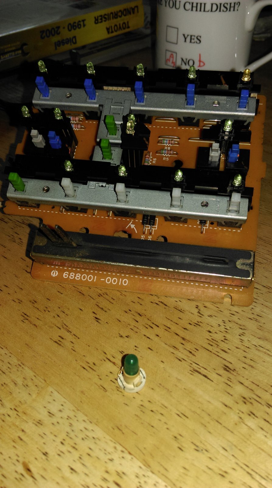

These heater control green condomed backlight bulbs.....can't seem to find any info whether they're tiny push fit, or moulded Toyota jobies...broke one trying to get it out (was buggered anyway)
What bulb, or what Toyota part number if moulded anybody?
Then after hours of looking, immediately finds the answer himself after posting :character-grover:
If this helps anyone in future.. T4.2 bulbs. They're moulded one piece with the twist base.
There's quite a lot of that style get used in the 80. They are the backlighting bulbs I think, the others you show in the climate control unit look like LEDs from the photo which are probably still ok. The one at the base of your picture, the T4.2 will probably have a tiny green hat on it that can be peeled off and fitted to a new clear lamp.
30 milliamp bulbs if i recall with 2 wire strands. Should be able to source from RS. The hat peels off. Unwrap the wire strands then pull the bulb to withdraw them
I have seen the bulb removed and a bright LED soldered in, fancied doing this as my dash is out ATM.

That would be ideal as long as a series resistor is soldered in on each LED. You may also find high brightness ones too bright, though they would be a marked improvement on those fitted to the climate control and likely a straight swap for those.

All LED's are fine. Just the backlights. Maybe the bulb does come out of the holder, but I'd assumed they were one piece as all the bulbs I've looked at come with the holder.
Yep about 1k should do it IIRC?

1k is a nominal figure, it will depend on the LED you choose, there are some variants in voltage.
