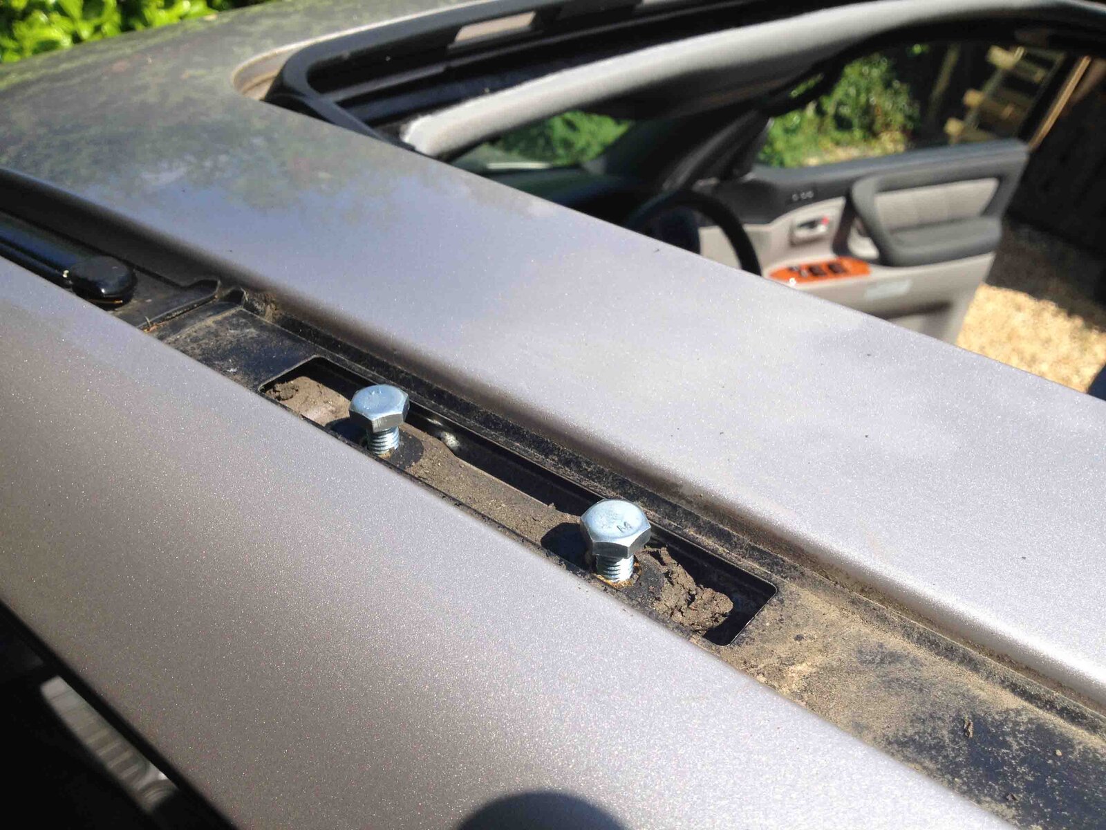

Decided to remove the roof bars after all - put M8x25mm bolts in place to stop the water coming in. Actually M8x12 would be long enough and will get some tomorrow. I'd read that once the front and rear bolt pairs had been removed that the rail would need to be slid fore/aft to free the rail from its mounting. In my case the centre support had a single bolt to the roof and a lever-off cover (similar to the other fixing points) - good job I didn't hit it with the soft faced mallet too hard :?
Anyway that is another 4Kg off the GVW of the truck

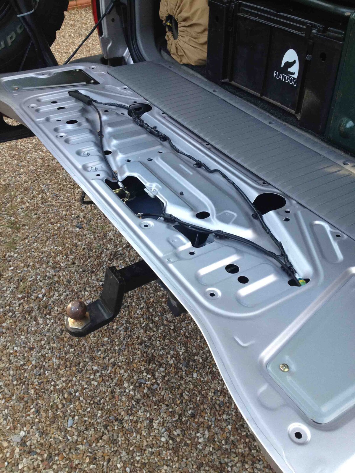

Yesterday ordered a piece of aluminium tread plate (cut to size and formed into an external channel to give it strength) to mount on the ball as a cheap imitation of a "step n tow". Will need some cutting and drilling to make it fit around the ball - the ball will hold it in place.
And also ordered some food grade stainless steel to put on the tailgate. It is cut to size but i'll need to do the profiling of the sheet to the curves of the tailgate to replace the carpet.
Both items arrive tomorrow - 2 days from Alco Engineering

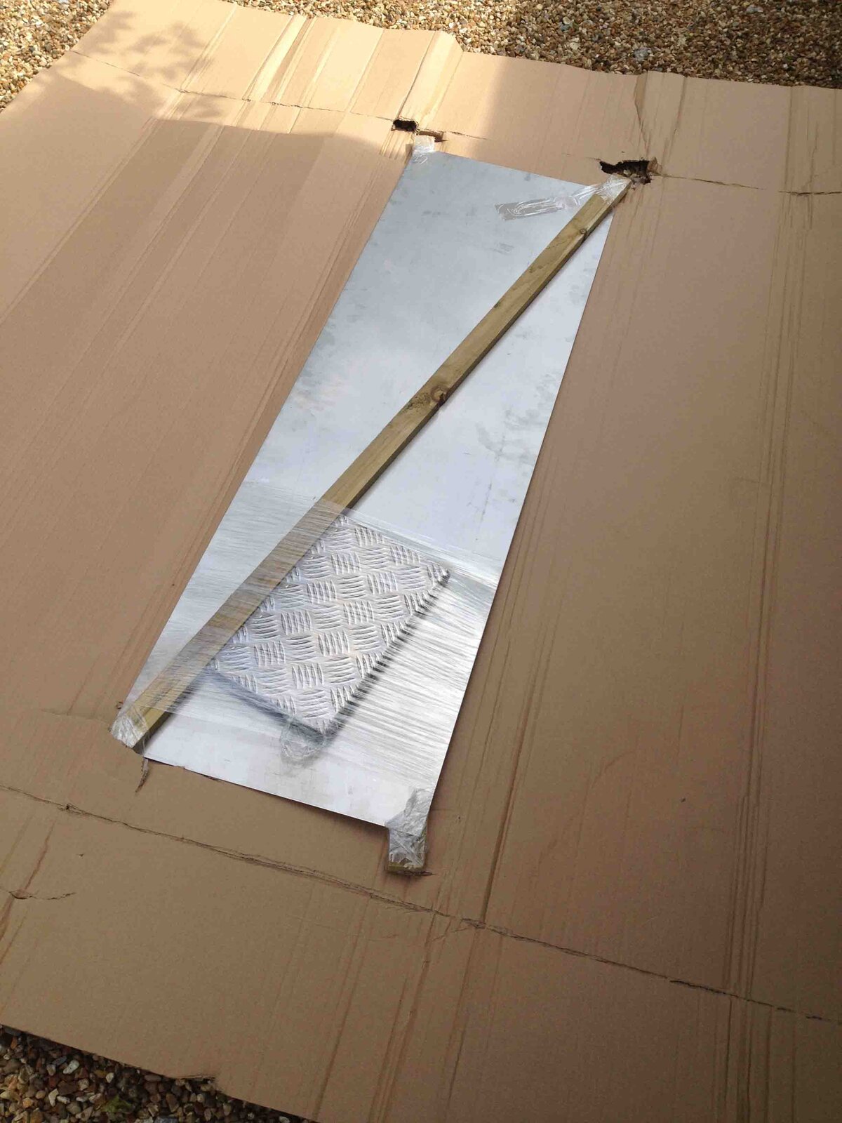

Stainless Steel sheet and formed aluminium tread-plate arrived today - everything nicely packed and in good condition. Weekend job to profile the pieces. Impressed with the service

Looks good, I would recommend having it powder coated a colour or sprayed a colour as the glare on a hot summers day is going to be unbearable and you only going to have to sit on it once having left it in the sun for 5min to know you will not do that again as it will get bloody hot.
We're going to suck it and see before we make decisions about spraying the surface, if at all - but I can I can see what you're getting at. Ideally I want to keep it raw stainless steel surface
