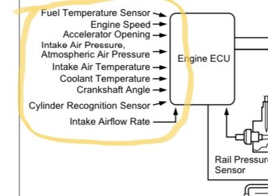

This was a schematic I found that was useful in describing some of the key ECU inputs associated with the fuel delivery system.
I worked my way through this list.
