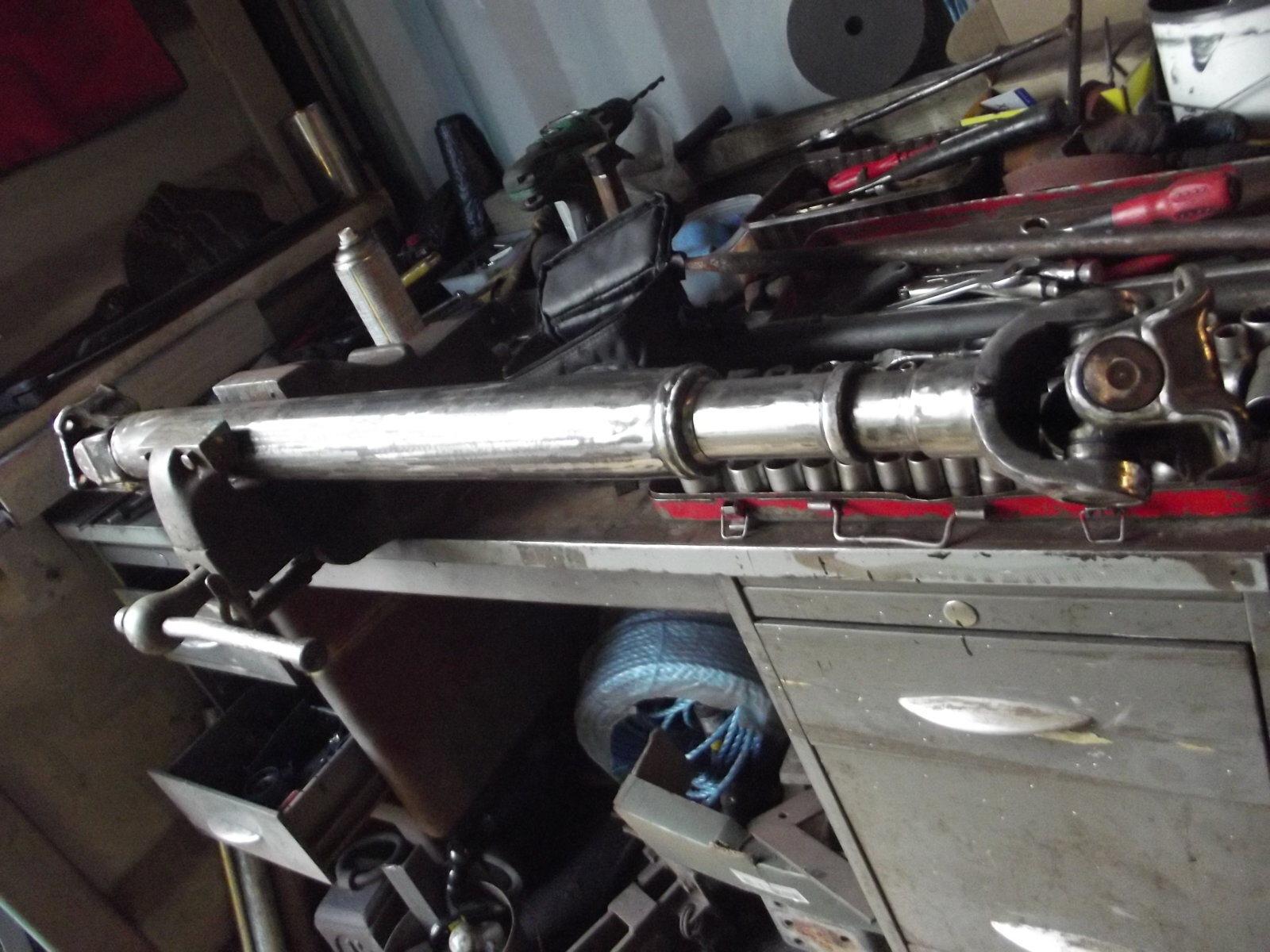

    Just a few more pics.. Got the front bumper off, stripped it down to bare metal, so I can weld up a few cracks and holes. ... Looks like someone has had many attempts at fitting a number plate, Holes everywhere, Like its been shot with a blunderbuss ...Got more stuff painted and stored away..... I must have power washed the truck 10 times but im still finding mud packed in everywhere. every time I take something off.. well at least it will be clean when iv done.... Thanks ps im gonna get myself a brake pipe flaring kit does any one know the thread size of couplings etc im assuming its 4mm pipe... DSCF9573.JPG DSCF9574.JPG DSCF9575.JPG DSCF9576.JPG DSCF9577.JPG DSCF9578.JPG DSCF9573.JPG

    The brake pipes are 5mm OD.
    3/16 is slightly tight on my flaring kit but works fine.
