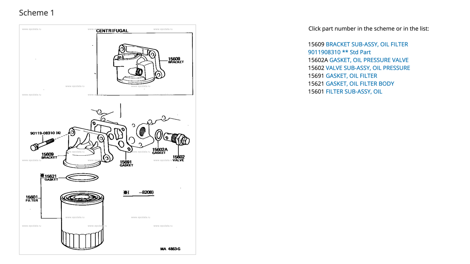

I'm thinking it's the hex bolt on the oil cooler housing, right of the mounting block next to the top right hand bolt holding the filter housing. I want to be sure as I have made the mistake of undoing the wrong bolt on somthing long ago a wrecker toyota repair guy or an early HJ60 (Diesel) owner might know servicing these is uncommon as most find out to late and this is well over due.
If this is it do I take out the small bolt or the large one as the large one might house the valve but I doubt it.
Do you see what I see oil filter leaking this suggest the valve needs attention asap. Unless it's the oil I wiped around the rubber seal.
How abot this pic (below)? another question, is that oil filter a genuine Toyota filter P.N 15601-68010, if not that could be the cause of the slight oil leak.

Yes that is it thank you very much I just purchased a new valve so just need to wait for the postman now it's comming a long way. Comming from New Hampshire. USA where did you find that image of it Jibberjabber? I'm very happy even though it cost a small fortune.

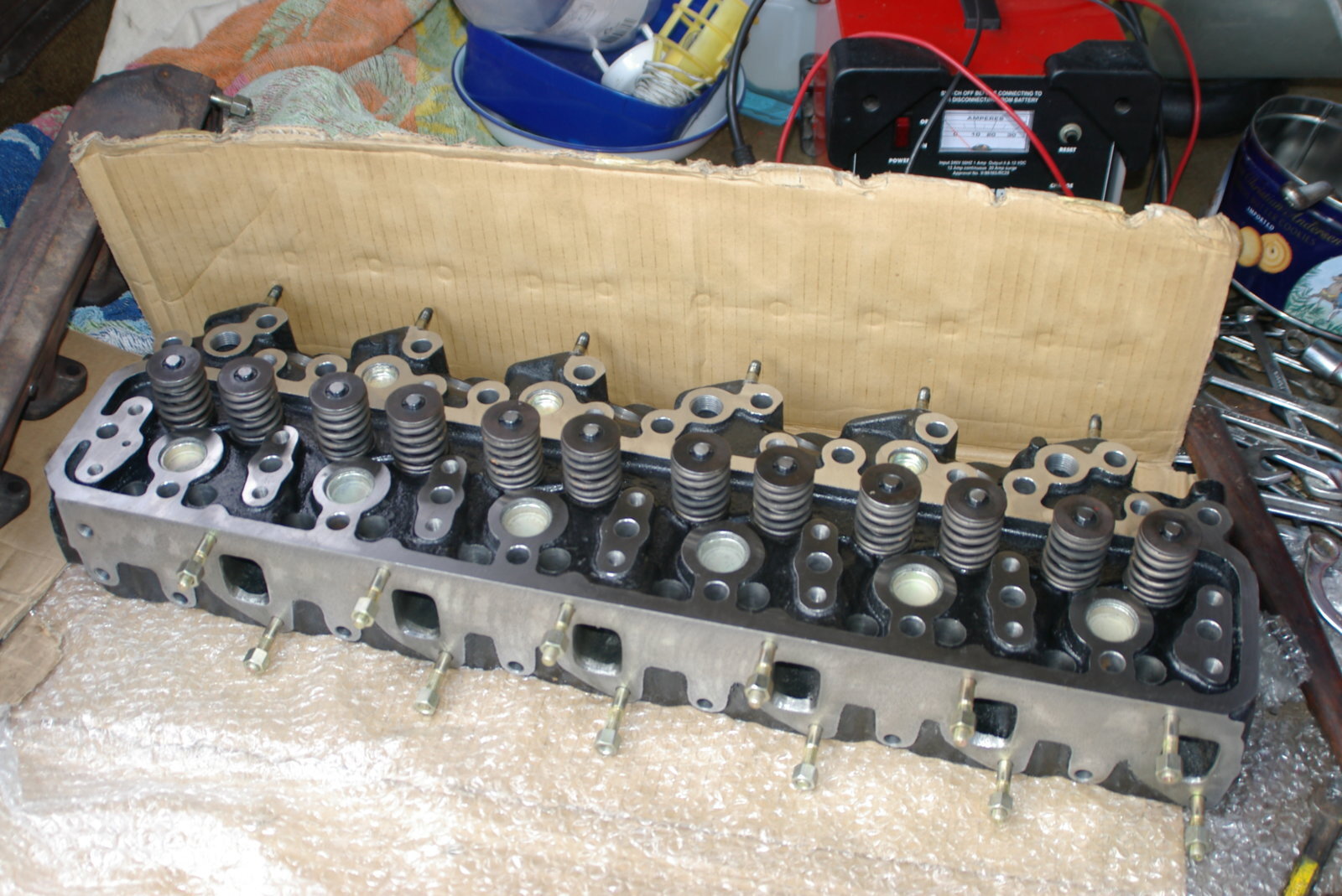

The new Heads they were making them on the Gold Coast QLD Au.

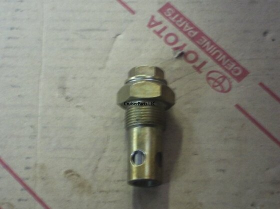

Hello I'm back and I have excellant oil pressure in my Landy now I had the wrong model dash meaning wrong wiring to the oil pressure gauge or the oil pressure gauge didn't work. I also had another issue the oil pressure switch advertised for landcruisers did NOT WORK leaving me to think I had issues mechanicly elsewhere. The new oil pressure relief valve I got works better than the old one as it has more tension on the spring so I have really good pressure now. I will post a photo of the oil pressure switch that did not work at all in my 1982 HJ60.

Below is the new pressure relief valve well worth the expense as I had low pressure before the gauge stopped working. I did not think I was going to get it working as the wiring digram is more complicated than what is in the HJ60 itself, it's different. Possibly because it goes through the engine control unit and mine is different to later models.

Also thank you Jibber Jabber for those drawings as I needed them to find a relief valve.
