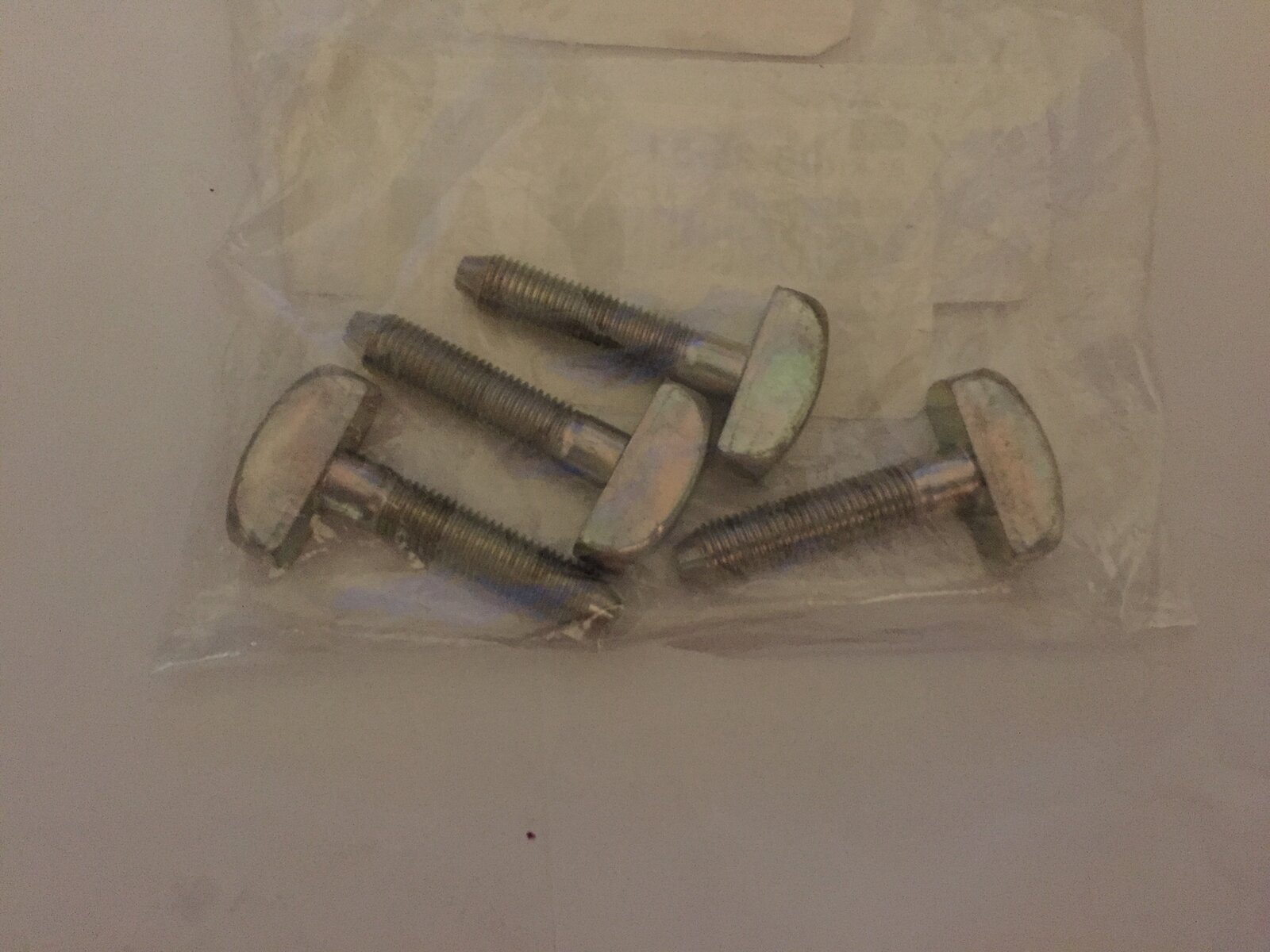

I just spent the day fitting the tub with new T bolts and high tensile corner bolts packing all the other mounts believe me its a big job getting it right.

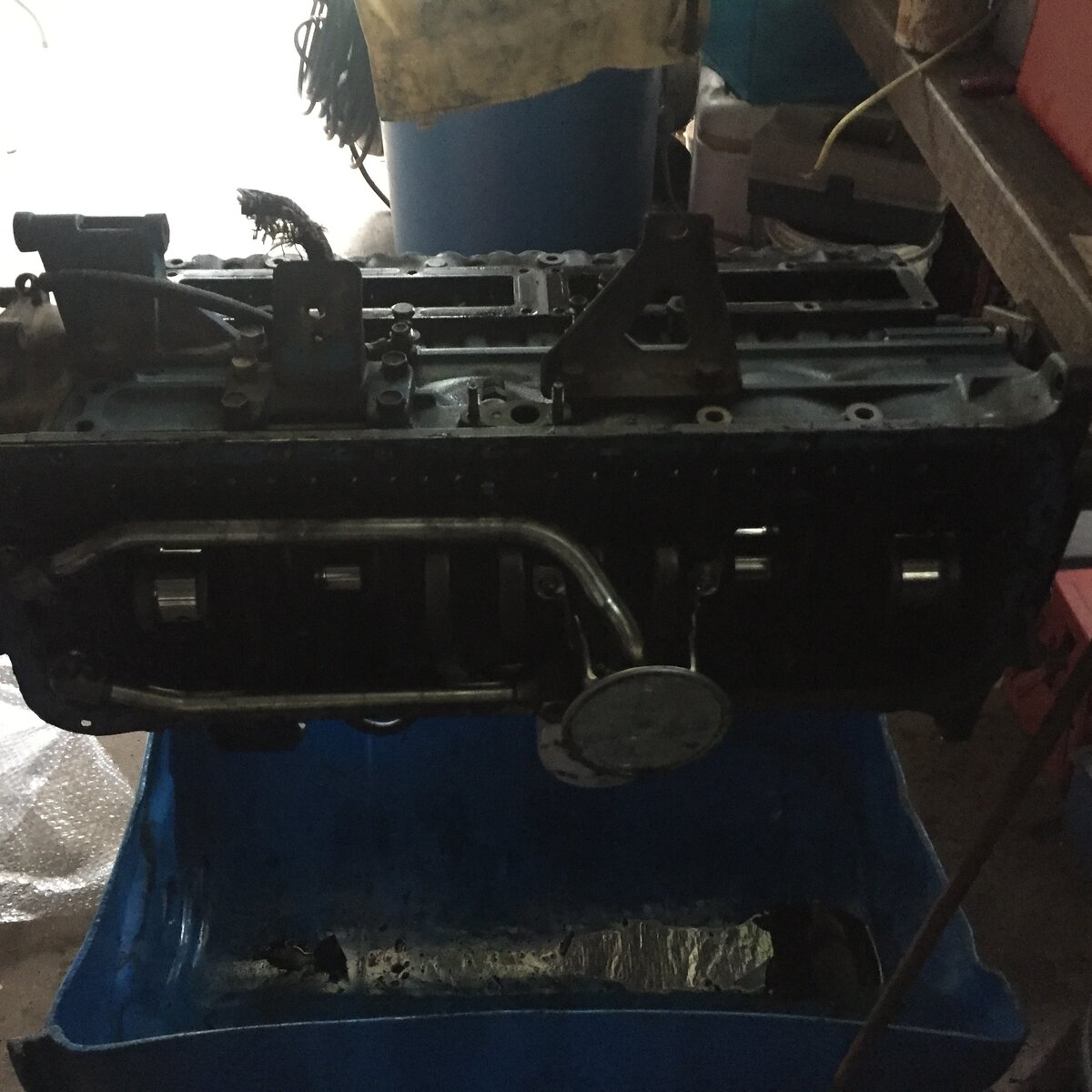

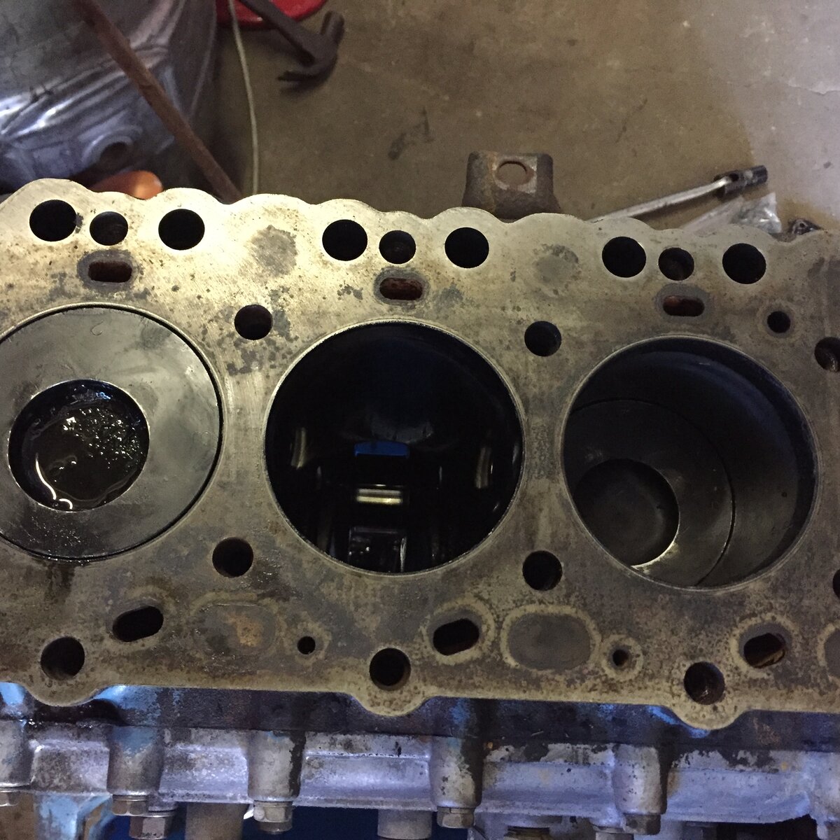

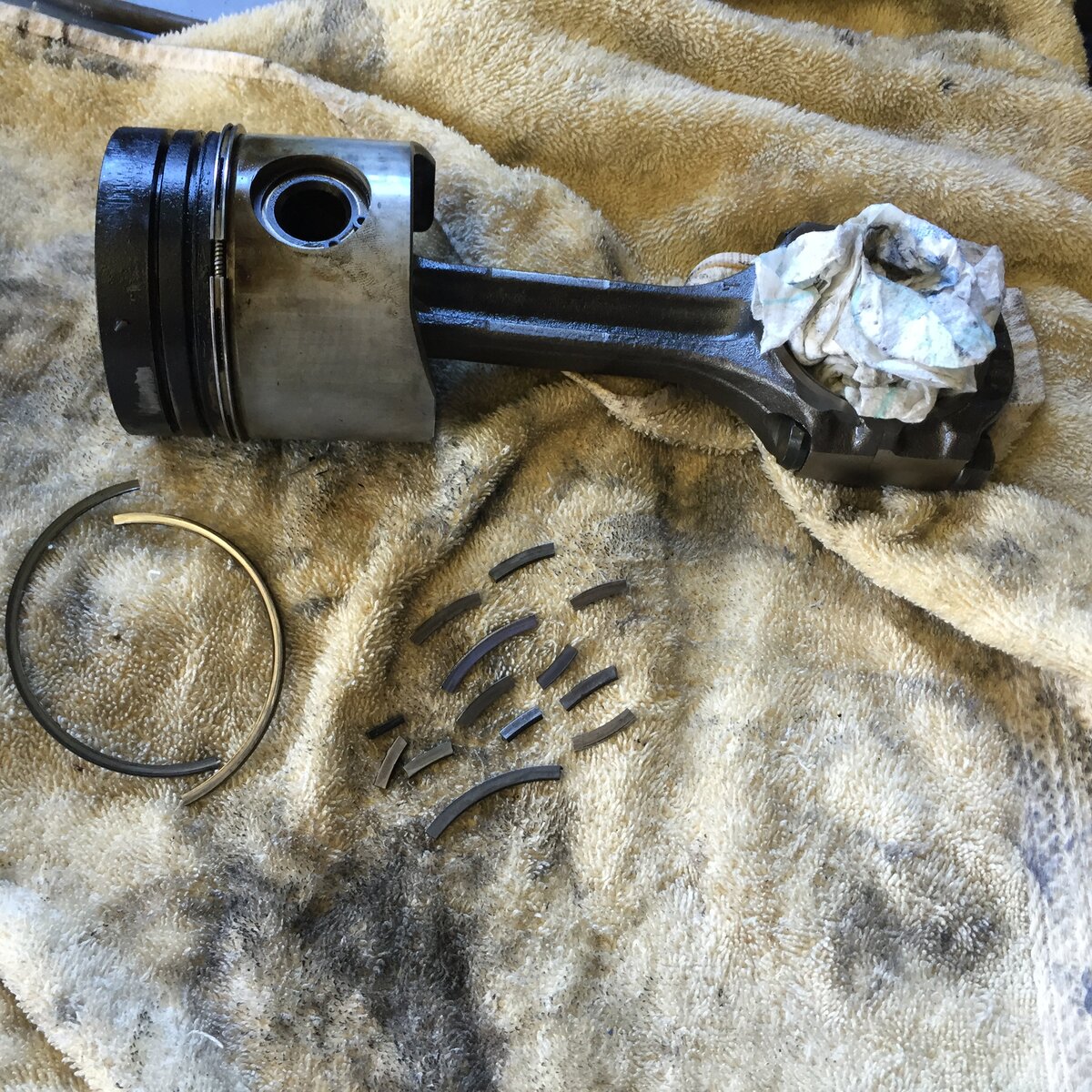

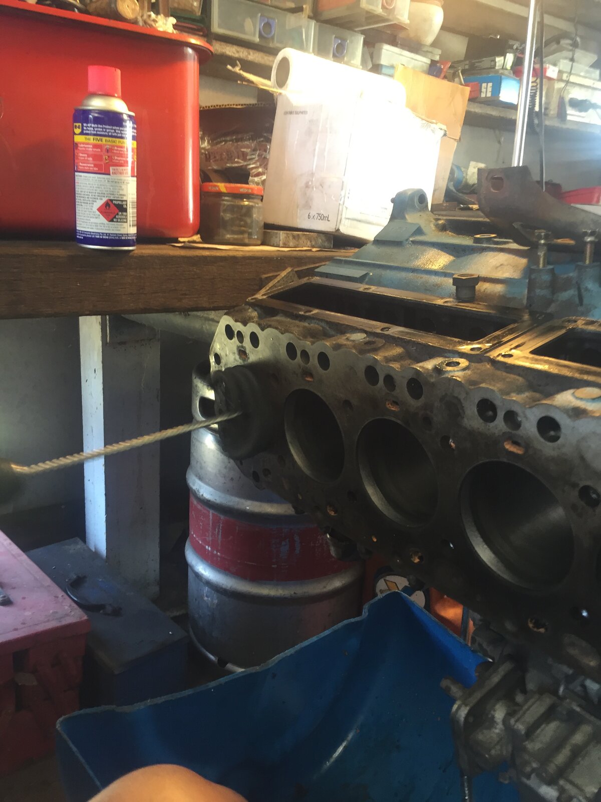

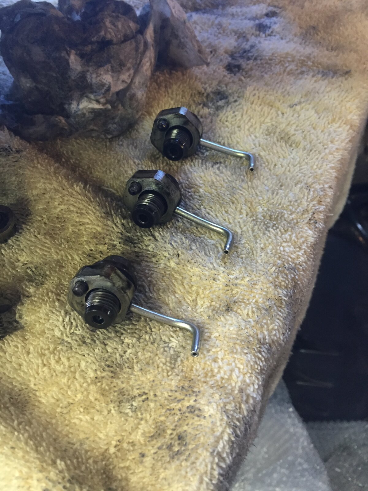

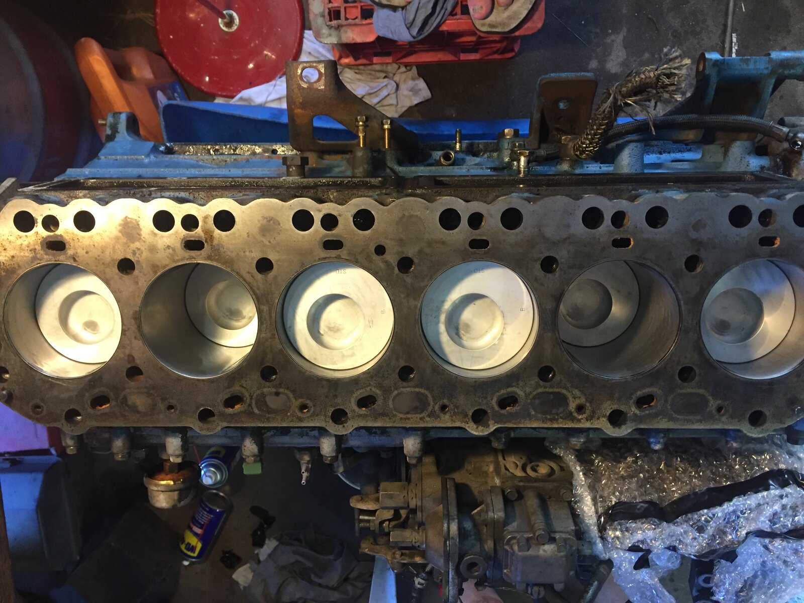

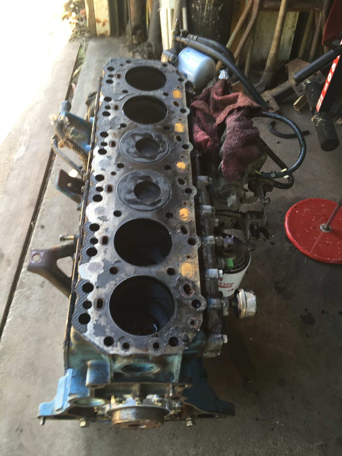

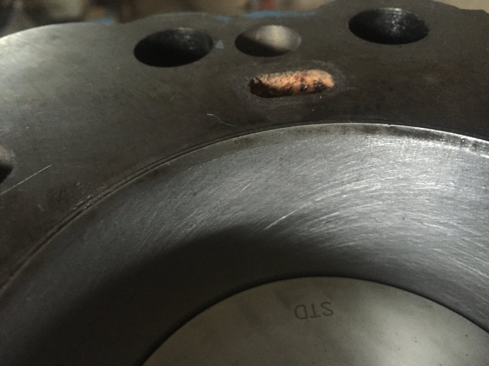

I found the 12ht number 5 cylinder was low on compression and stripped the engine to see why and found this.piston 5 008.JPGpiston 5 009.JPG

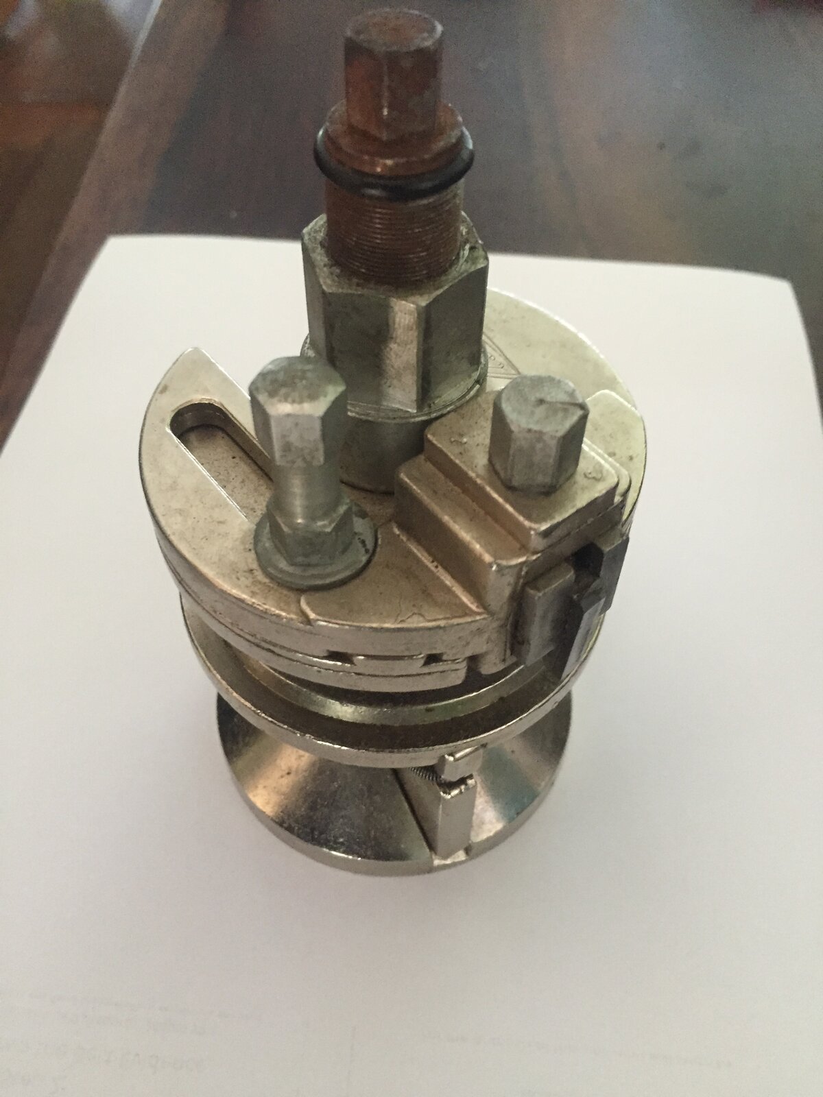

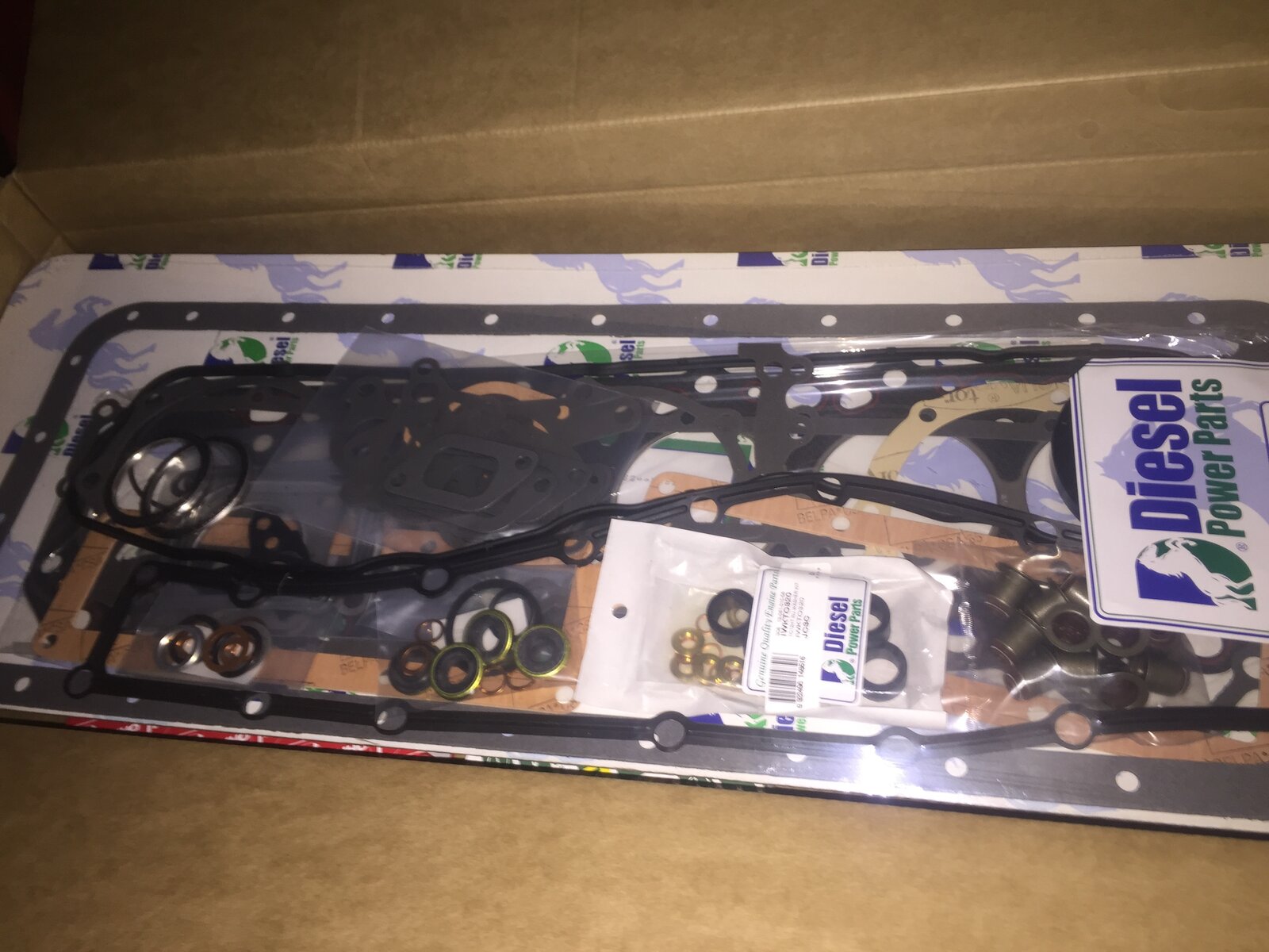

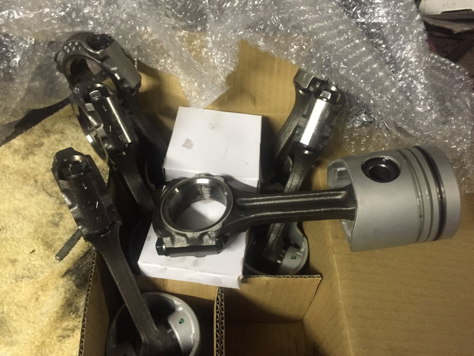

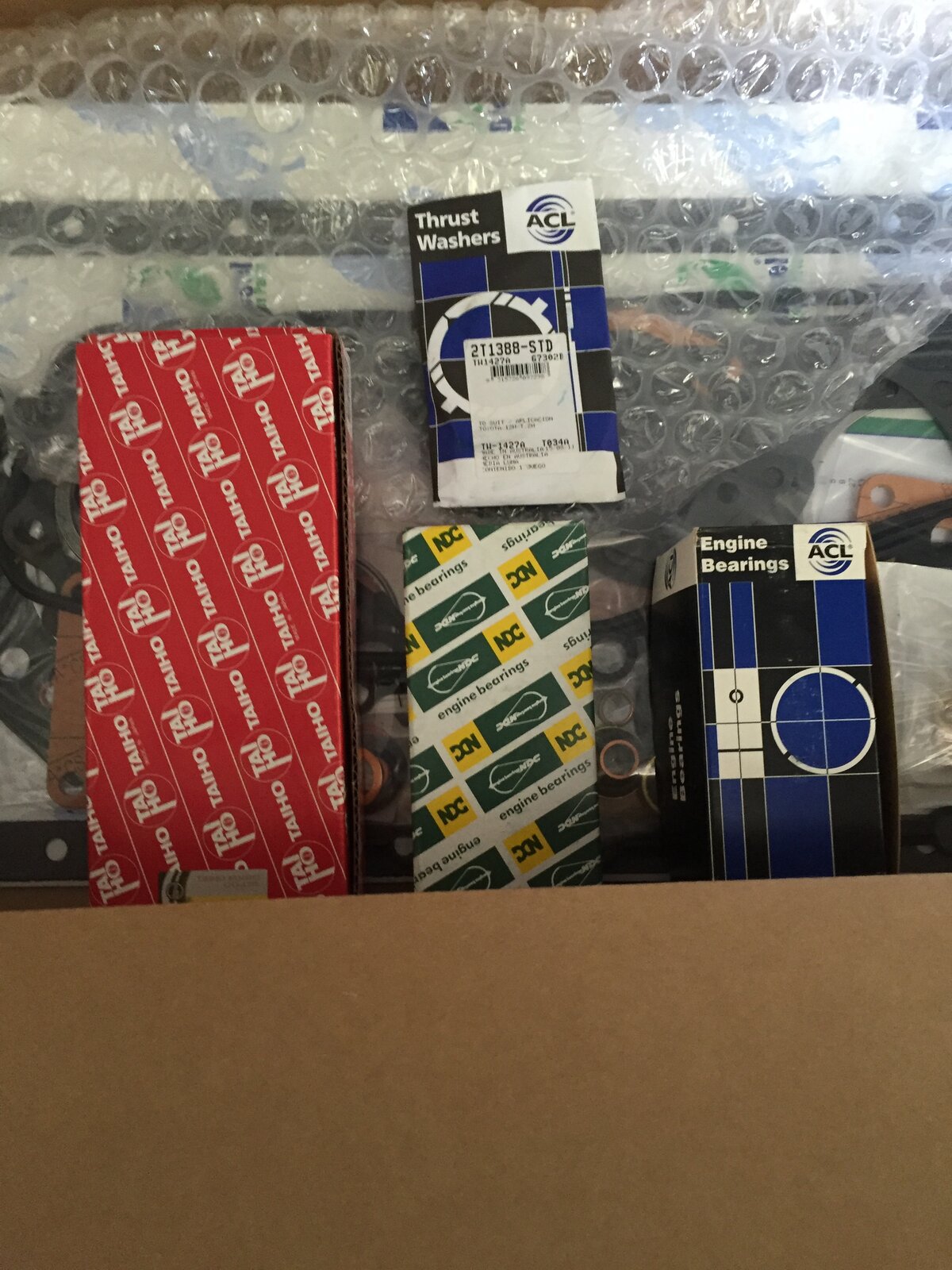

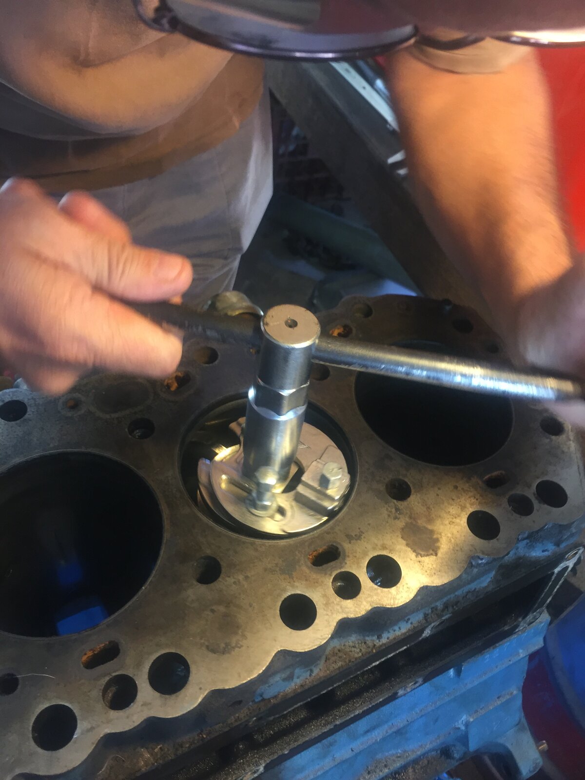

Brought a new std rebuild kit and going to hone the cylinders wth new alfin pistons.engine kit 001.JPGengine kit 002.JPG12ht bearing etc 001.JPGlisle reamer SR9 002.JPGflex hone 001.JPG

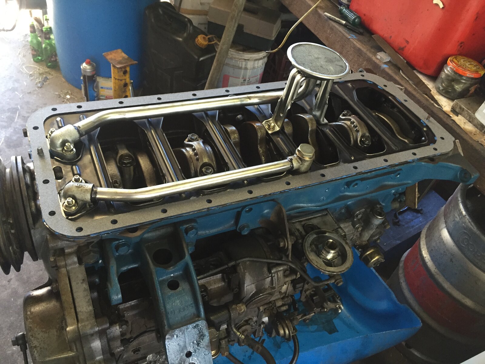

New clutch and getting ready to rebuild with all std parts.

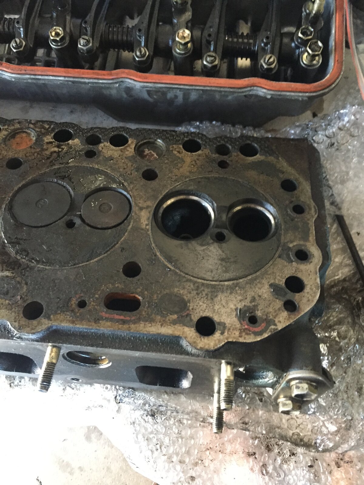

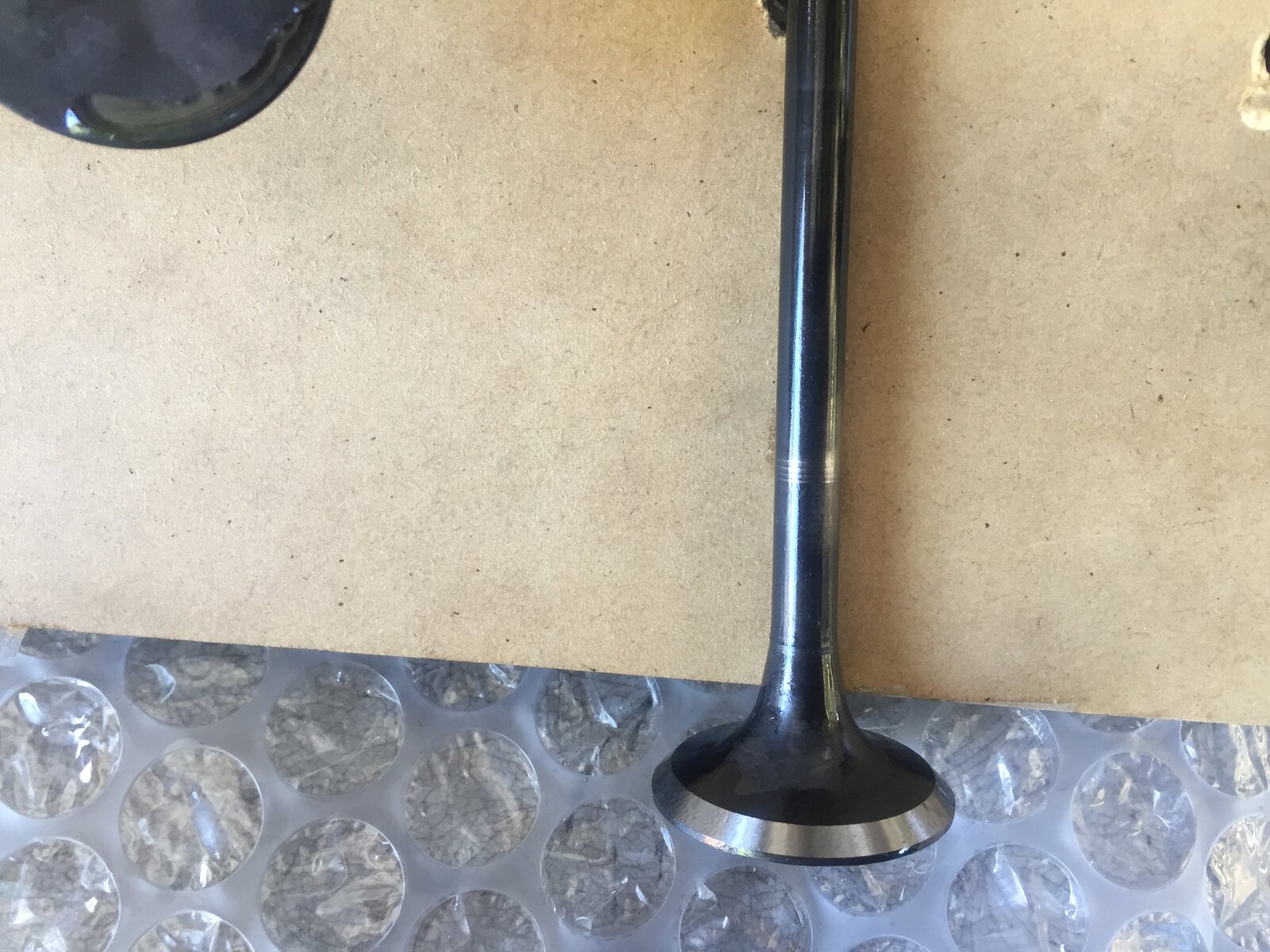

I will pull all the valves hopefully this weekend and check out the seats but happy as number six looks great with little ware in the seats.

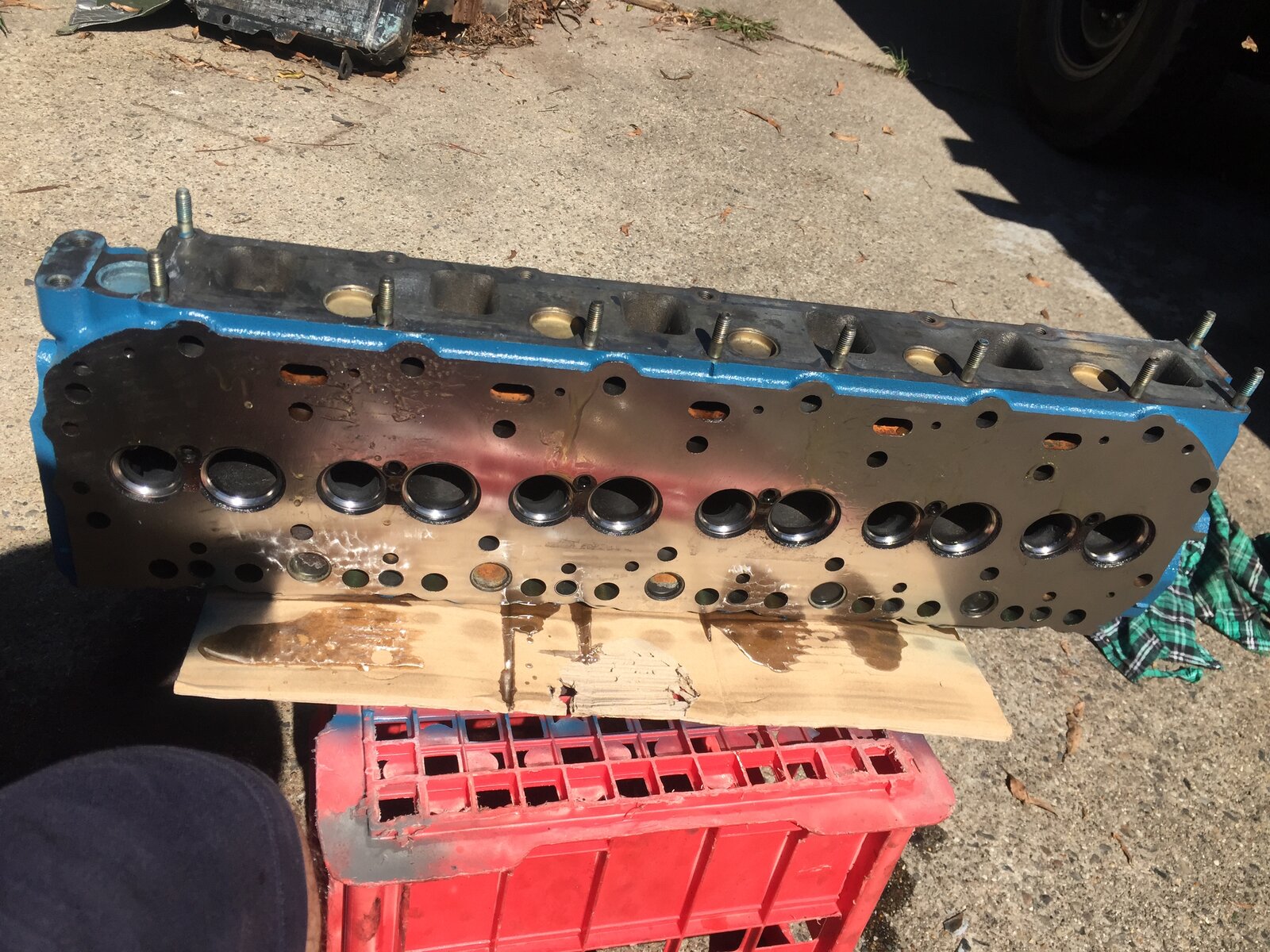

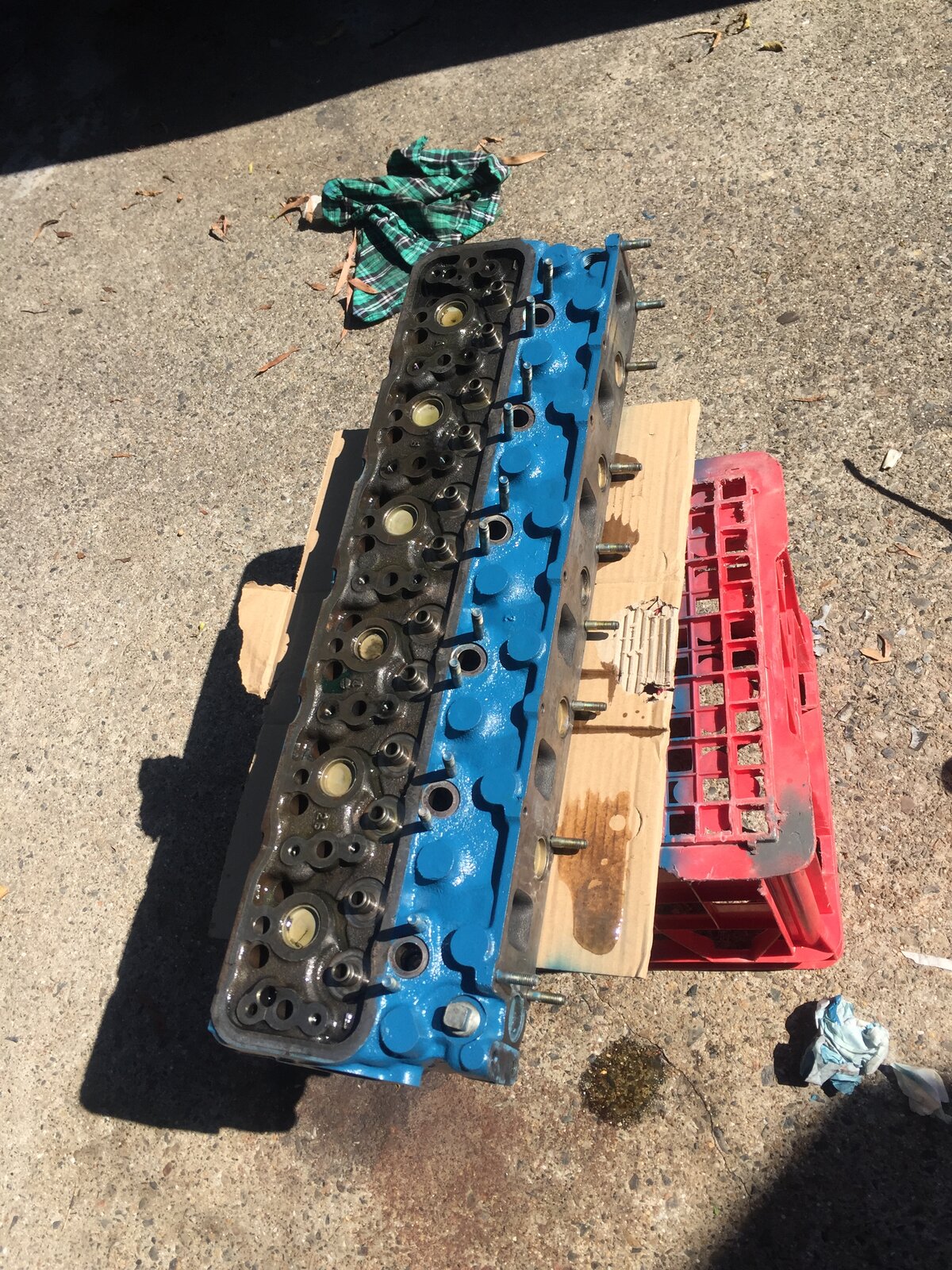

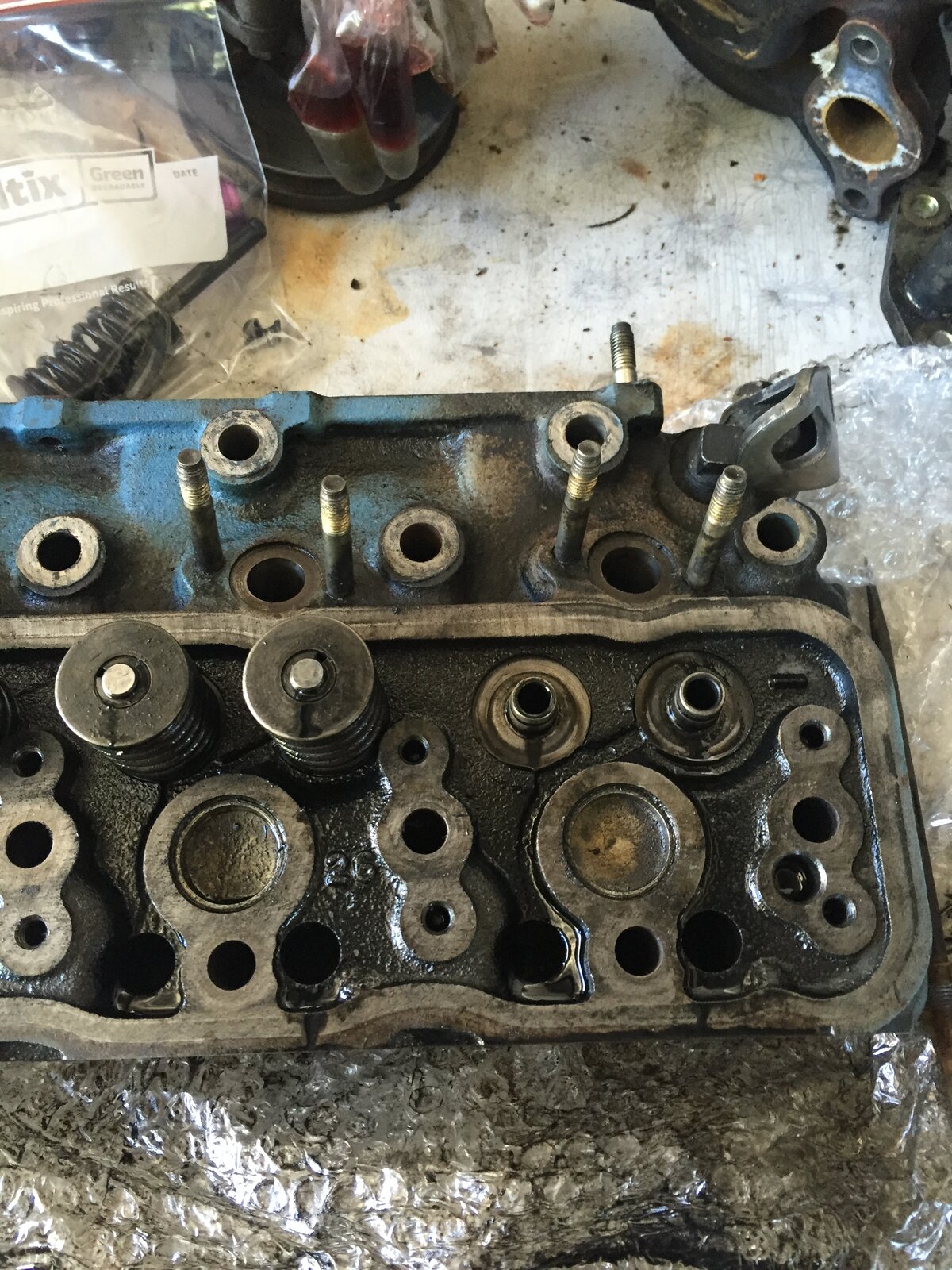

I had the valves and seats cut and head was decked because off a slight warp.
I also brought the 18 brass welsh plugs needed for the head.

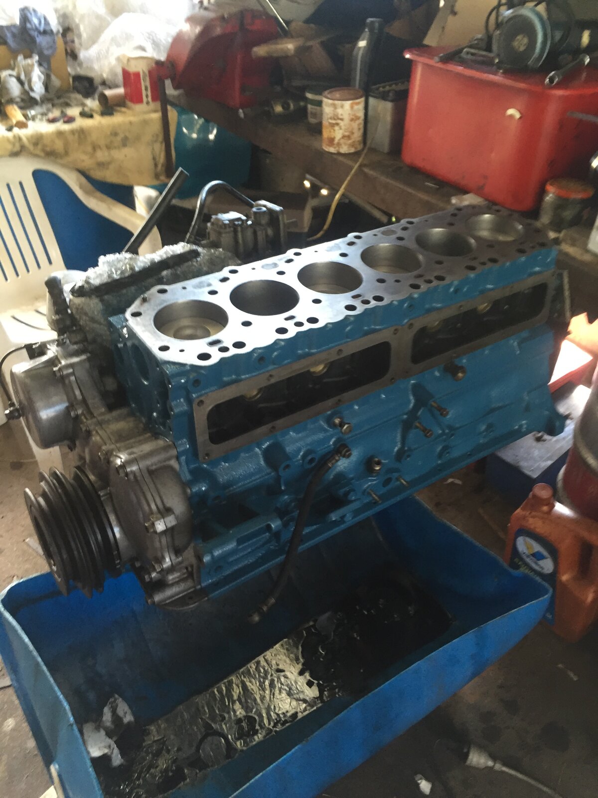

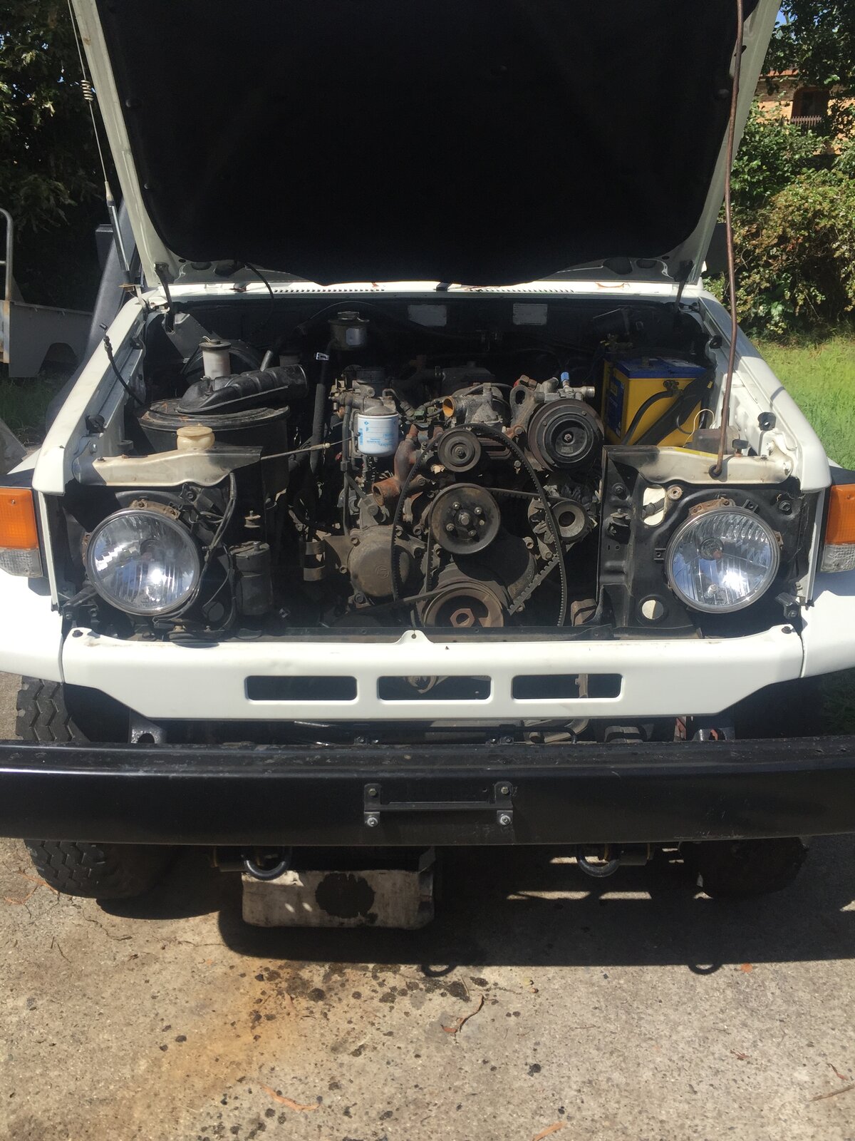

Cheers Ben another day or two and should be able to start the engine swap.

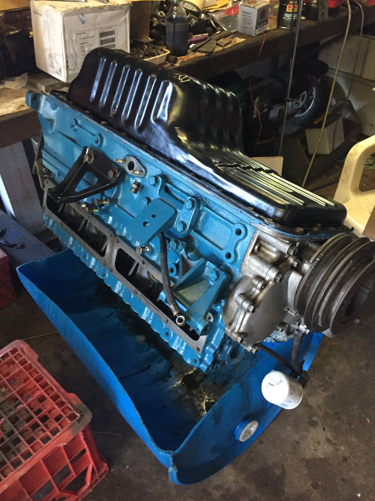

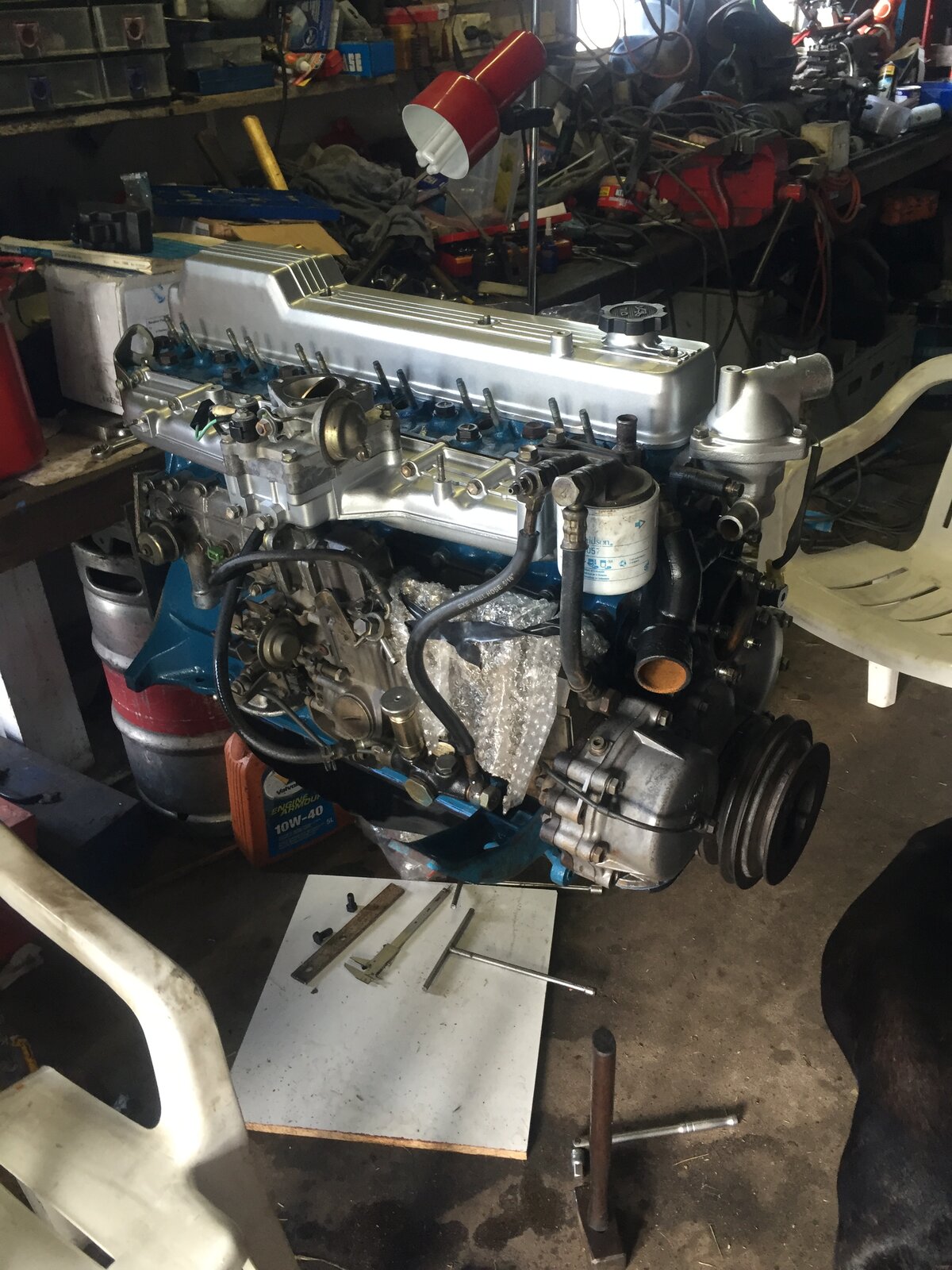

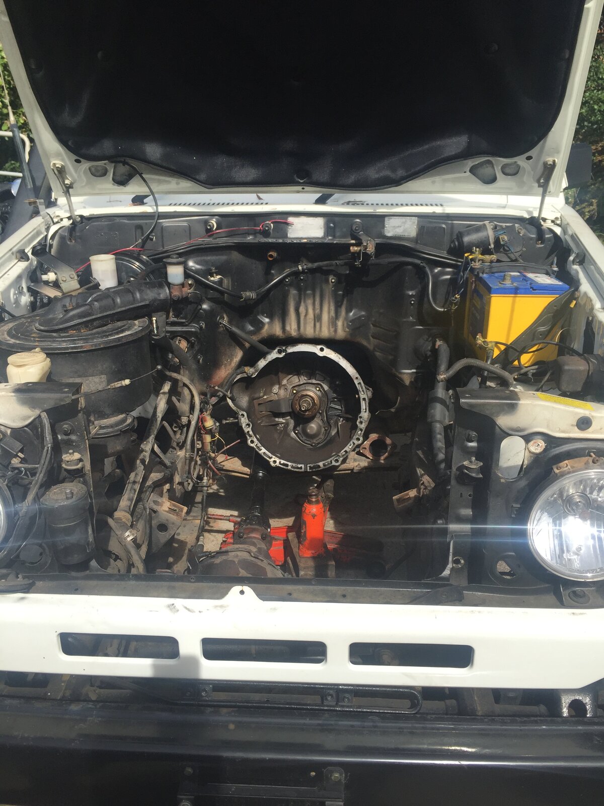

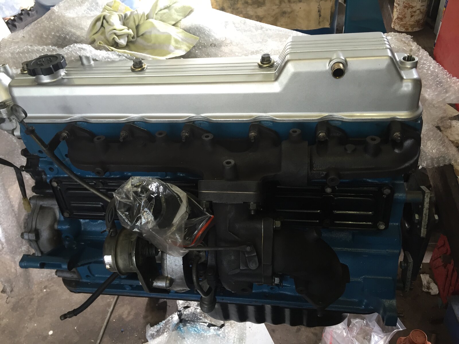

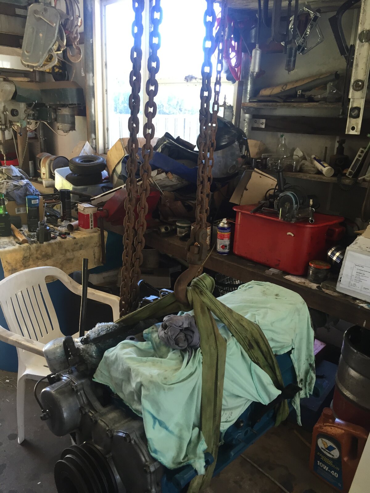

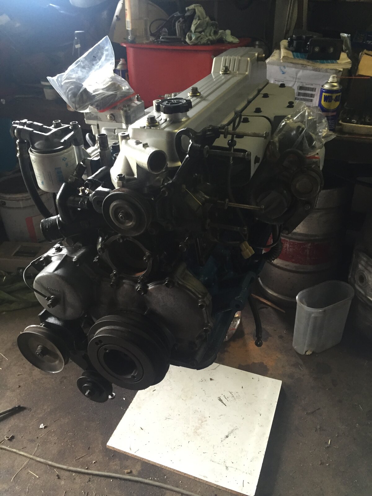

Not much more to do to the engine except pull the old 2h and slip this baby in. Happy days
