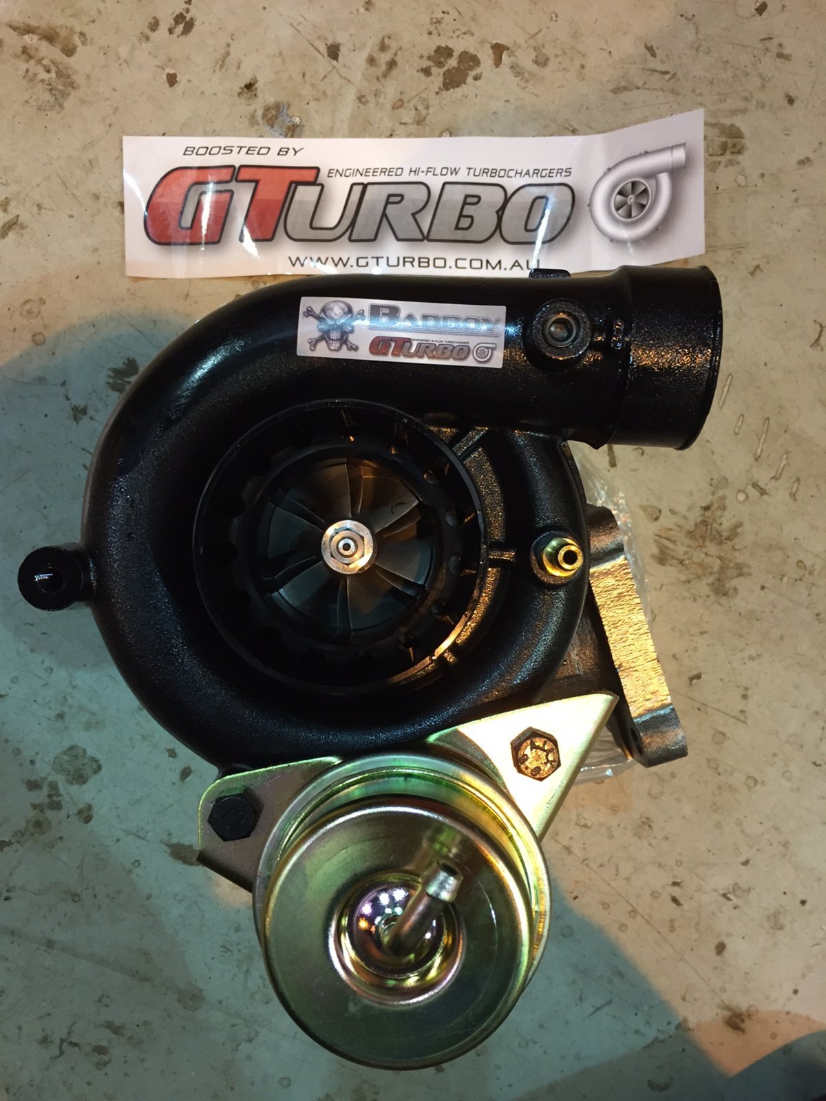

I am leaning more towards the GTurbo option currently though. I'm not sure that my current turbo is salvageable given what I've done to it. So if I had to buy a second hand turbo to then upgrade it the GTurbo at £1450 is only a few hundred pounds more and the turn around time is a lot quicker.

If you want to upgrade to a hybrid turbo, you may want to check these guys out:
http://www.wink4x4.com/
They are in the Netherlands and developed a hybrid turbo from scratch much like the Gturbo, but at a way better price since it does not have to come from down under. I think it was around 1400 eur / 1240 £.
Also found these guys in Aus:
http://www.munroracingturbochargers.com.au/
They have good prices for the billet high flow turbo, but I think shippingcosts and importduties etc will kill it ...
