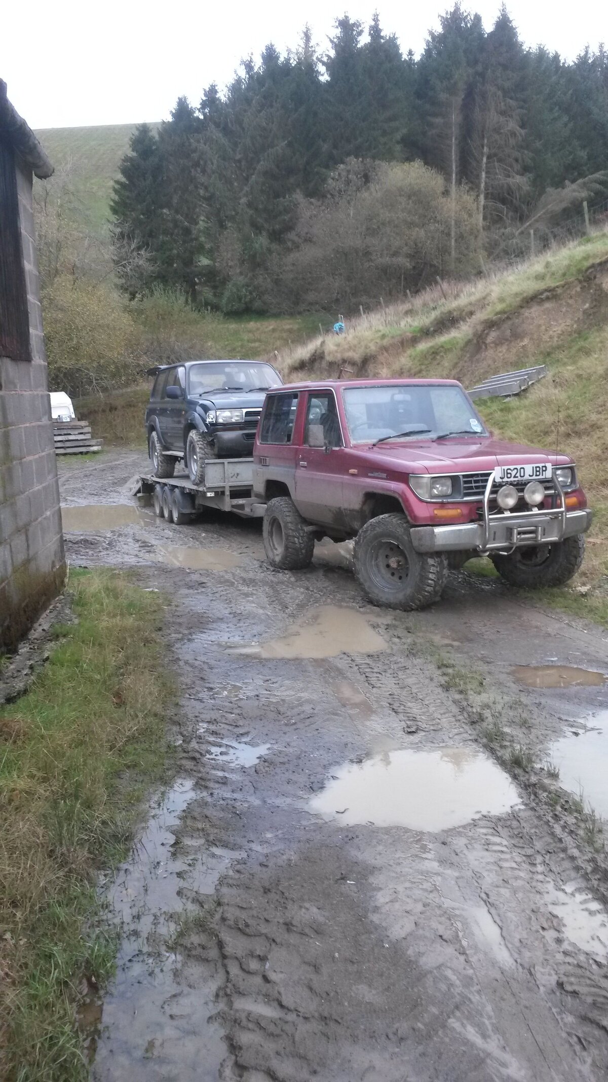

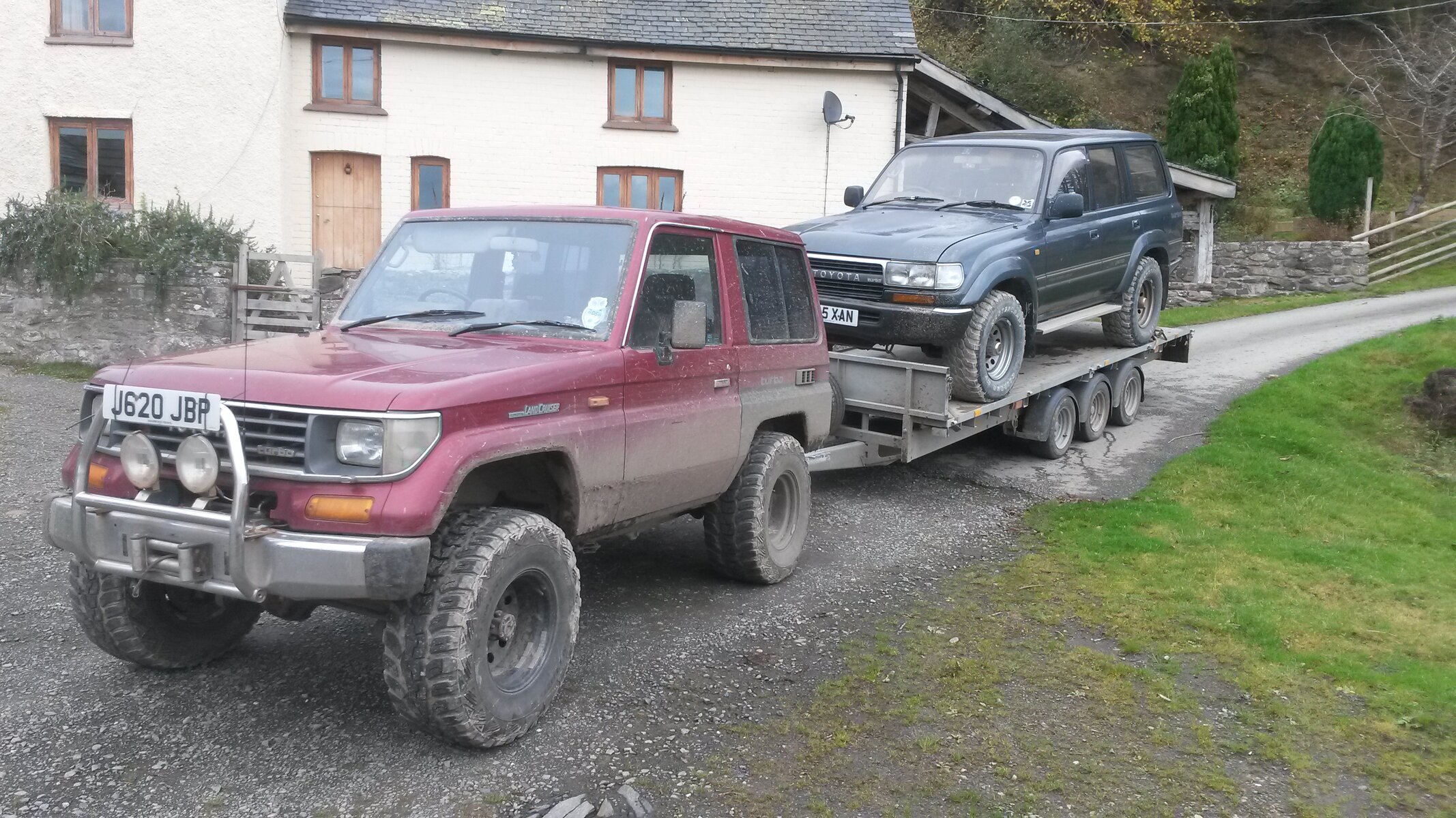

    Hi guy's. . Have made it over to the 80 series!
    I started a thread in July about a local hdj81 vx limited that has a few issues. After hard dealing and leaving time, it is home for £1300 and he gave me £20 for luck!

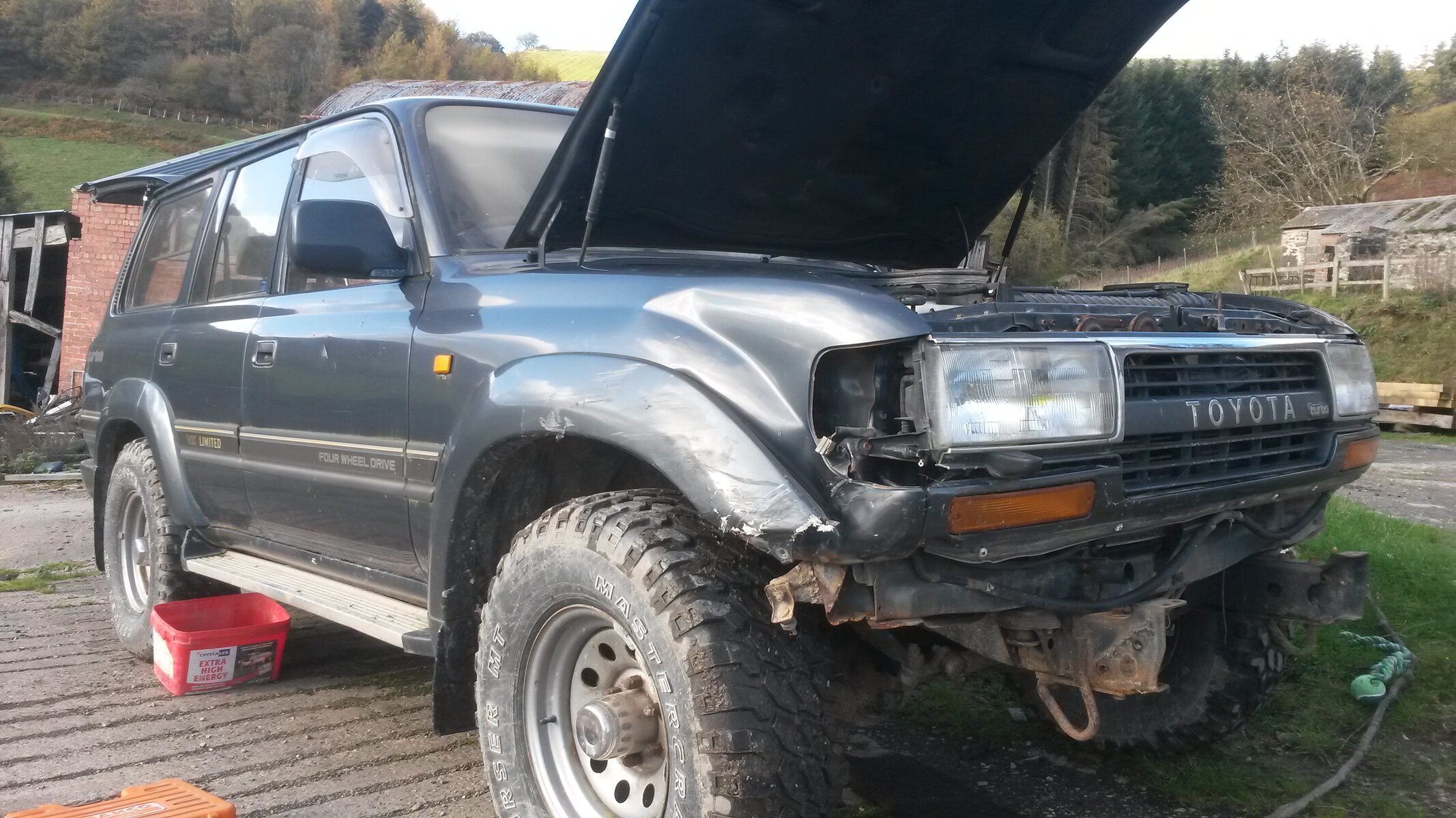

    After looking at the auto box issue. The accelerator position cable is seized and not broken, it is stuck full out. The guy said that the truck hadnt been driven much after the problem occured. He changed the atf fluid and said it was clean and had no black bits or smelt burnt.
    Hopefully use was stopped in time with no extensive damage.....
    Both batteries were flat yesterday evening so am eger to get out and try to fire it up. The right hand negative battery terminal is shot so first job.
    As an import the underside is real neat and doesnt even need painting so pleasing!
    70 series had a heavy pull back (thats what its there for!)

    Iwan, well done. Bargain. That cable does get stiff and sometimes seize completely. It's pretty easy to change but it's not cheap. You need to take the auto box sump off. Always woorth cleaning out the ATF filter whilst you're in there. Wear a hat though. It drips a lot.

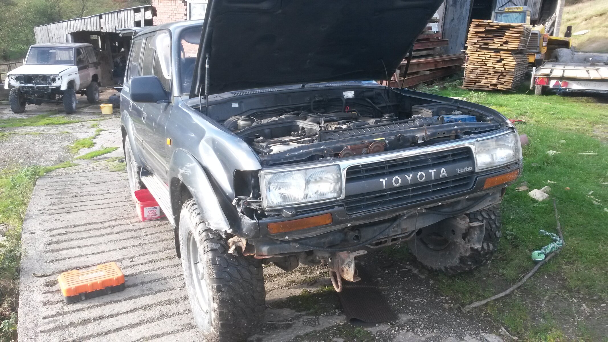

    Cheers Chris.. overall its not too bad.. have got decent charge in the batteries and worked out how the immobiliser works.
    When I goto start the starter motor sounds like a rattle gun! So am trying to work out the reason. Not engaging or not enough power going to it.
    So could it be the starter motor or 12v to 24v start relay?
    Must be a diagnosis here! Thanks!!

    The Rattle gun sound on trying to start it is the batteries not having enough grunt in them, may be worth investing in a new pair

    Iwan, just try a jump lead from the -ve on the battery to the engine lifting point. Could well be batteries of course, but a poor earth to the block is not uncommon. This bypasses that. I there is no difference then it's not the earth clearly. I bought a pair recently from www.batterymegastore.co.uk/?gclid=CPfA0bvH3MECFSgFwwodN1YAlg
    They are fast and pretty much best prices around. Free next day delivery. Shame you are not closer, I have a pair of Optima Red tops sitting here doing nothing. And a spare driver's side Yuasa too. It just turned out that way. I'm not collecting them.

    Thought you'd like this one Clive. . I got it running and moved from the muddy area it was in. Much happier with it now..
    Thanks yes the lhs battery had 11.33 v in it. Fitted one of my 60 series and started with a flick of the key! Running sweet as a nut :dance:
    Moved to a dryer concrete surface, removed the oil pan and cable removed now that's a dirty challenging job!
