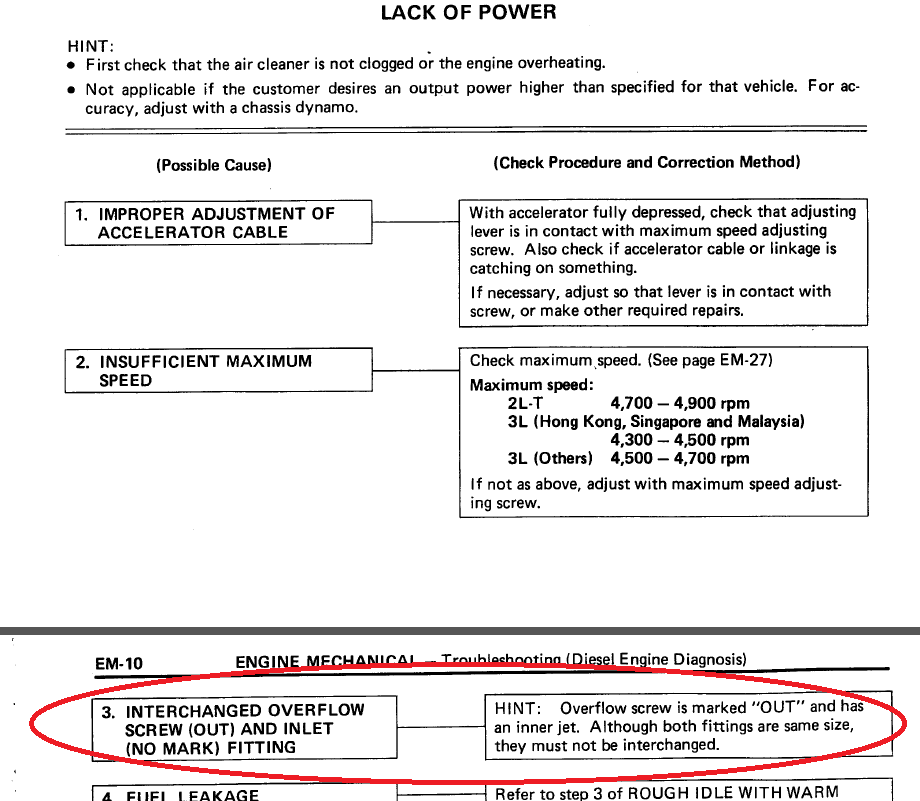

I looked into the 2LT manuel and found the following cause of lack of power:
Does anyone know where those 2 screws are located? The previous owner overhauled the cruiser almost completely, so maybe he interchanged the 2 screws. Google does not give me any more info...
