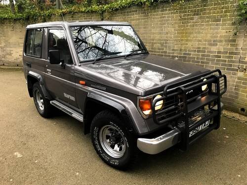

ps oh God, do change those tires ! had the same ones , one nearly exploded on the highway in France.they are stiff rubber by now and just awful, they are a genuine danger.
