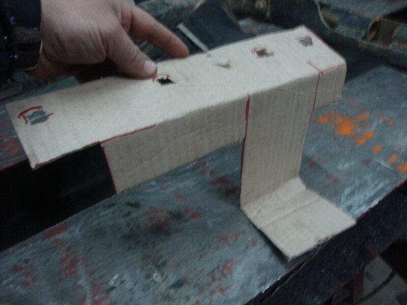

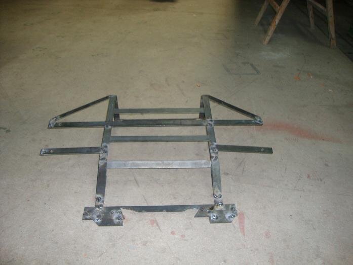

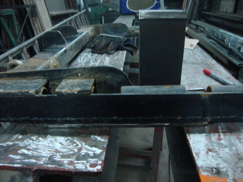

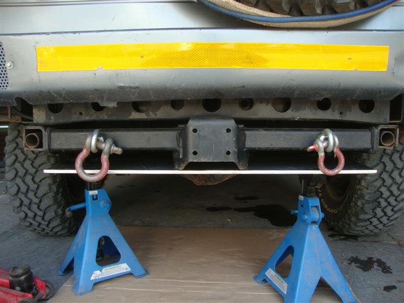

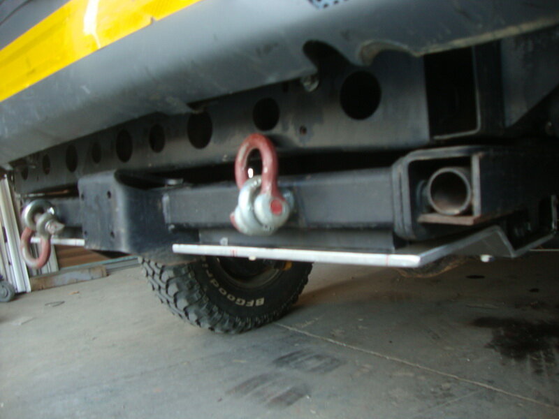

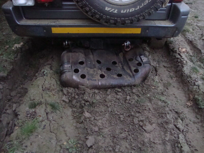

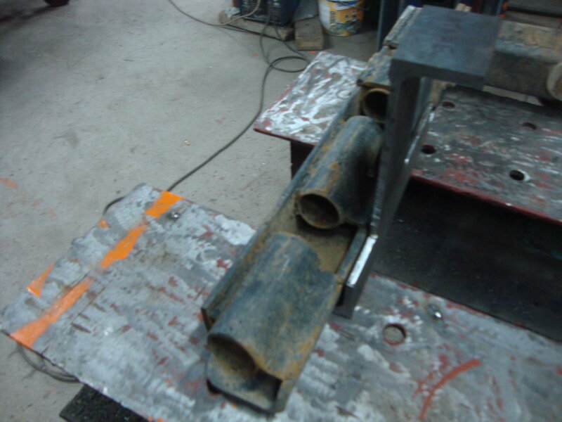

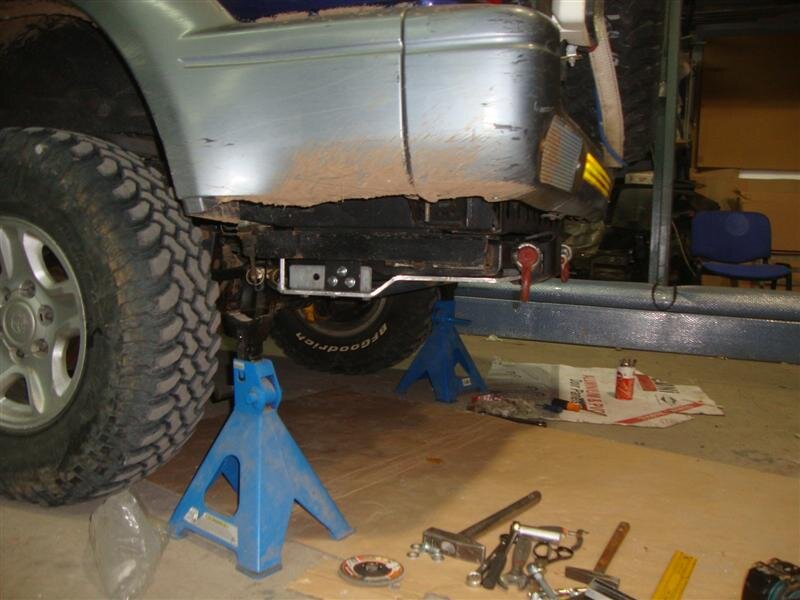

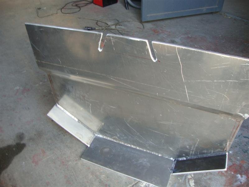

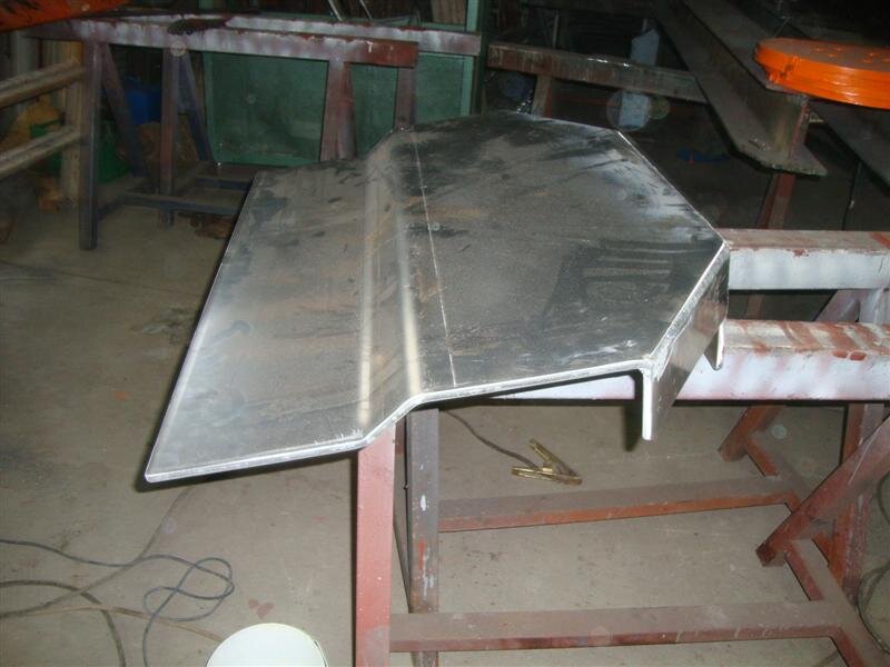

as u ll see my rear skid plate stopped my car as a brake...

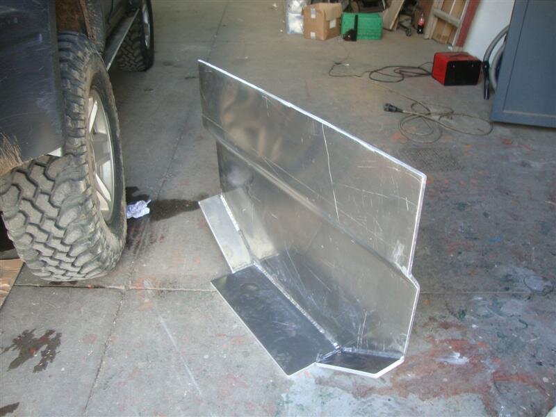

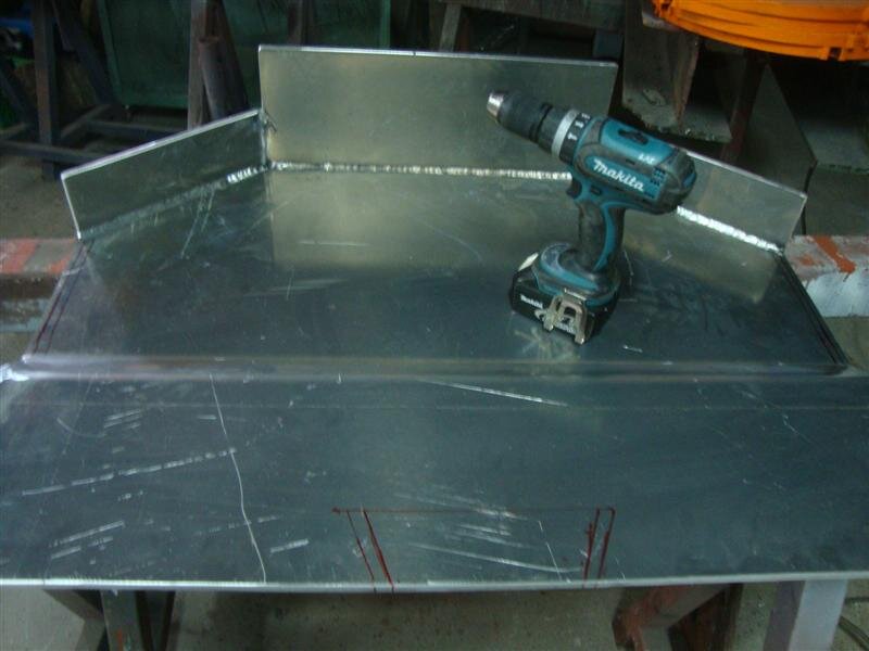

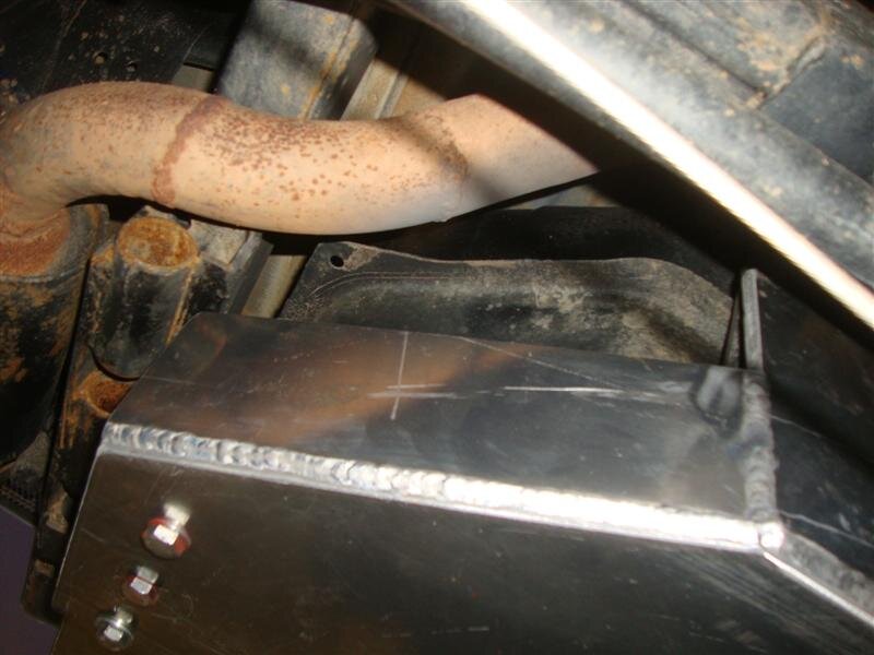

so i copy the figure from asfir rear skid plate to make something similar using as a material alu 5083.. but 10 mm .
( when i used the original 6mm skid plate for the transfer protection and paid 350 euro after 3 months was for the garbbage..became as a ruffles- waves)

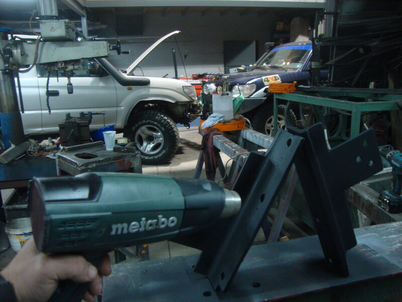

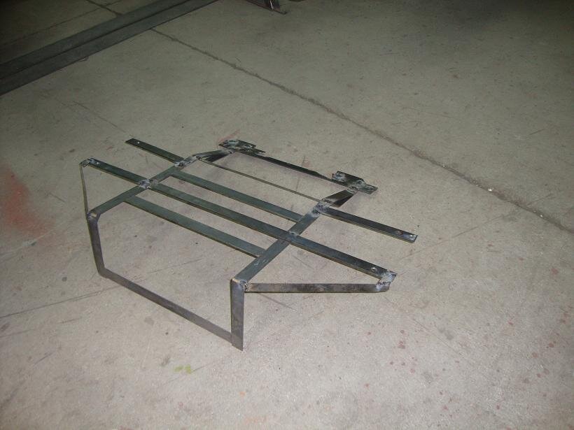

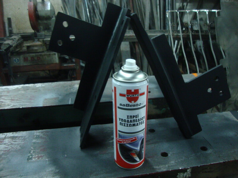

for the support bases used channel "H" (thickness 6mm)

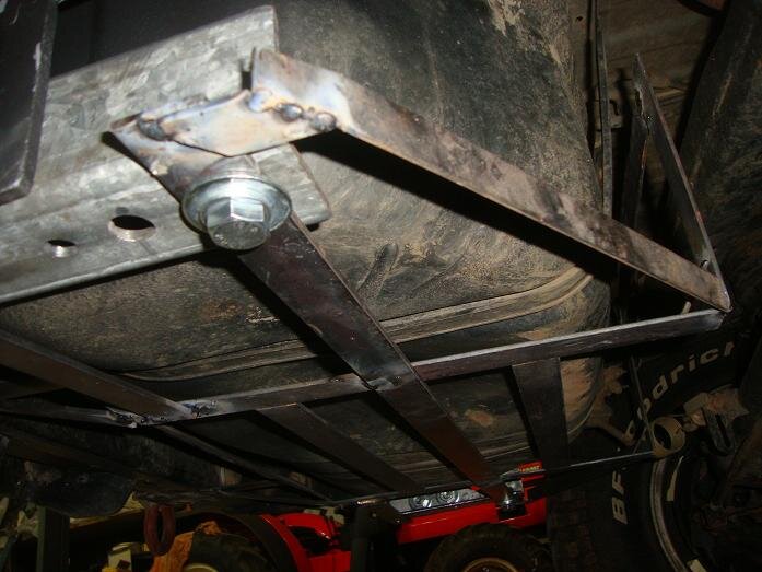

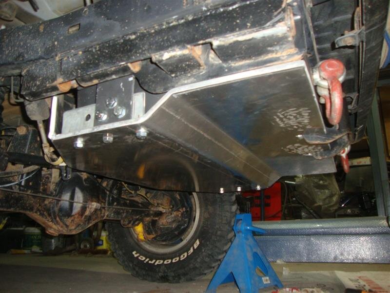

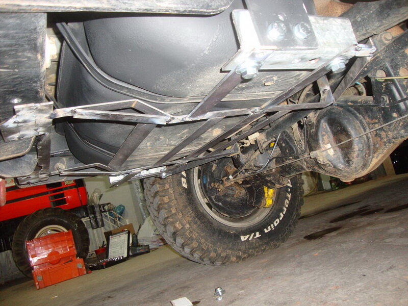

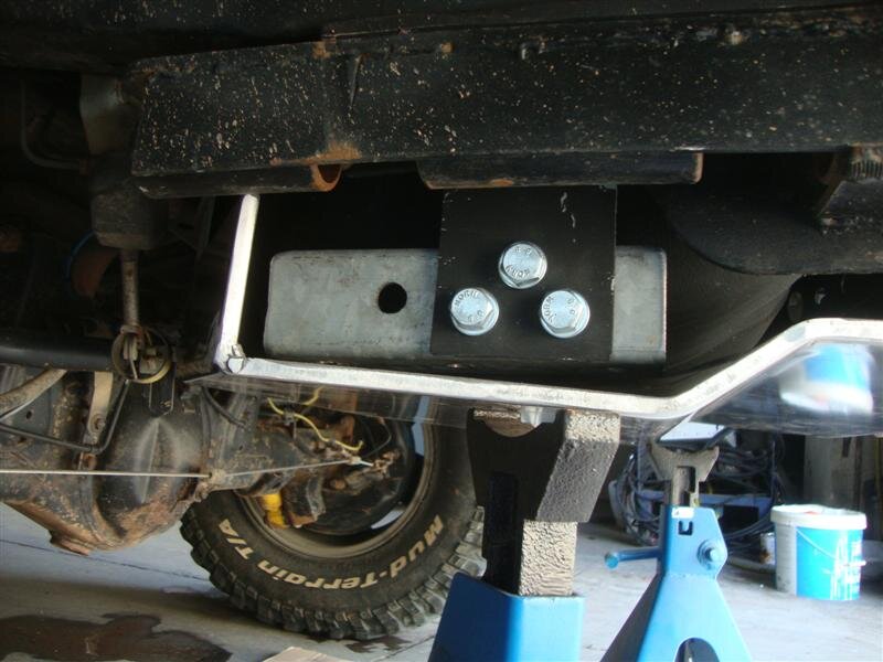

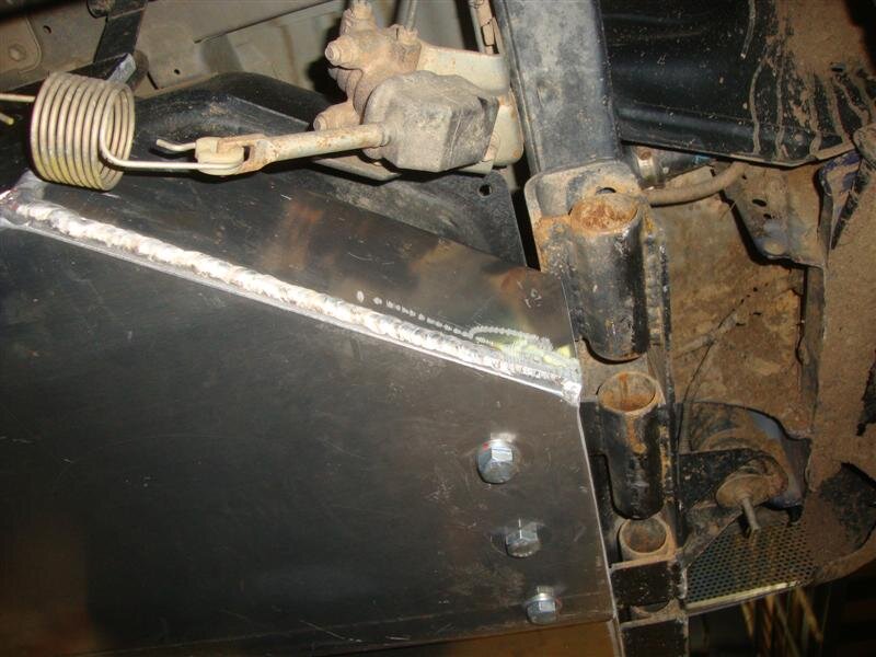

..with the 3 galvanized bolts supported the 5mm galvanized angle to the main base type "?" ..so if needed to take off the plate is very easy
the nuts from inside are welded and the space between the tank and the plate is 2 cm

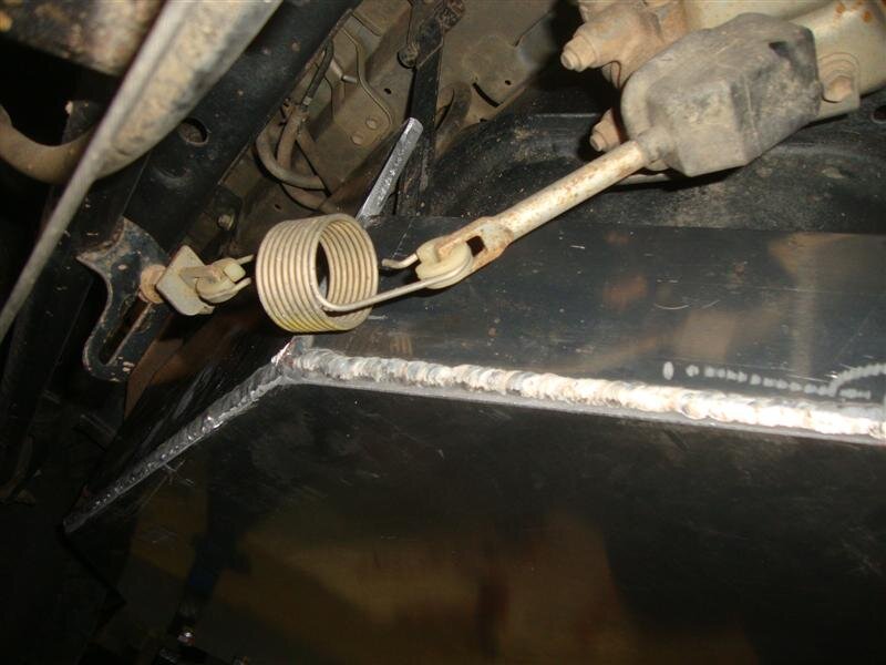

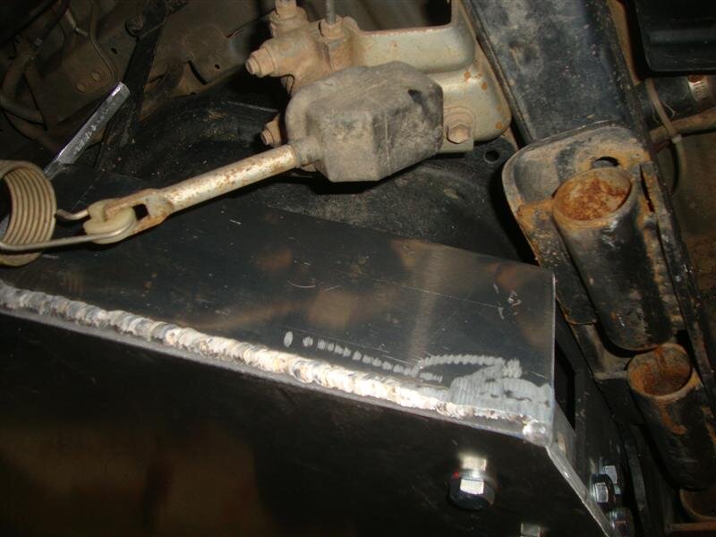

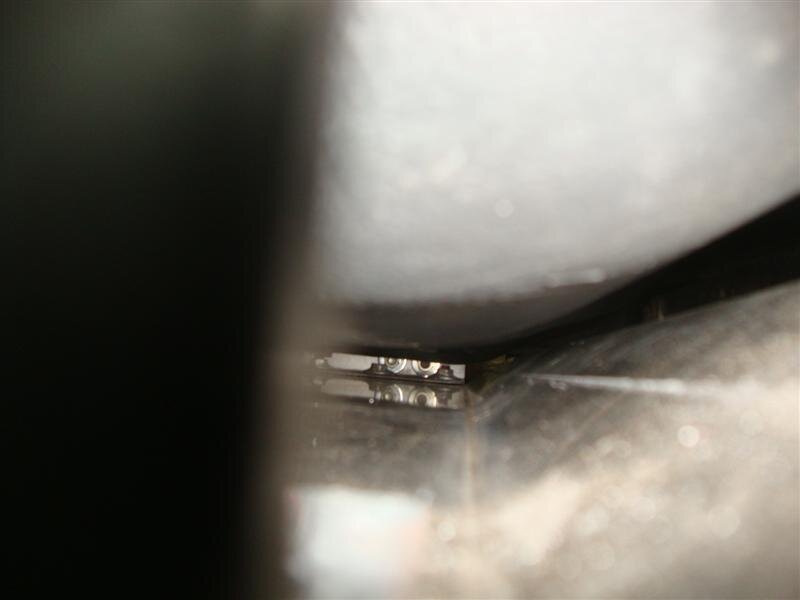

.. the distance between the spring and the plate is 2 cm (angle photo no help)
..the bolts that hold the plate to the galvanised angle are M12 and 40 mm length
the skid plate cost 80 euro (pay only the material)
