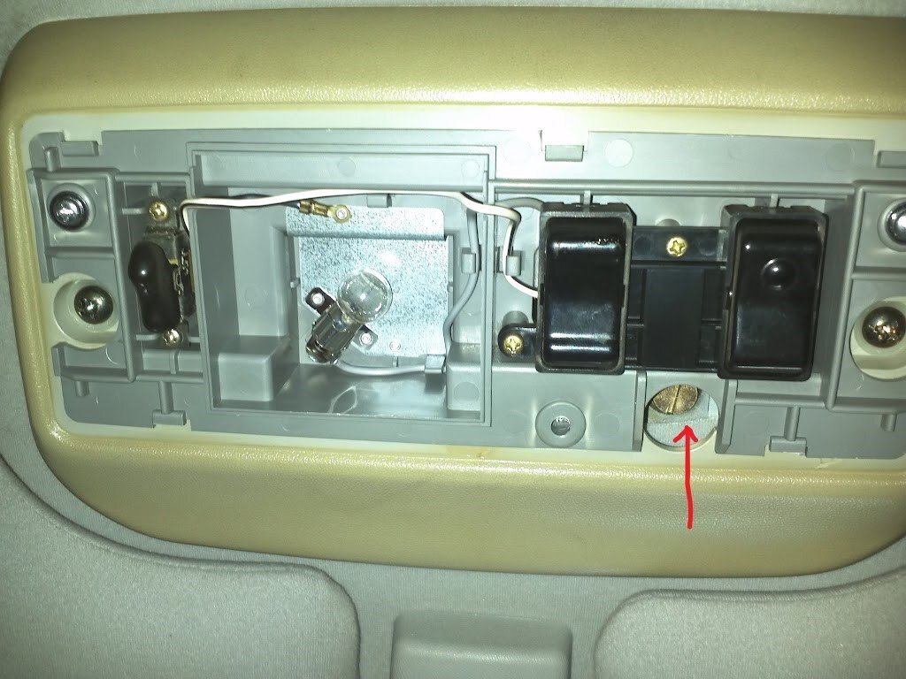

There where the arrow is, thats the motor gearbox spindle hidden behind the compass/tilt clocks. A gentle twist is supposed to manually open and close the roof. Mine doesn't move, so will have to go deeper.
