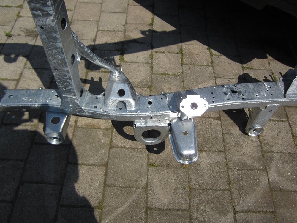

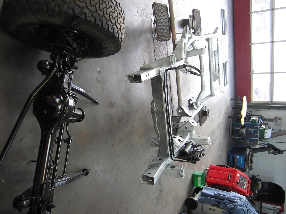

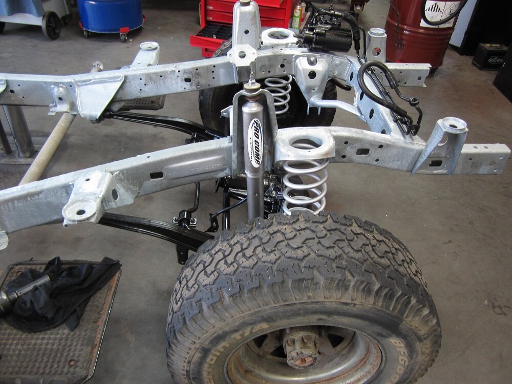

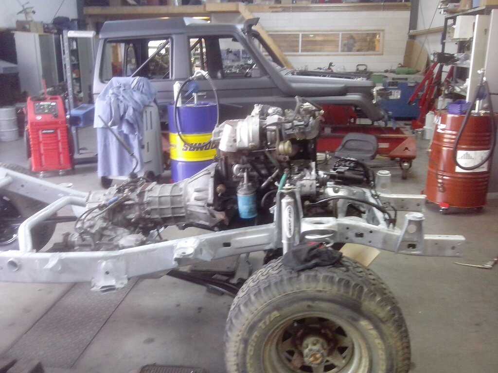

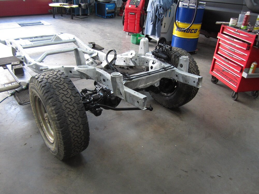

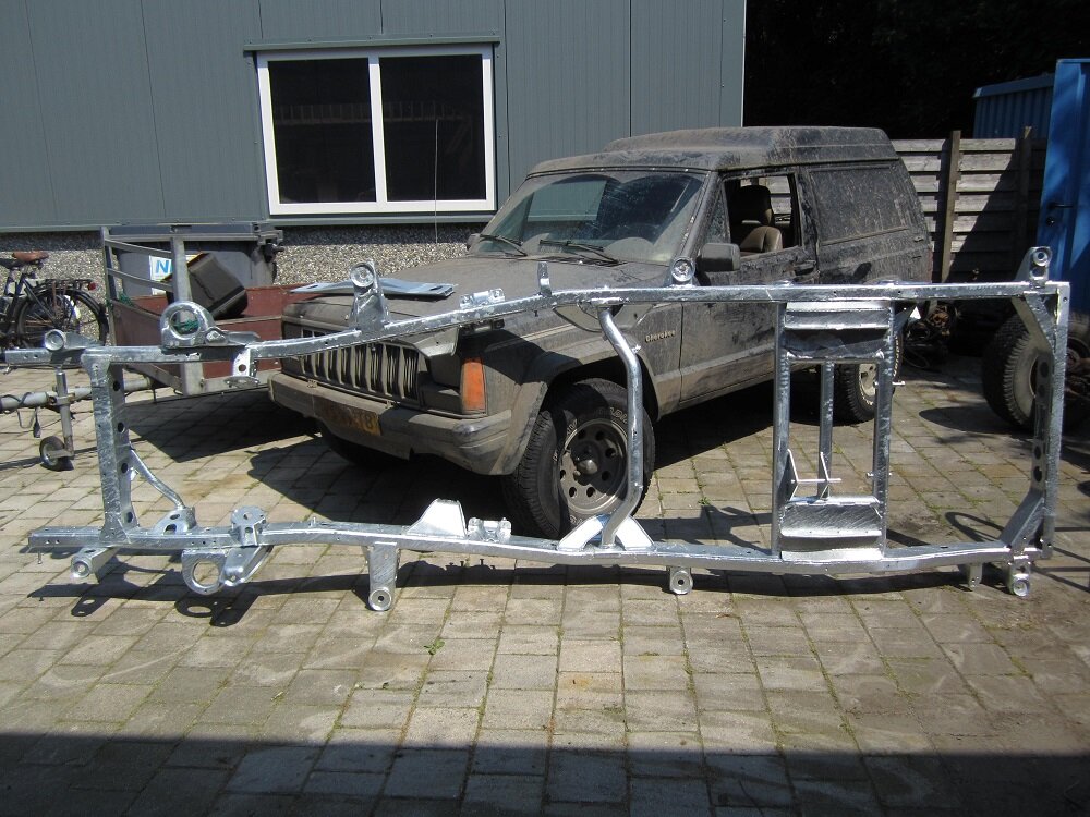

Got the chassis back :dance::dance::dance:
Bling Bling
need to do some cleaning up on some places

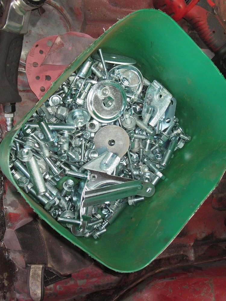

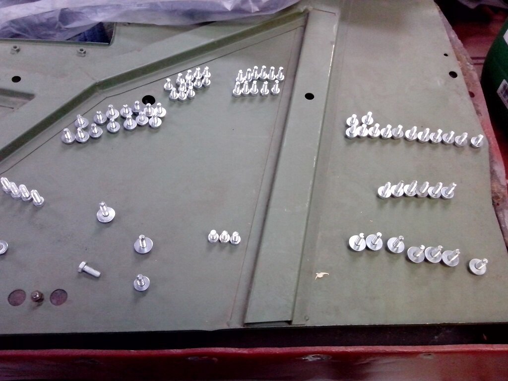

and remove all the bolts witch I'v put in to protect the thread

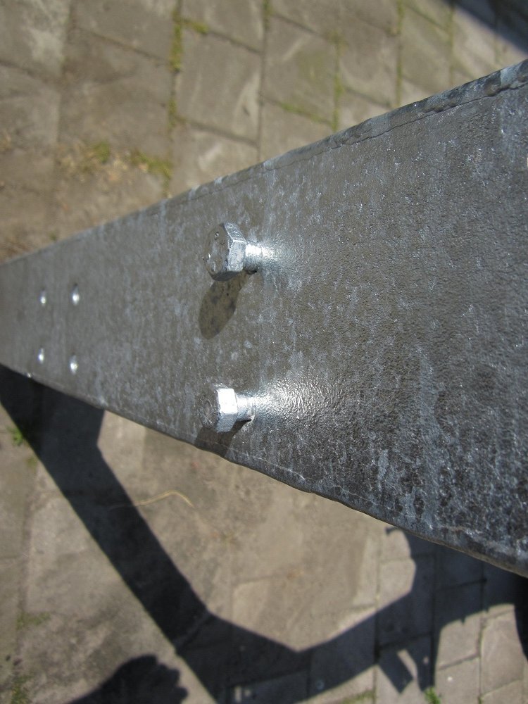

also got al the bolts from the chassis and body electro plated
I asked the to do them gold colour as is orginal, got them back silver, slackers
Looks good, interested to see the rollcage come together.
Envious of your welding skills!!
Damn, that looks terrific!!
Point being with a 60 series is that the chassis is riveted, so therefore galvanizing is not really an option...

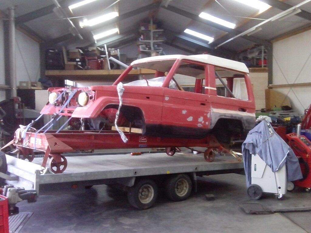

Update time.

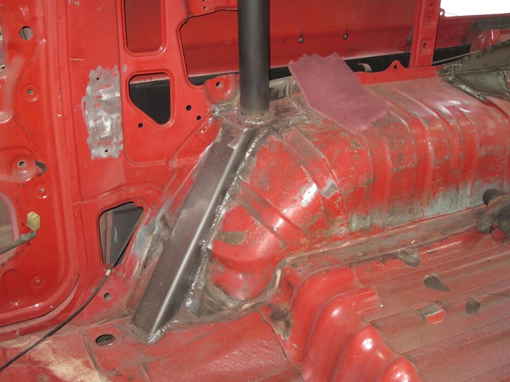

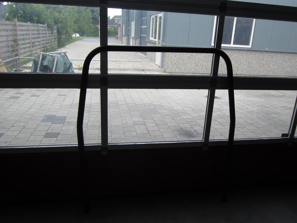

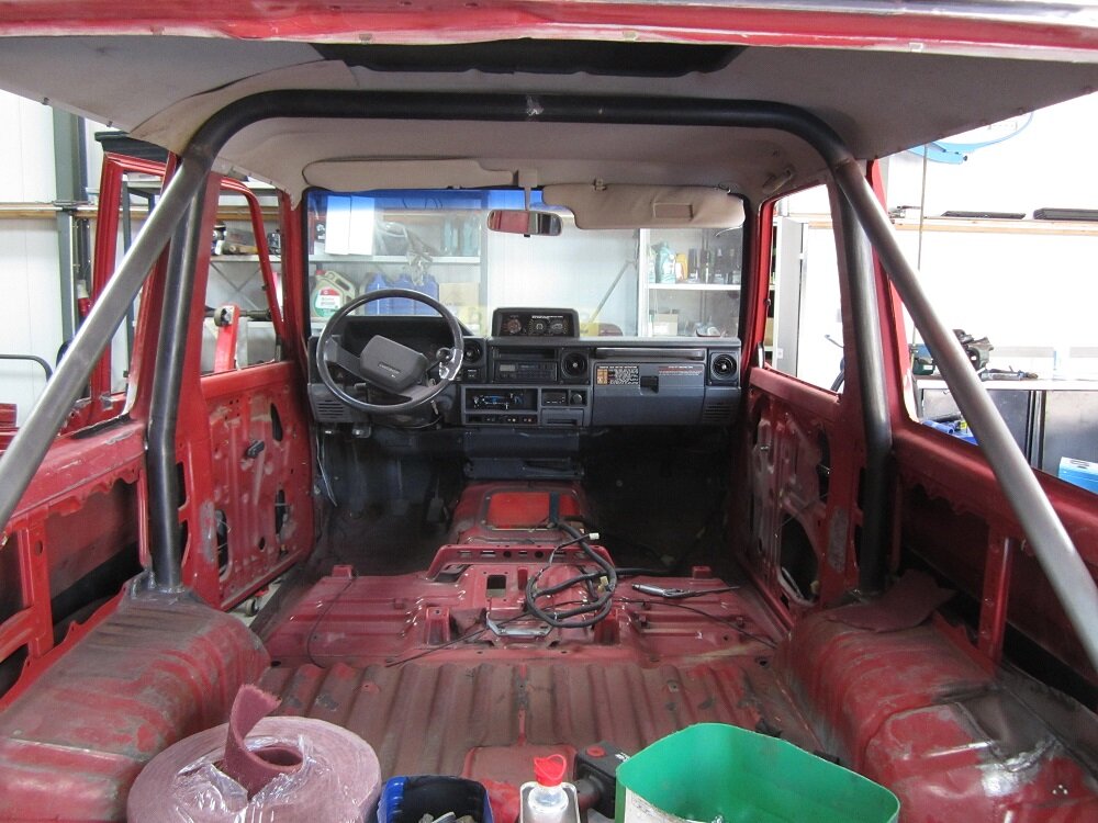

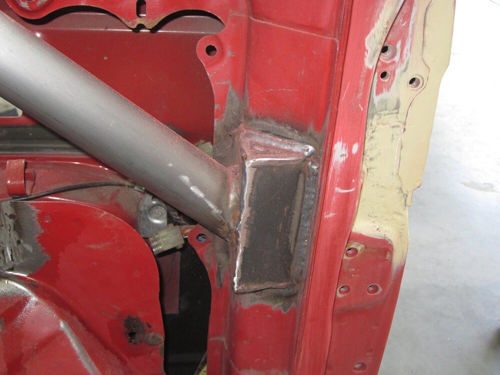

Made the main rollbar hoop of 50 x 2.5 chome moly tube, shut be strong enough :icon-cool:
all fixed in place
side view, shame the rear windows have to be blindend in Holland ( for tax reason )

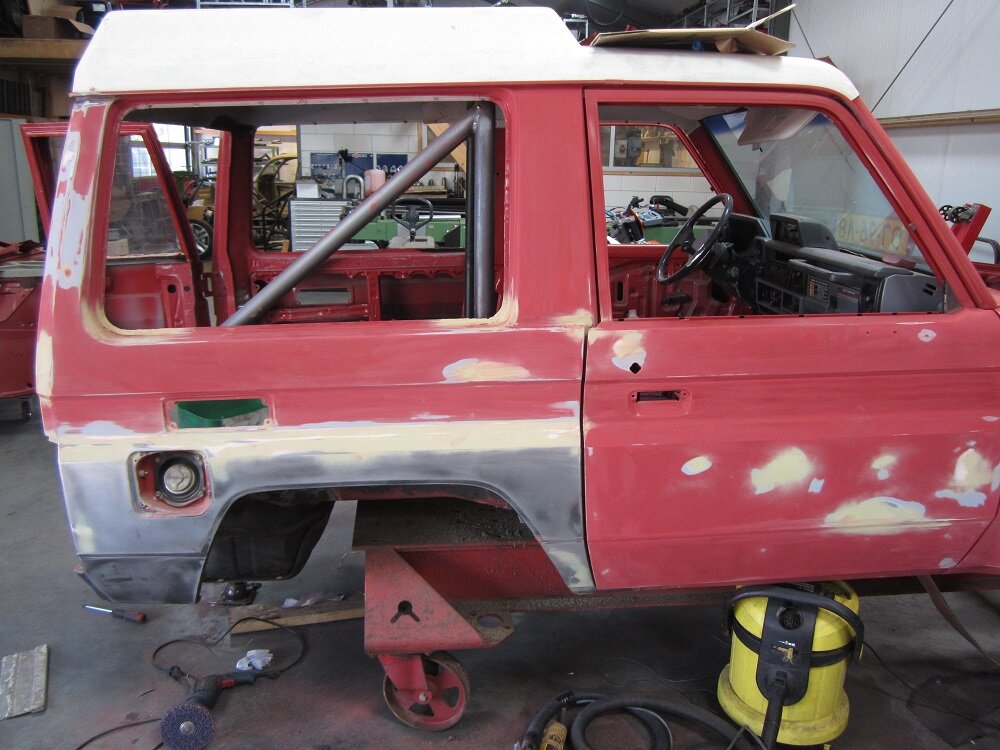

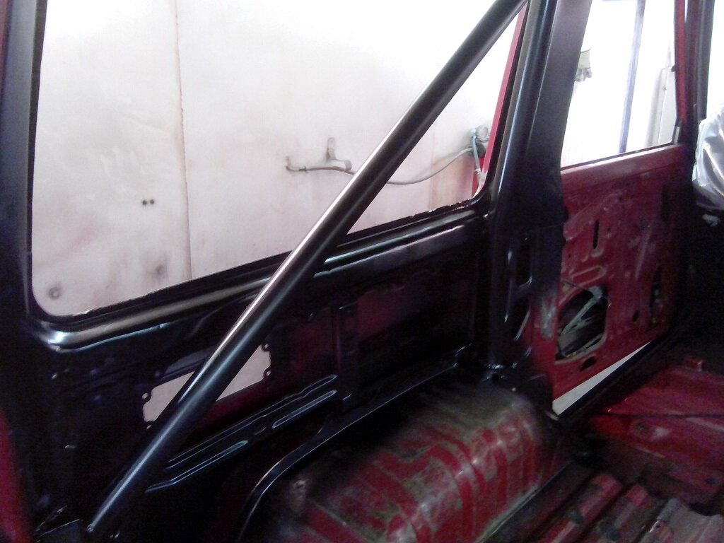

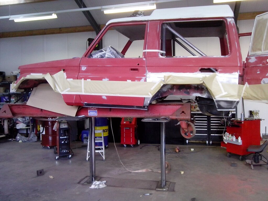

made some reinforcements of the inner wings all the way down to a chassis mounting point.
rear back stay in place

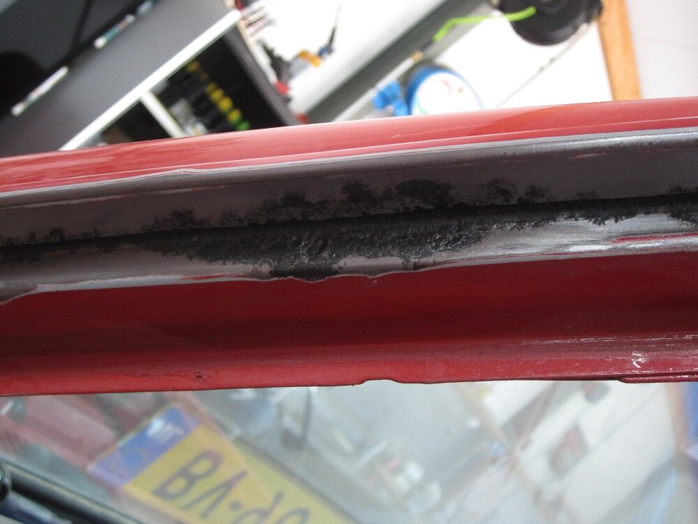

luckily for me there was some more rust on the inside of the A pillar :thumbdown:
treated all the rust spots with Owatrol, people say it is great on rusty spots, whee will see.

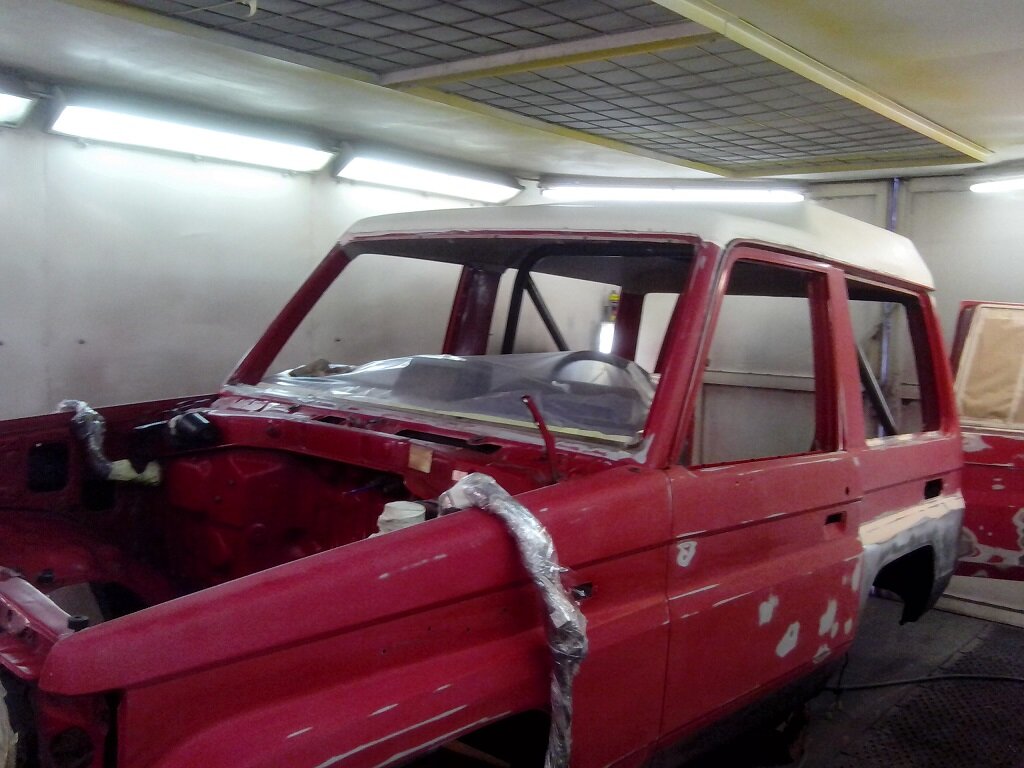

finished with sanding this weekend :dance:
rented a spray boot for Wednesday, than we gonna paint the sucker black :icon-cool::icon-cool::icon-cool:
Damn, that's serious progress!! Roll cage looks real solid!

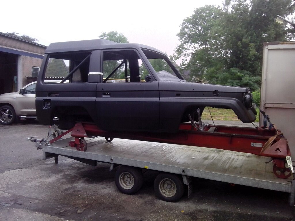

got the car painted this weekend :dance::dance:

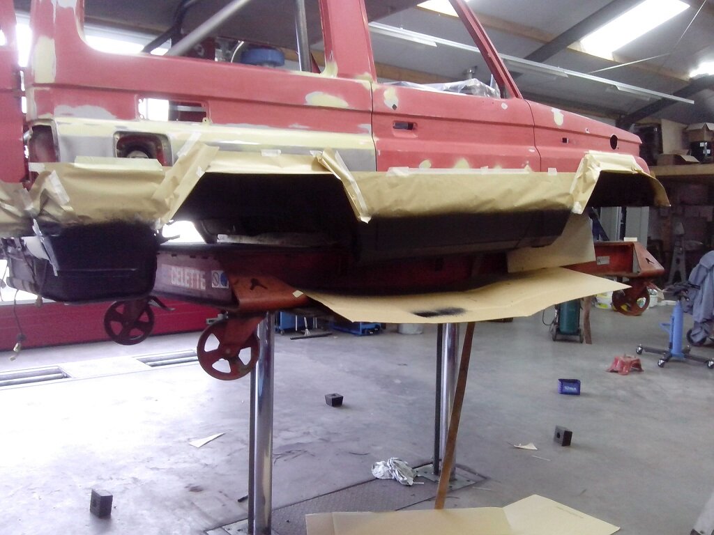

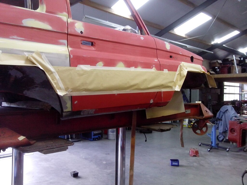

masked the car, ready for a nice layer of undercoating.

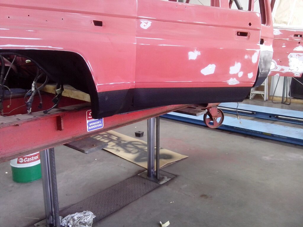

Doors, skirt en lower piece of the quarter panel are in a nice thick layer of undercoating
spraying the undercoating in progress

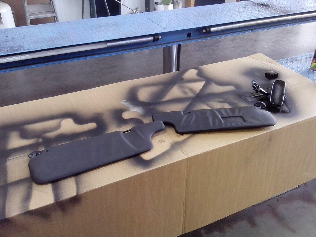

Painted the sun visor black, to match the black roof liner

masking tape and paper removed
got the car on to the trailer, ready to go to the spray boot

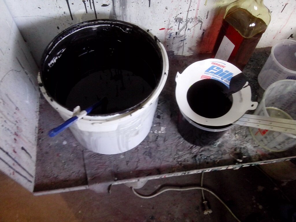

mixing up the 2 pack paint.

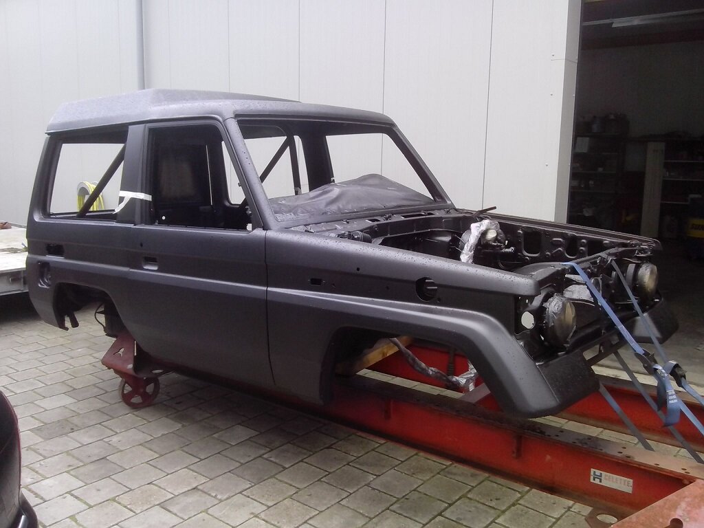

it's a 2 pack flat black paint, I added a little bit of silver to give is a special look, so its become a Flatt black metallic
spaying in progress
after 4 hours of curing the car was ready to take home
back home and of the trailer.

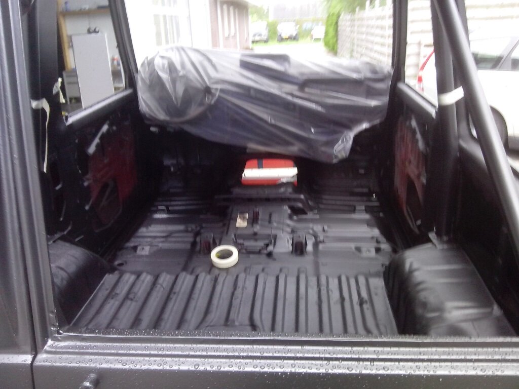

a pic of the inside

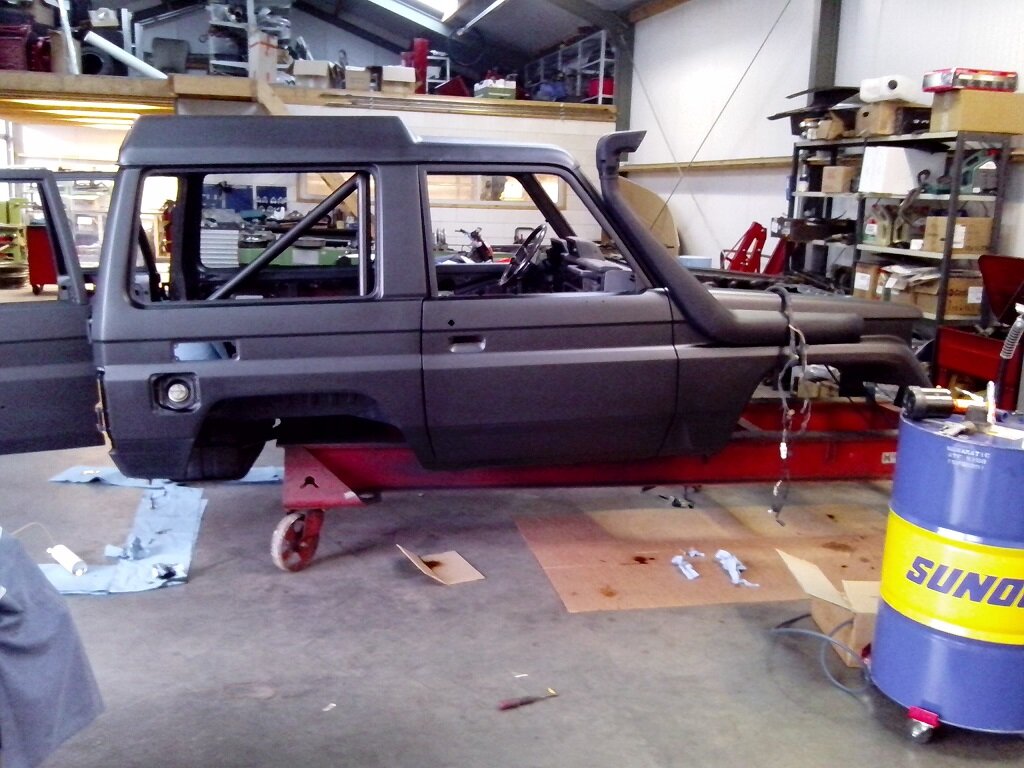

I could not resist mounting the snorkel :shhh:

must say I,m very pleased with the result.
considering it has bin several years for me sins a last painted a car, it went very good.

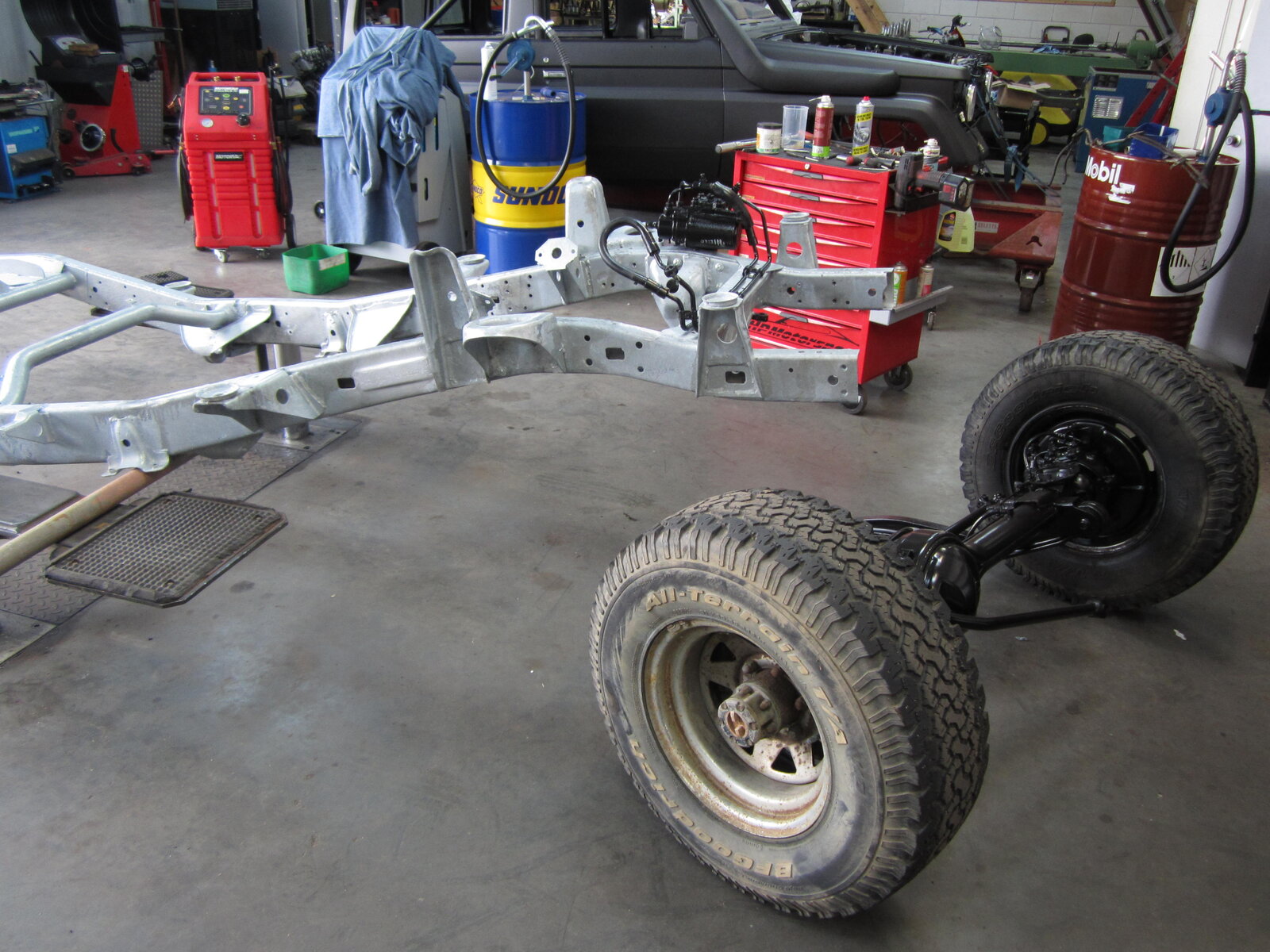

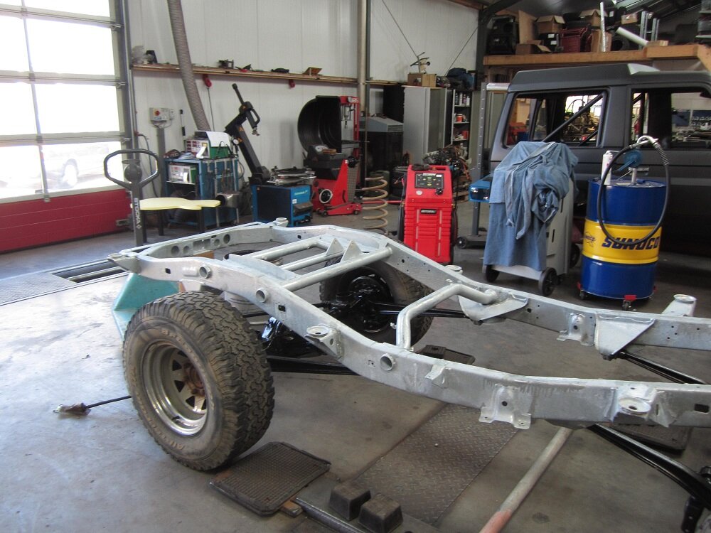

First I pulled the chassis in the workshop and removed all the bolts and nuts witch protected the treads.

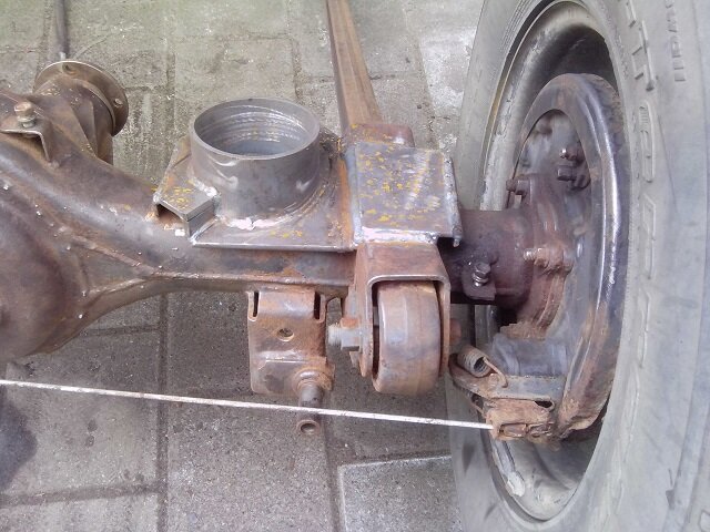

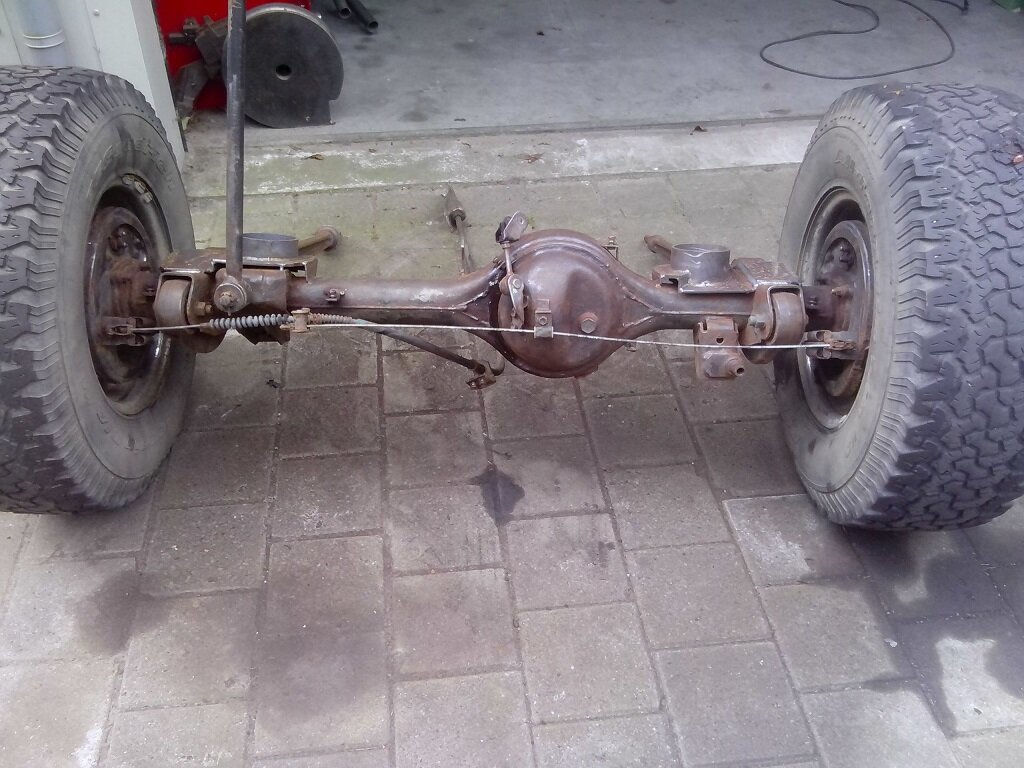

repaired the rear axle, both spring seats where totaly gone. build some new one's out of 6mm steel.
than removed as much rust as possible and gave it a coat of black paint.
Front axle didn't need any repair so it was also given a coat of black paint. ( sorry no pic's )

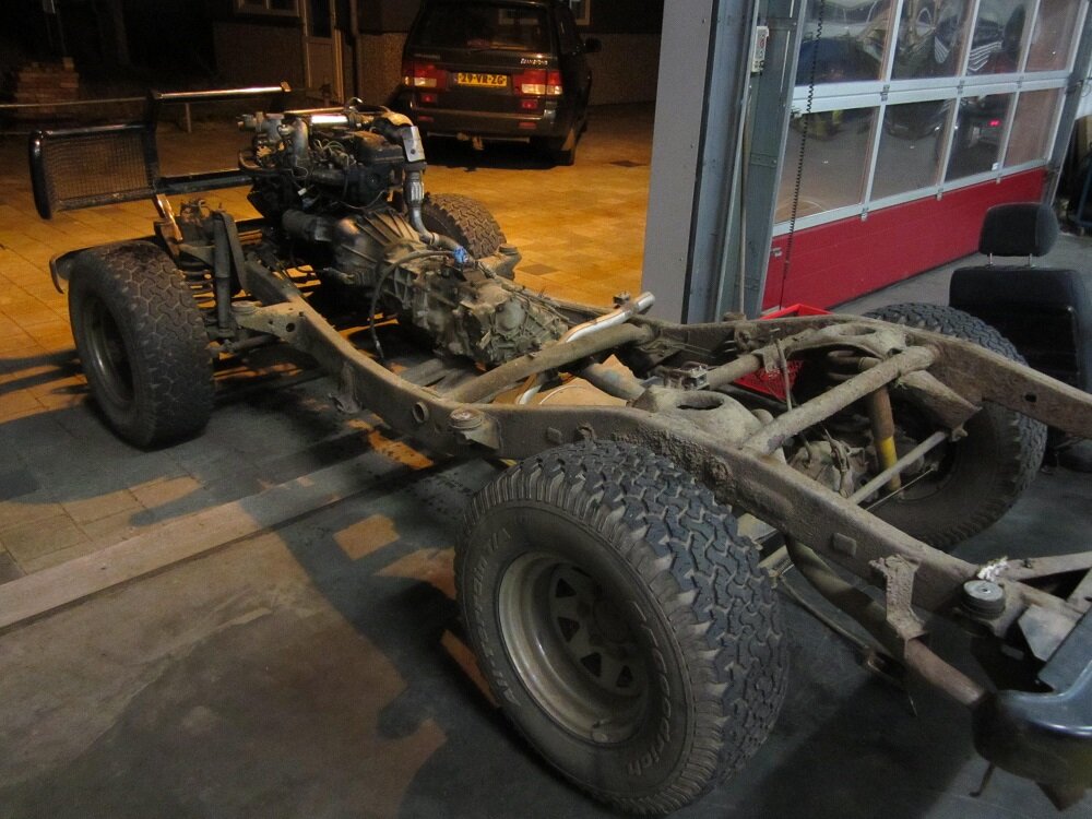

now's it was time to put the first bits on the chassis :icon-cool:
got the shocks and springs mounted
rear end

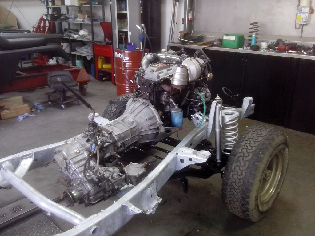

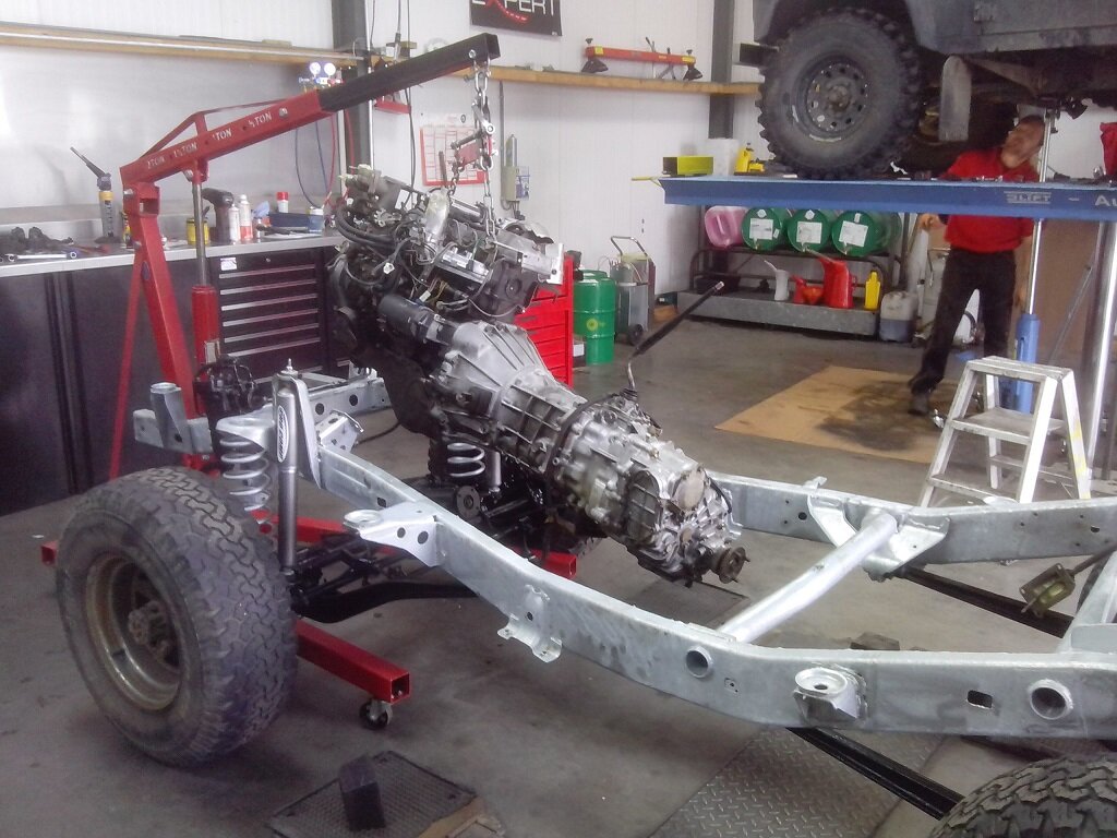

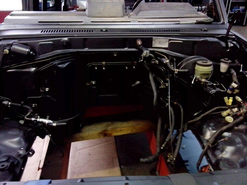

droped the "broem broem thing in "

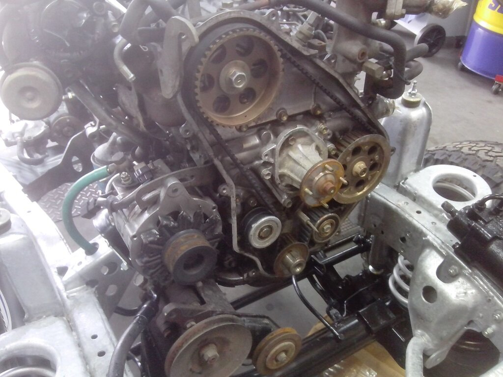

engine and tranny in place :icon-biggrin:
put on a new timing belt, easy acces
from this:
to that:
