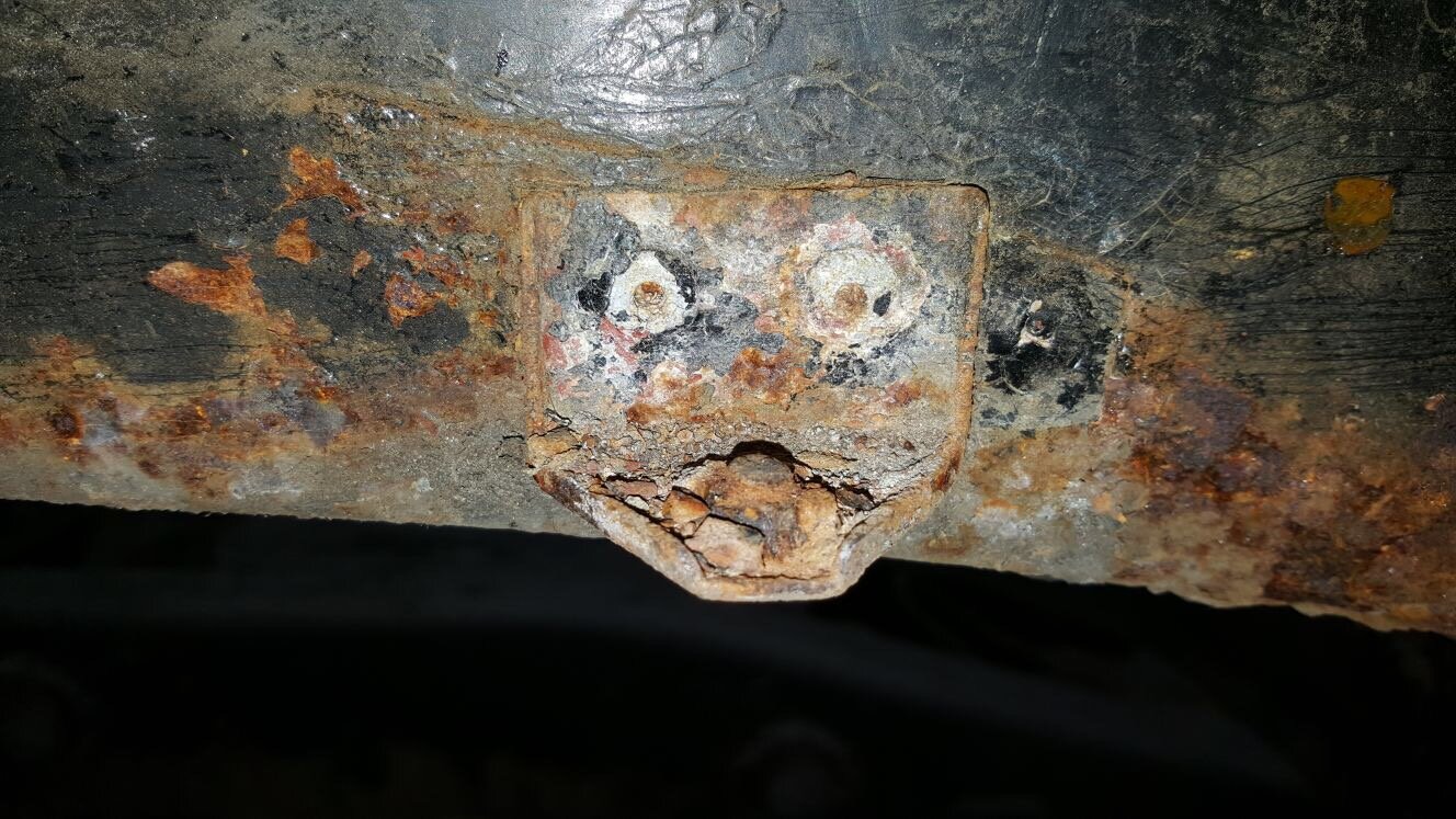

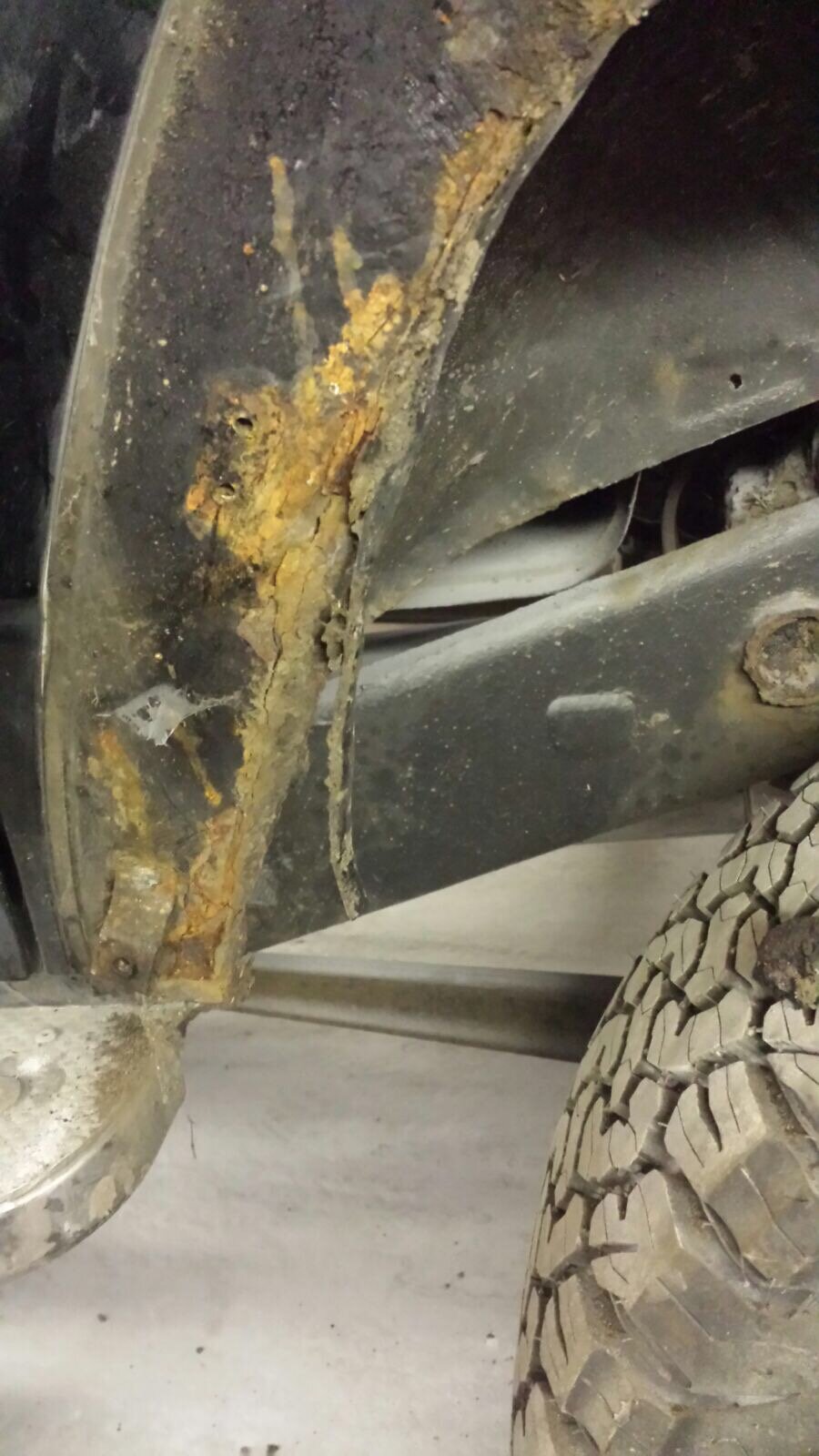

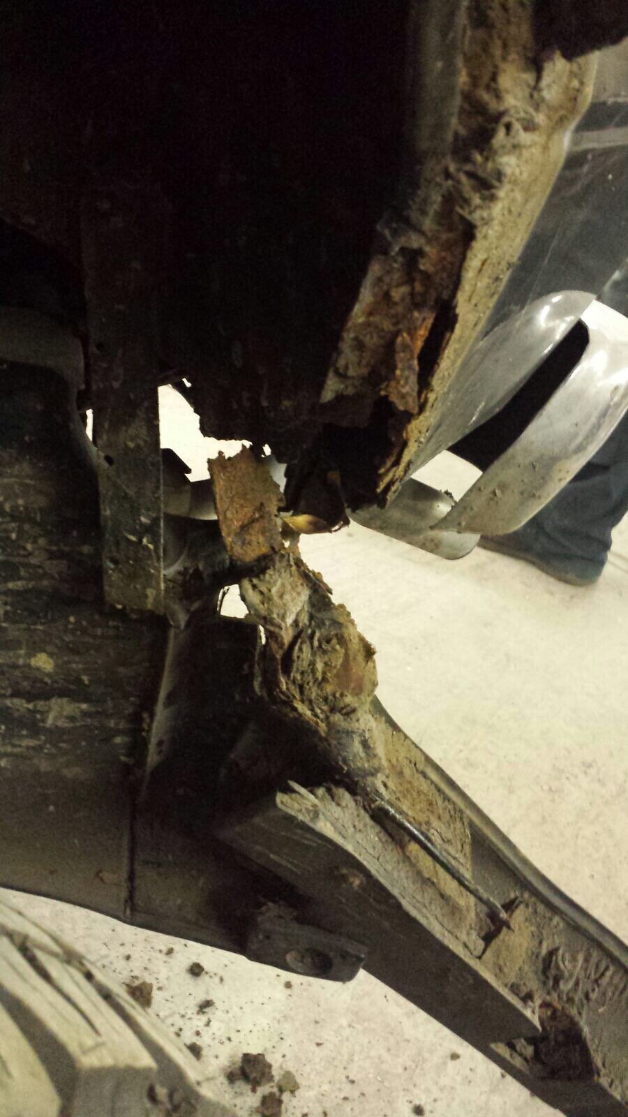

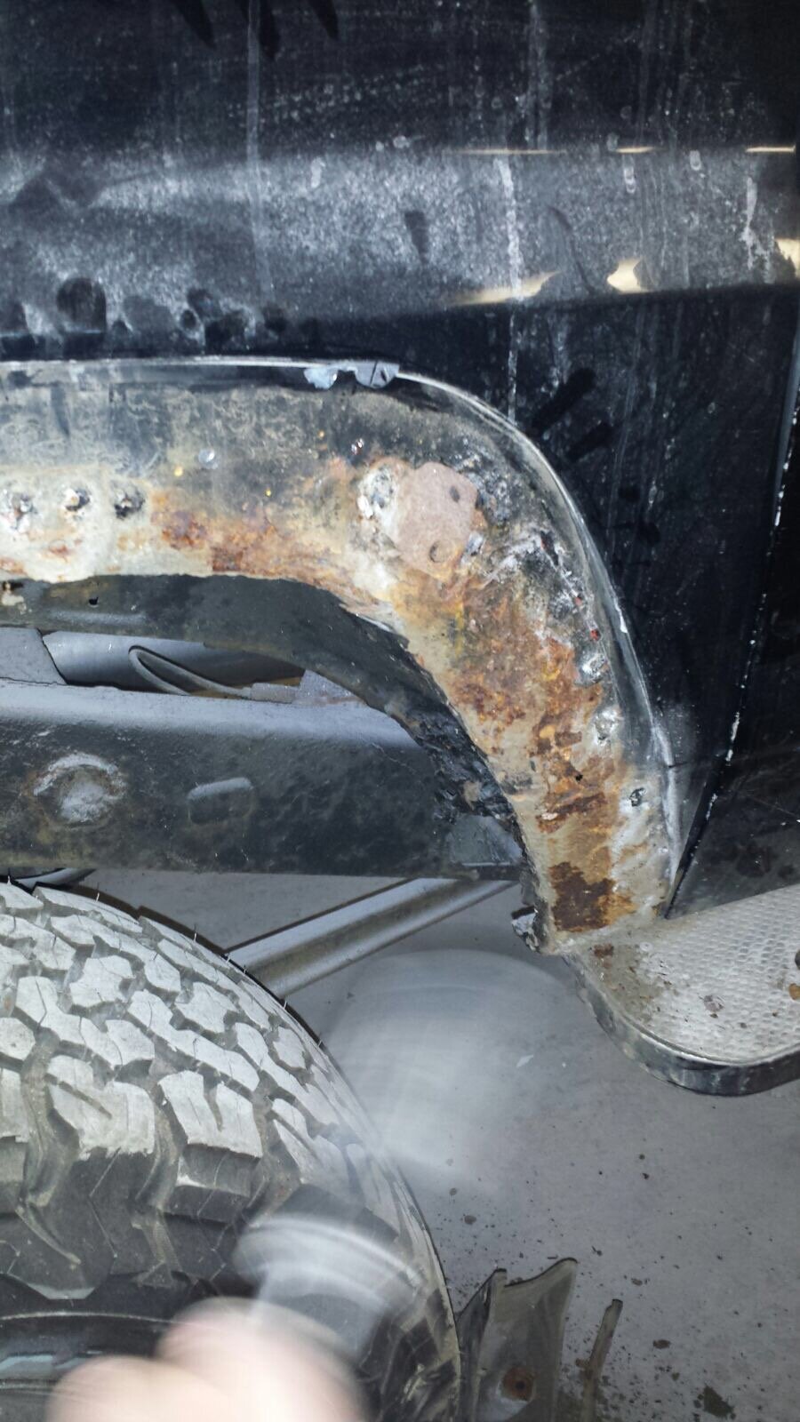

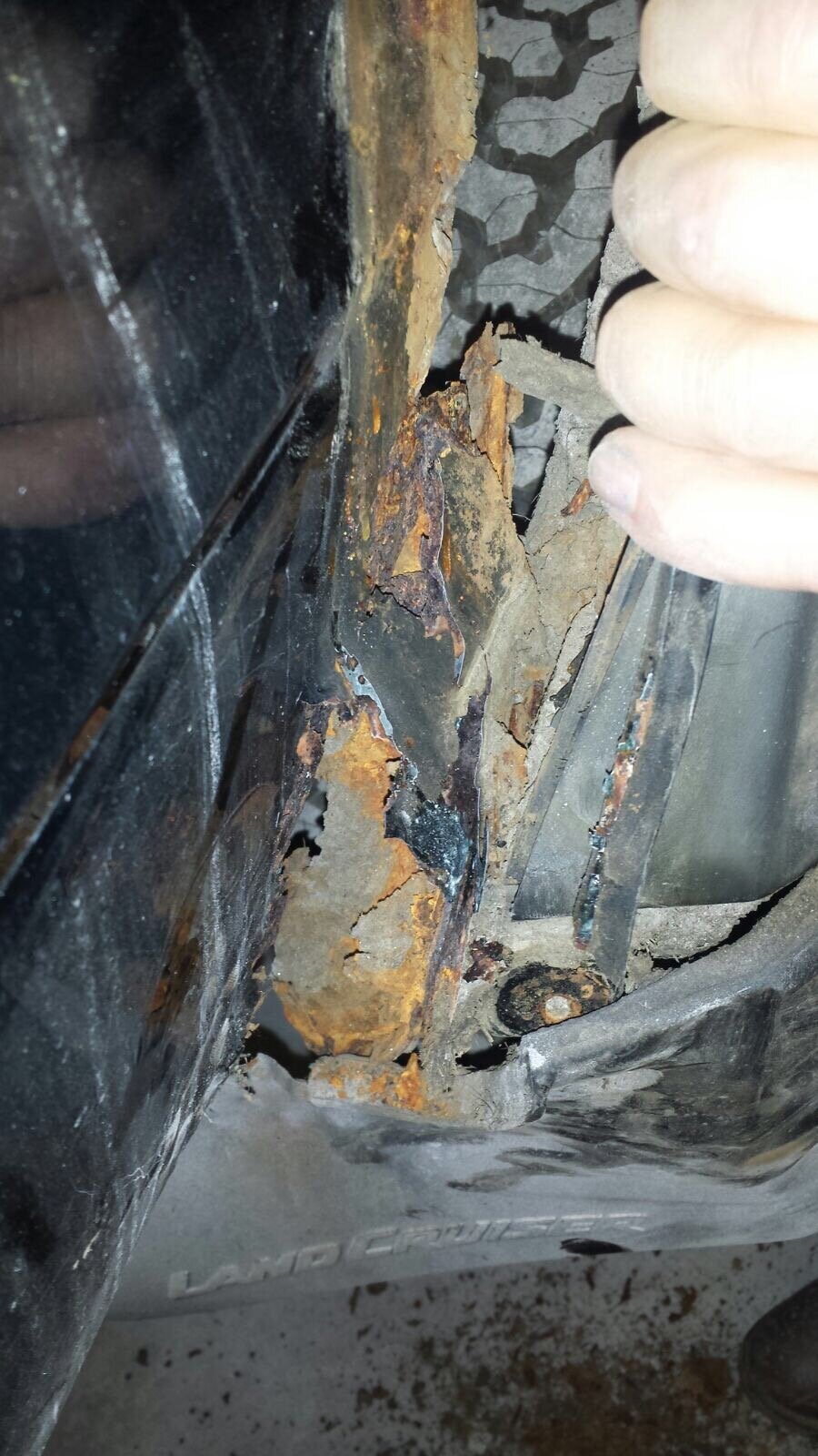

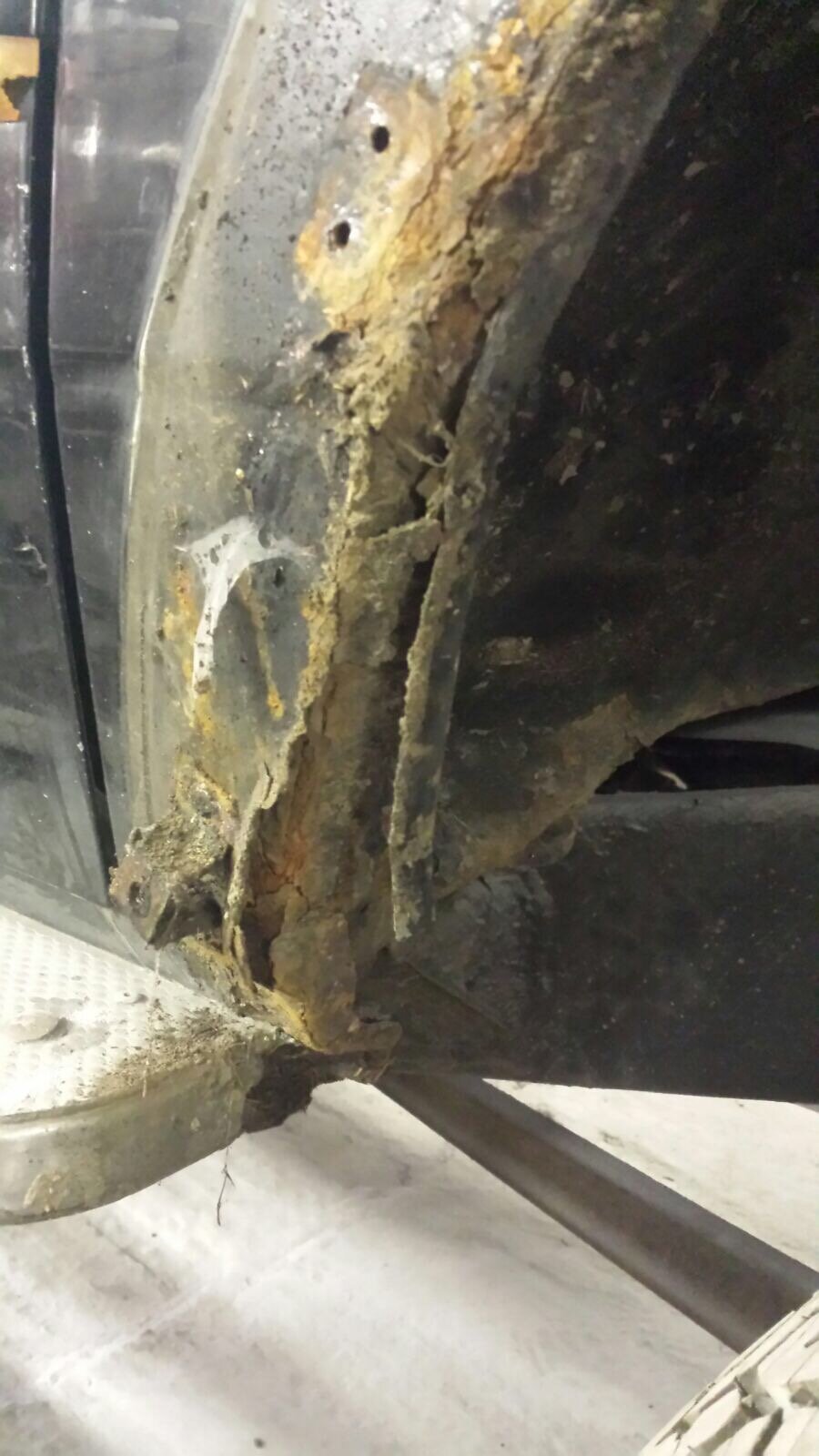

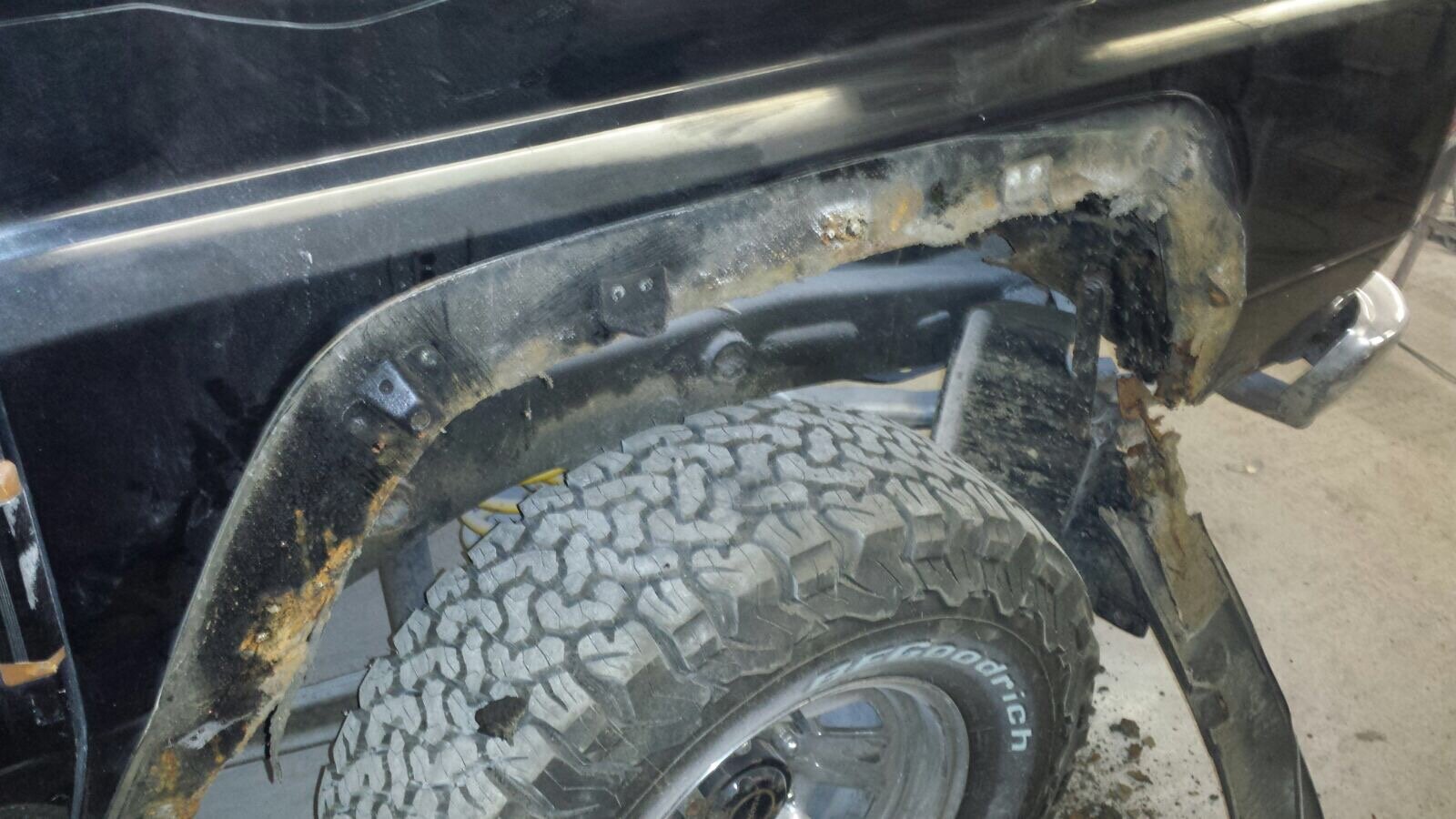

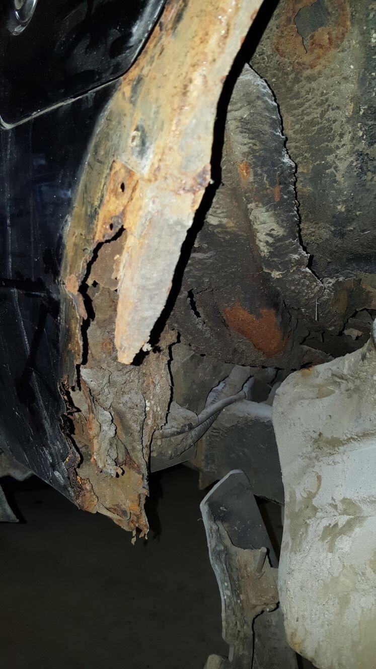

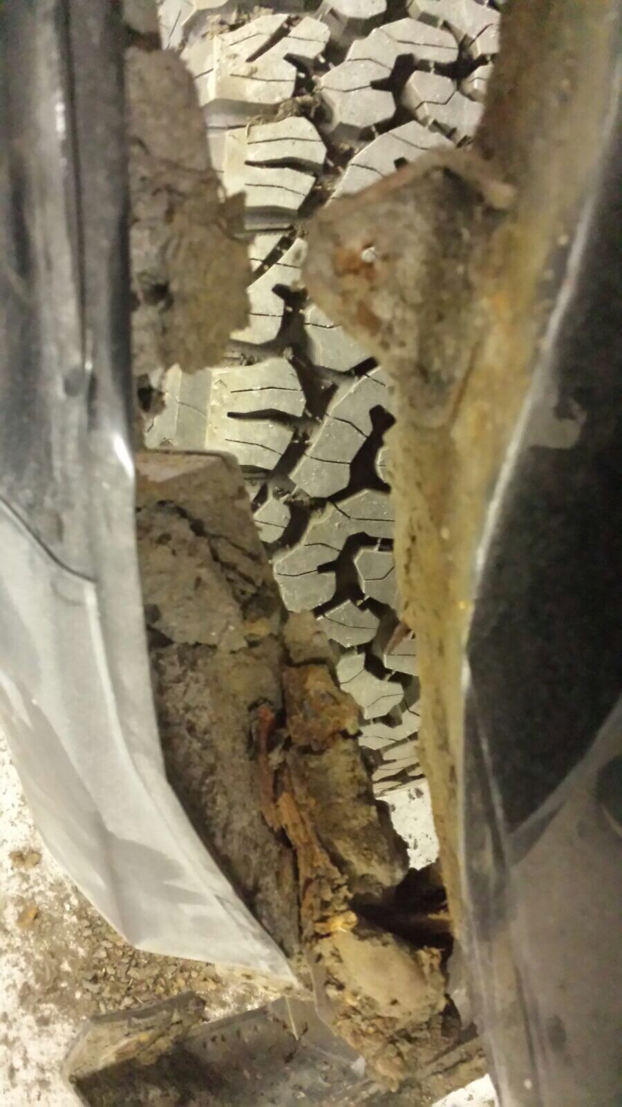

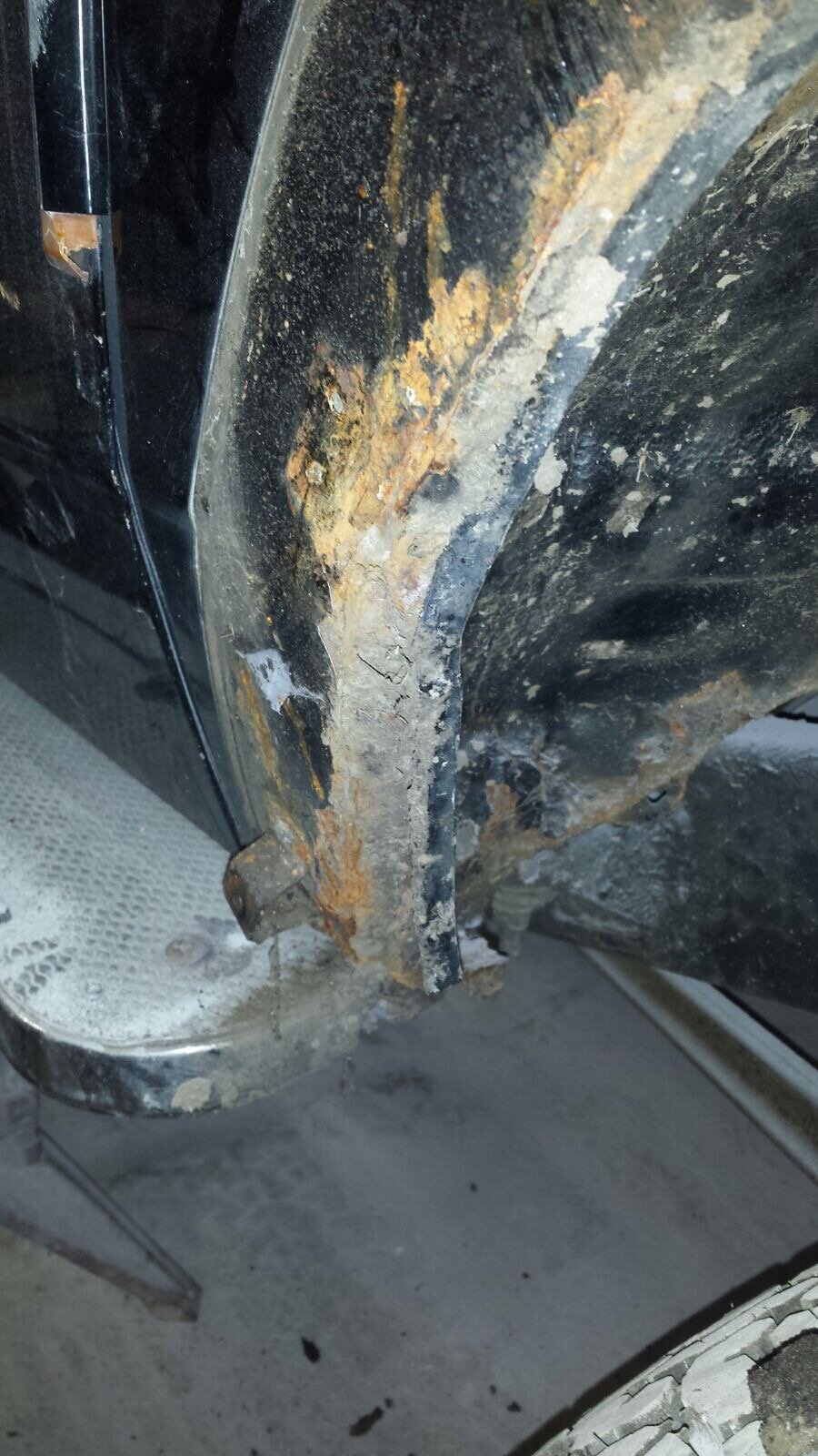

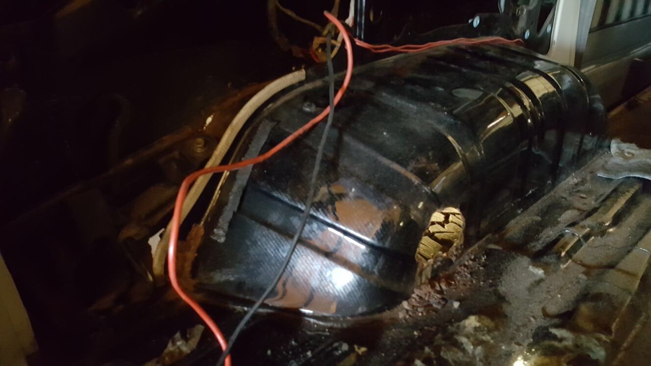

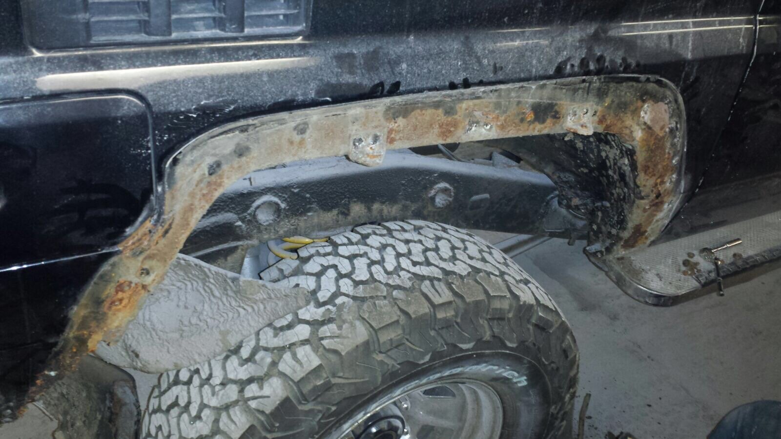

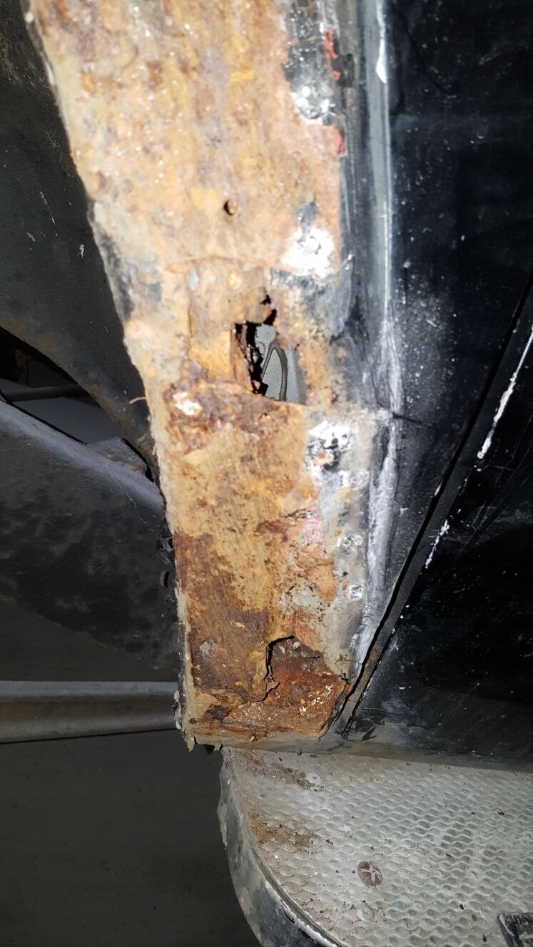

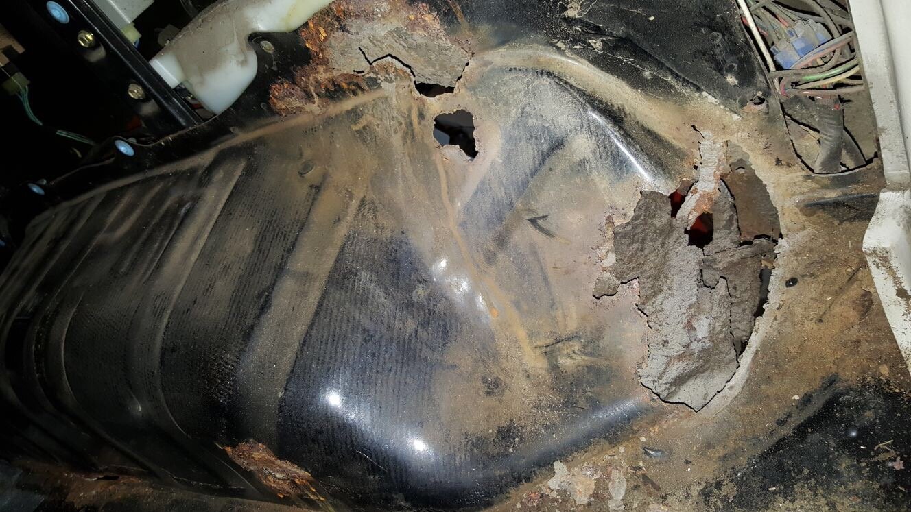

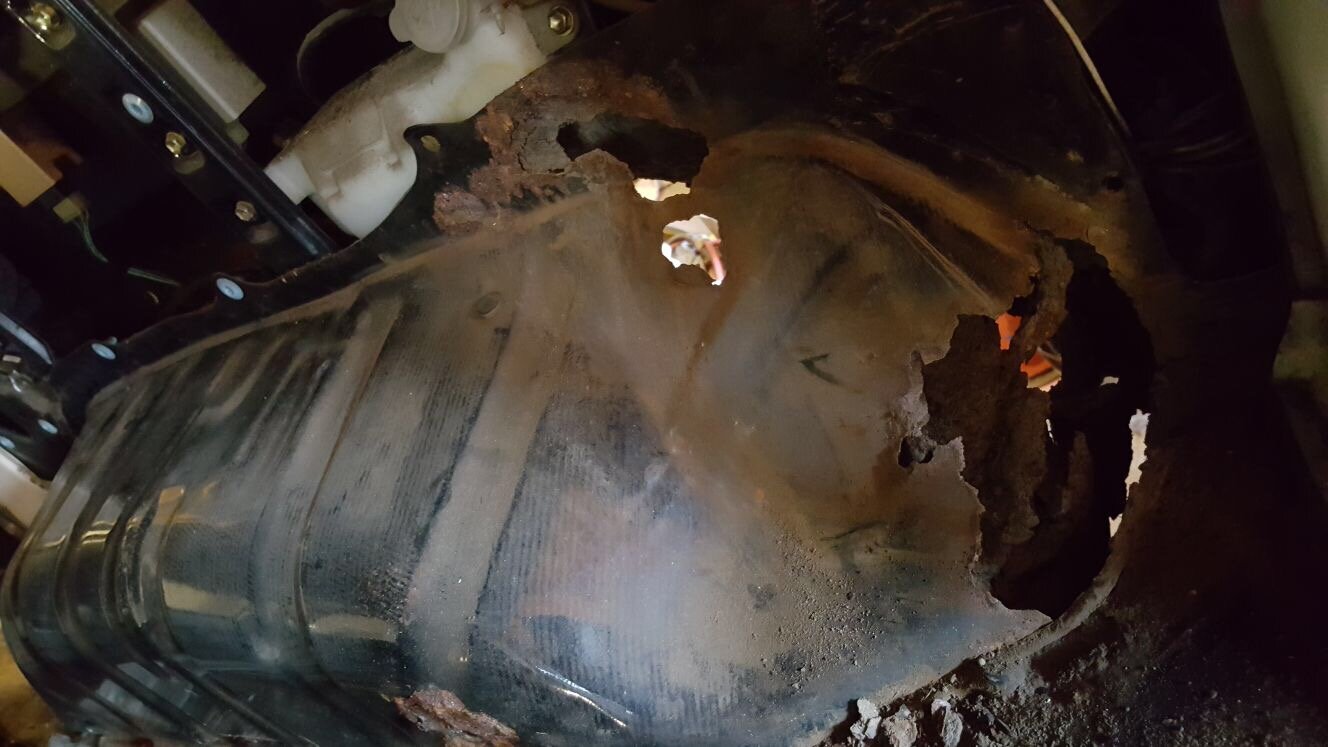

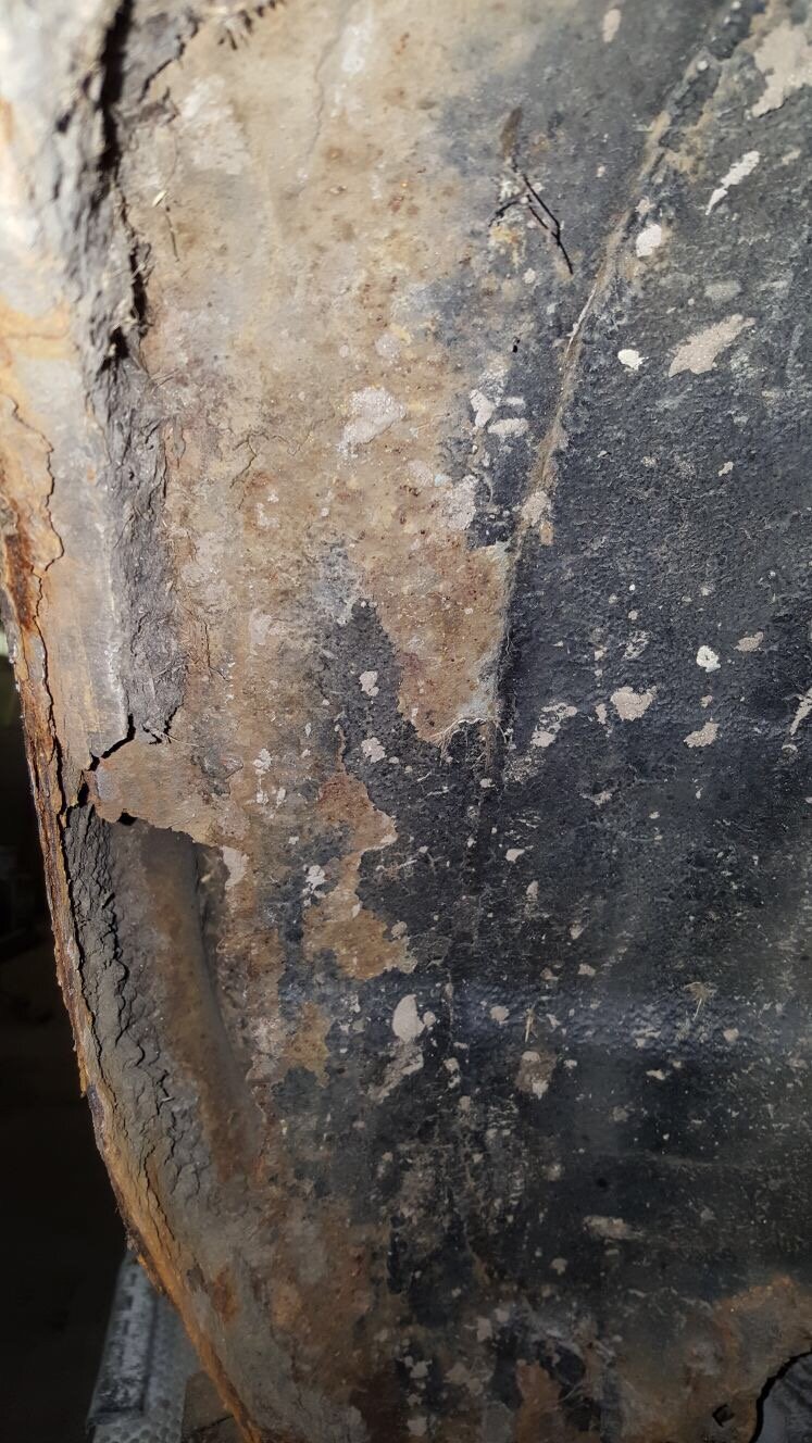

    It’s worse than I’d thought but about in line with what I’ve been hearing from others.

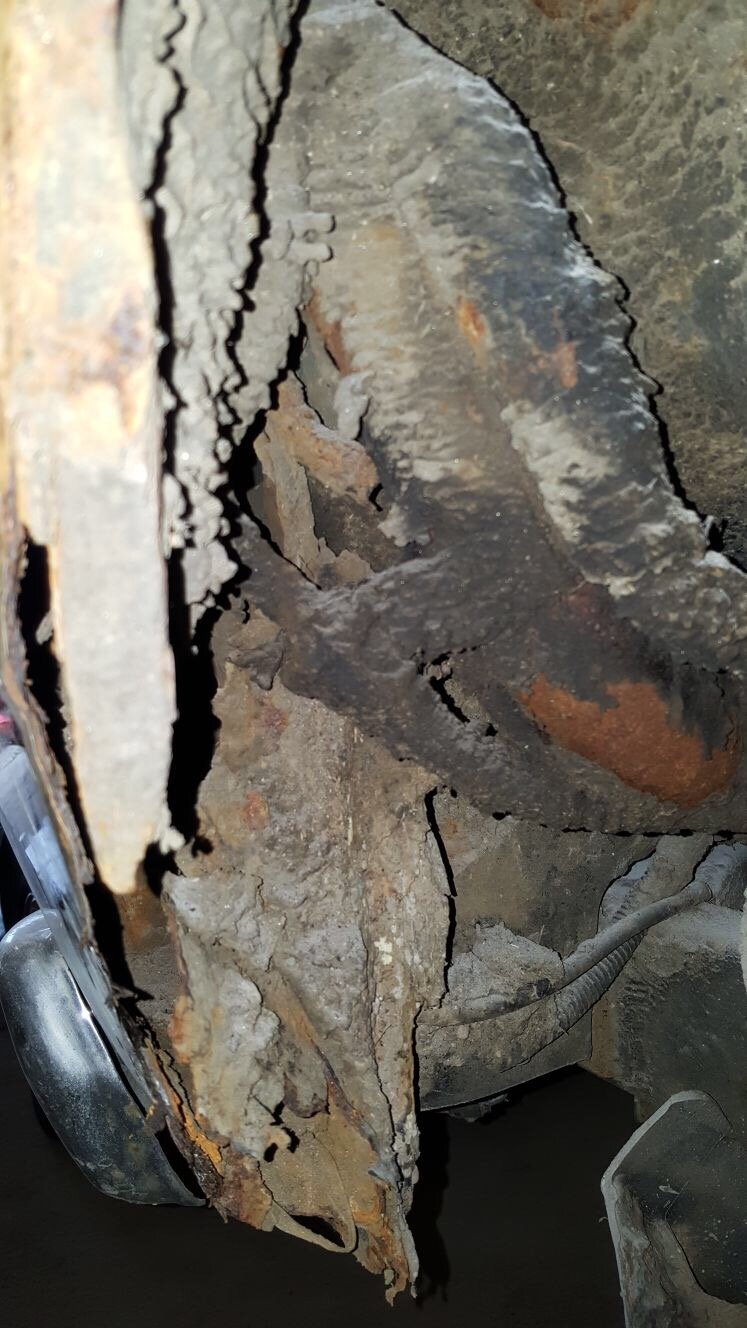

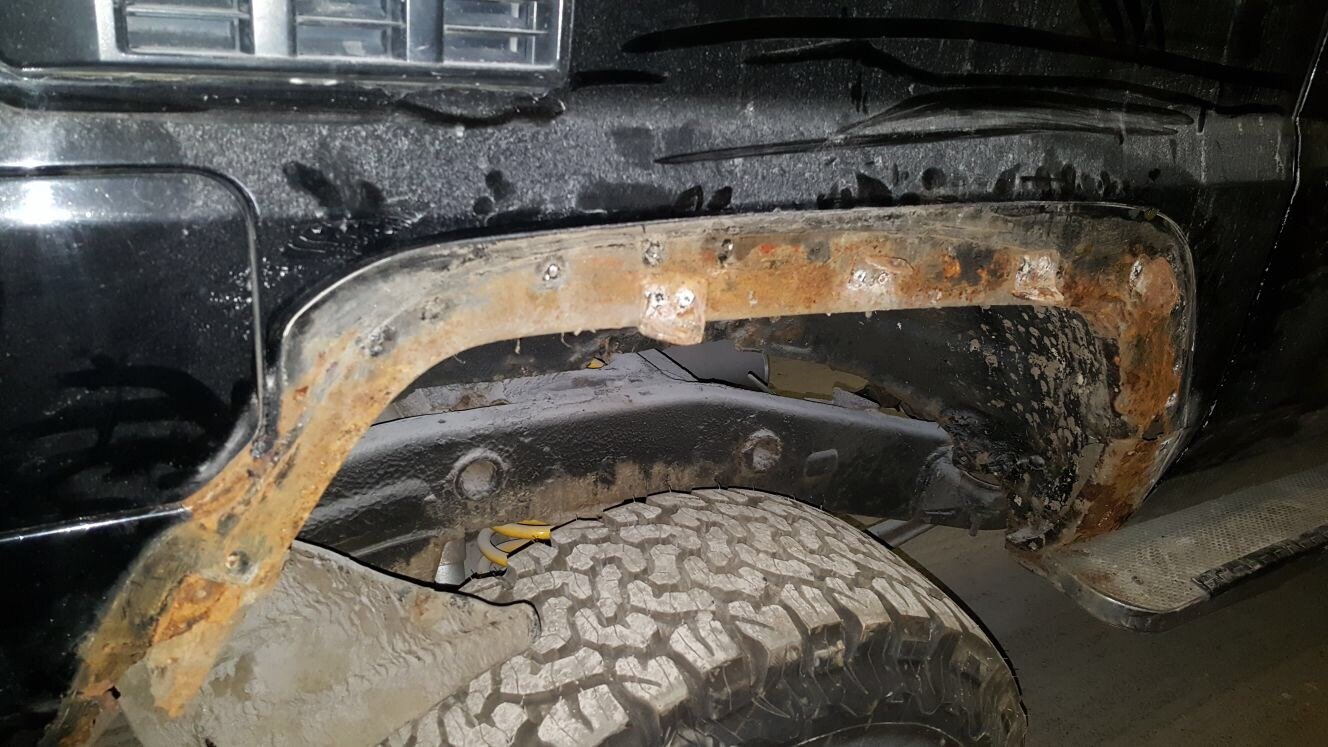

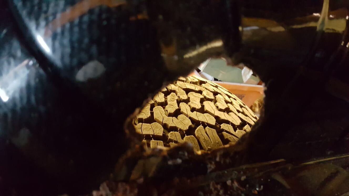

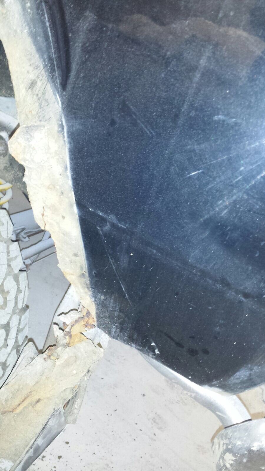

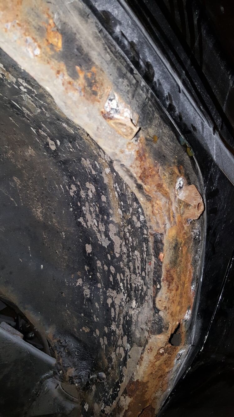

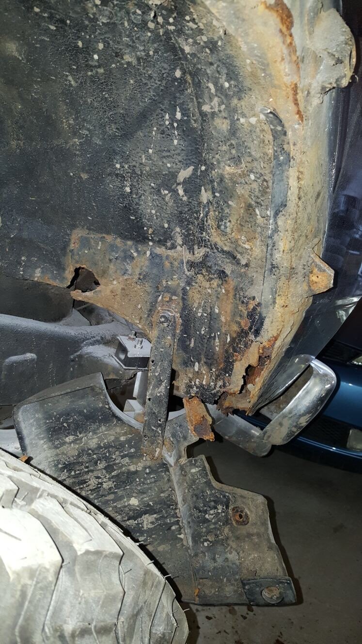

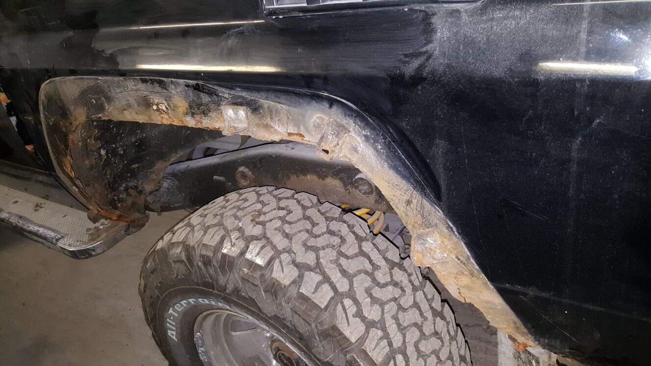

    I thought I’d show more as I will make this good, I clearly paid over the top for it but I’m in it now. It needs inner arches and two repairs panels for back arches.
    I was hoping to get it back this week. Lol

    once its done, pull the inner panels from inside the truck and waxy oil it. Mine was repaired for similar damage probably when I bought it, but I went ahead and sprayed all panels, inside fenders, hood, sills, doors.
    waxyoil will drip and stink for two weeks, but then its ok…:)

    There's guys on here that have had problems with Waxoyl trapping in moisture and not halting the rusting. Look at Krown as a similar product that expels moisture as it goes on.

    are you going to replace the rear aches of just not bother putting new ones on I like them without to be fare.

    As far as I understand two repair sections for both rear sides have been ordered and two inner wheel arches. It’s adding up now!!!
    The plastic arches are all ok but some of the brackets need replacing. He got a quote from Toyota for all four and quote for brackets alone came around £300. I haven’t ordered those.

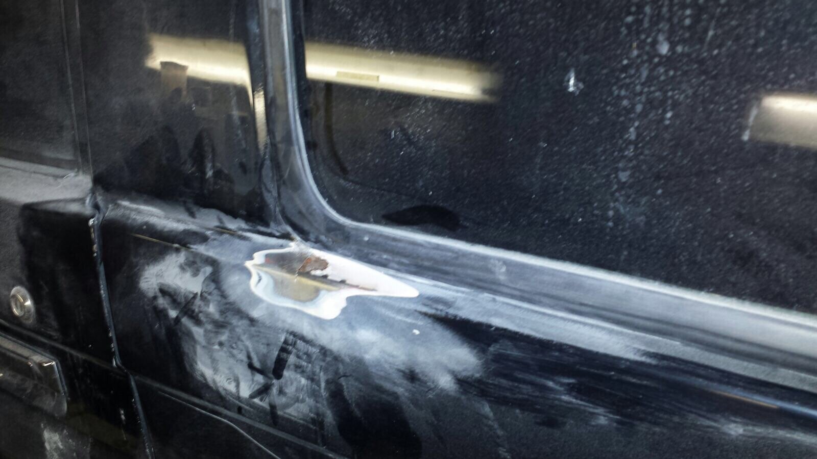

    Once a welder starts working on the arches, side windows and front window, New windscreen, headlining and a full respray it’s going to stand me in around £11k to date and that’s without me paying the guy who’s organised it all or repairing some mechanical issues. Had I of seen the car I’d of probably walked away or bid £2000. Bloody eBay :) I blame myself the most but the seller was a lying sack of shit. Poor judgement on my part but I do believe in Karma.
    After the work on the arches it really wasn’t an option to leave the window surrounds if I’m going to the effort of painting the whole car and best day rate we could find on the welding is £200 a day around Crawley.

    Dammed rust! Is all I can say Bund! The wheel arch trims should never been fitted as they trap the salt etc and prevent people from seeing the condition underneath!
    I wouldn't even think of refitting the arches and leave it so you can easily clean and keep an eye on the metal arches.

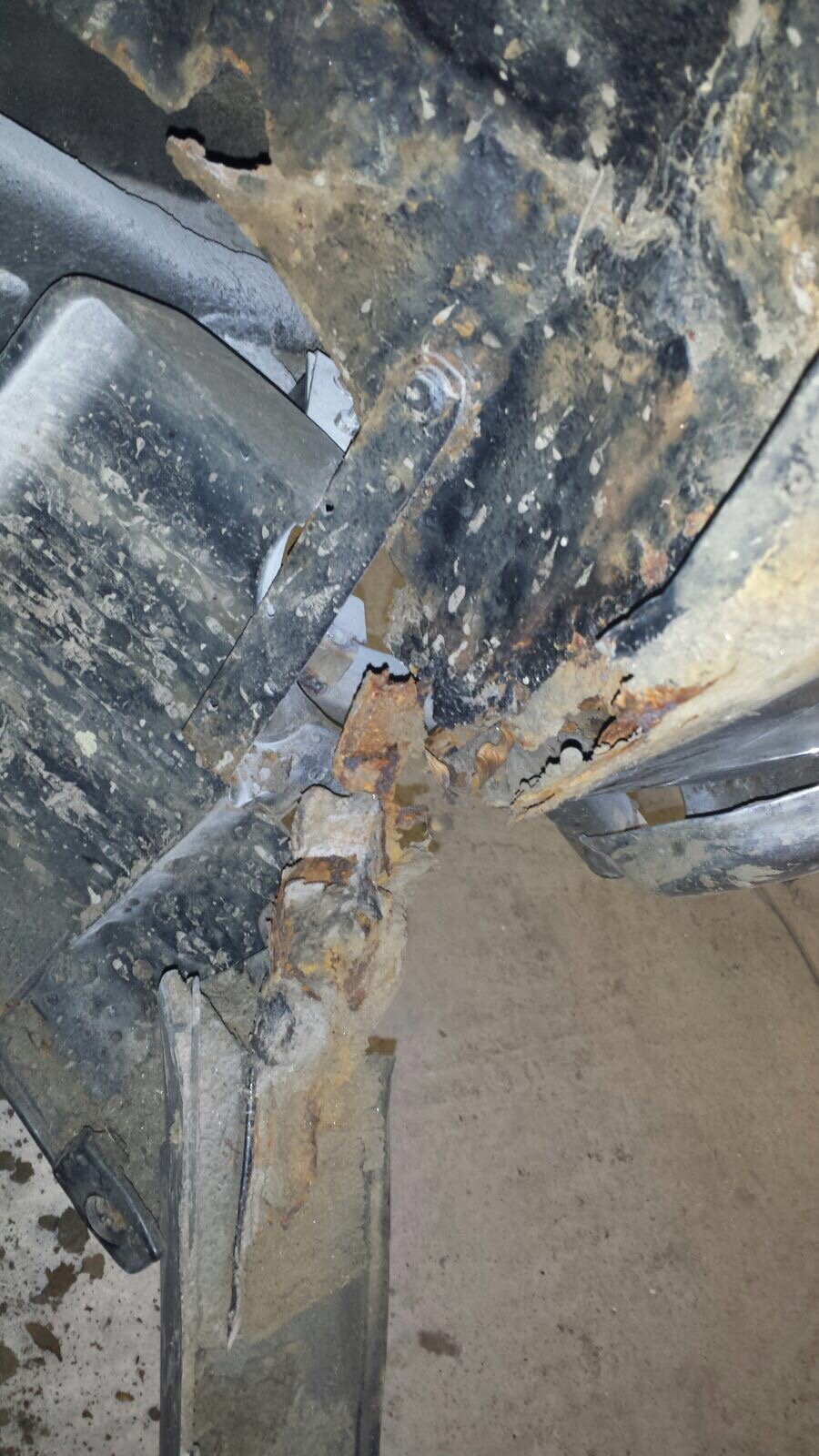

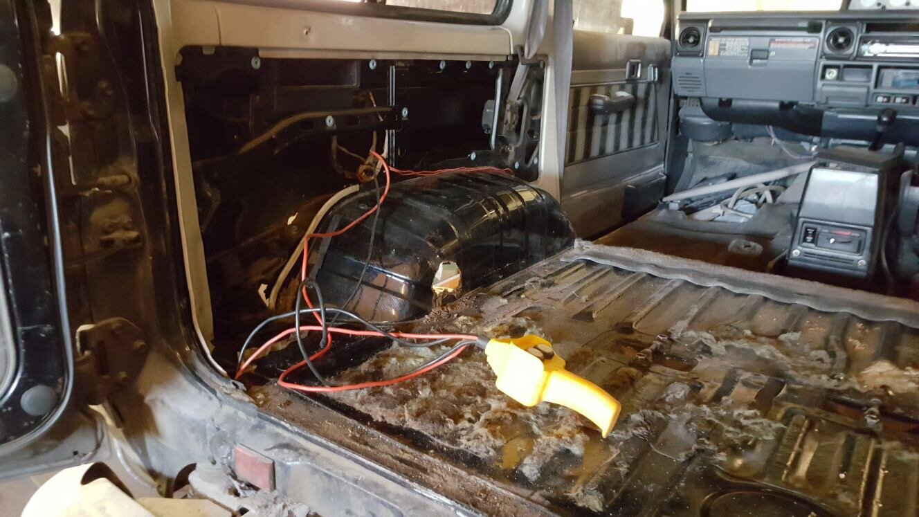

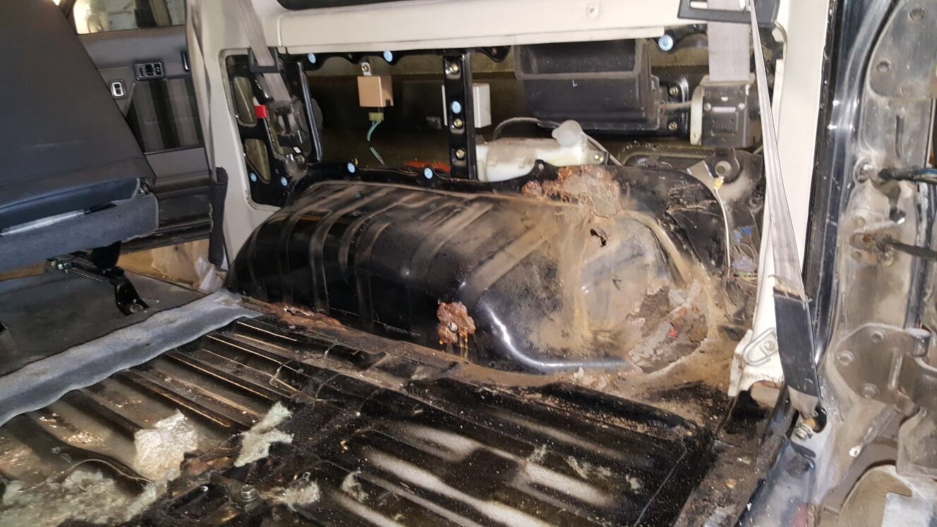

    maybe its worth looking at the condition in which the fuel filler neck is (is normally covered by a shield, but I guess welder will take that out ) and the fuel tank pipes, the ones that feed to the engine. the fuel tank ones corrode next to the tank . unless theres an inspection hatch from the boot floor one has to drop the fuel tank to replace that part. now you will have access to inspect these elements and have peace of mind later.

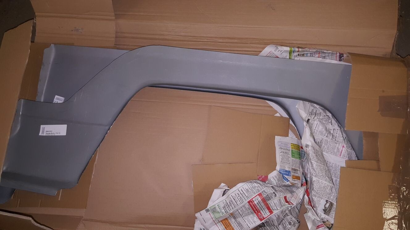

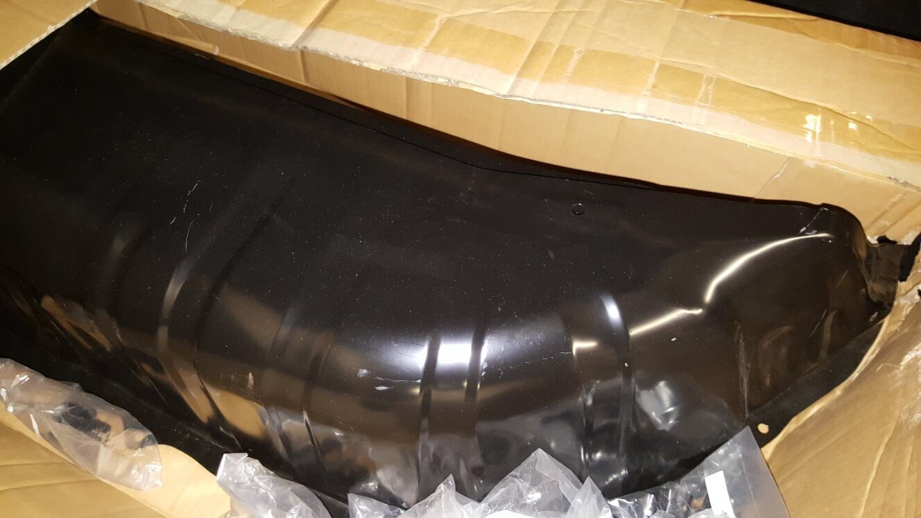

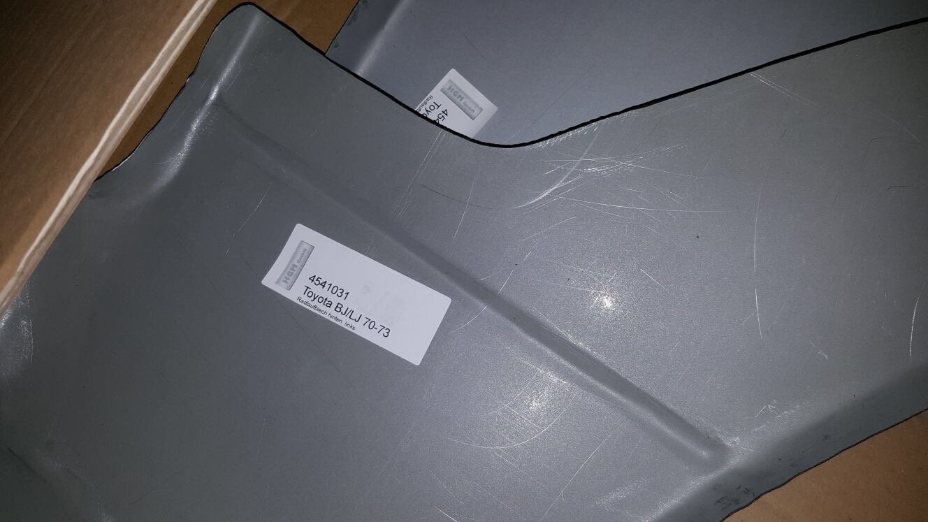

    All inner and outer panels have arrived from Japan/UAE and I think some came from Europe. Welder will start Monday. Looks like floor is solid so that’s hopefully good news.
    Definitely the worst car decision I’ve made as I haven’t the skills to help I’m paying everyone to do it. I hope it will be a great car but can’t see me getting the money back it’s costing to get it into good condition.

    Some nice new bits to go in.
