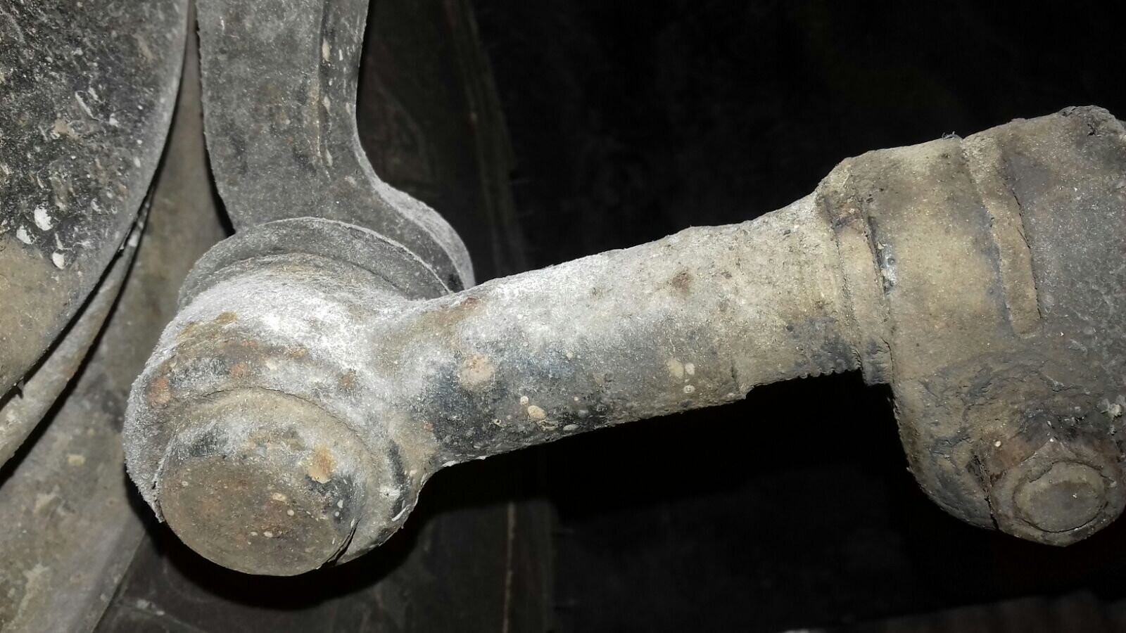

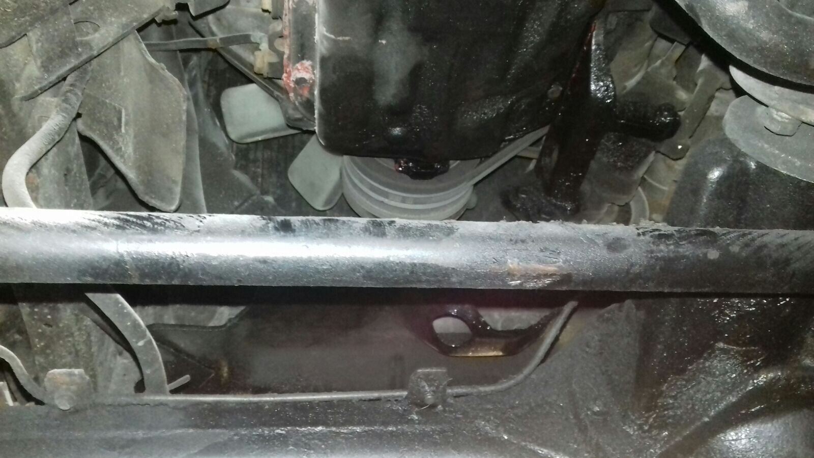

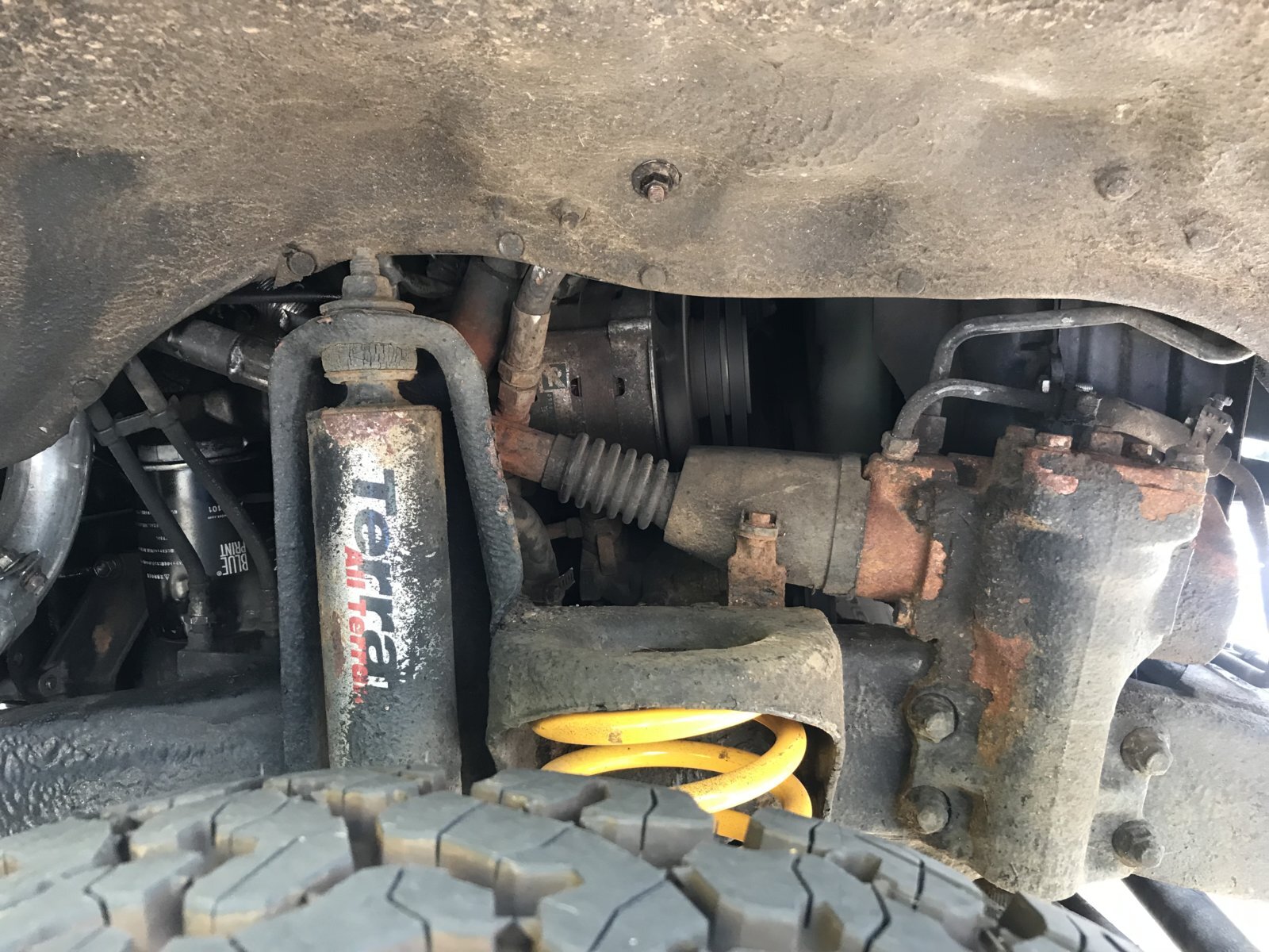

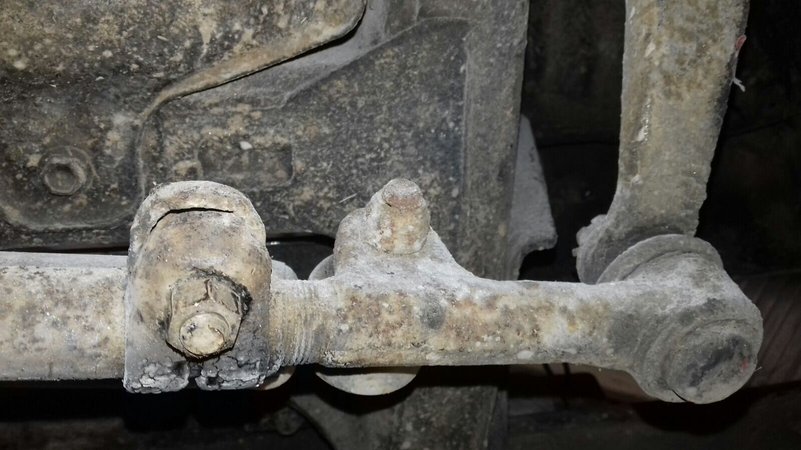

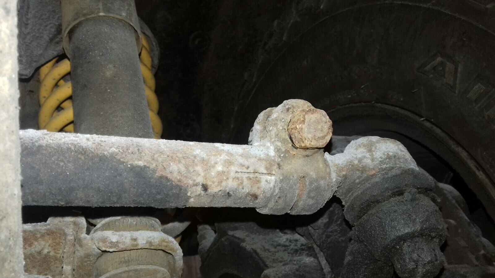

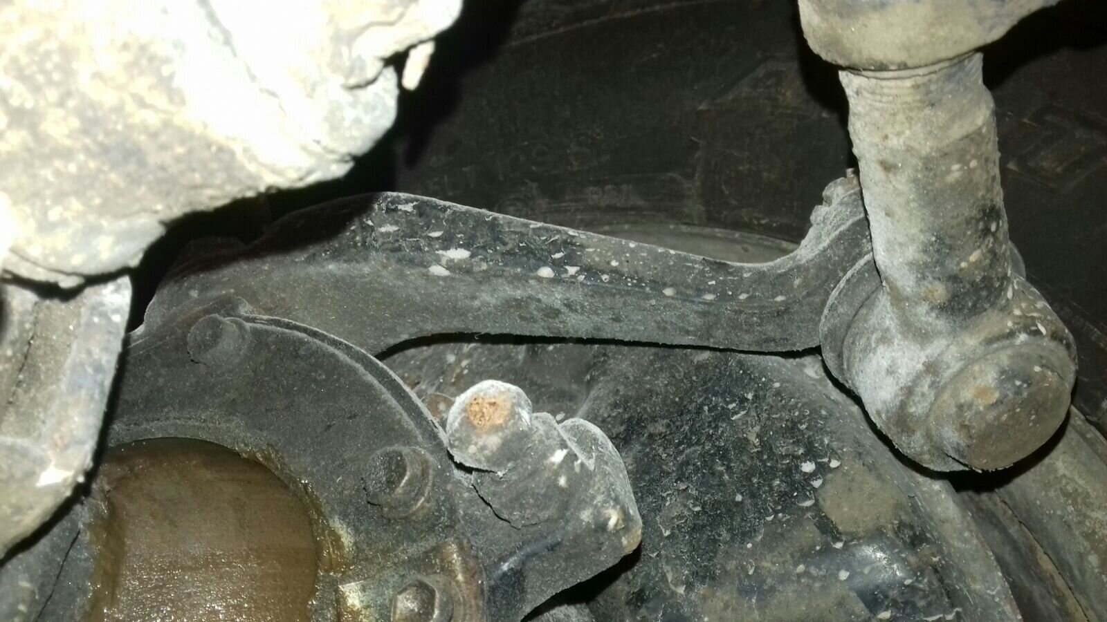

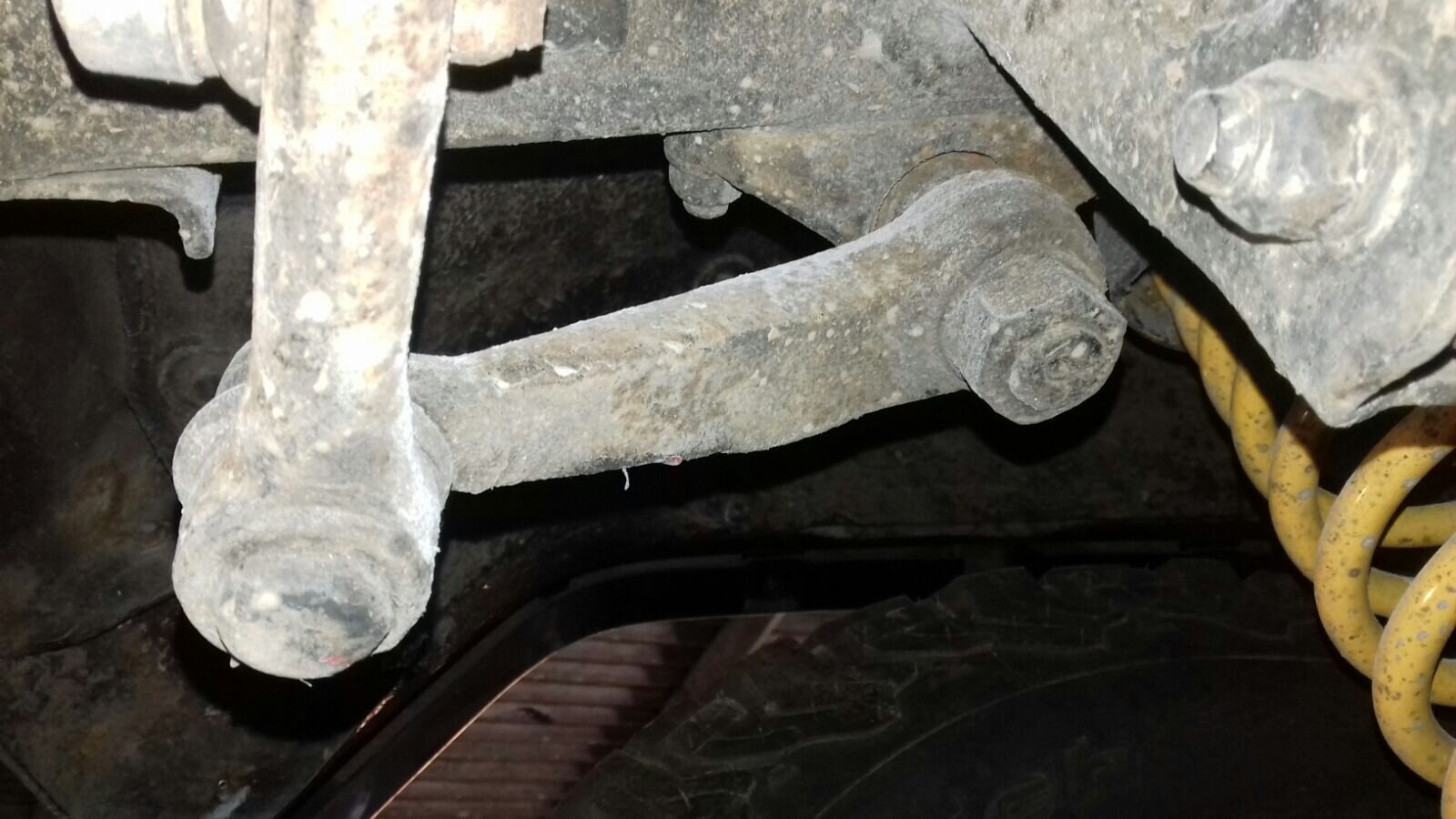

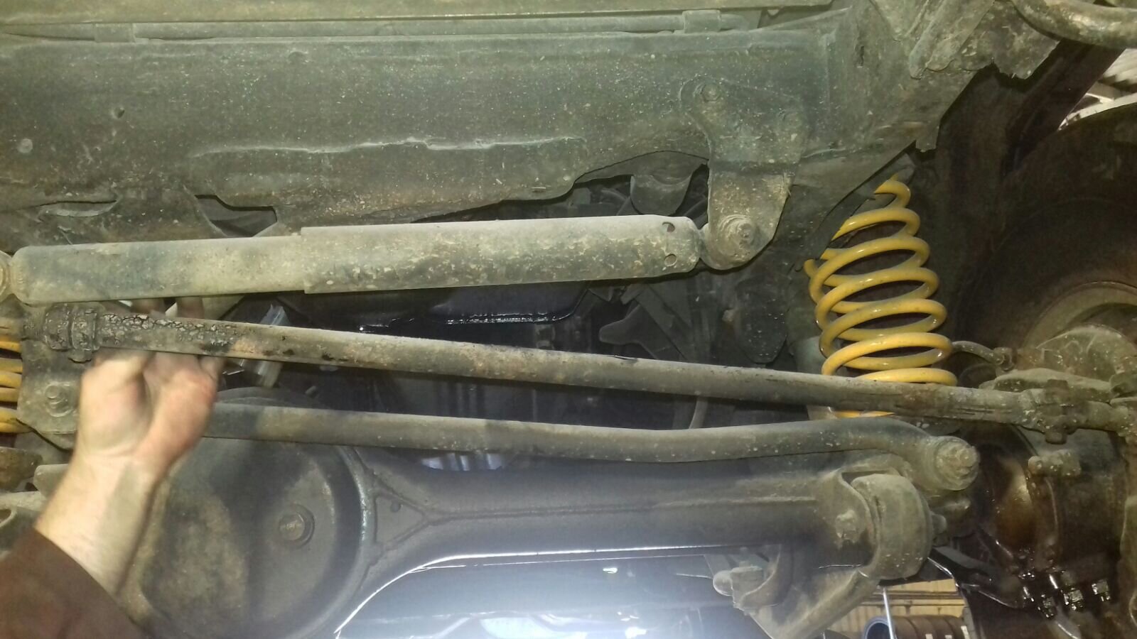

    It just keeps going :expressionless: so Cars looking good on the outside though there are mechanical issues to now address. Bens helped with the likely oil leaks and it’s going to be washed again underneath to see what’s what.
    The only time I drove the steering wheel was off centre which really upset my ocd. They take it to get it tracked at a place called tubbytyres in crawley(can’t see it as the 4/4 specialist I was told)said the rods are seized, Bens said he’s seen worse. They heated them up at the end and supposedly clamped them with a long wrench but are saying they’re seized.

    No such thing as a seized track rod thread IMO, slide the clamp off, heat it to cherry red, quench it a few times in paraffin/diesel mix if necessary and it will unscrew.
    More to the truth, they can’t be bothered.

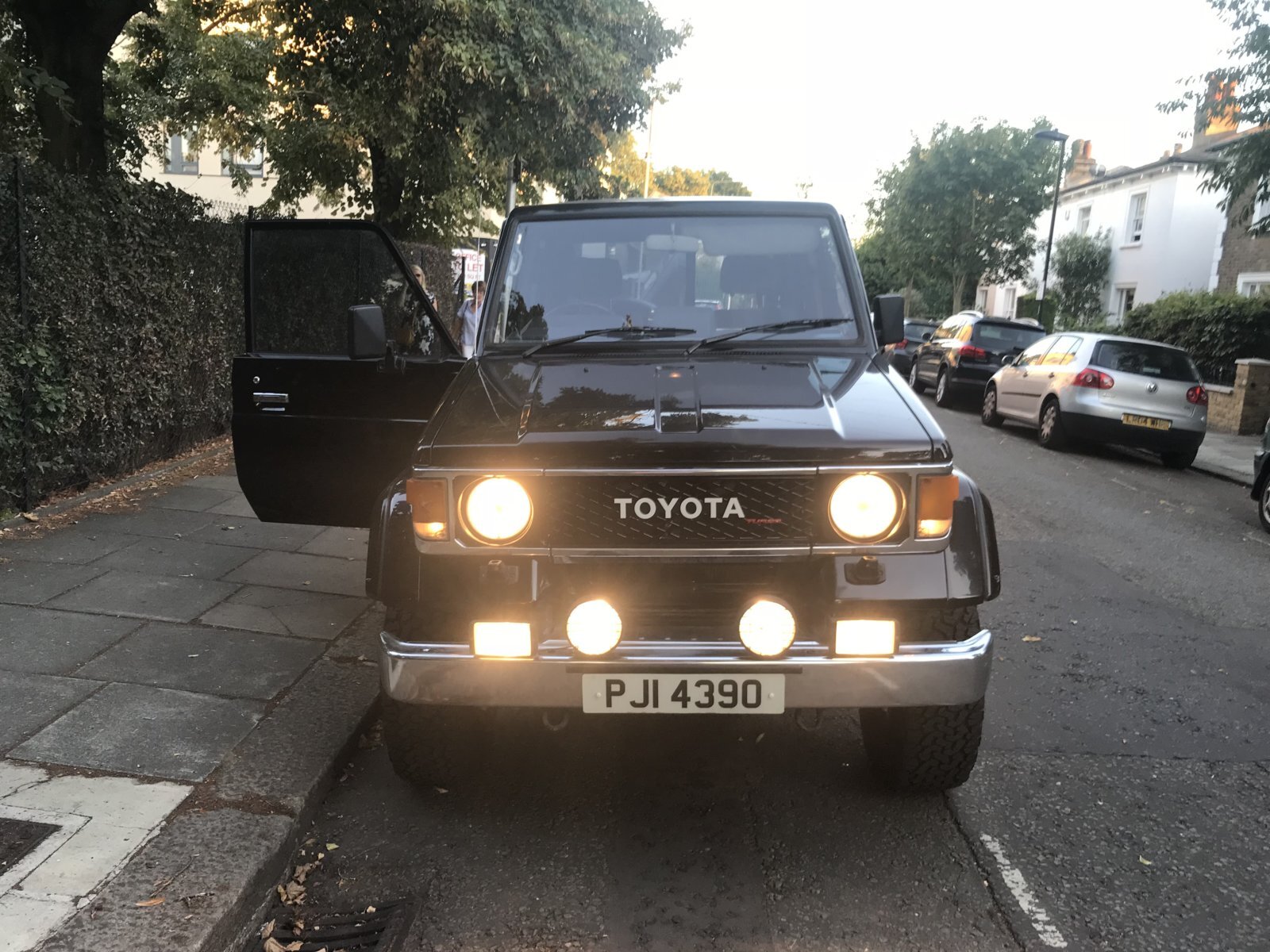

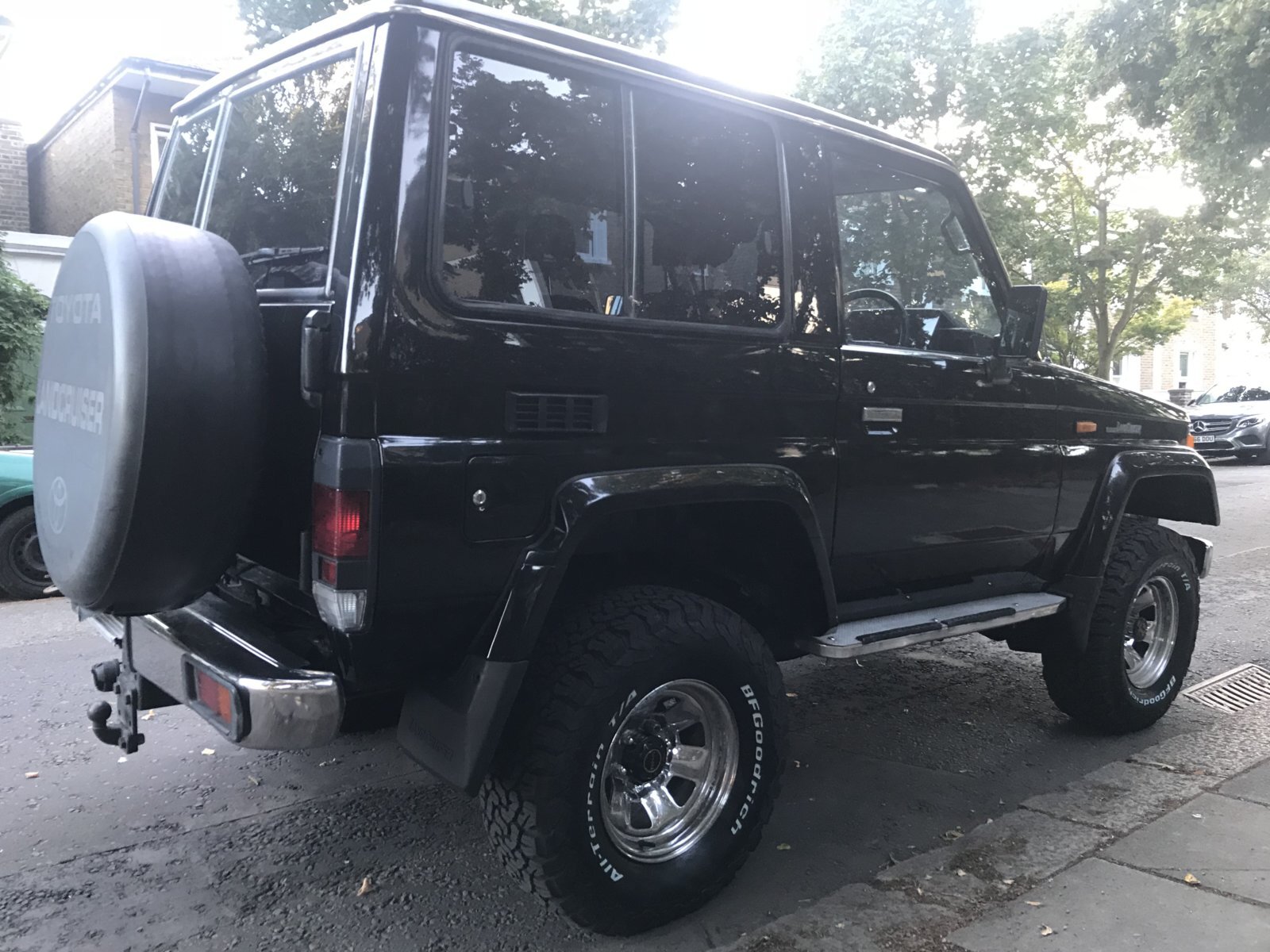

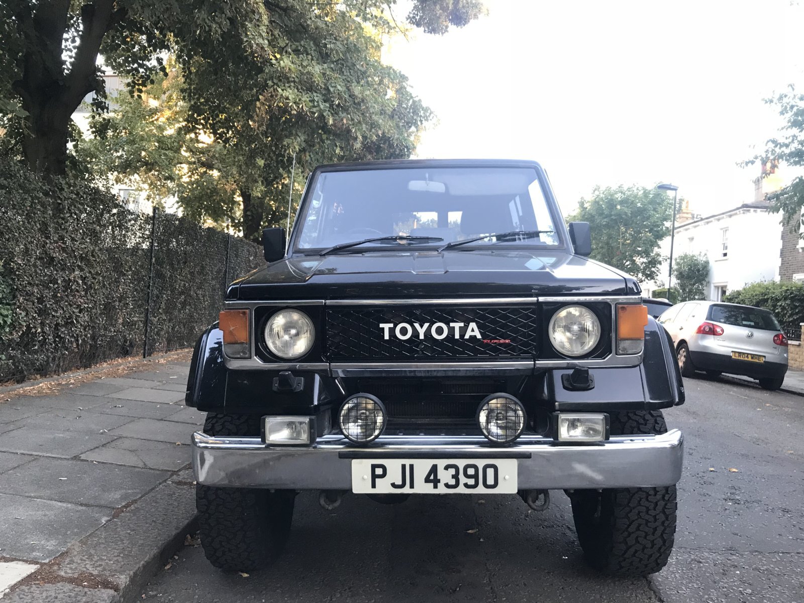

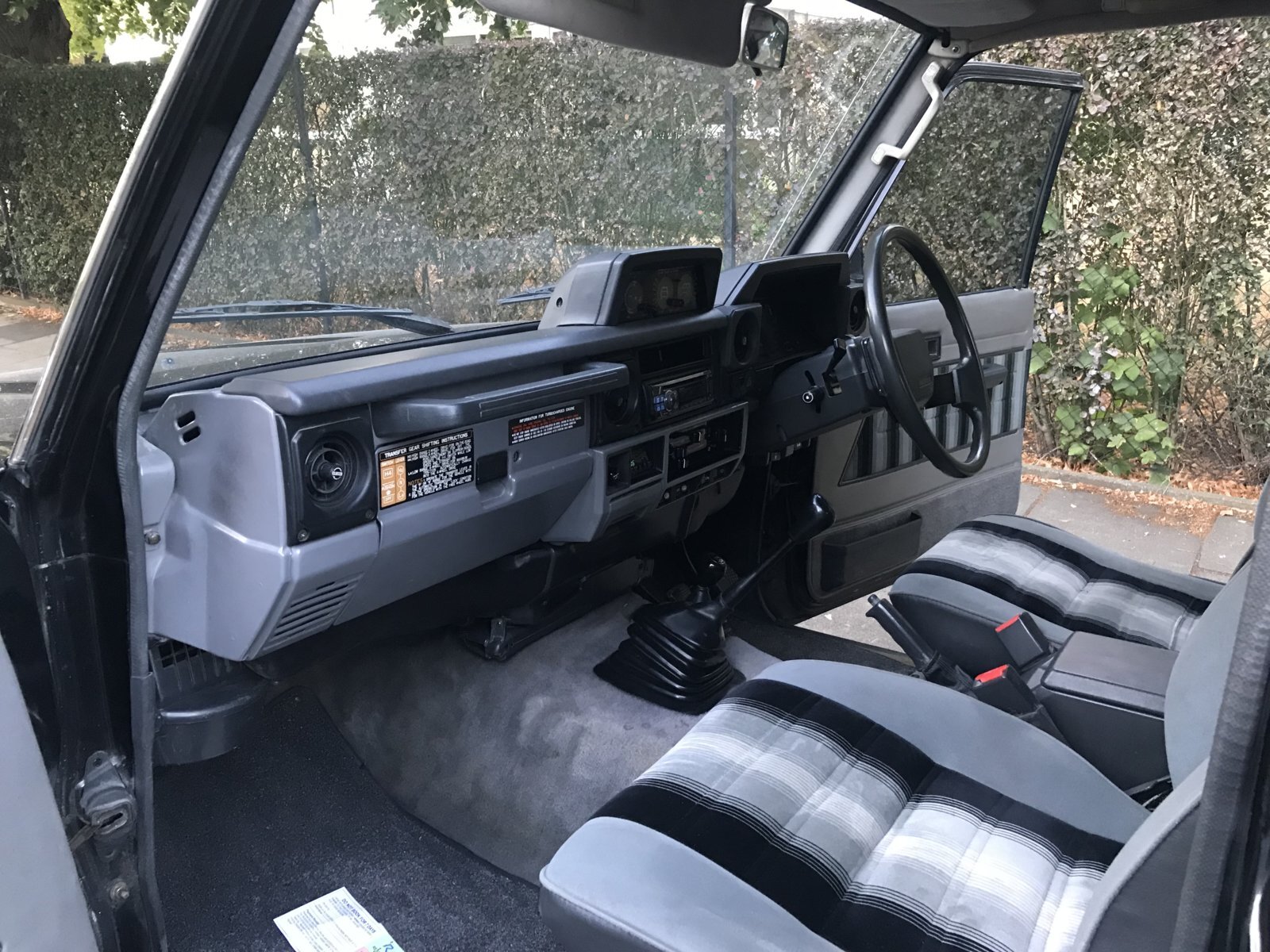

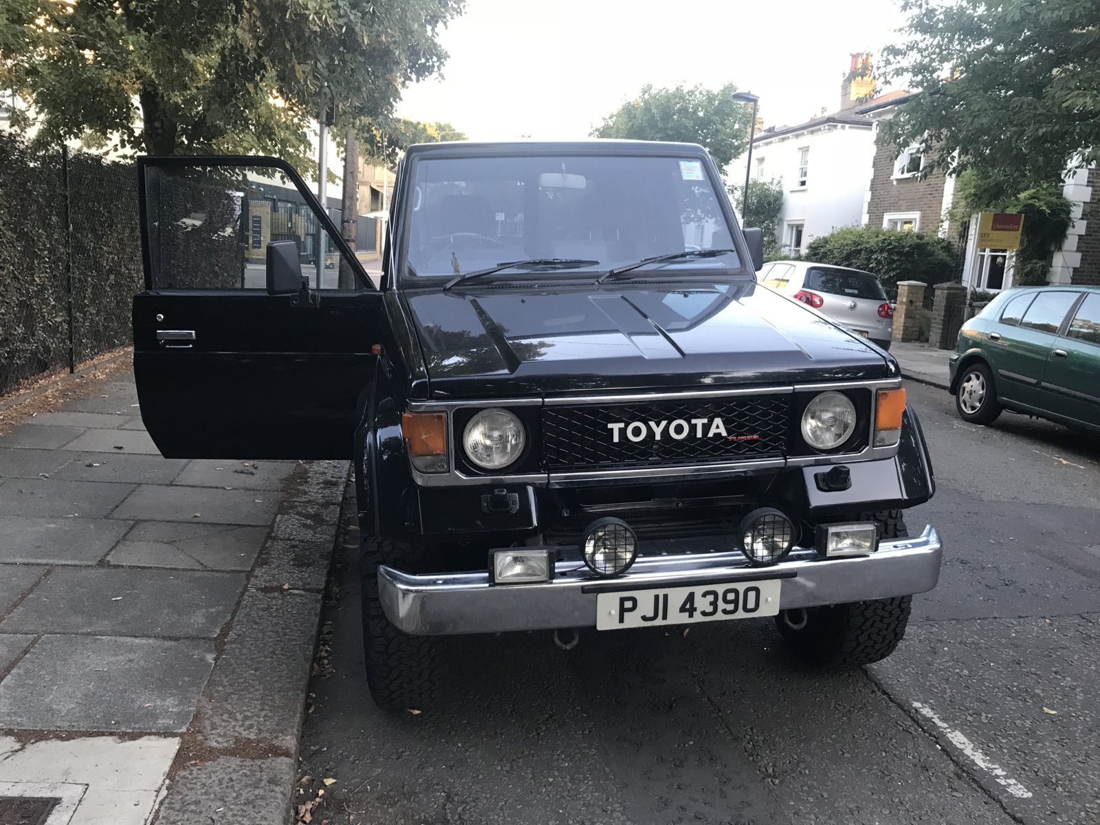

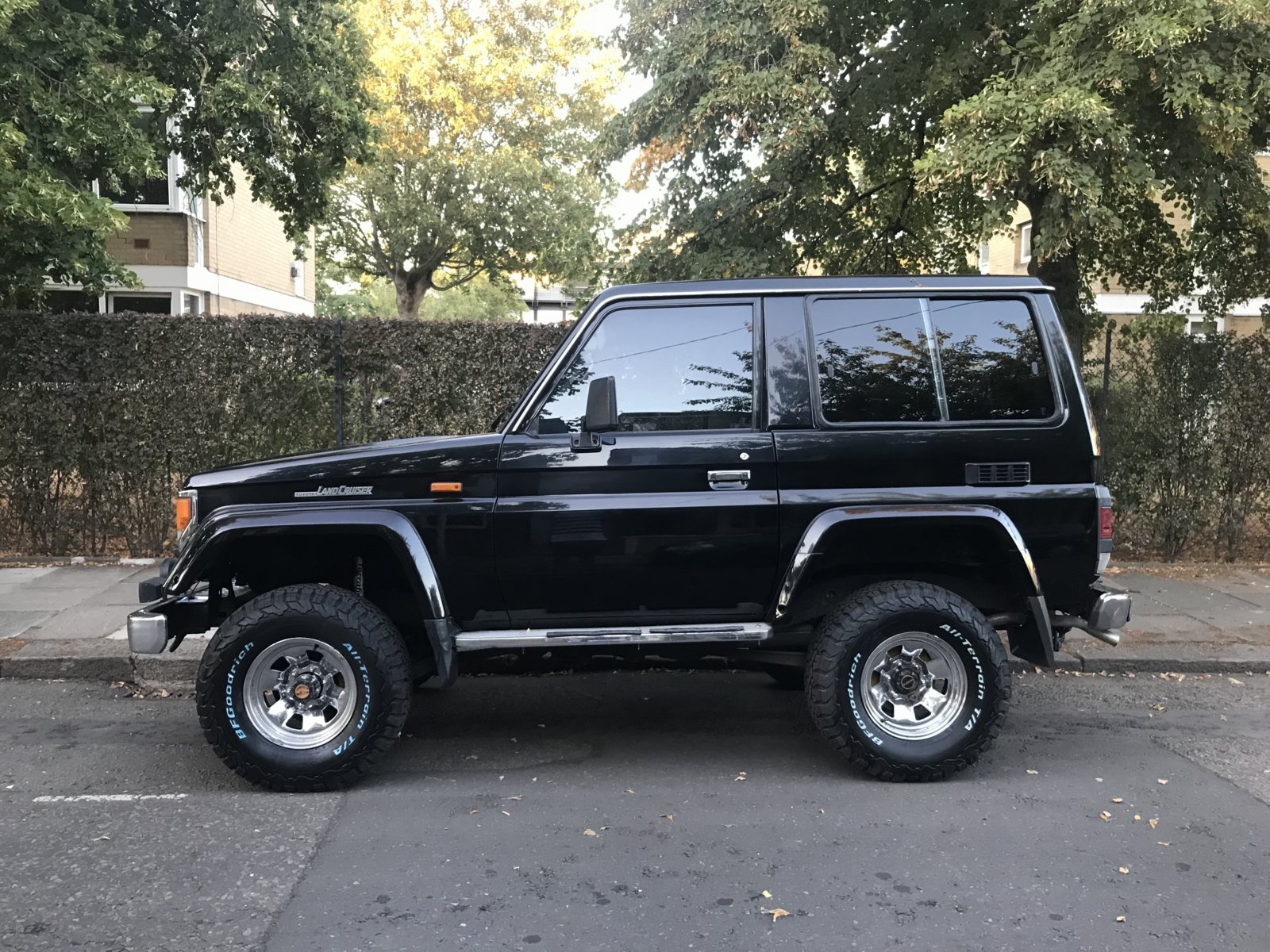

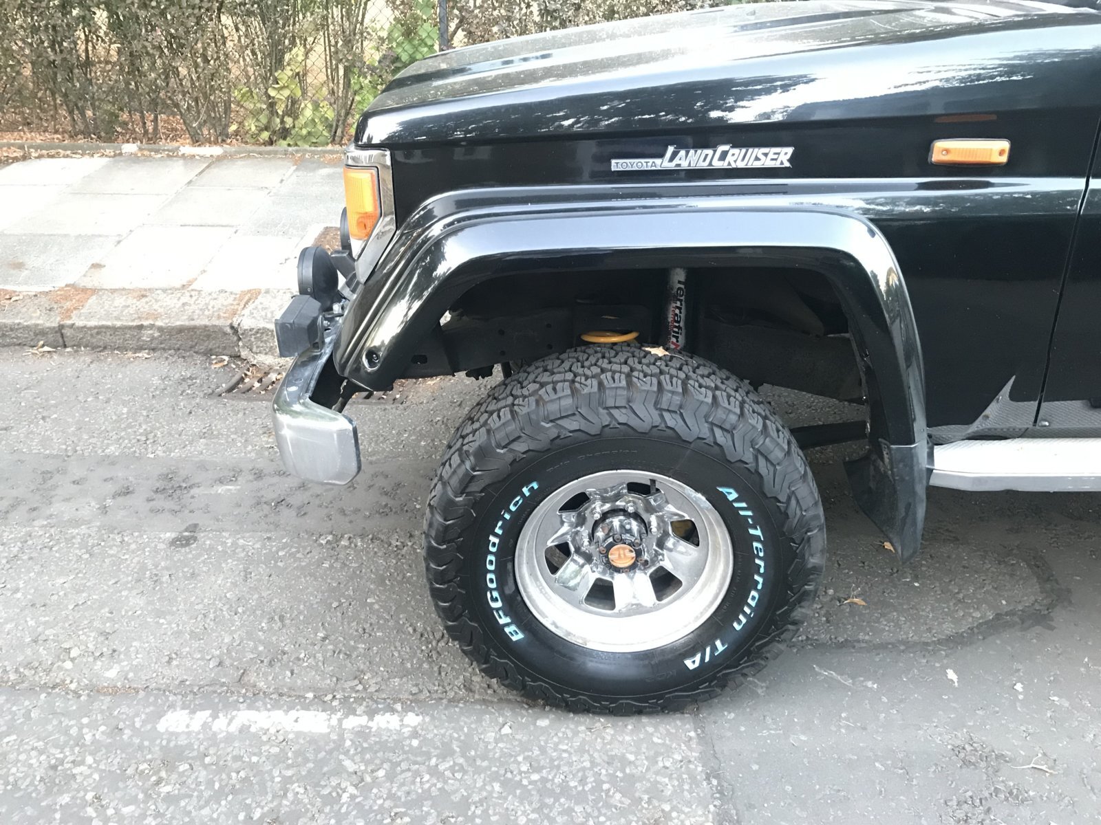

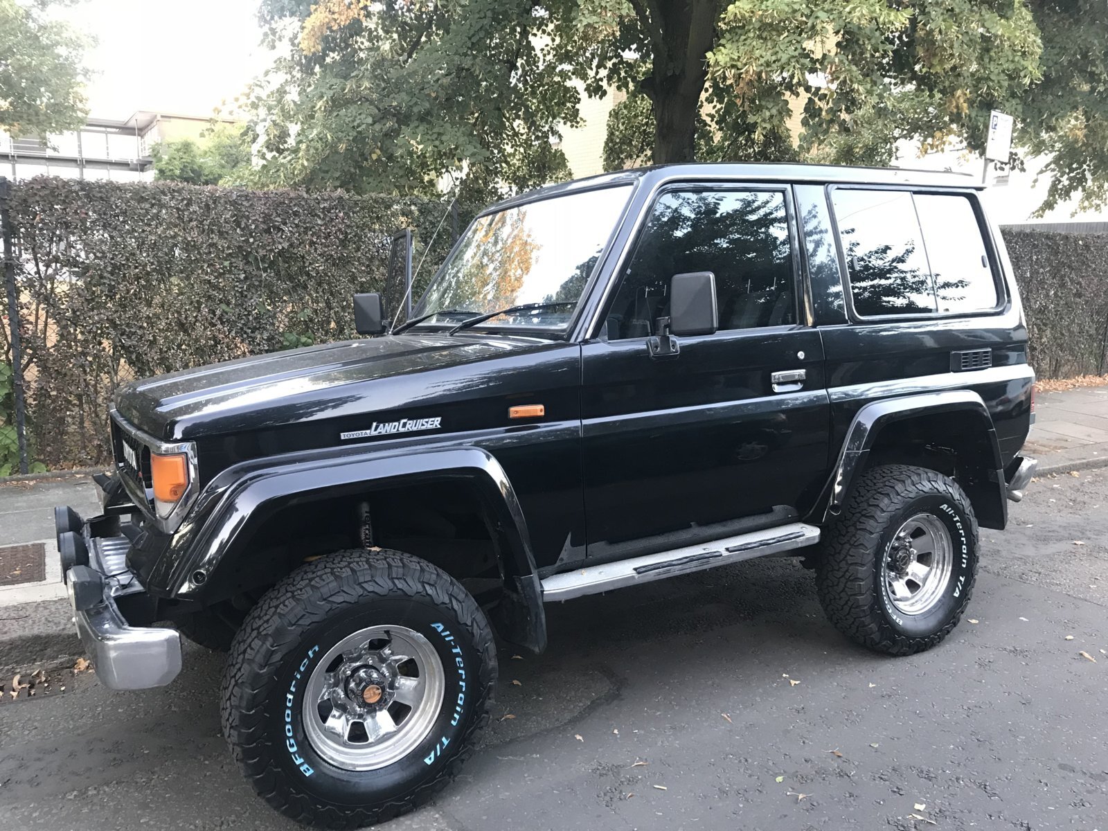

    Gents just wanted to share my good day, I finally picked up the truck an hour or so ago and the drive back was brilliant.
    The first garage I pulled into some guy approached me and said I’ve always wanted one of those, I haven’t yet but I will. I said I’d been waiting 13 months myself. Was just the best and I’ve had some awesome cars
    Hope you enjoy, it’s looking really good and I got my new Toyota badge on straight away and a temp turbo badge.

    on previous pics looks like the powersteering pump bracket has oil on it.
    Mine looks same and culprit is alternator leak.

    Do these alternators have a vac pump on them then Alexy? I’m puzzled as to what would leak from an alternator? Bearings are usually sealed in alternators.
  18. alexy
    alexy Active Member I am in romania
    89
    31
    28
    Map
    i can only see a picture, he needs to look properly to see if thats the case or not.
    on these LJ cars, alternator has an oil fed vacum pump on the back. Mine leaks, so I bought an aftermarket one (Quinton hazell) and will see if original can be repaired or not.
