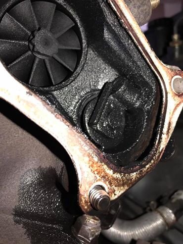

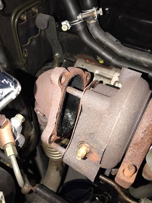

hey guys thanks for the responses! I pulled my turbo after noticing some residual oil on the exhaust side head shields. turns out there is A LOT of oil in the turbo, which is odd that it didn't come out the cold side(like its completely clean). when I say I lot I mean there is oil all the way from my turbo down my dump pipe and into at least half of the exhaust. no wonder it was smoking lol
Im trying to source a CT20, I would like to get one new and rebuild my stock turbo in the mean time.
Here are some pictures so you can see what im talking about, lets all have a good laugh! cheers
