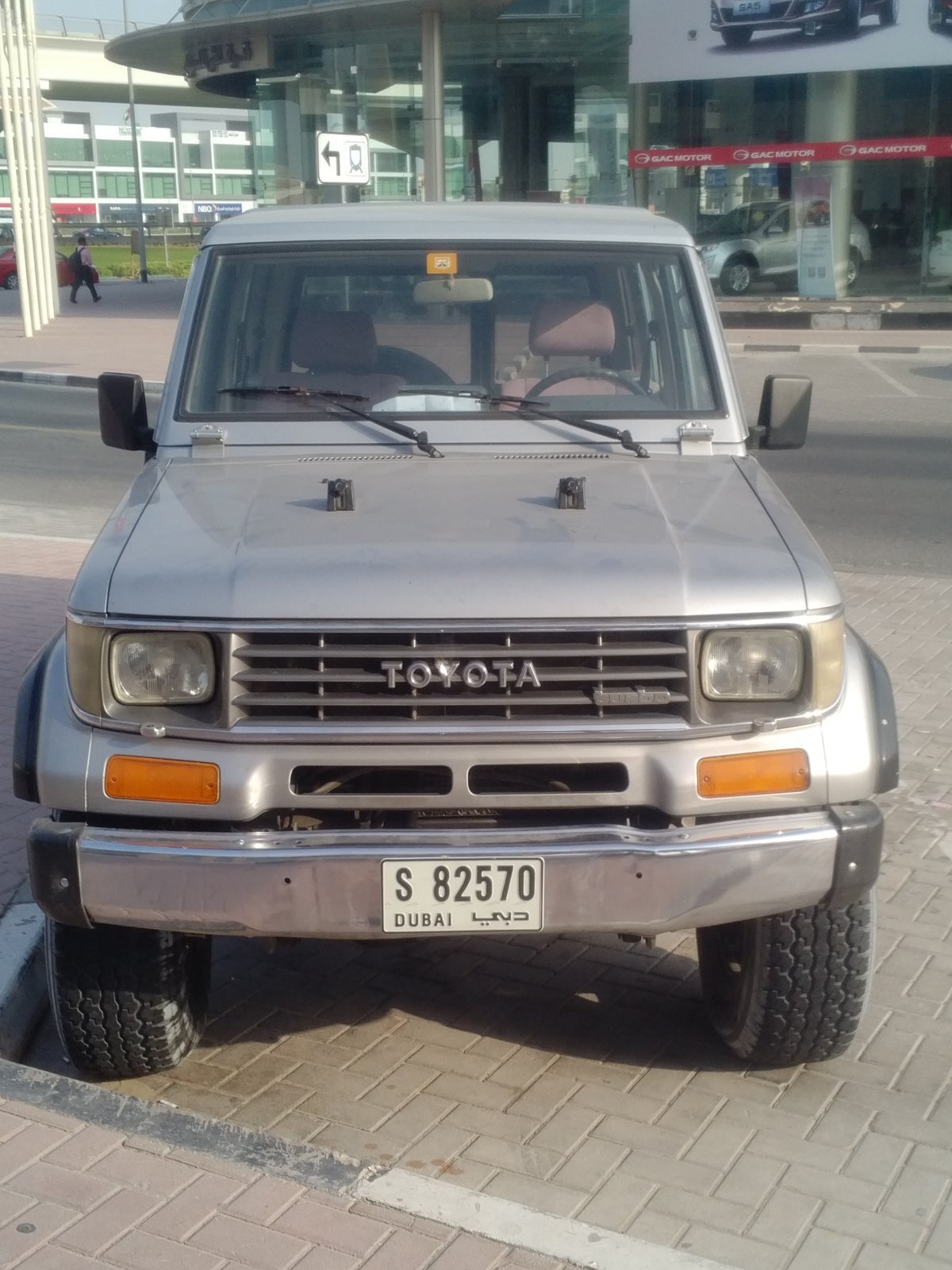

    Hi all,
    I found this forum through google, seems there is a lot more knowledge on these vehicles here than anywhere else I have seen. Then I found two x 1UZ-FE converts and had to sign up.
    I have lived in Dubai for 15 years and just this week bought a LHD LJ73 which was originally imported from Germany. I have previously owned a 4.0 Wrangler, GQ 4.5 Patrol, GU 4.8 Patrol, 79 series 4.5L supercharged ute (pickup), Chevy 6.0 2500 HD and then Pajero (shogun) 3.8L.
    We don't really drive diesel vehicles here so the previous owner converted the 73 to a Lexus LS400 1UZ-FE. These engines are cheap here and you can buy a complete one (less loom/ecu) for around 200 GBP. Not sure how that compares to UK prices.

    Last pics were the for sale ad. Took it for a test drive and was happy enough. Told him to put the hard top on (FRP) and then made the transfer. Important thing for me here was to have the engine cylinders in the registration. You cannot officially change the number of cylinders here. At least for expats like me. But this one had 8 cylinders in the official registration. So job done.

    Unlike most people who buy a used Toyota, mine was set up for Falcon hunting. So I still have a falcon perch on my extended centre console. Don't have pics of that yet. Will get some as it is an unusual modification. This is why the removable hard top was sought from Germany. The previous owner now has a chopped FJ cruiser with soft top.
    I also got a canvas soft top, and the tube bars to support it. And a second set of rims/tyres. It came with a set of Nissan Patrol steel rims with some shitty Kendra tyres in 16", but also another set of alloys with BFG in 31 x 10.5 in R15. It also has a water tank behind the seats, with a water heater. No use here in Dubai but when hunting in Northern Iran it would come in handy.
    The list of things that need to be replaced or repaired in extensive, but the main bits work for now. Air conditioning is one item I need to sort, there is a leak in the system as I already had it charged and the gas leaked within 6 hours. AC is important here as winter we get around 20C and summer is 50C or so.
