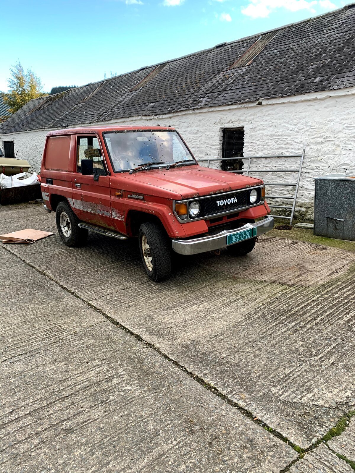

the photo is the LC just before it left the farm after 13 years

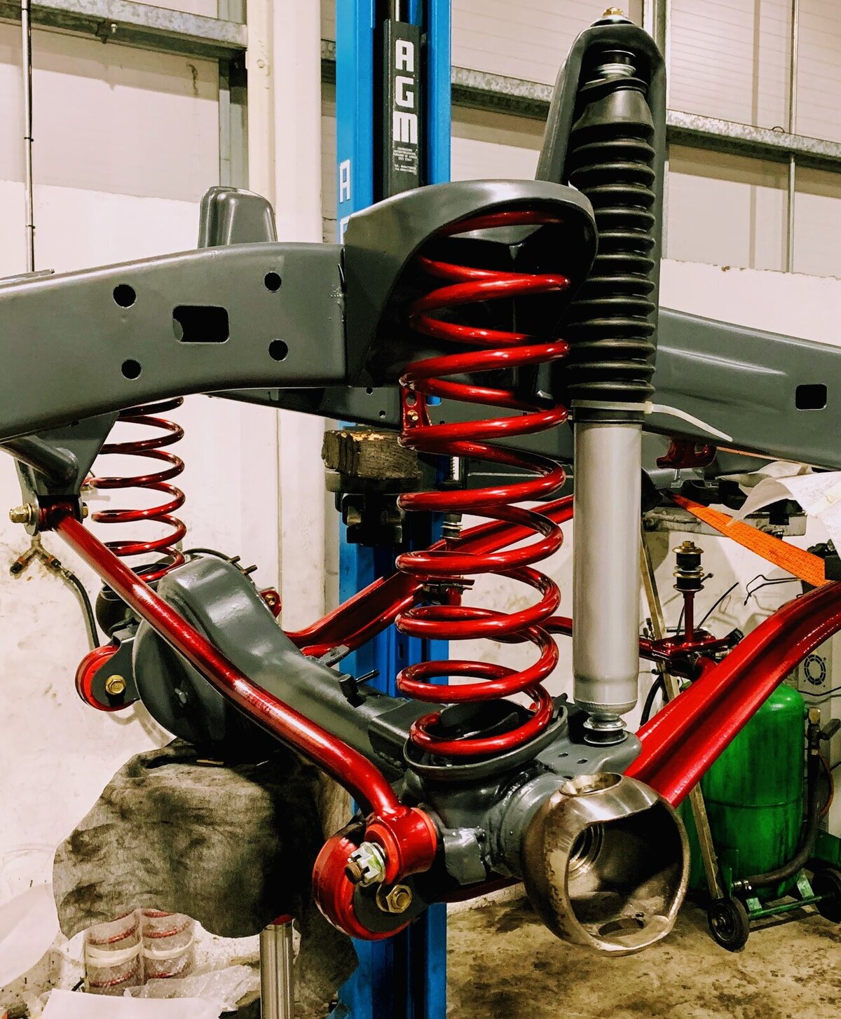

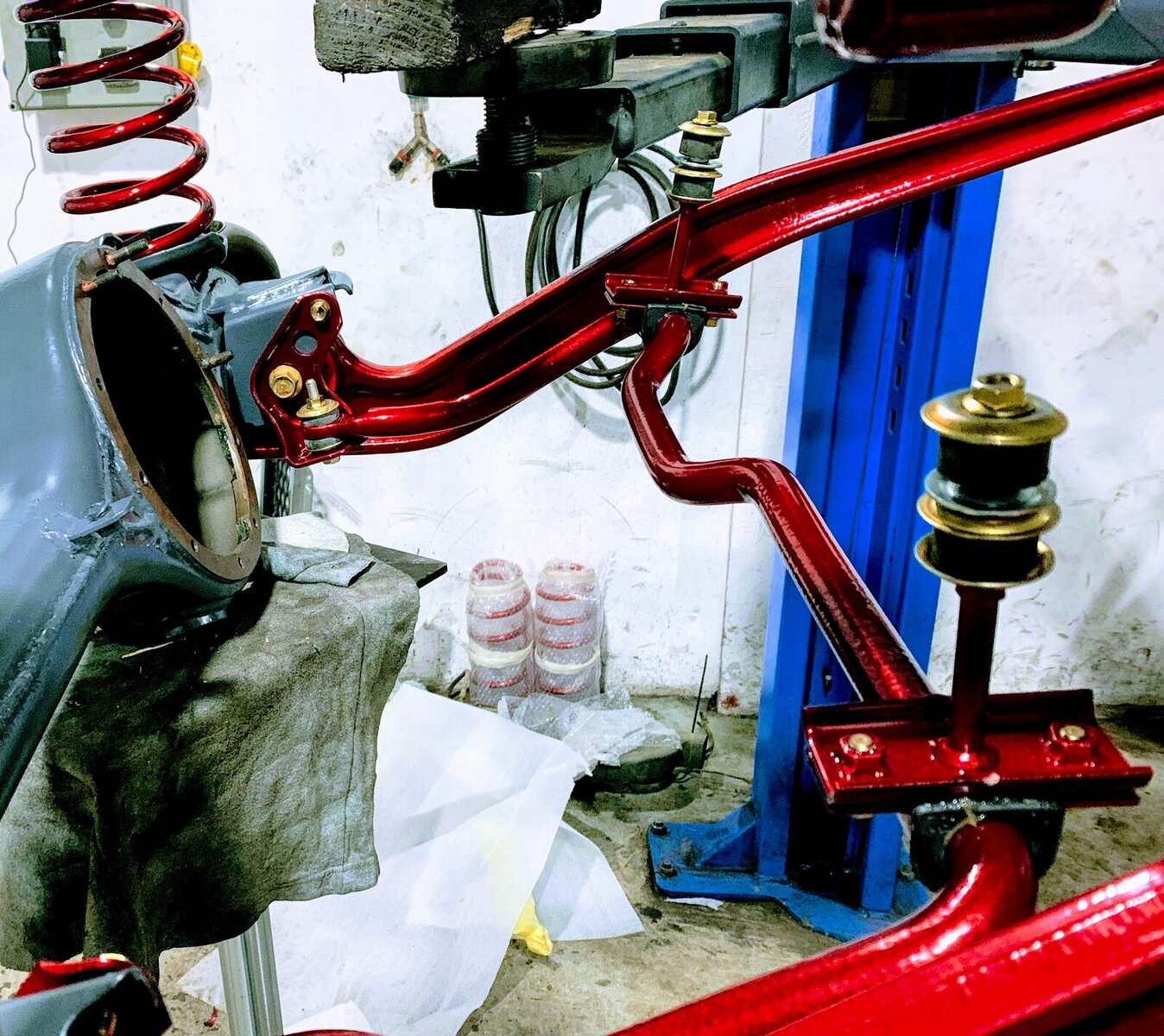

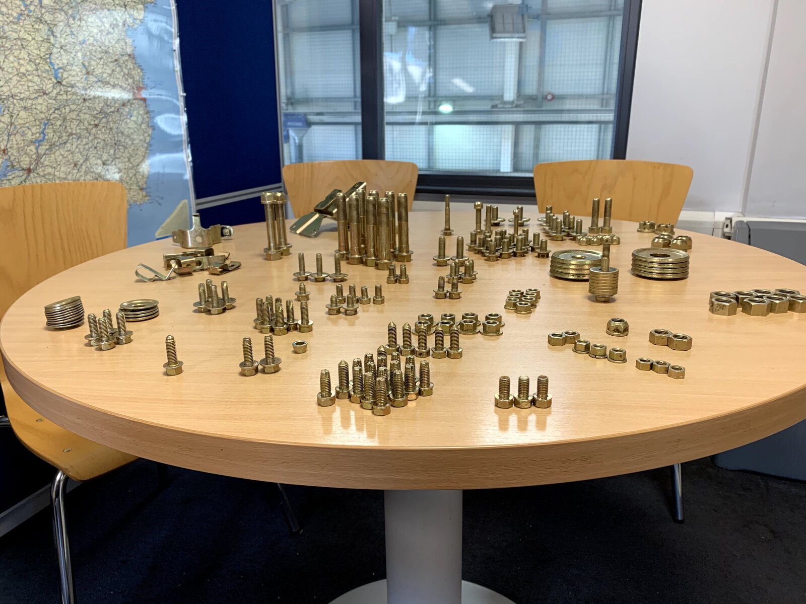

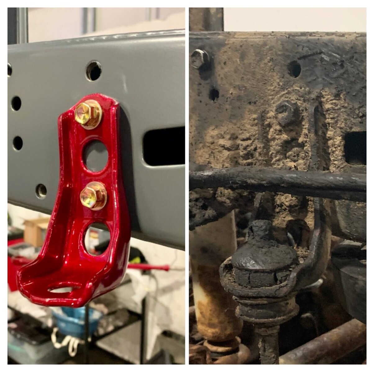

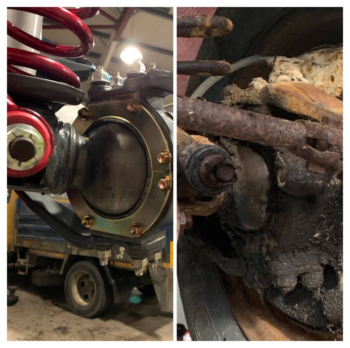

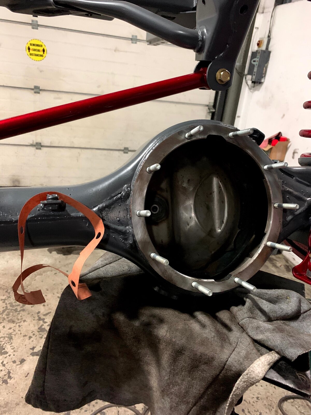

the chassis and components have been been blasted and powder coated so I guess another 30 years at least added to its life,
grey is Ral 7024 and the red is sort of made up but the aim is a candy apple which I think is achieved , the jury out on the body, a part of me wants to leave as is or even make it more distressed looking

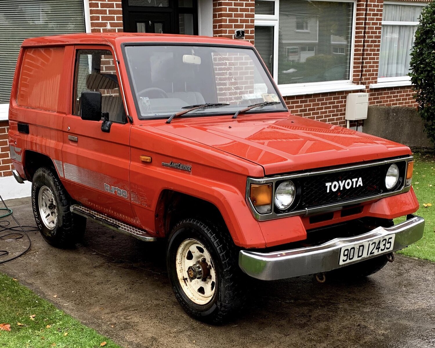

I have also include a picture of my BJ project from 8 years ago

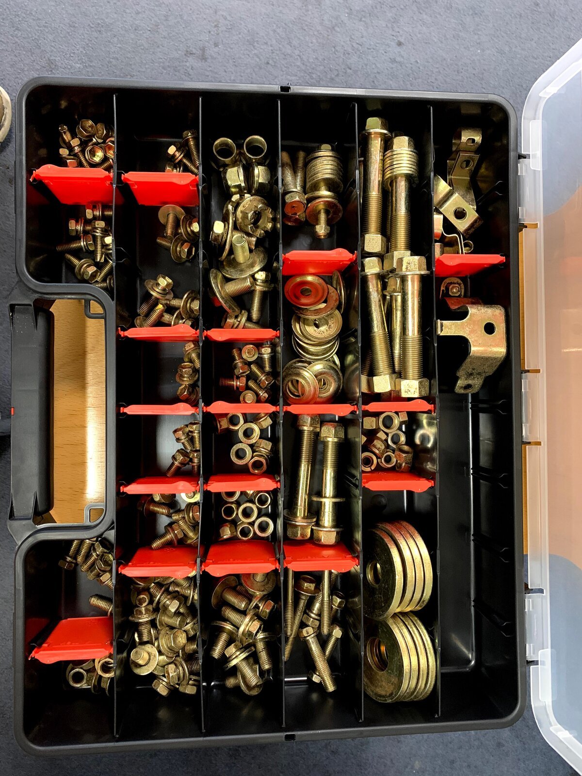

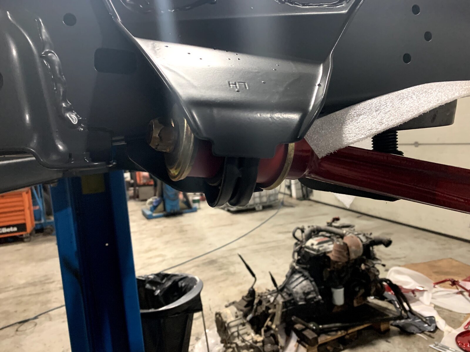

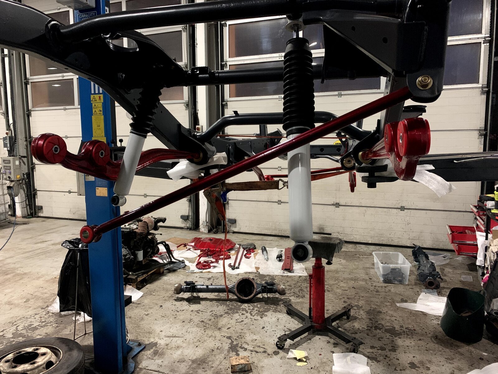

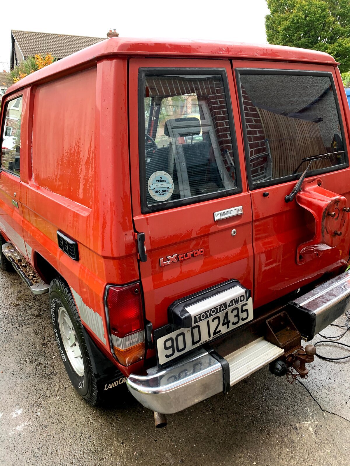

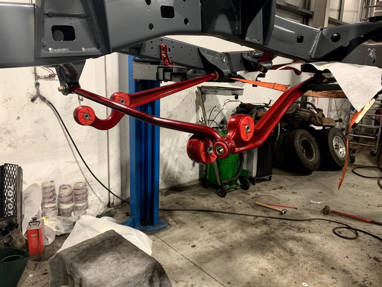

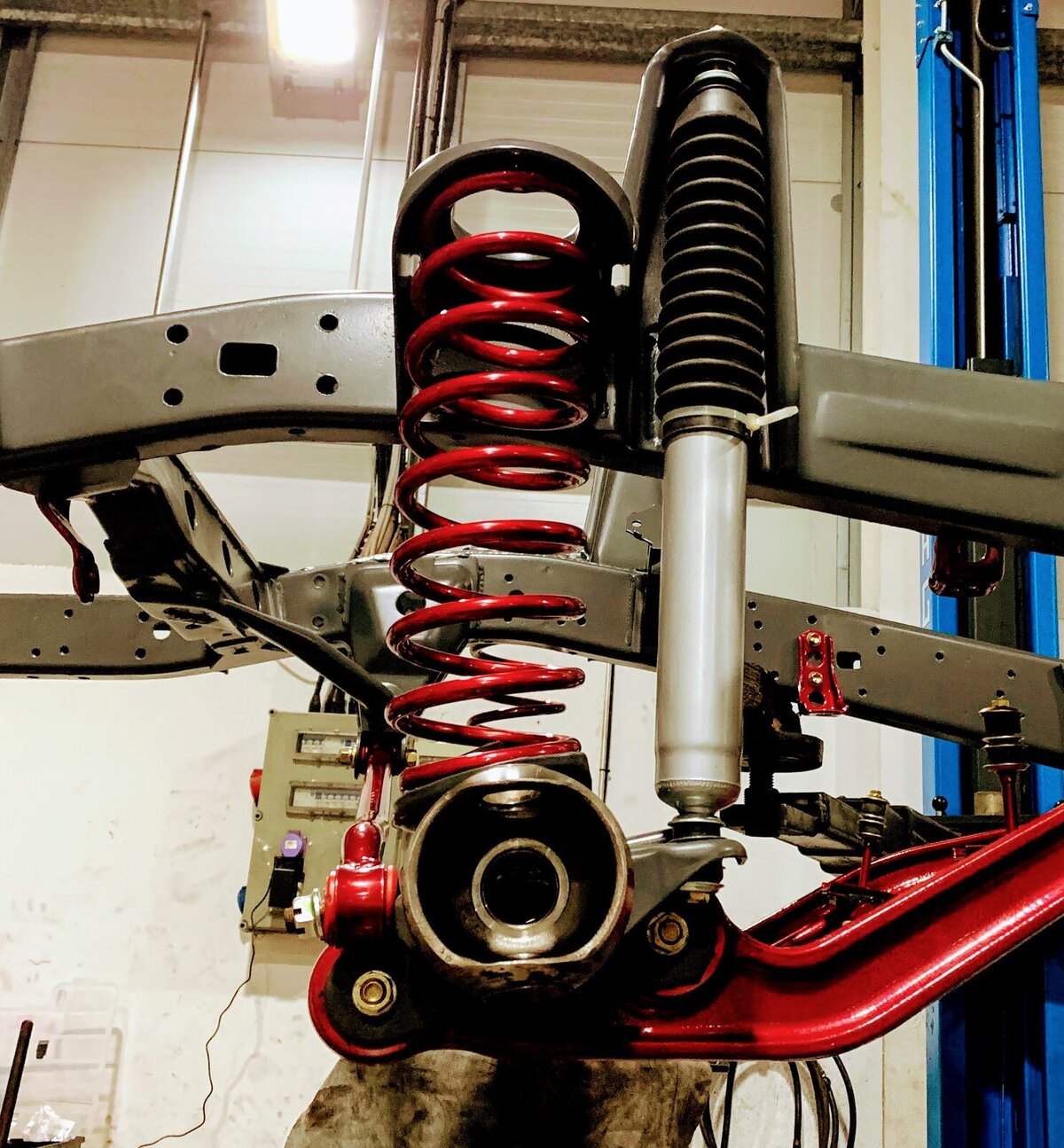

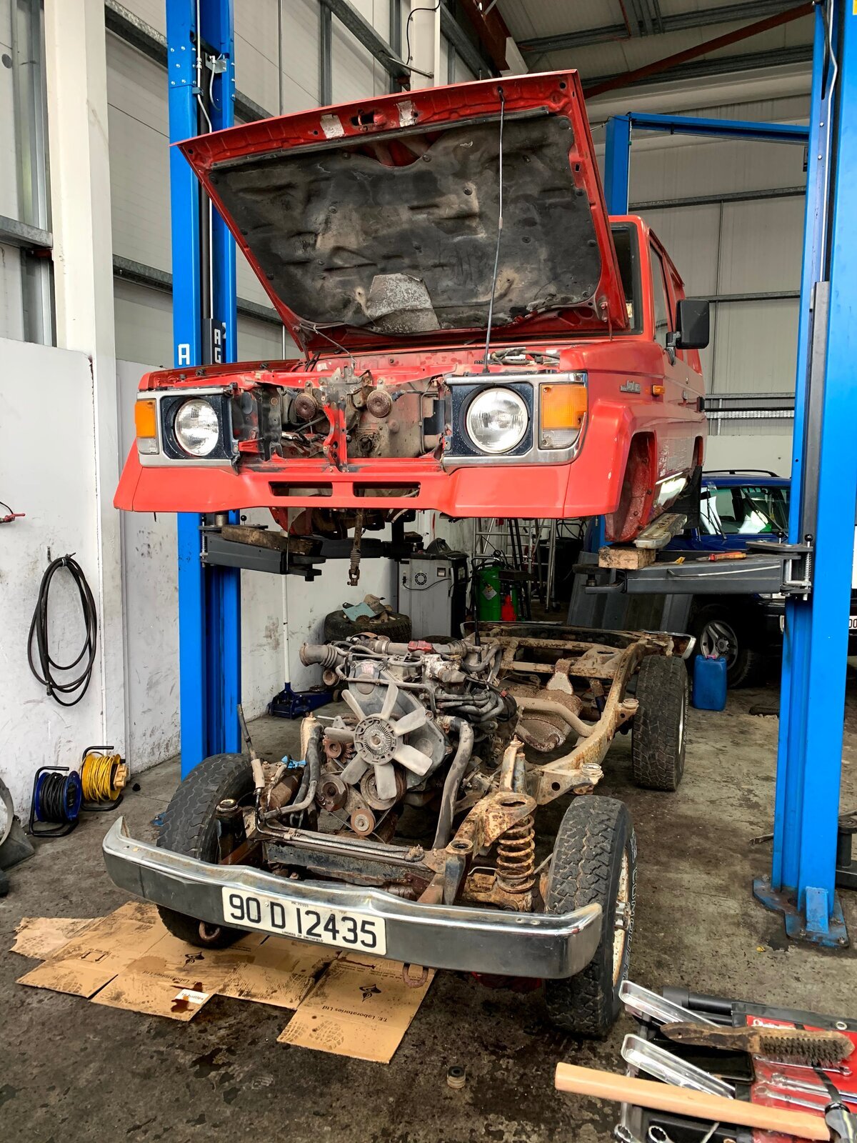

A bit wash after getting it home , other than a bit of expected rust behind the rear wheel arch its perfect , up until 10 years ago Ireland rarely salted the roads so it’s basically sound body wise, these pictures were taken on the 24th of October this year and I’m just now starting the rebuild of chassis and axles , all the hardware is due back Monday from Zinc processing , everything else is ready to go, 50mm suspension lift, 40mm body lift, poly bush all round, all new bearing, swivel joints and brakes front and rear .
33x 12.5r15 mud terrain on steel rims will give a pretty good look, that will keep me busy for few hours over Christmas!

If that is the level of your workmanship on the chassis think I'm going to need my mouth stitched up to keep me tongue in and stop drooling looks just bloody nice can't wait to see your craftsmanship on the body

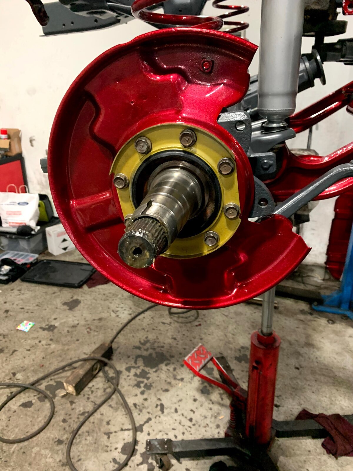

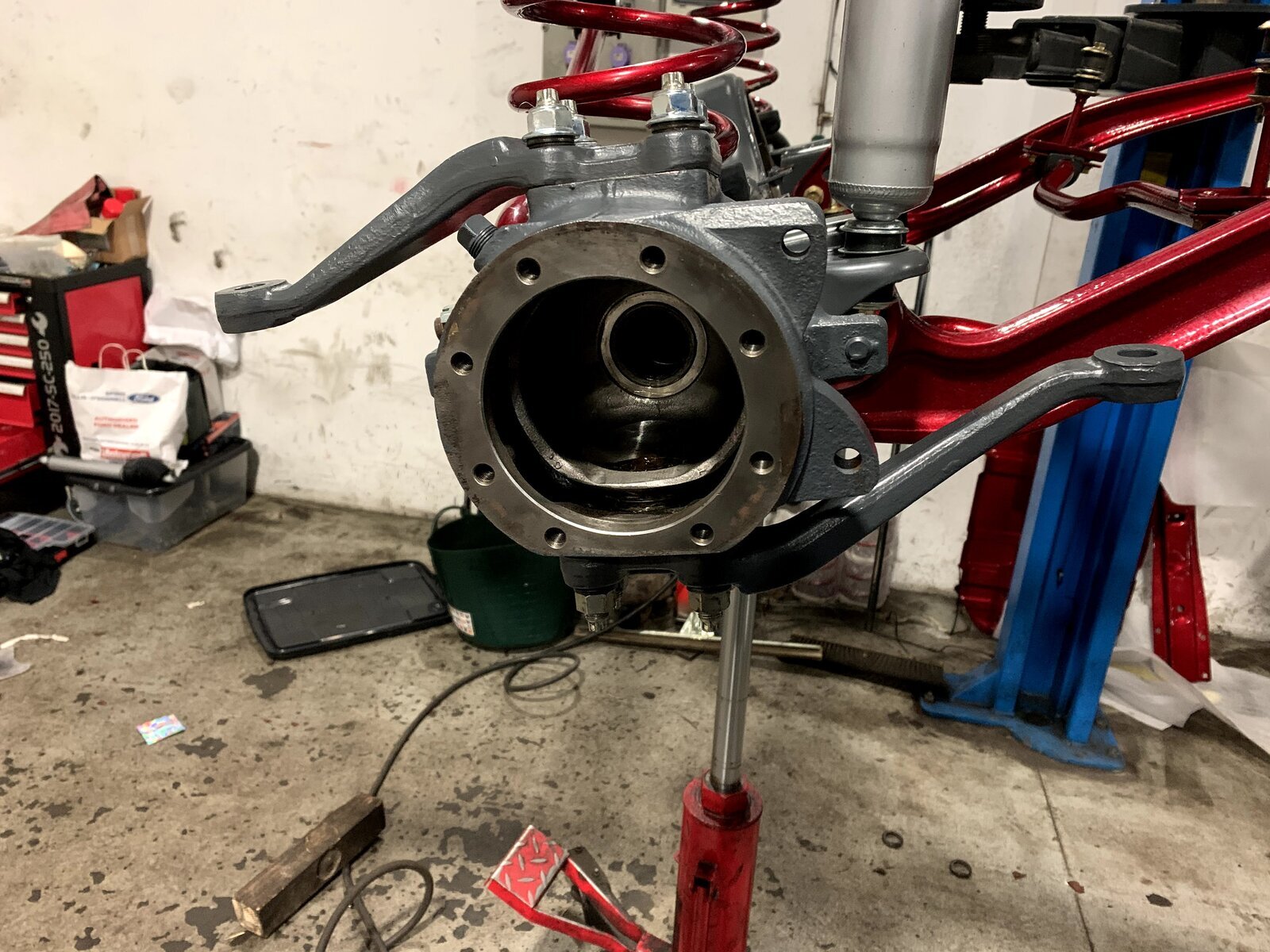

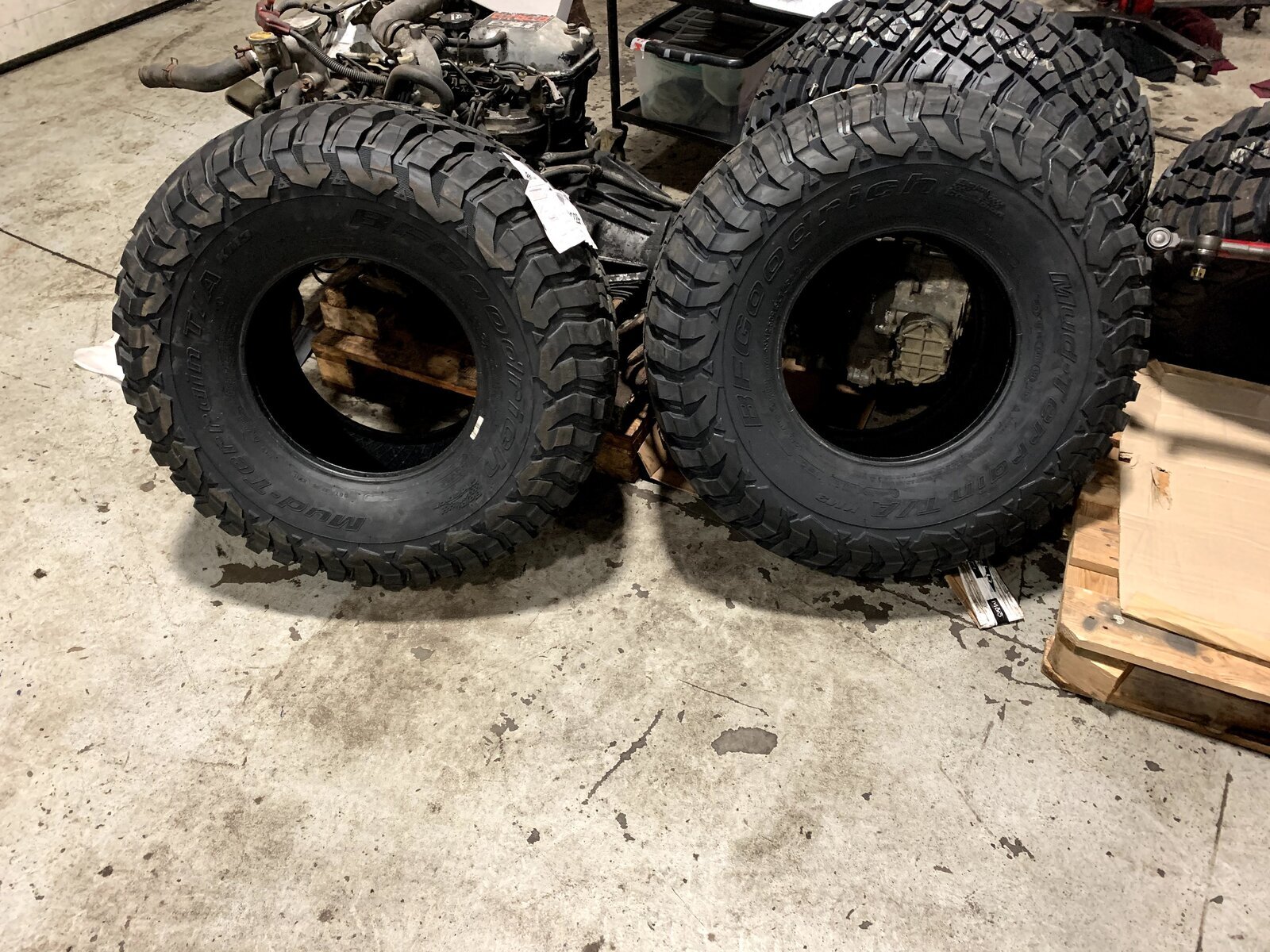

Santa came early for Del with a new set of 33 snow shoes, still rebuilding axle ends but progress is steady , dont Let a bit of rust or dirt put you off, all the main components are the original.

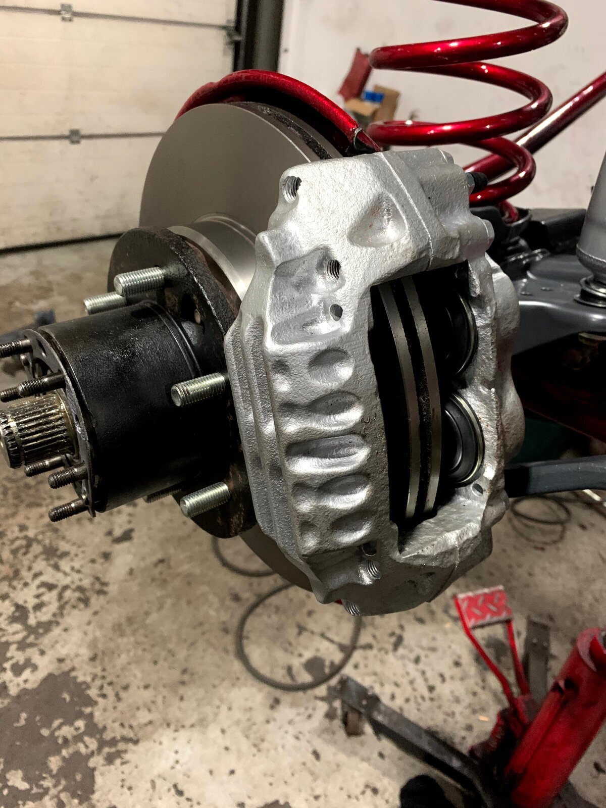

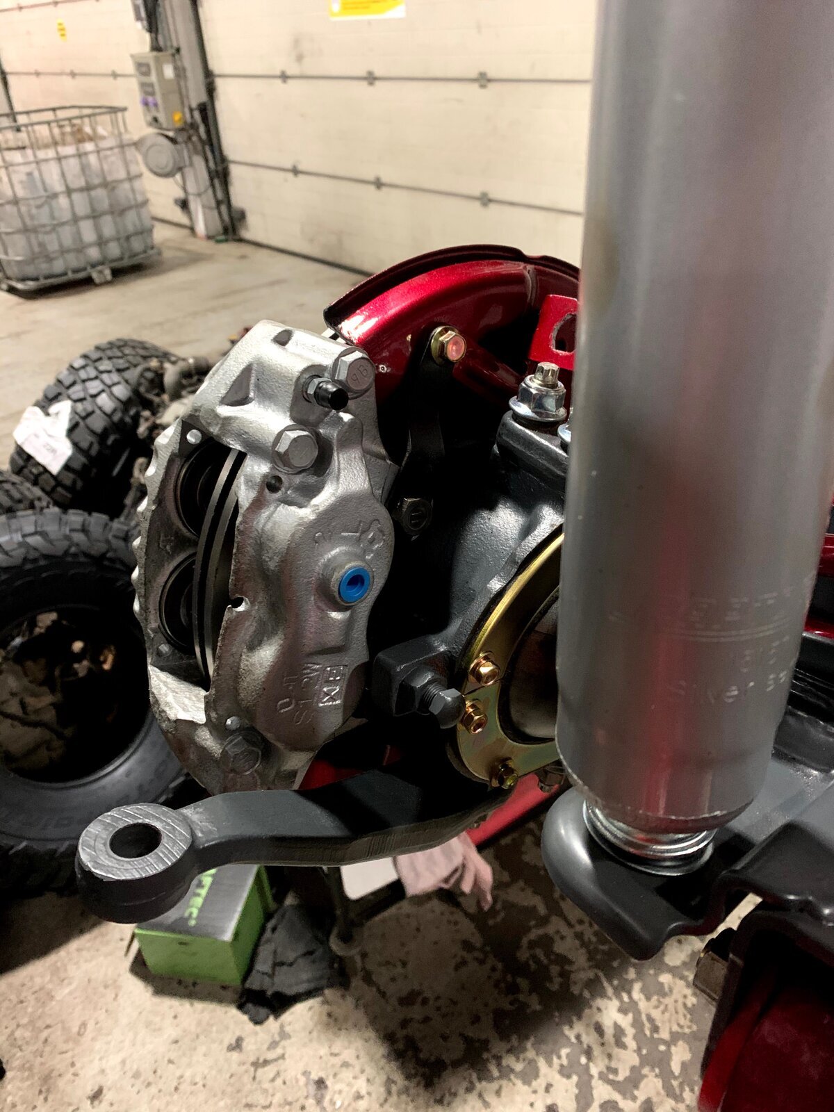

New upgraded vented discs and bigger callipers , had some minor alterations to the back plates but nothing an angle grinder couldn’t sort .
Just wondering has anyone any experience with upgrading the rear brakes to discs? I’ve seen after market options but for some strange reason it means doing away with the parking brake, I don’t think I’d be too excited with this prospect as the alternative of carrying a chain and anchor would not appeal me, any help would be greatly appreciated
