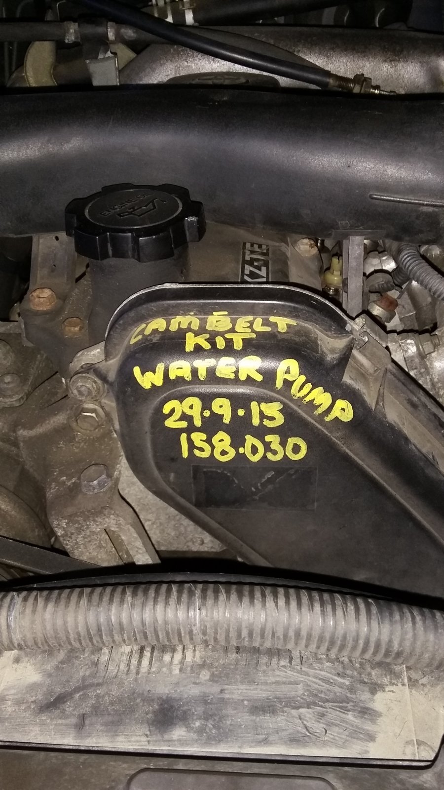

Hi All,
After starting to hear a rattle like sound i decided to remove the cambelt cover and was shocked how loose the cambelt seems see footage is this right or am i just getting to that OLD worrying stage in my life :icon-redface:
That looks way too loose to me. All the vehicles I’ve owned with timing belts have run way more tension than your belt appears to have. Check the tensioner.
The timing belt on these is not under great stress, but that does look a bit too loose. I would change it and get a new tensioner and idler pulley to make sure it can't skip a tooth. Reminds me, mine is due a t-belt change
At the very least check the tensioner. T belts don’t stretch so there is most likely a problem with the tensioner. Turn the lower pulley clockwise to make the right hand side of the T belt taught and the tensioner side loose and inspect and adjust the tensioner. If in any doubt as to the age or condition of the belt- change it. It’s cheap compared to a new engine and use genuine Toyota or Gates if you want to go aftermarket.
I defiantly too loose that! I wouldn’t run it like that I have seen the tensionors fail before! ntn I think make them for Toyota about £28
I thought it was loose was supposed to have been changed before my purchase :icon-eek:
On the timing belt tensioner there should be a 8mm protrusion on the piston. When they wear they have less than 8mm. So it's very good that you've caught it! They say if there's any sign of oil on the seal that surrounds the piston then its scrap. When you take it off turn it upside down and press it down on a hard surface and there shouldn't be any resistance, a knackered one will have some free movement!

Thanks for i will test it but i am going to renew the belt tensioner and pulley asap.

Hi Beau this is the belt when running which seems really loose to me :icon-eek:
If I were you I’d sort that before you run it again. Even a jumped tooth can be catastrophic on an interference engine. I don’t know if that one is but it’s best to assume so. That adjuster looks knackered bouncing in and out like that. If the belt WAS changed when noted before you bought it they probably didn’t replace the adjuster.
The cambelt kit is ordered i am not using it until its changed i also thought as you say that the tensioner was not changed as the belt does look in good condition :icon-rolleyes:
