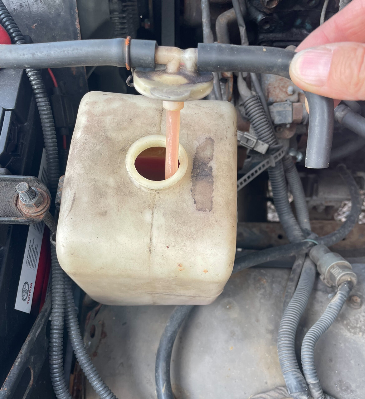

What's the little "spout" for on the overflow bottle cap as pictured, the blue drawing indicates the hole is connected to the spout, water can flow from the hole in the rubber to the spout, I assume this is an "overflow" if the bottle fills up to the brim, but how would that ever happen, it'd take litres for the fluid to reach the cap. Or is that for if you have a serious issue like exhaust gases leking into the coolant from a cracked block or such which would pressure the coolant back into the overflow bottle?
I thought the overflow bottle should fill via a tube from the underside of the cap??
In such a scheme the liquid can get drawn back into the radiator to maintain level.
Without the tube the expansion bottle can overflow and the whole system gets depleted? Here’s a pic of my arrangement if it helps

The "little spout" in the cap and the short pipe in the photo on the last post are primarily to let air out as well as excess coolant in the unlikely event the tank overflows. The coolant level in the tank will rise and fall according to engine temperature, filled and drained by the long tube (the end of which must always be below the coolant level) on the cap but the tank itself isn't pressurised so air must be allowed to flow freely in and out, just like air must be allowed into the fuel tank as the fuel level goes down.

So the little port in the cap is for air mainly, Thanks for clarifying.
