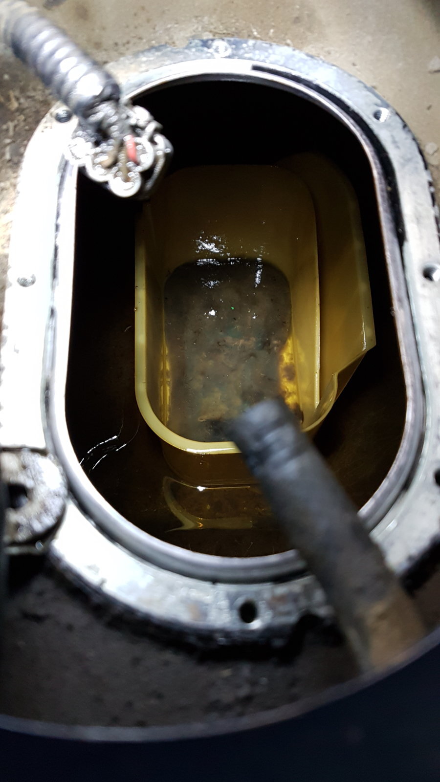

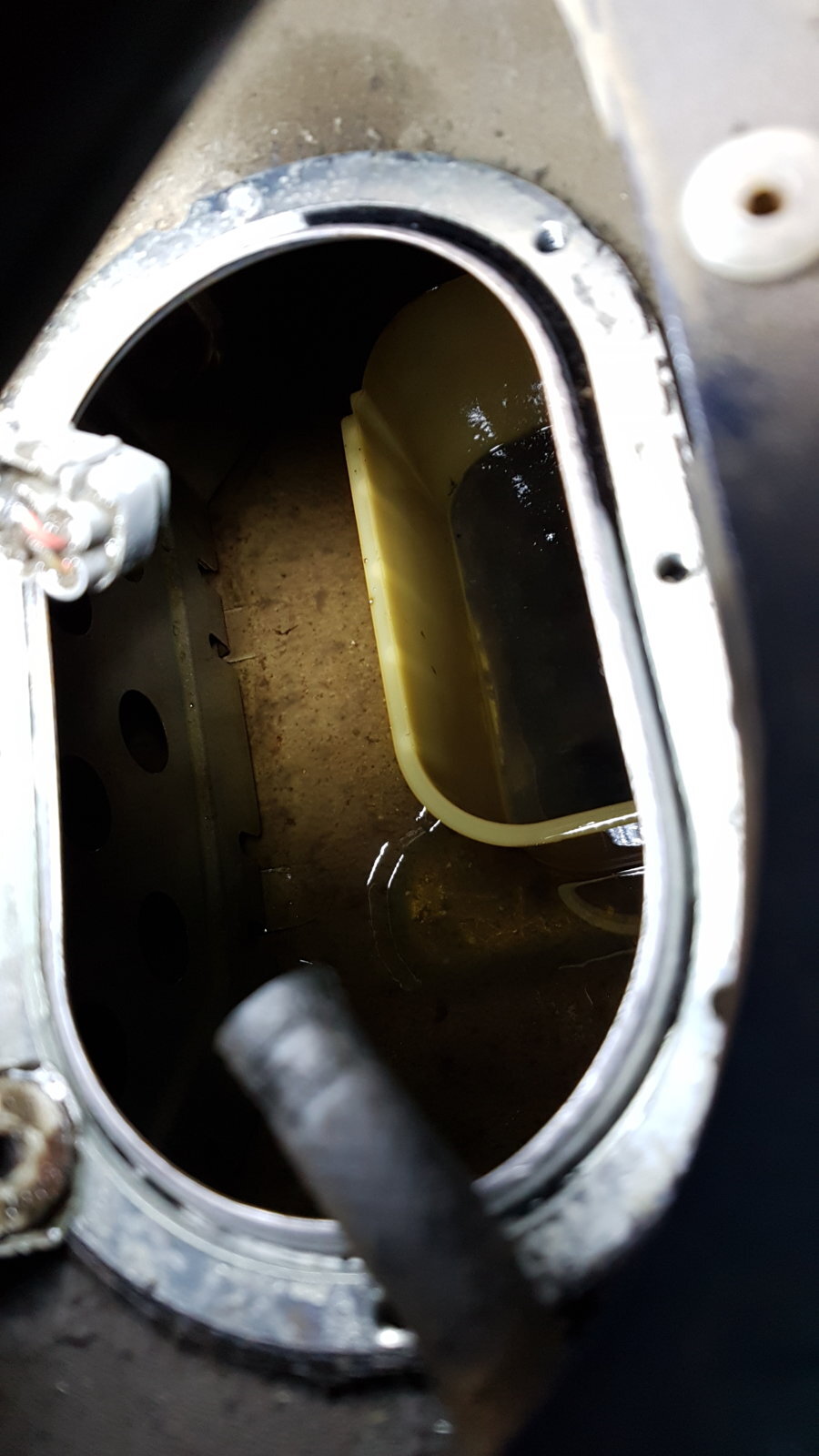

As you can see it was badly needed but as expected it didnt solve the problem
Going by the gunk so far the pump or injectors cant be great either. Do i try an injector cleaner and drive her for a while before i do anything more 20161211_111235.jpg 20161211_111255.jpg

No timing was not touched in anyway. Jeeps been lying for 3 years.. Intersting didnt know about filter inside pump.
At 2200rpm your turbo cuts in and demands more fuel from the pump via a vacuum line to a diaphragm which in turn increases flow in the pump . If this mechanism isn't working then at 3000rpm your running on diesel fumes .
An air leak in vacuum line or diaphragm is my bet .
