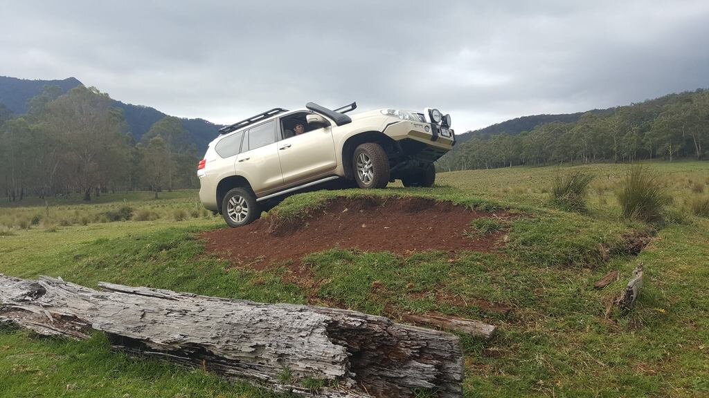

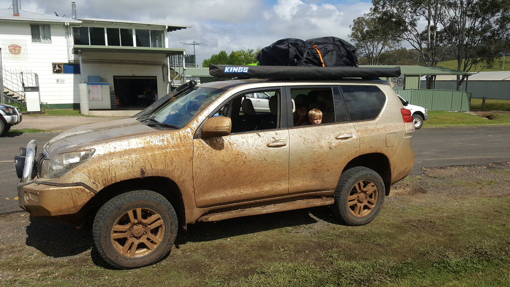

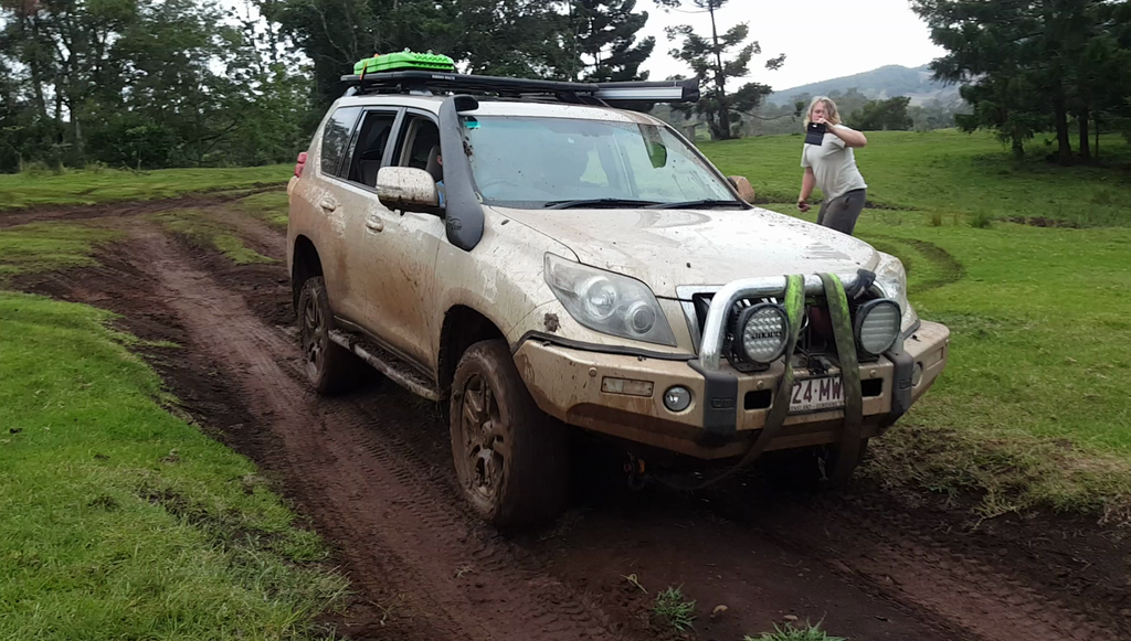

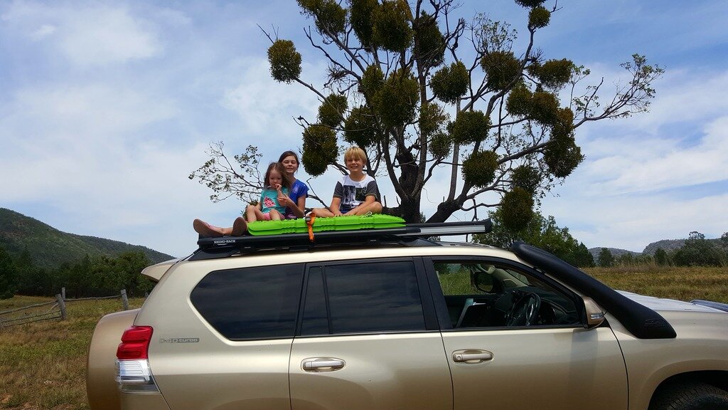

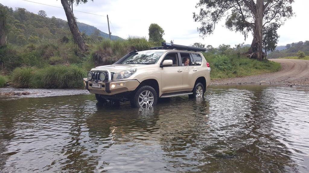

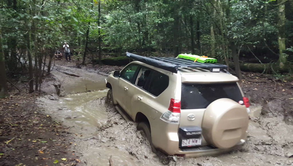

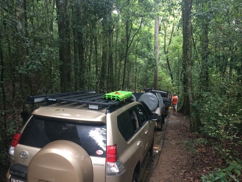

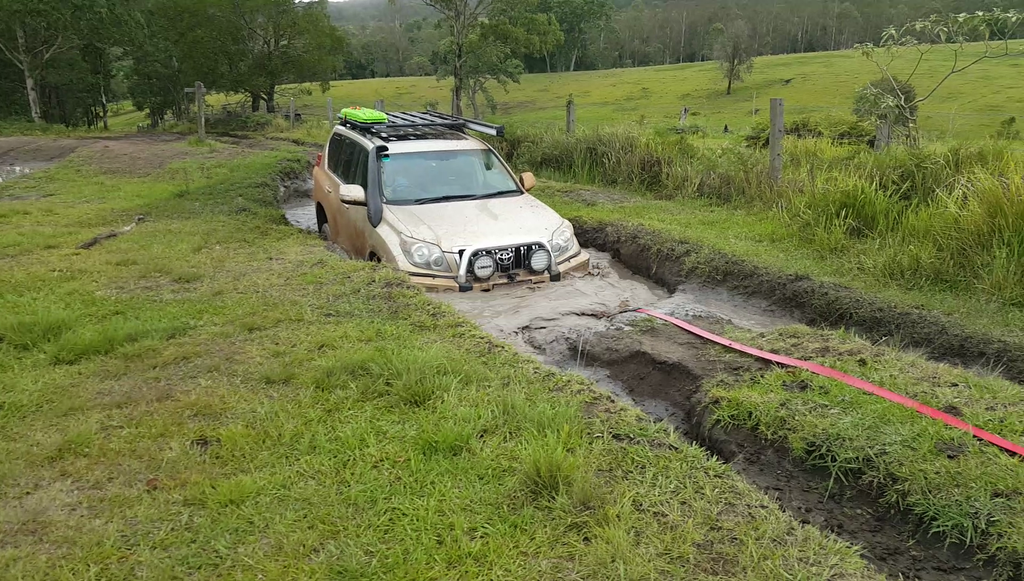

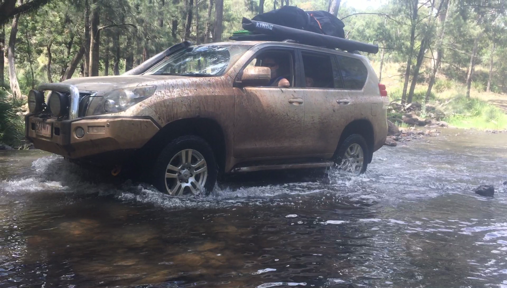

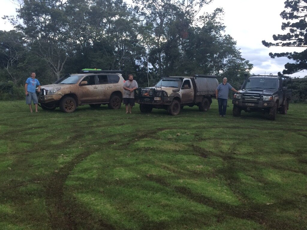

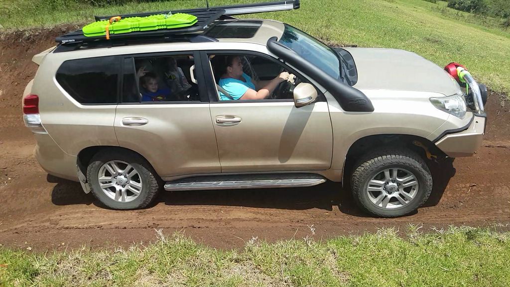

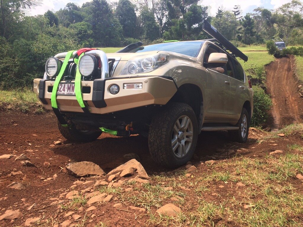

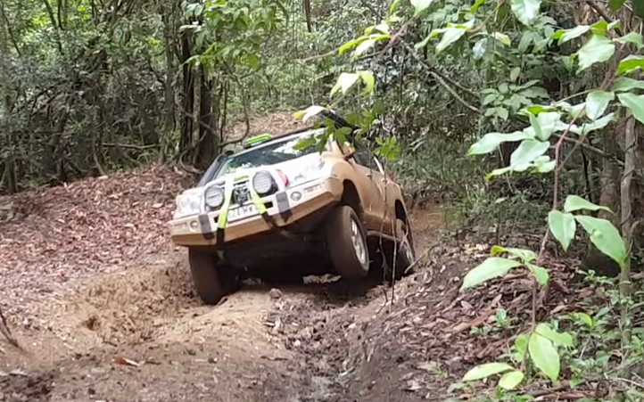

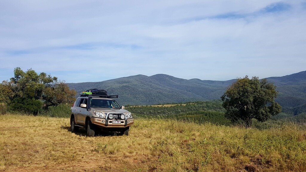

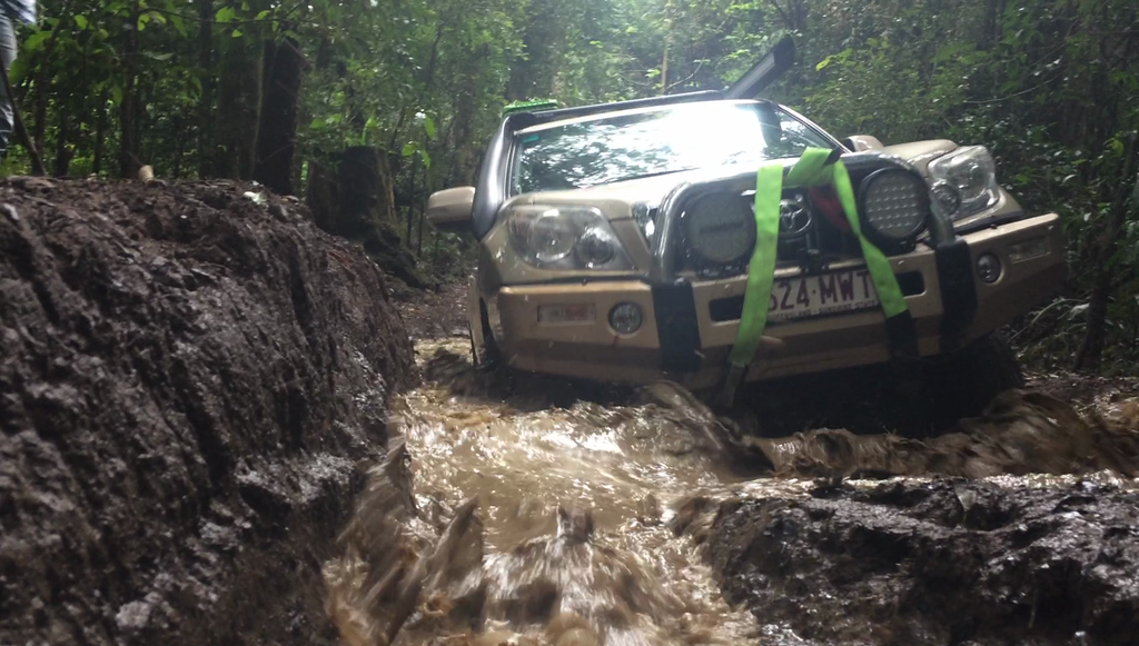

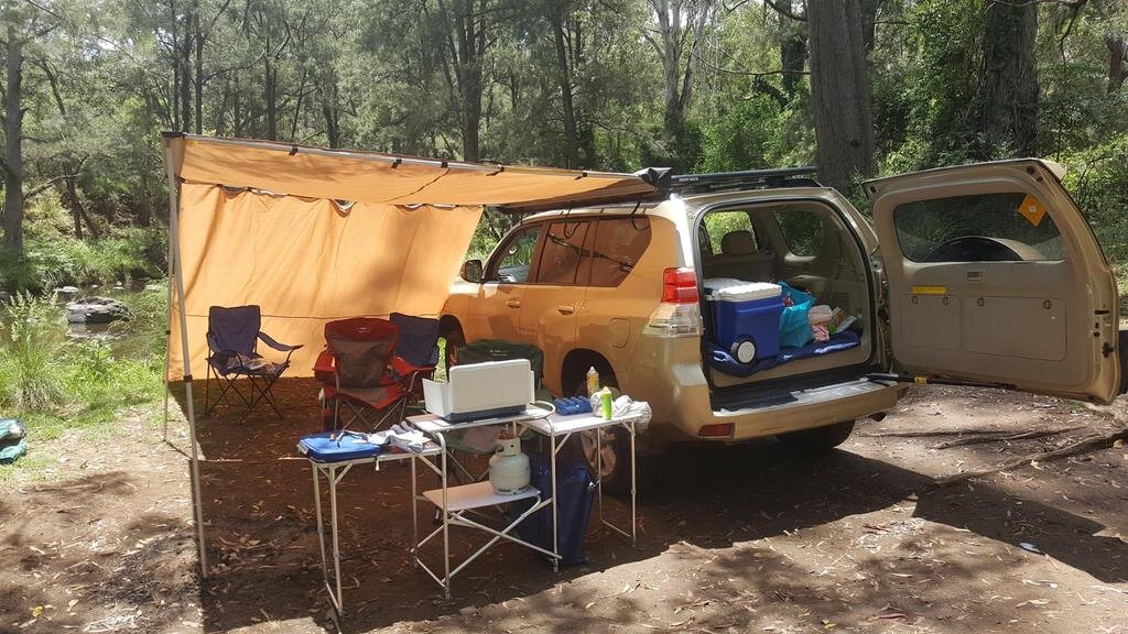

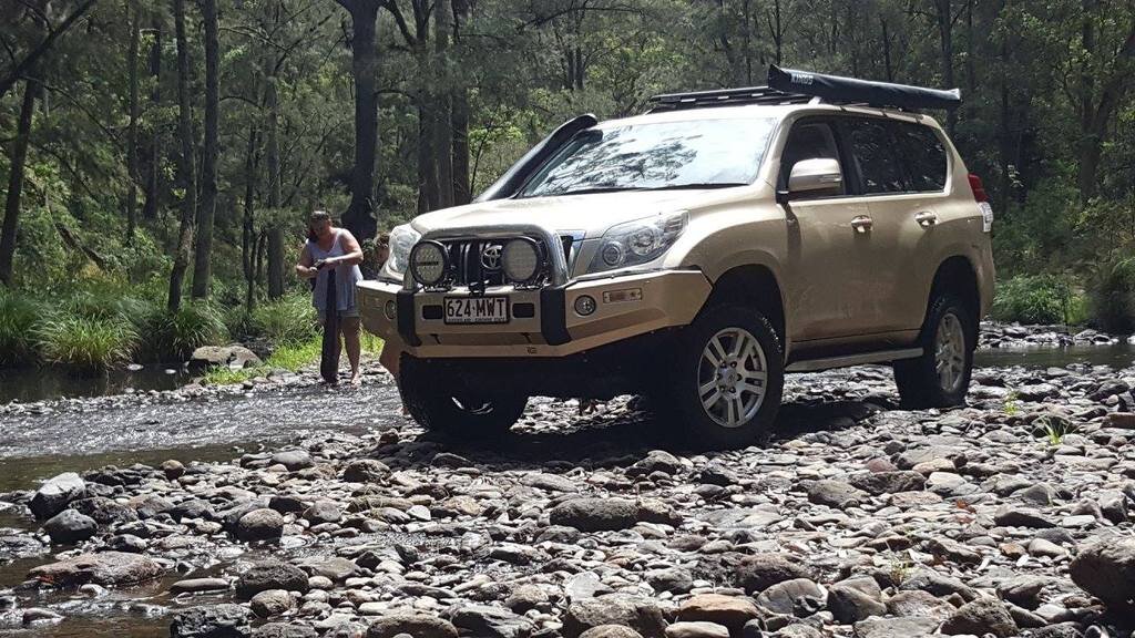

    Hi Guys, Thought I might post some pics of my Prado. These are my favourites from our trips so far

    Great photos. Good to see the 150 getting muddy

    God looking truck too and the kids seem to be enjoying as well.
    Plenty of strap-work there, but I don't see a winch. Is there one hiding in that sleek looking bumper?

    Nice pics. The bumper looks quite good. What's the rough price of one of them?

    No winch as yet . Definately on the cards though. The Kids put up a fight when we leave home and put up a fight when we leave camp also. Cant win :)
    TJM T15 winch bar is Roughly 2K colour coded and installed

    Are those bumpers legal over here? If so I might have to invest in one as well, that is if I can convince the bank manager that we really need one.

    If they have a winch then they're deemed a utility and exempt. Well, that's what the last discussion we had here concluded.
    If you have it as a vanity item then it's against EU rules for pedestrian safety. A winch though was a functional item and it was ok.
    IIRC it was also a case of "if it's already on the truck then it's ok but you can't fit a new one"

    No Worries. Im pretty sure these bars may be available in the UK ( I may be wrong ) they are winch and airbag compatible
