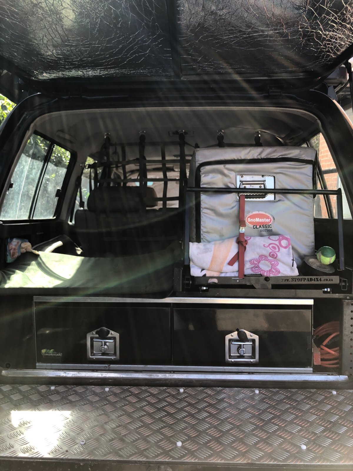

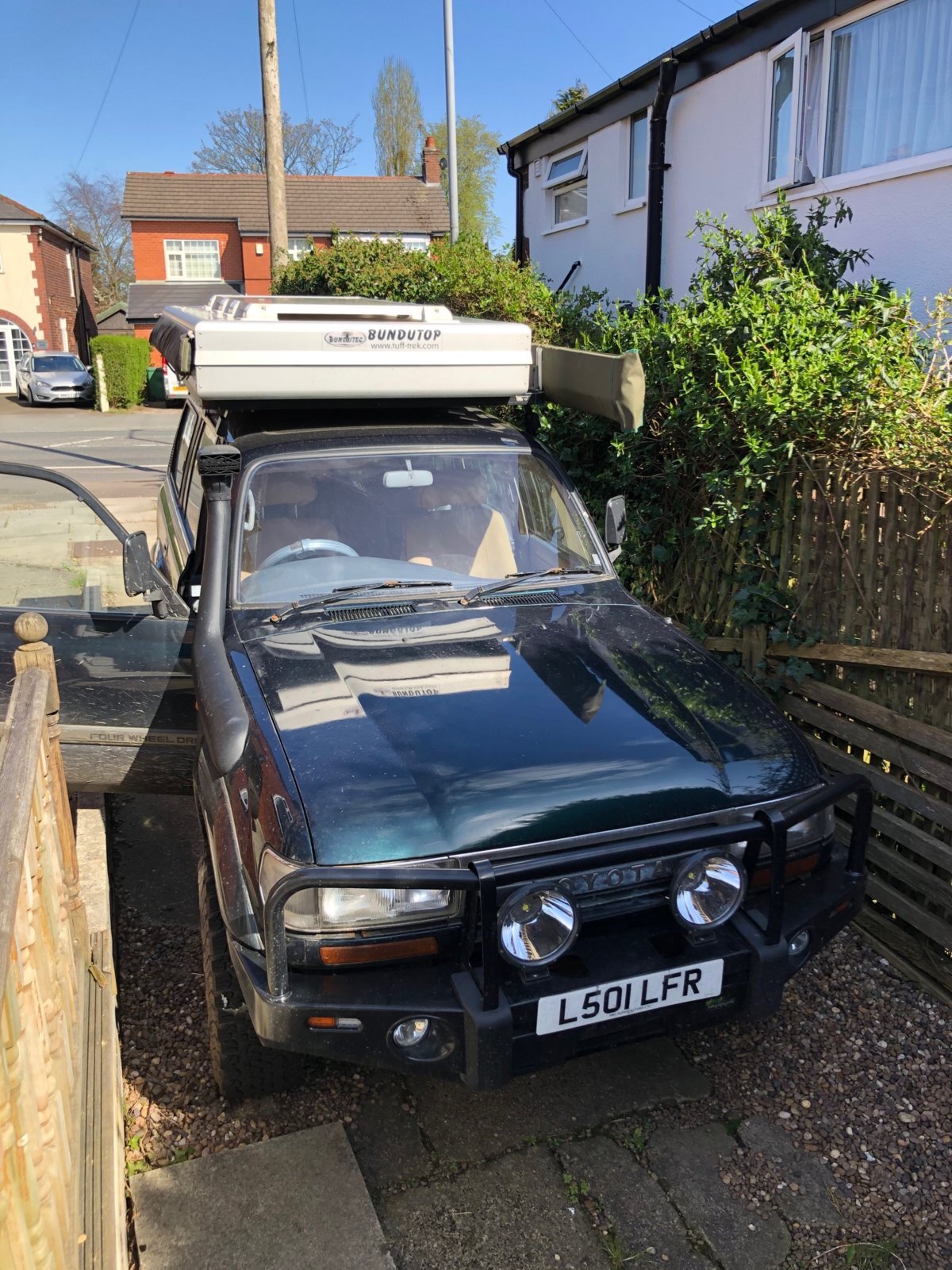

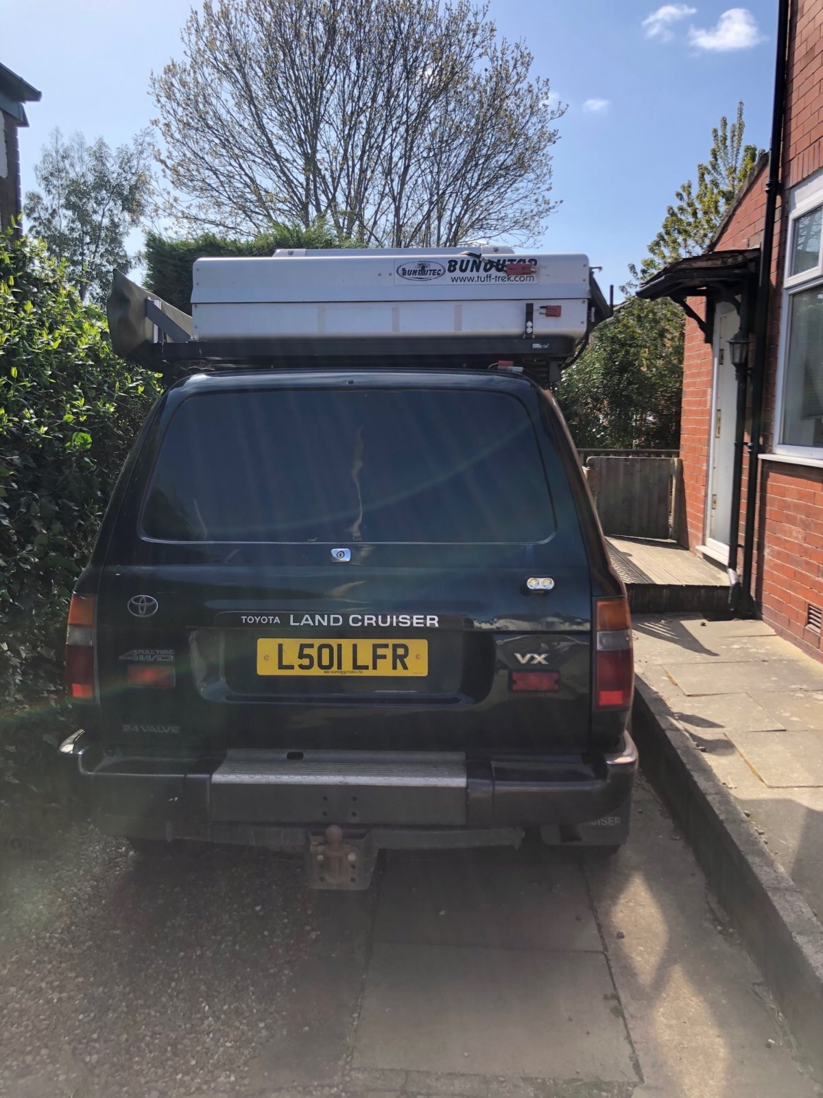

Hi folks - not something I have done before, but apparently people like to see what folk have done to their trucks, I know I find it interesting to see other peoples modifications, so given I have nowt else to do - thought would share my progress so far. Been a 2 year journey so far with help from Phoenix Autos and West Coast 4x4.
In short - things I have added or changed:
Ironman Suspension upgrade - springs and shocks with a 2" lift

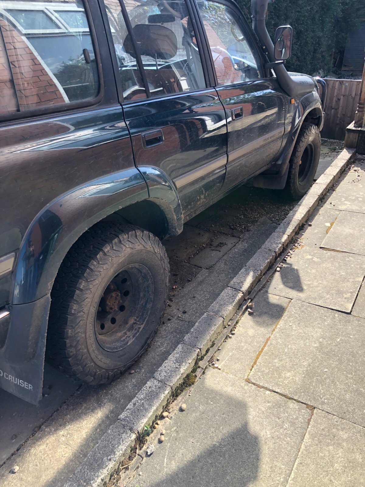

New steel wheels and the Goodrich AT tyres
Ironman front winch bar
Ironman 9" driving lights

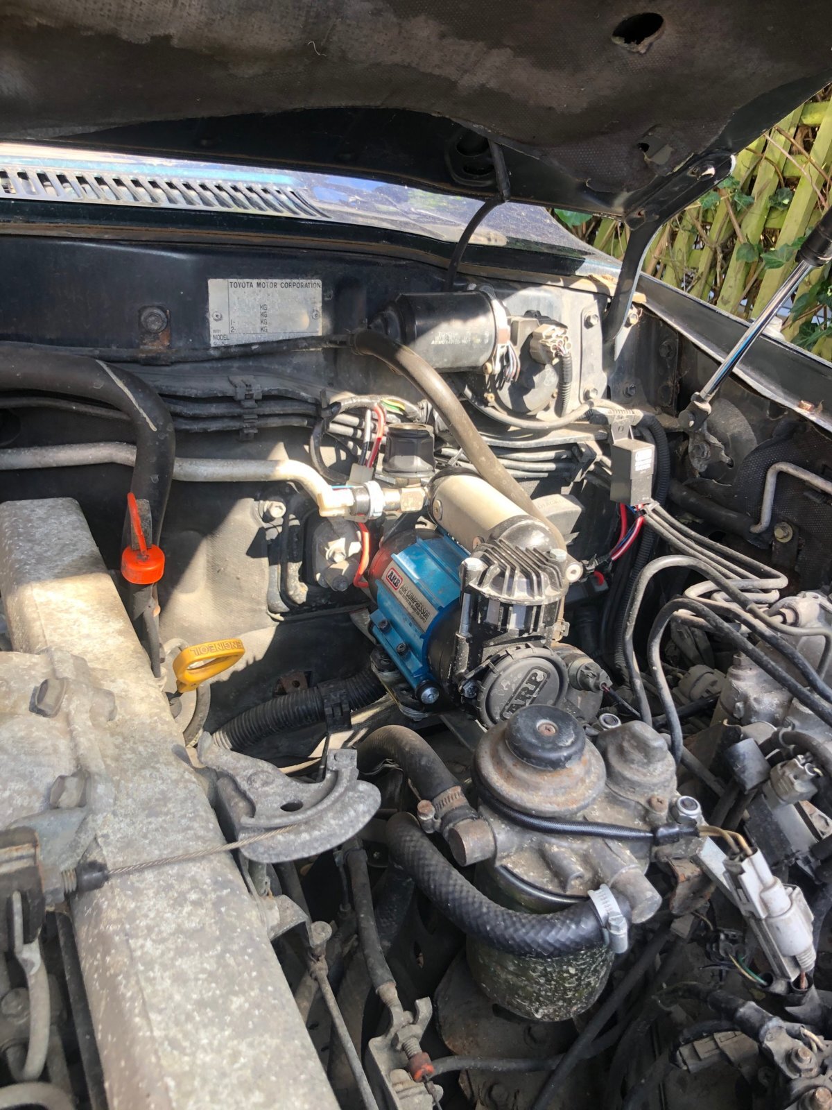

ARB compressor mounted in the engine bay
Ironman Drawer system in the rear
Drop down fridge slide and Sno Master Classic fridge
FrontRunner Slimline Roofrack
Bundutop Tent
Ostrich Wing Awning
BluntForce cargo net to separate rear cargo area (protect dogs basically :-))
Escape Gear front seat covers

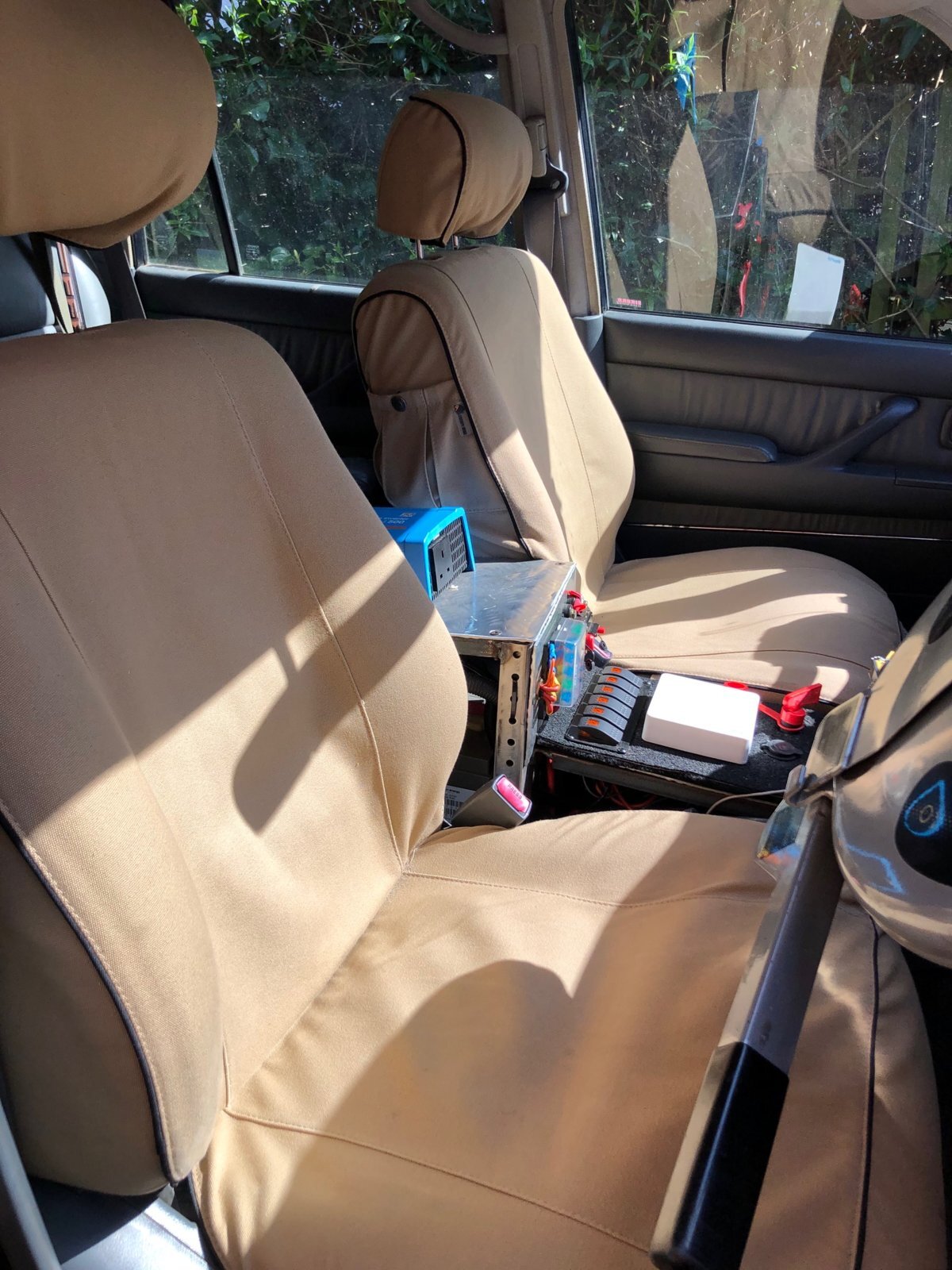

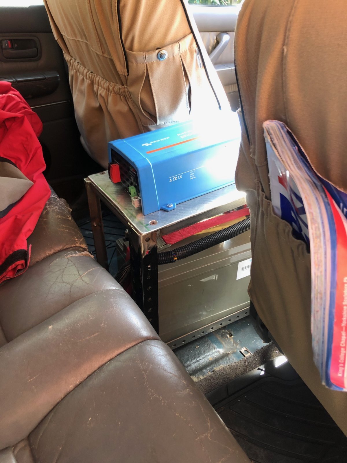

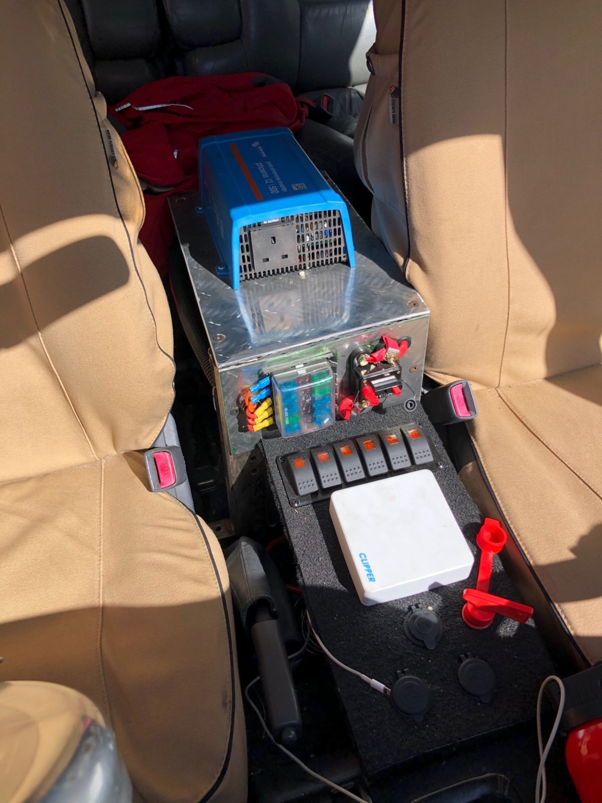

Leisure battery and separate electric system isolated from the twin battery start set up - comprising of:-
Victron 110A AGM Battery
CTEK D250SA DC Charger
NASA Clipper Battery Monitor
Victron 500VA Inverter
2 Double USB front and 1 rear
1 Cigarette lighter point front and rear
Bank of switches for (tent, fridge, lights, power sockets, compressor) + fuse box etc.
Couple of new body panels including removing the rear window and steel plating
Mmm blimey - it mounts up when you write it down. Sure I have missed something. Next on the list (apart from getting front windows to work) is a Rear Bumper and wheel carrier, Winch, Auto Box Oil Cooler - always a list - onwards and upwards and hope will get the chance to use it properly later in the year!

Do you have more info on the split charge system? was it a kit you bought and how easy was it to fit?
I'm looking to do something similar but with added solar panel on the roof. Is that possible with your set up?
