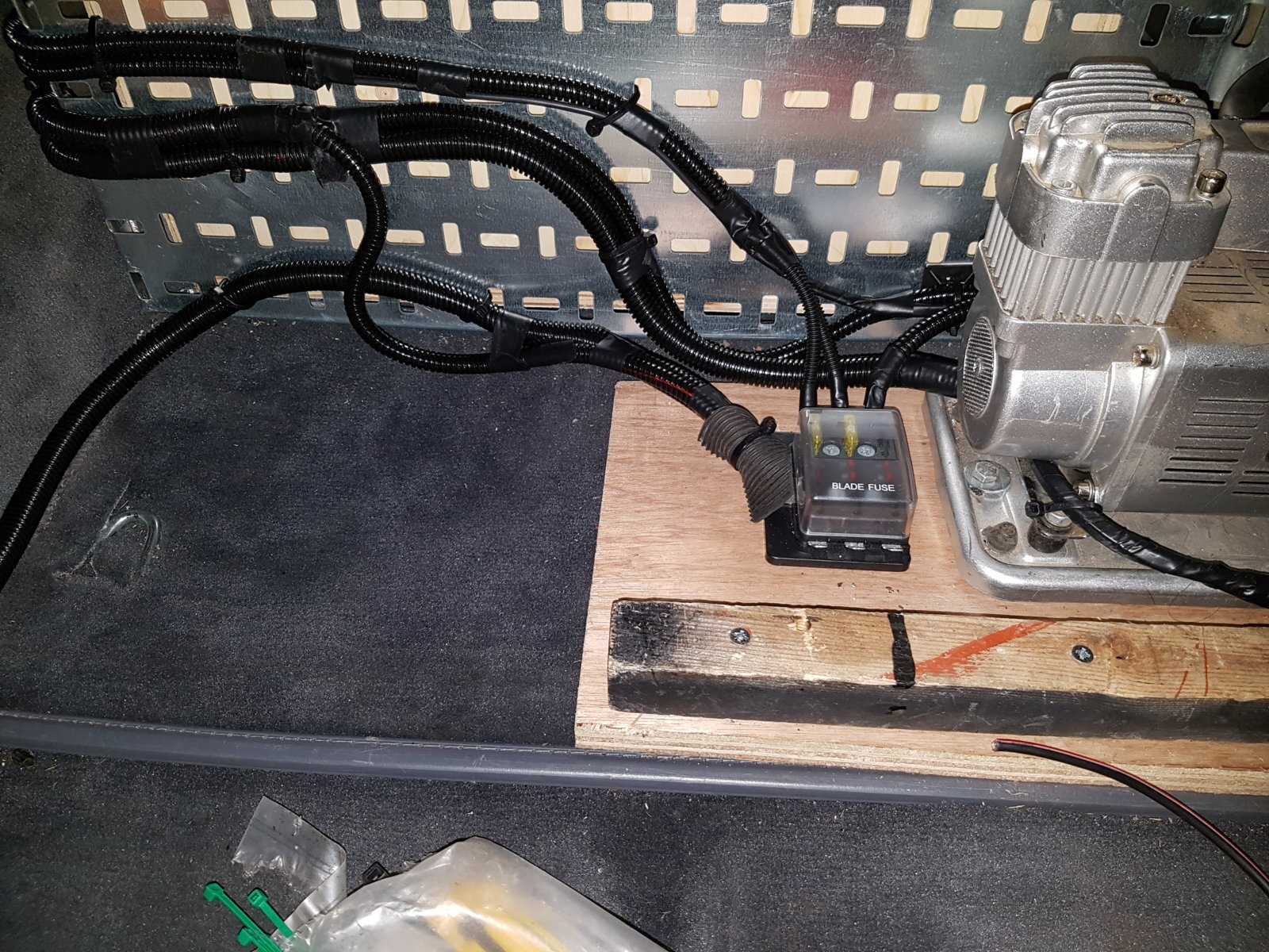

Right side tray from Karl.

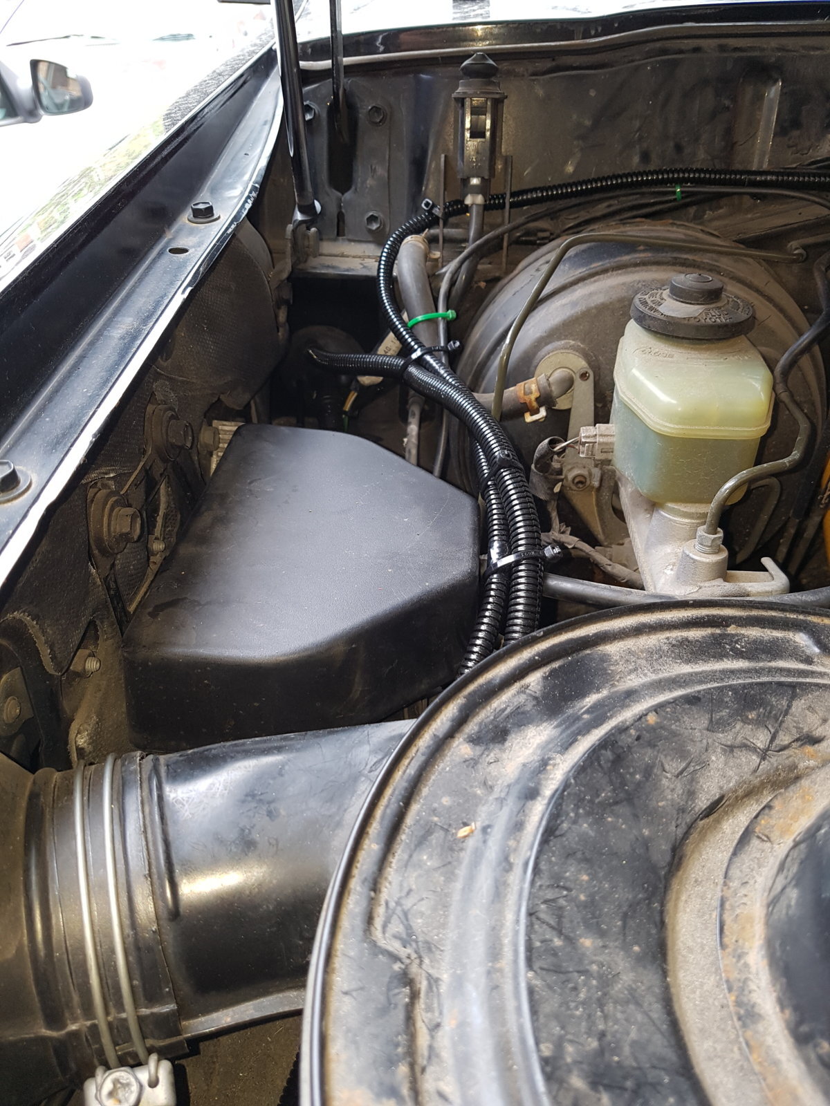

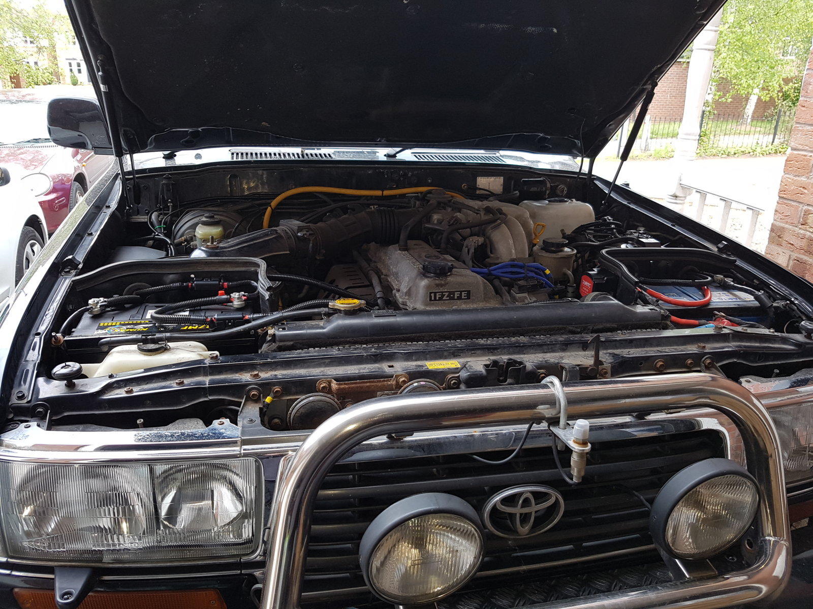

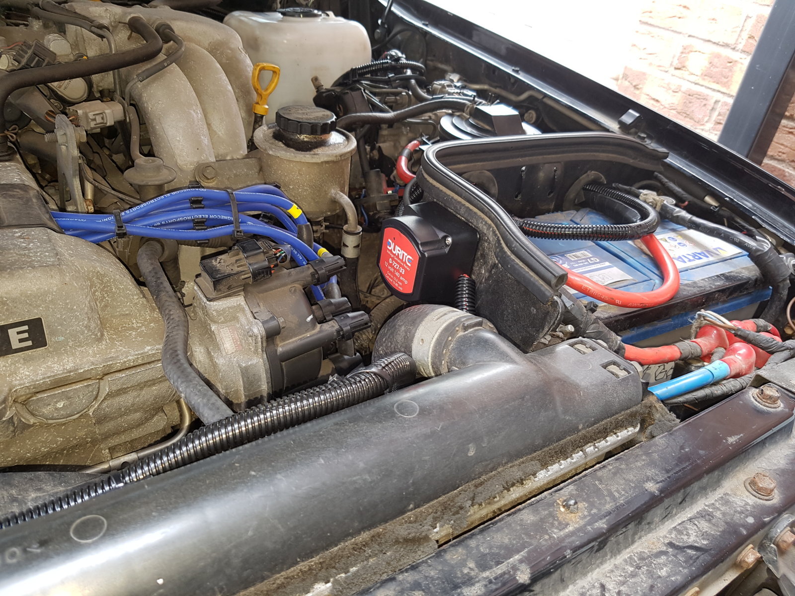

Lots of cable, conduit and fuses fitted and connected using a durite vsr which kicks in pretty quickly after starting up and takes about 5 minutes to drop back out when the voltage drops.

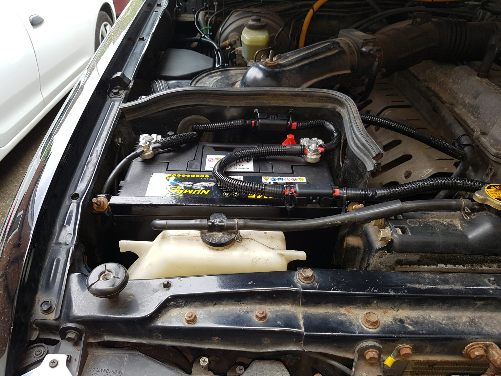

100ah numax leisure battery which has any extra electrics connected to it now.
I've fitted an extra fuse box in the back to run 12v sockets, cb etc off which has spare locations for any other bits.

The battery has the terminals the same orientation as the main battery so if I ever have a flat battery I can swap them to get me going again.
