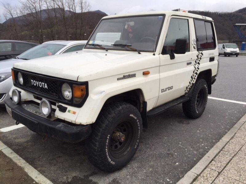

    Here I would like to post the story of my sweet Lj70 2.4 '86 LX
    I bought it on March 2016 from a guy that have had it for 6 years, I didn't pay too much for it.

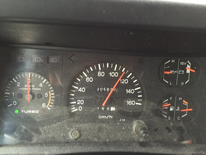

    Car had 305.800km ( 190.000mls) +2'' lift suspension kit, and km2 tires ( too worn :D )
    Car have had 3 previous owners, but it's in good condition, there is only a little rust in the usual place of lj70, but nothing important.
    Engine and trasmissions are good and this I thinks it's more important!! :D
    Here is when I went to Genova to pick it up ( about 180km fare from Turin)

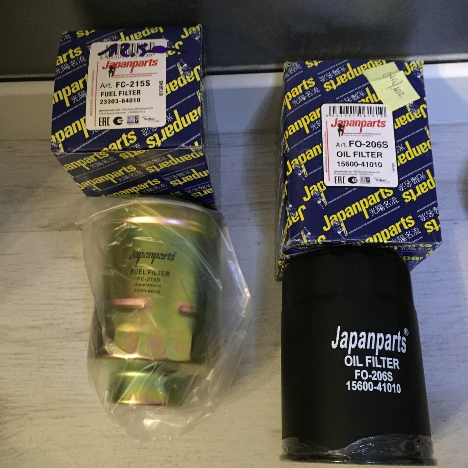

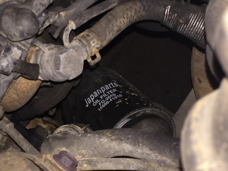

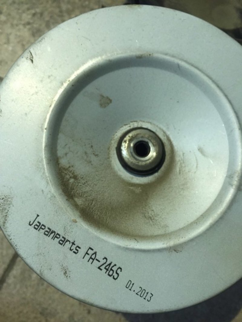

    First of all I check all the filter the aren't so bad, it was a good "news" for me

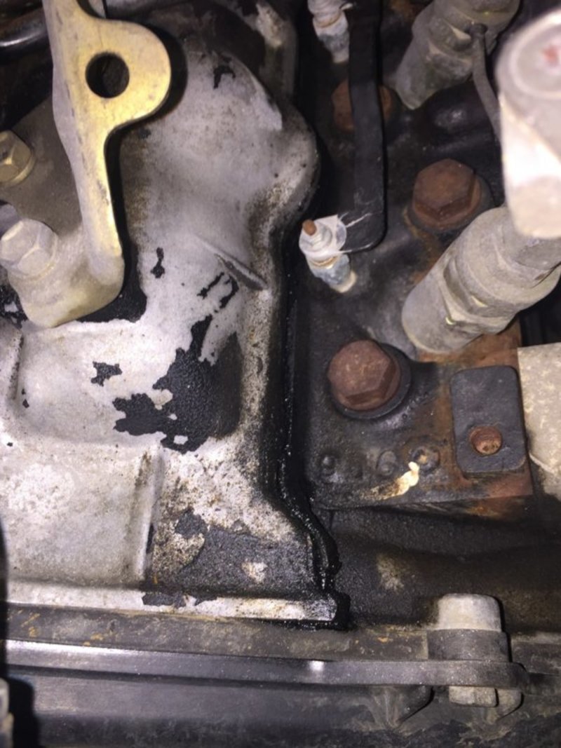

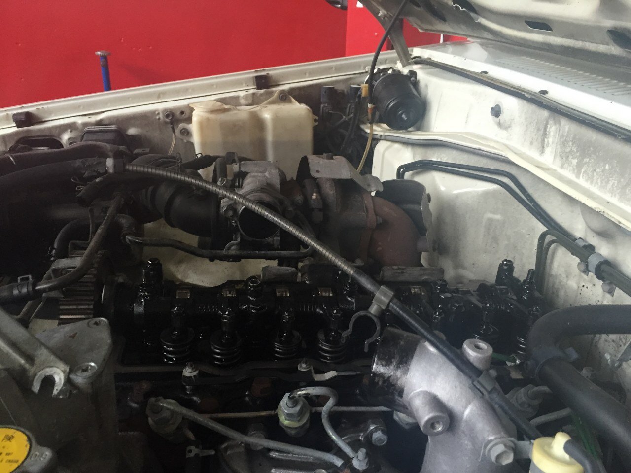

    But I see also a little oil leak from the top of the head, it must be repair!

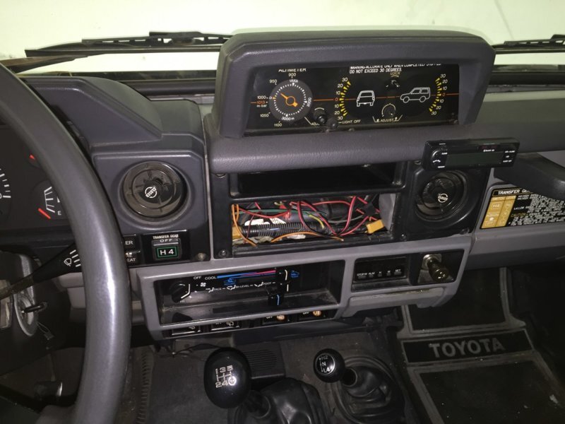

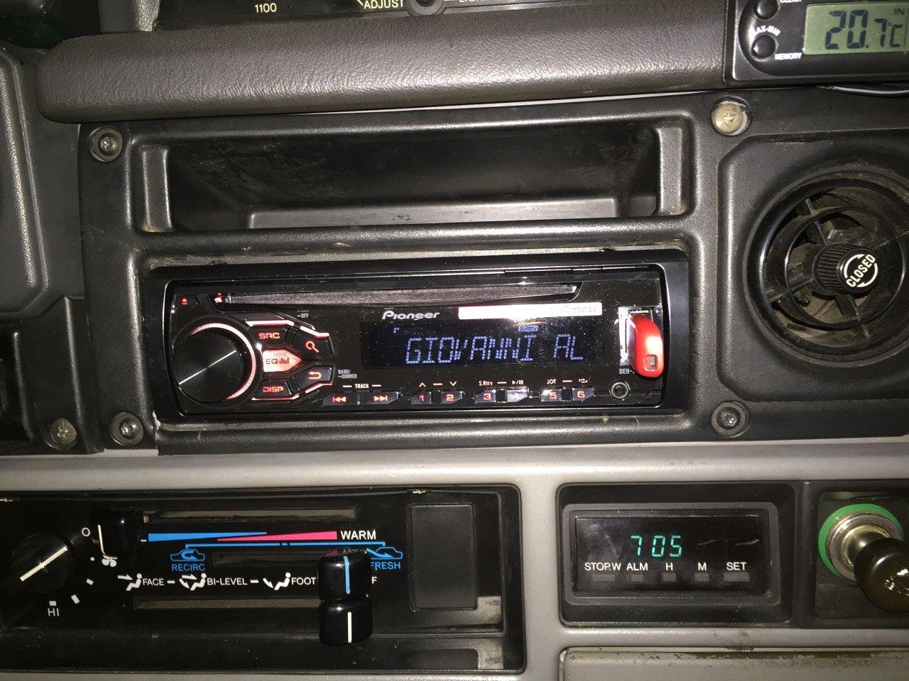

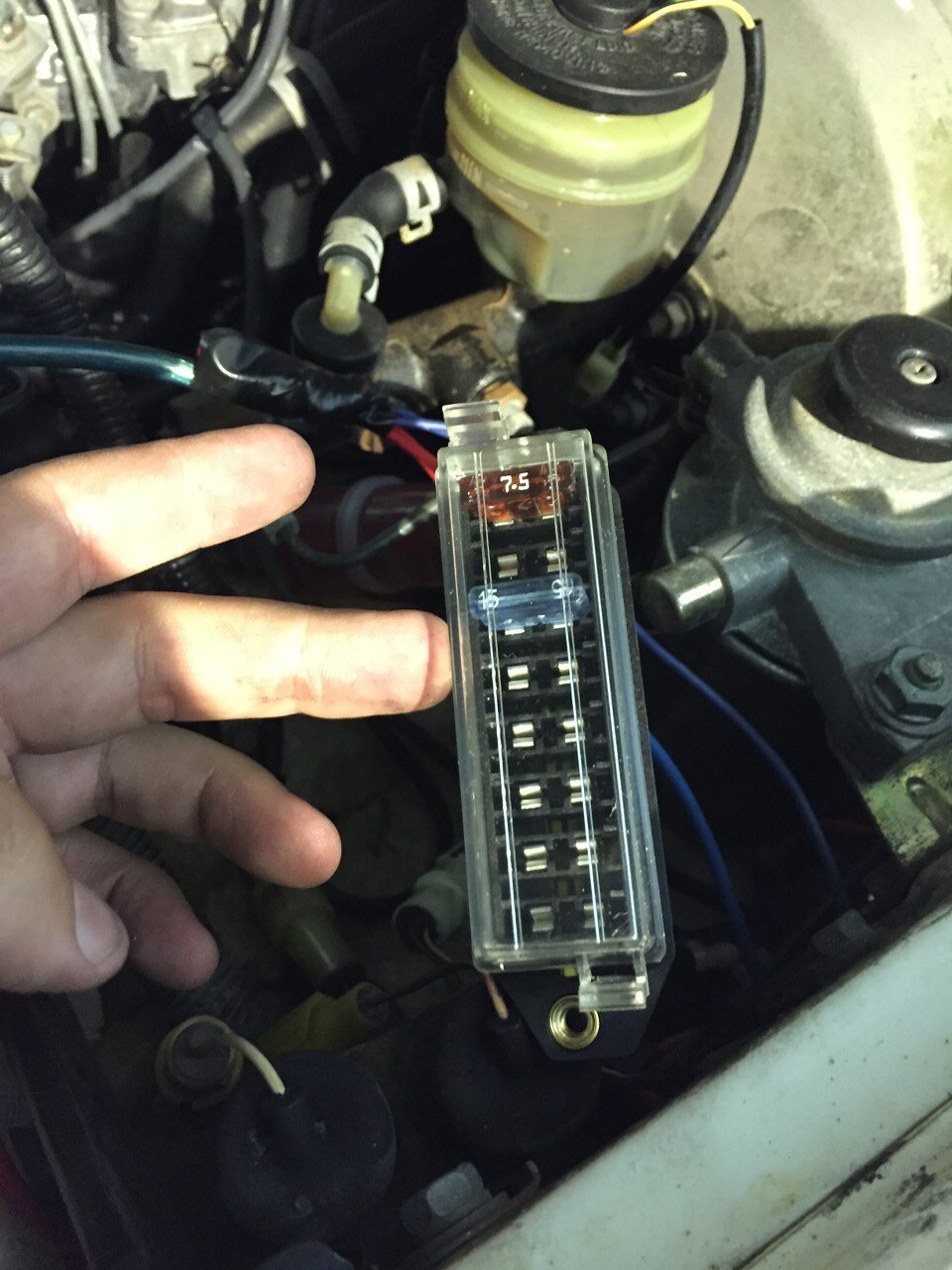

    Another problem was the radio....someone stole the radio and destroyed all the cables.
    First of all, I started cleaning all the interior, because there was a lot of glass yet everywhere!

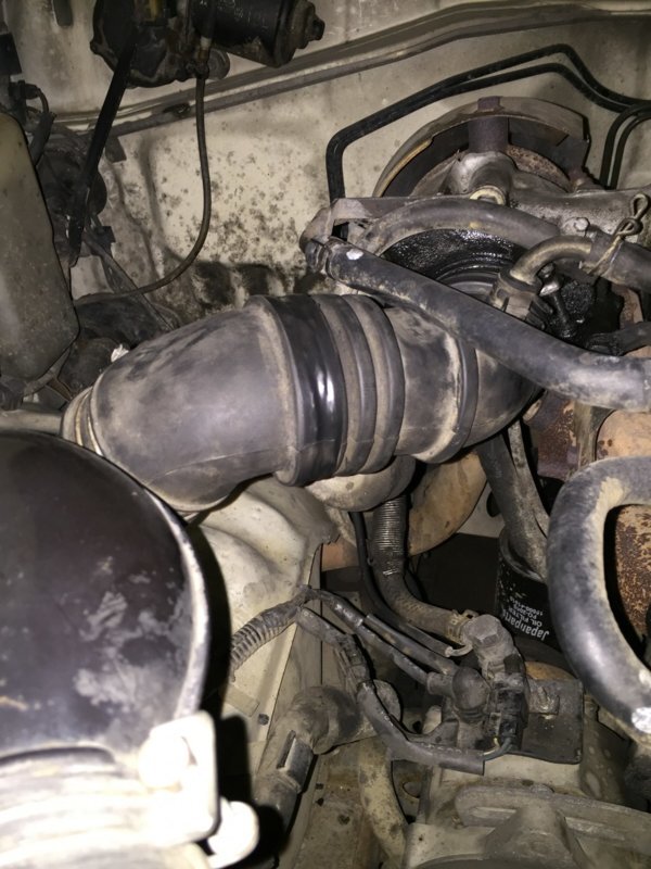

    Then I repaired a turbo inlet that was cutted with a resin and I've covered all with a a tape, not a wonderful repair but it works

    Good luck with the wiring. Always 'interesting' in working out inherited wiring problems :)

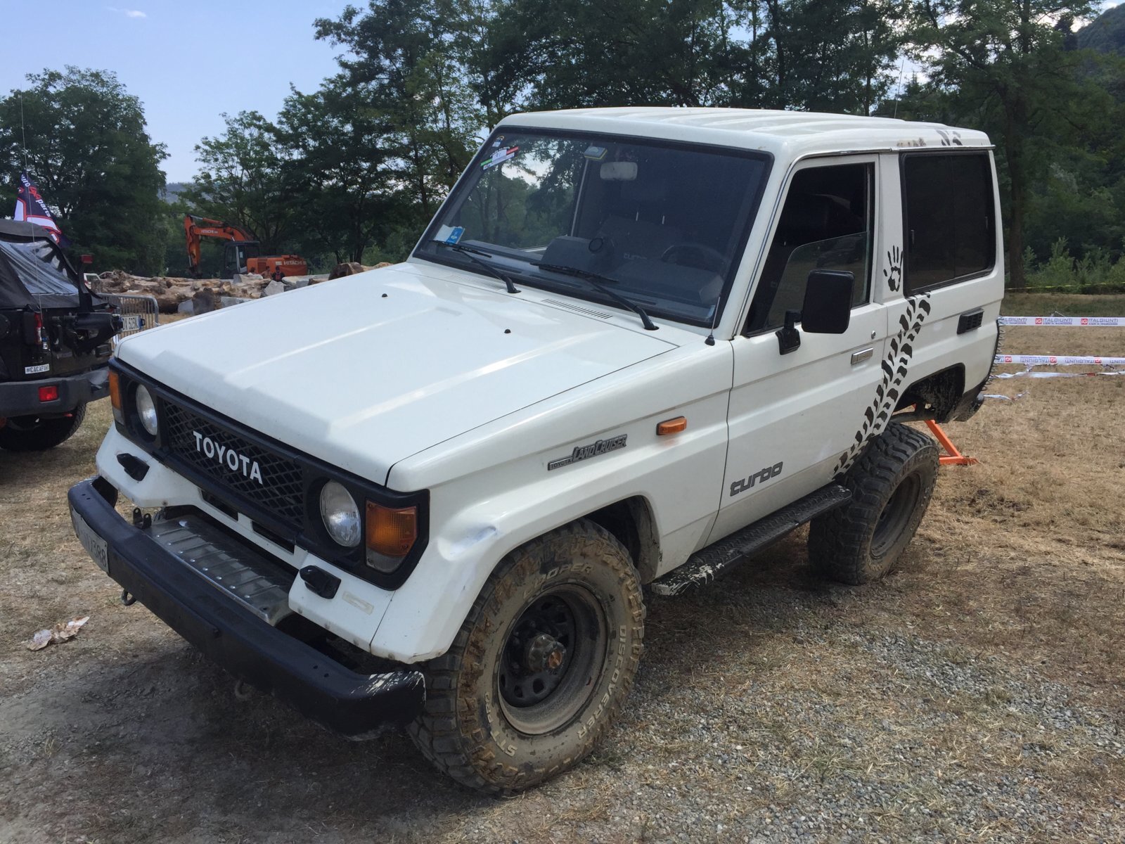

    However my first trip was on 25th April checking what is working and what are the problems with my brother that has a Patrol Y60 '89 and other friends

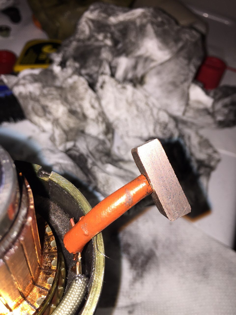

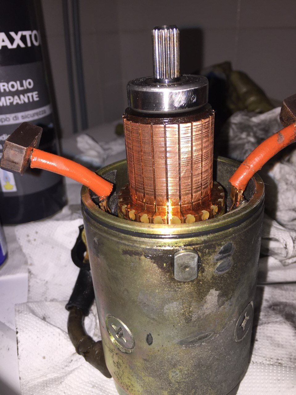

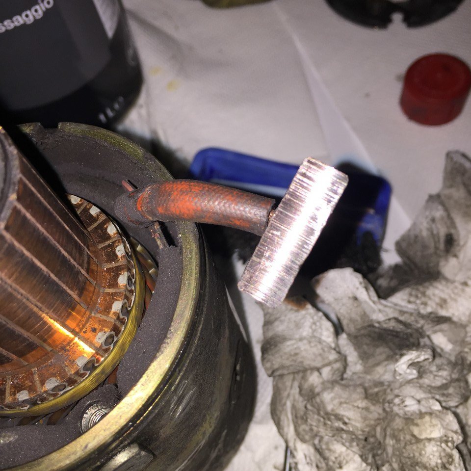

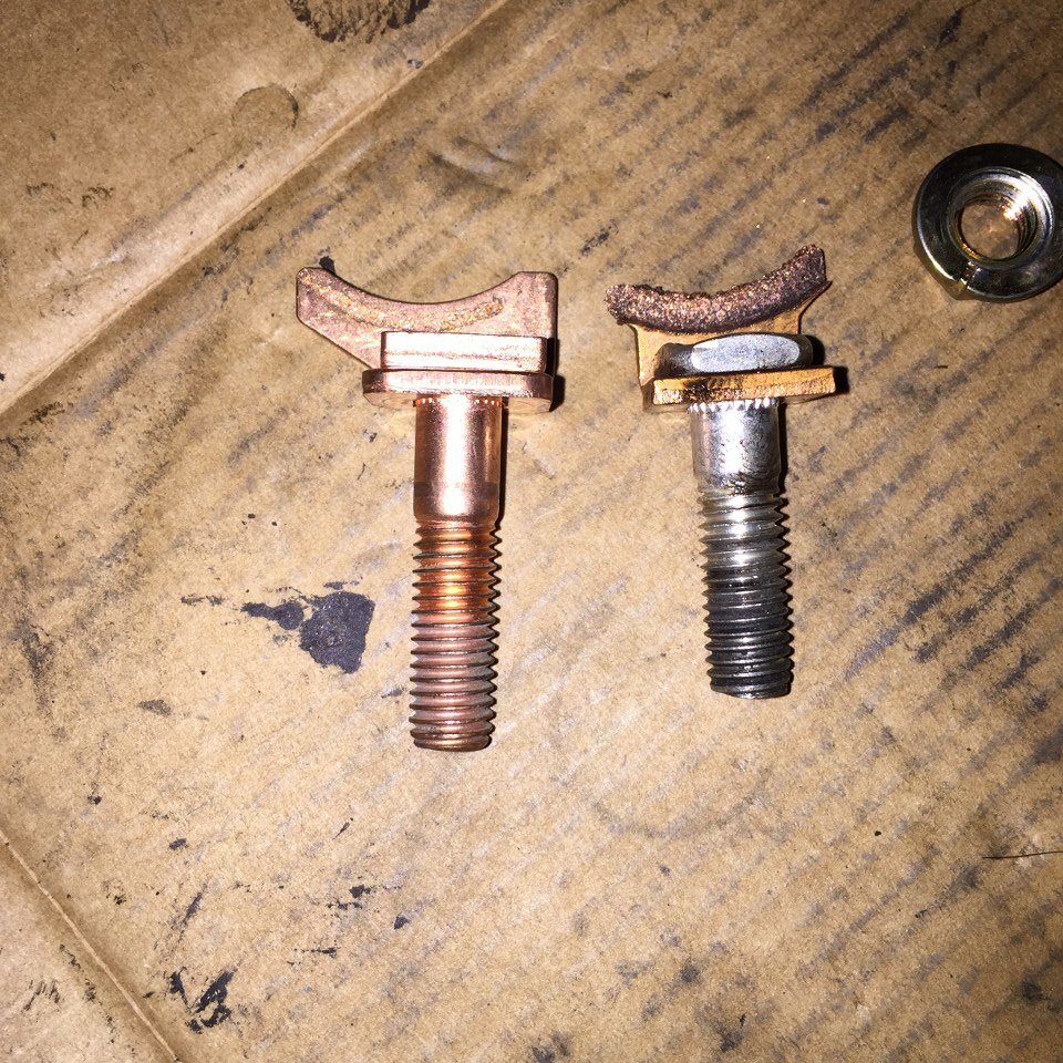

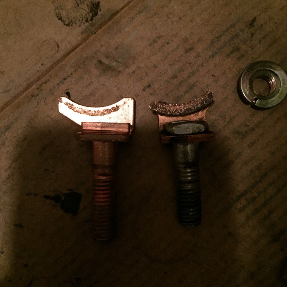

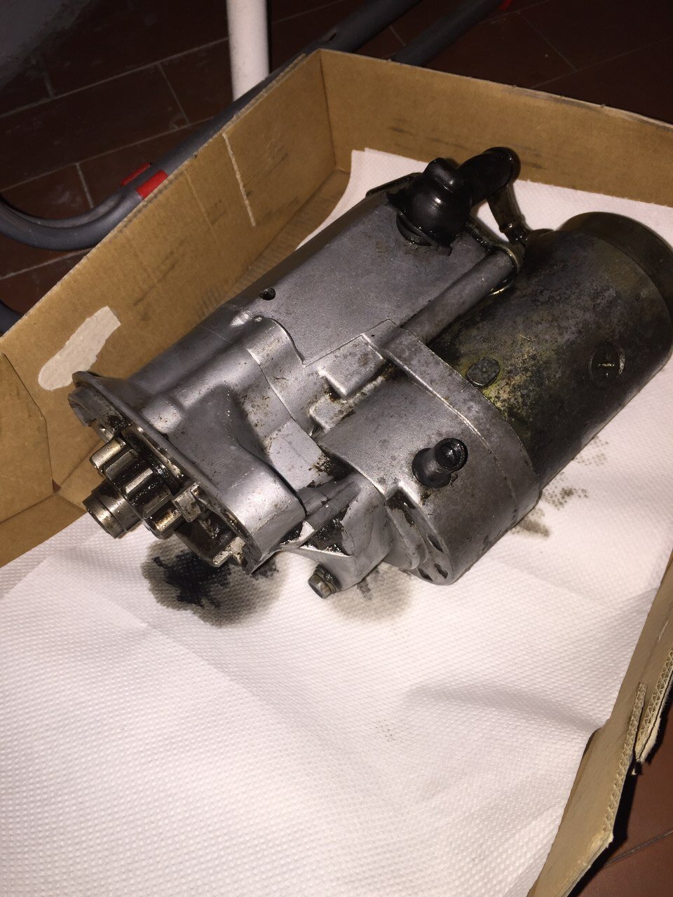

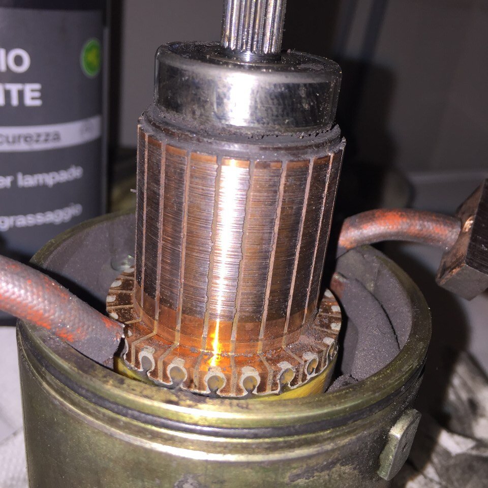

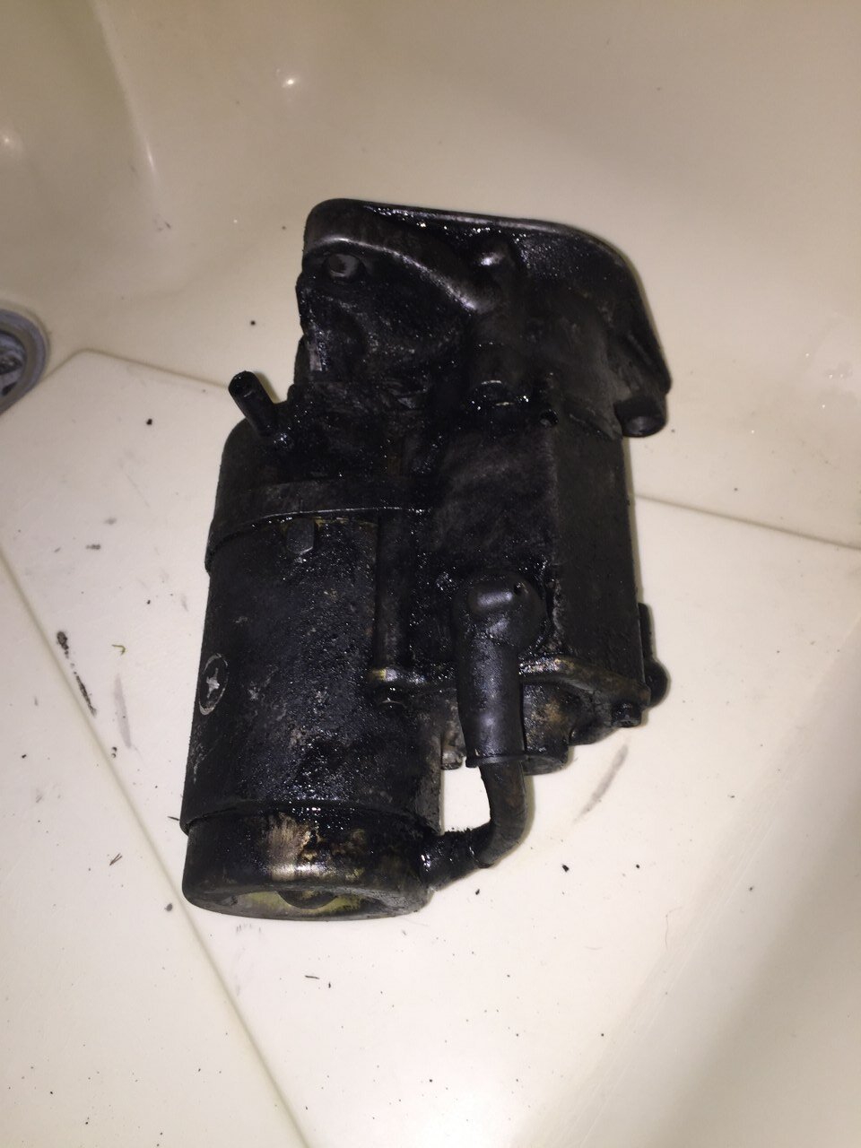

    So I started rebuilding my starter:
    First of all I had cleaned it, because the leak of the head goes on the starter!!
    I check the motor brushes, but their thickness is ok!
    I check the rotor and it ok!
    the problem was the solenoid!
    I don't have the right replacement, but I get the solenoid from a Rav 4 '95 starter!!
    So, i changed the solenoid, cleaned the Brushes and the rotor and my starter return like new :D

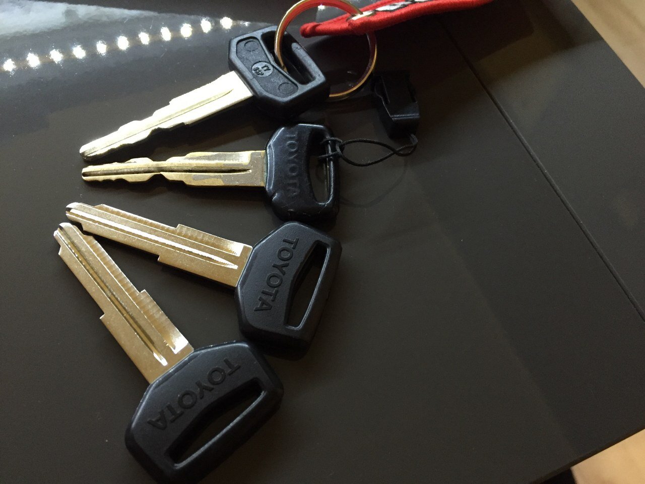

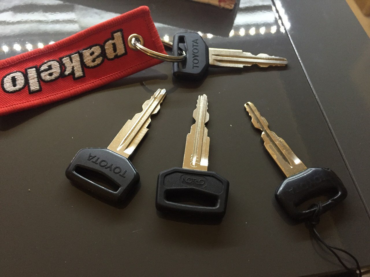

    After that I had done some copy of the only key that I had, because it was really worn-out!
    2 originals and 1 not original
    I also make a complete service, including all filter & oil, but the older filter and oil was not so bad.

    Did you get the new keys from Toyota? I need some new ones for my RJ70 project, the only key I have is really worn like yours was. :think:

    About the key, I have asked it at my Toyota Dealer and with the VIN, he ordered the 2 keys.
    I spend 14€ each (about 15$) + 5€ for right cutting in a "ironmongery", because new one arrives without any cut as you can see IMG_2449_1280x960.JPG
    If you can't find it, ask me, I'll call me dealer for the right part number ;)

    If you could get me the part number for the key that would be awesome, please. :icon-biggrin:

    This is the code on the receipt.
    90999-00084
    Please make sure that is ok WITH you VIN!

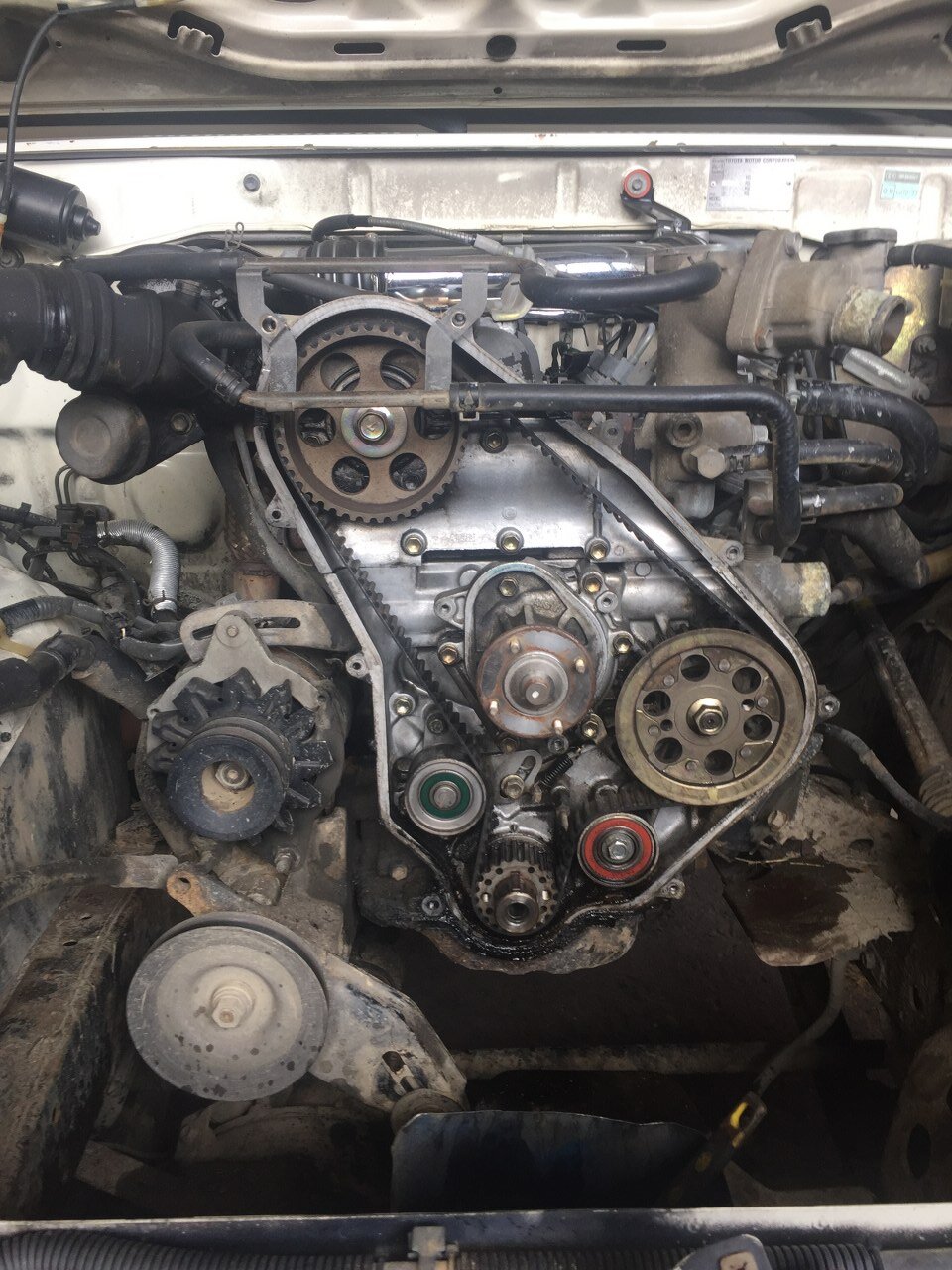

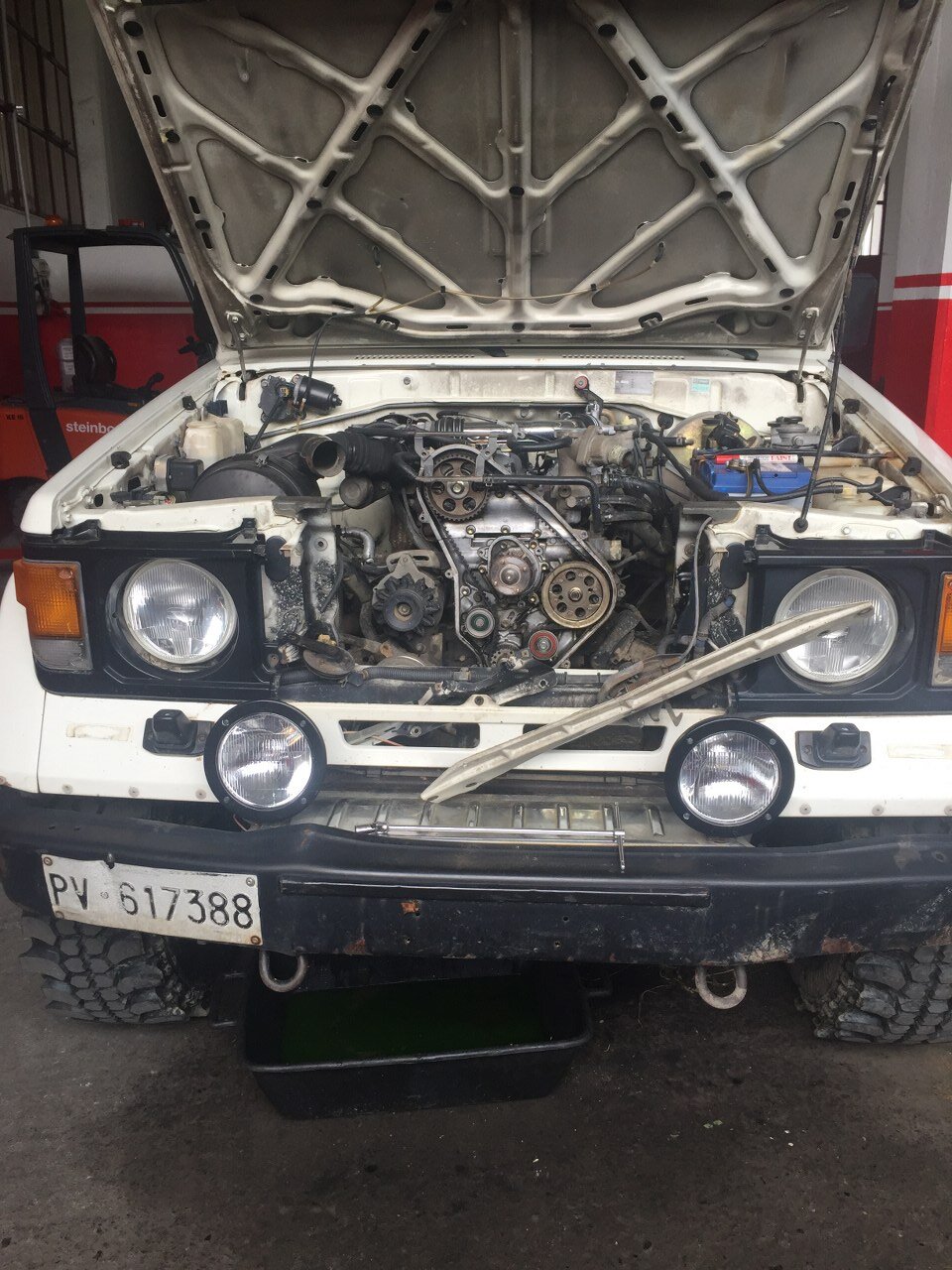

    Thanks Alexy for you message, knowing the normal issues of lj70 '86, I have just changed radiator, water pump, and fan clutch when I changed my timing belt!
    I have also changed the gasket of head cover

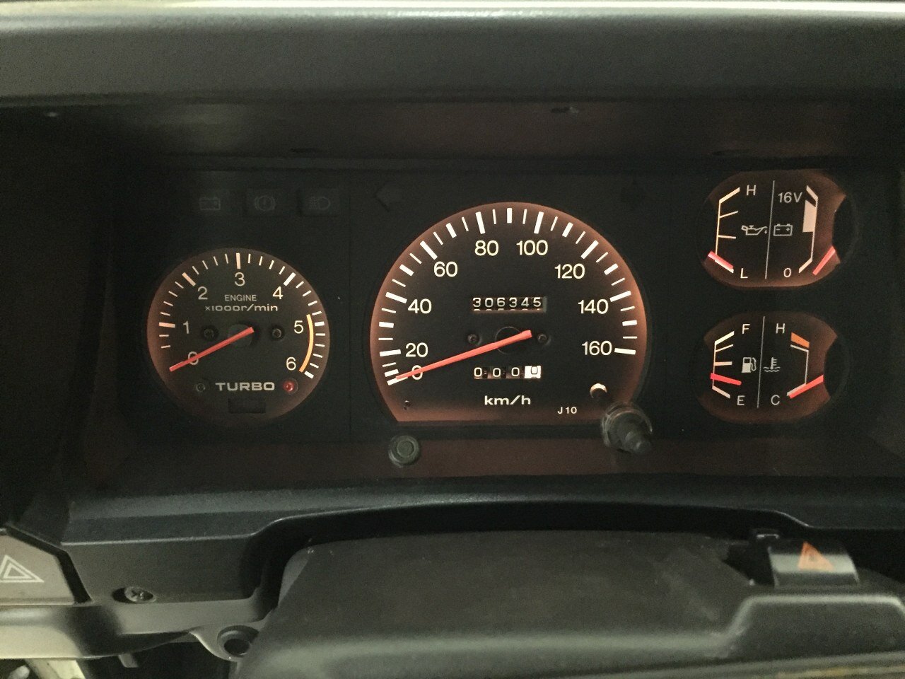

    Furthermore I changed all the lights (w5w) behind the dash, because it was impossible to read anything!
    So i put new lights and i Didn't inserted any green cover on the light, so now I have a really good instrument!

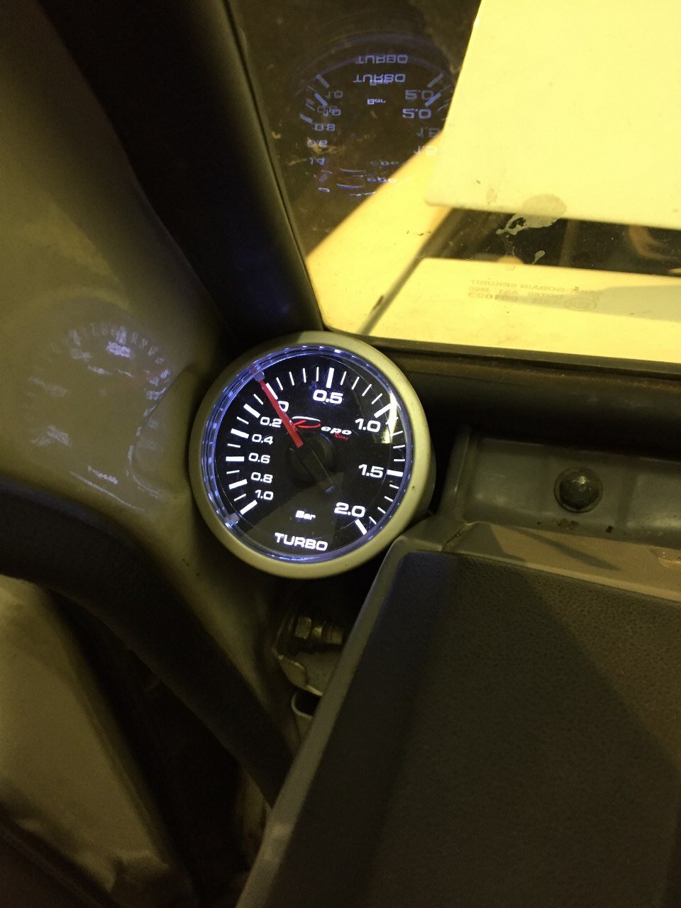

    I also installed a Turbo Gauge, because I'll later install a variable geometry turbo (GT2256)

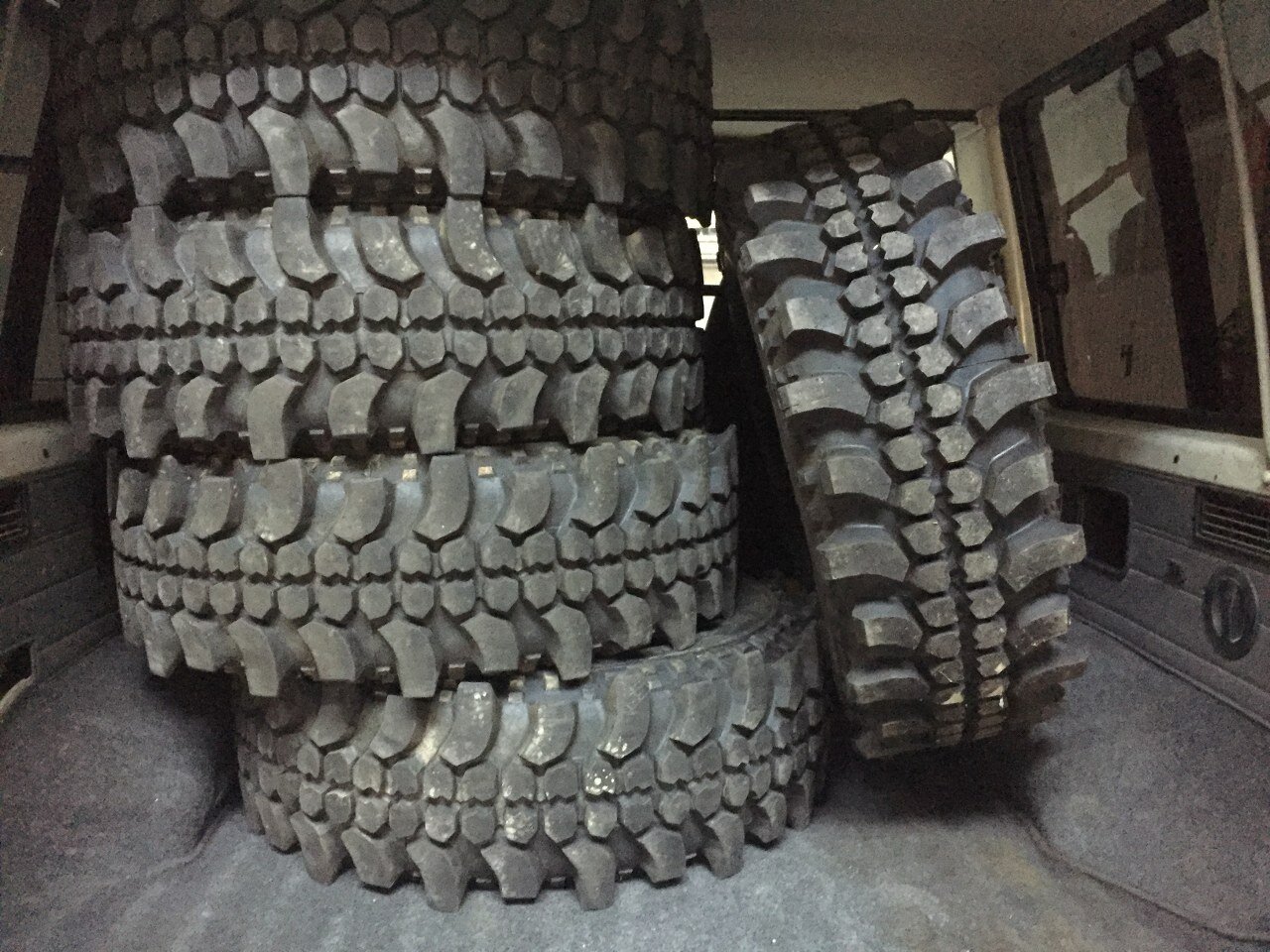

    Unfortunately my BF were too worn, so I buyed used Extreme Tyres 32'' (235/85 16)
    I little bit heavy, but very good in the mud!

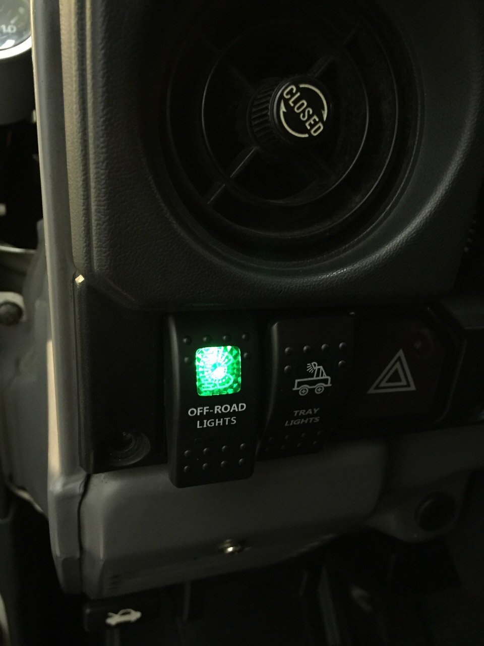

    To finish the today update of my topic I have also installed 2 new chinese switch for front and rear light!
    But rear light need to changed because it haven't a good light!
    Incredible switch fitted without any mods in a hole of instrument!! IMG_4583_1280x960.JPG

    Thanks for the part number for the blank keys mate and great work on your 70! :thumbup:

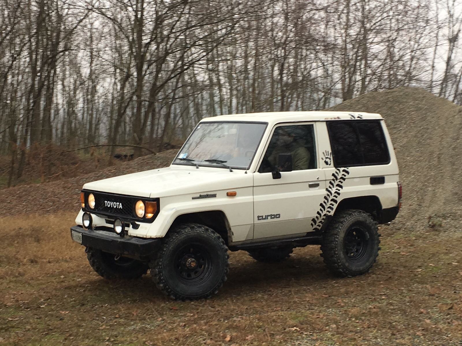

    Hello Guys!
    Some updates for my topic!

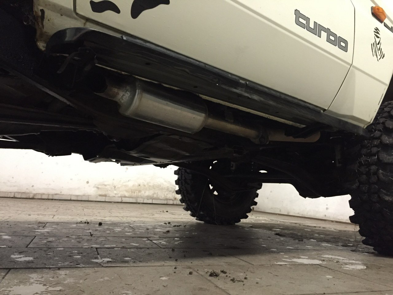

    I have tried a short exhaust on my lj: feedback was really good, I get more power at low rpm (incredible!) but noise was too much, so after some weeks i decided to sell it!
    During september I have had a wonderful trip with my friends, in two days we covered more then 300km off road between Italy and France, on the Salt Road, but During this trip, my master cylinder left me!

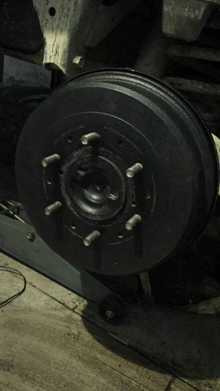

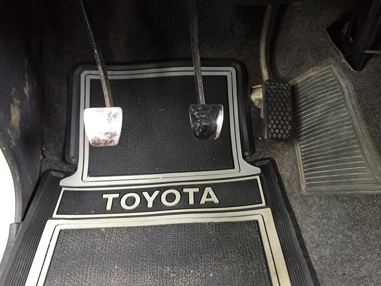

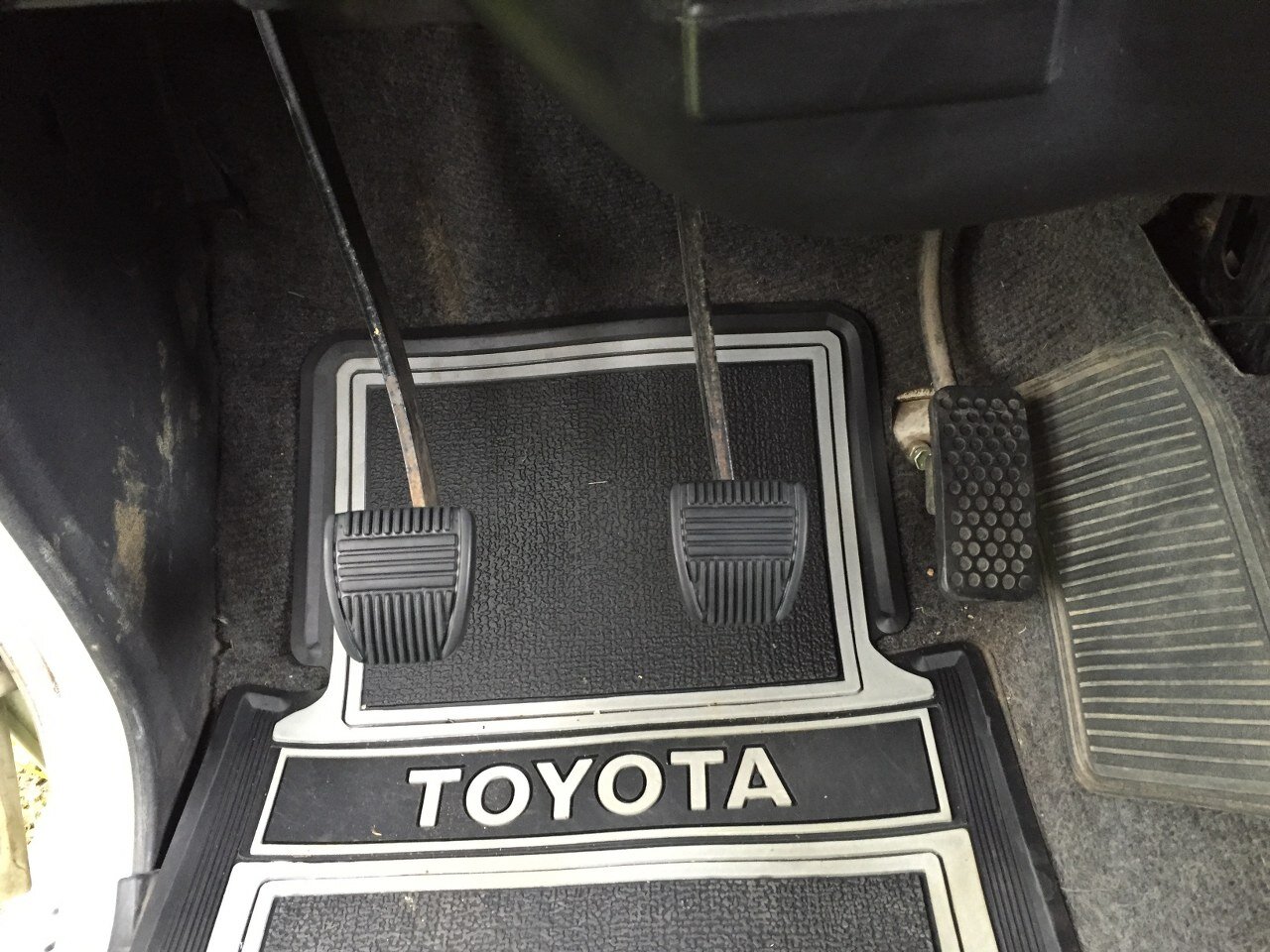

    I can't brake any more!! I need to use low gear to stop my car!
    It was really annoying, so i Decided to change all the brake parts!

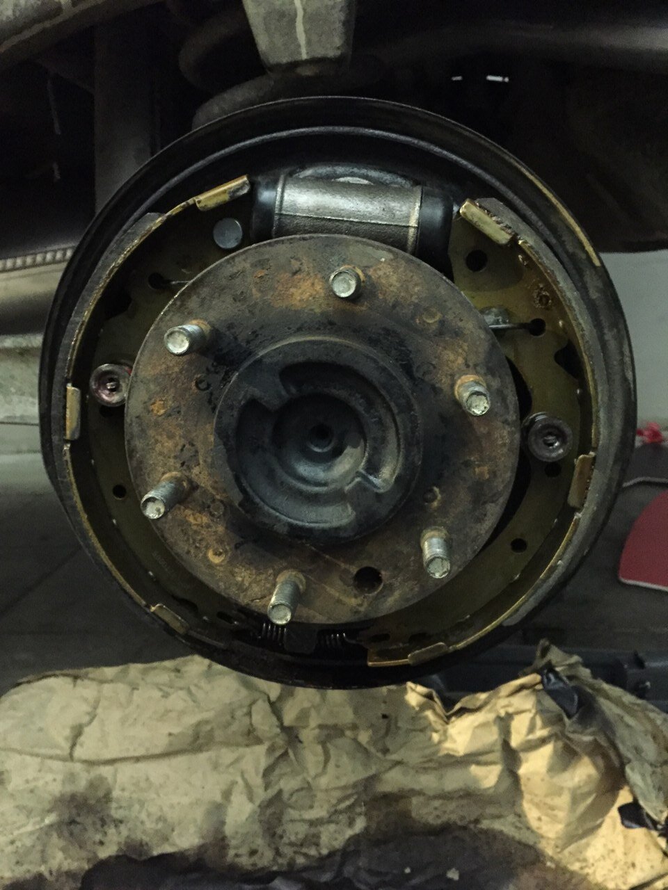

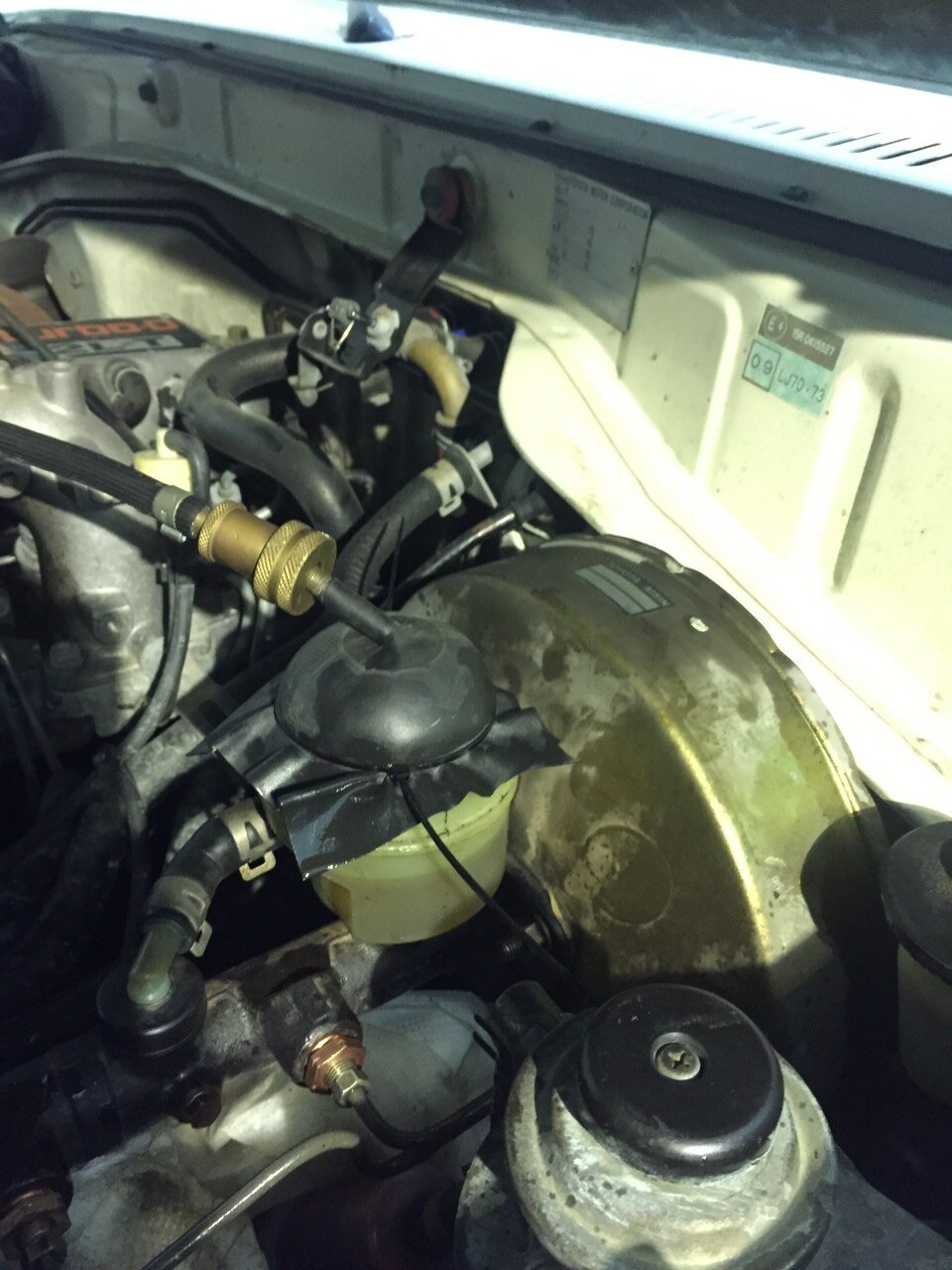

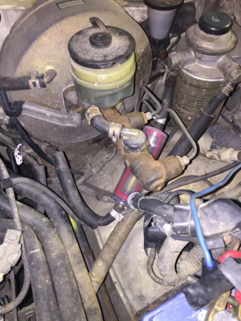

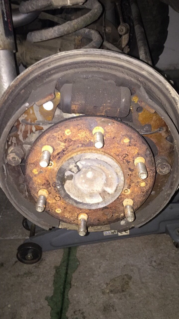

    I started from the rear drums! I had problem with handbrake system! It was completly blocked from the rust!! After 2 hours i win! Now the rear was like new!!
    With master cylinder I have had some problem!
    New one bought was not ok!
    I bought a repair kit for the old one!
    I was alone, and the oil bleeding was a problem, because i need to press brake pedal and open the bleed screw together !!
    So I cutted an old inner tube of bicycle and use It like a bleeder pump! IMG_6106_1280x960.JPG
    It was a bad work, but it WORKED :D :D
    Now I would like to change brake line, and all the parts of front calipers!

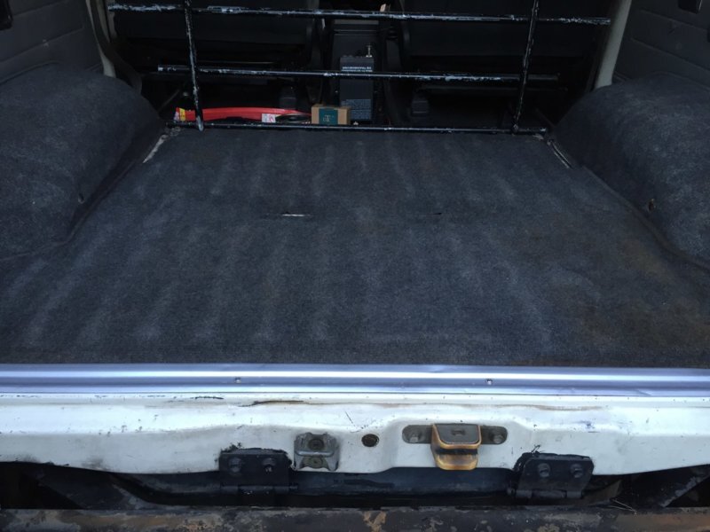

    After that I'm trying to convert my lj70 from 2 seats to 5 seats, so I have eliminate the grill behind the seats, restored the old holes where the seats were fitted, and installed again old rear seats
    I also installed originals front seats because actual one are not reclinable
    Another problem was rear seat locking because it was impossible to find the original lock system, so i've made it alone
    and that is the result:
    It was also impossible to find original rear seat belts, but I found front ones and they fitted without problems
    after a good cleaning :
    Now I'm waiting the MOT (it's called so?) for the homologation of this modification, and homologation of new tyres set, cooper stt pro 31x10.50 a real good polyvalent tyres (extreme are also ready to use if necessary :D )

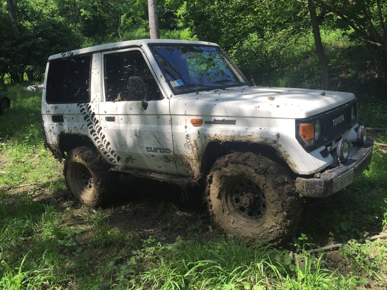

    Here is ours last trip testing new tyres in the mud :D
