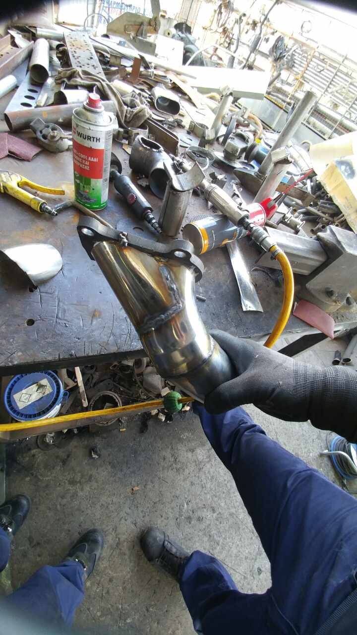

I’ve been going the ‘make your own downpipe’ route (well, get someone else to weld it that is). Made up a jig from the scrap downpipe Trevor kindly brought to Stratford (thanks Trev :) ).
Then cut all the bits. Then started having flanges made up as I couldn’t find them. Then looked on eBay and found them, so cancelled the flanges (well what’s left of them). Got this far.
I was dead impressed (shocked actually) that I folded up the bracket to all but fit first time! This is following the standard parts and will be interchangeable as bits fail.
Flanges due in this week. MOT at the end of the month.

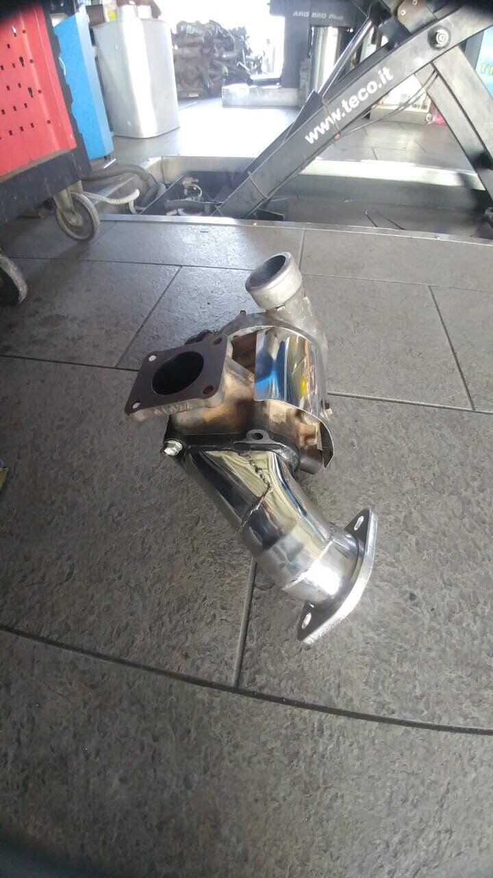

I’ve looked at this quite a bit (well, the spare one I got from Simon) and I reckon there’s little to no benefit in replacing the dump pipe as the one on the 80 is short and direct and probably exceeds the actual output of the turbo itself (would be good if someone has a turbo they could measure). The other thing is it looks an utter bar steward to fabricate the tubing around the bolt holes and still be able to get in and fit the thing.
I therefore decided not to bother and to go 3” from there onwards.

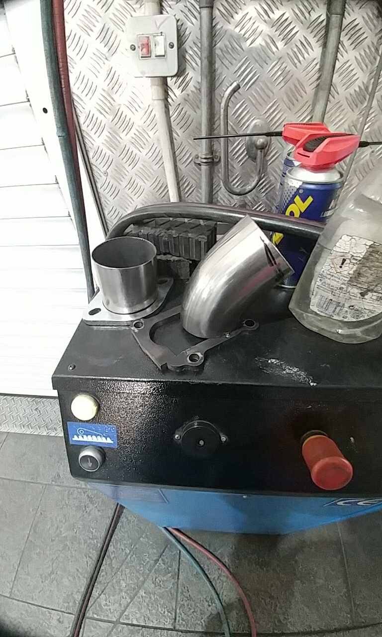

This one was made Richard on mine....I have the old flange in storage.....What measurements do you need?
Thanks Dervis, I was thinking of the port inside the turbo where the exhaust just leaves the turbine itself. Where the turbine pokes it’s nose through. :)

the general consensus is the stock dump pipe restricts flow. im all for challenging the norm. I guess the only way to know for sure would be a flow/pressure test, or however exhaust performance is tested.
Sorry I thought you meant the flange part of the exhaust. My turbo is at the cousin garage in the city. Can have a look next time im there if no one helps you out before then.
Just wanted to point out that there is a significant size difference from stock to a 3.5in flange connection shown here.
Basically and it must be basic because its the way i see it , when the turbo wastegate opens , every time you back off acceleration , it bleeds off pressure into a standard downpipe already working near full capacity . 3" lets it simply dump the boost pressure so it can start building again . Your not removing restriction so much as freeing your turbo to do what is does without an unnecessary hindrance .
Sounds technically right there Shayne. Only thing ive yet to add to the mix is a larger turbo that which im sure will utilise the larger down pipe and exhaust as a whole.
