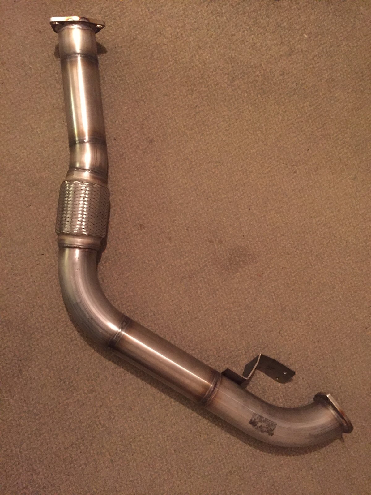

It seems the throat of the turbo is around 60mm (thanks Mike for the measure) so the elbow off the turbo is larger at the 3 bolt flange at 65mm. It’s fair to say it’s a pretty tight bend that’s more of a plenum with a hole at the bottom than anything nicely swept so a nice easy bend would be better I’m sure.
I’ve decided there are far more restrictions within the factory system than at the dump pipe so at least for the time being I’m going to leave this part and concentrate on the downpipe followed by the rest of the system as and when it needs replacement.

If you decide to leave the dump pipe and go for the three bolt flange this
https://rover.ebay.com/rover/0/0/0?mpre=https://www.ebay.co.uk/ulk/itm/132245719958
was the one I received today from Germany after ordering Saturday.
Nearly finished, just got to trim off the excess at the flanges, fit an internal reducing cone to get round the step from 76mm to 65mm into the factory centre section, add some gaskets and bolt on. Then fabricate a stainless clamp for the enginevend and that’s that section complete. If I need a resonator in the first section I can cut one in later.
