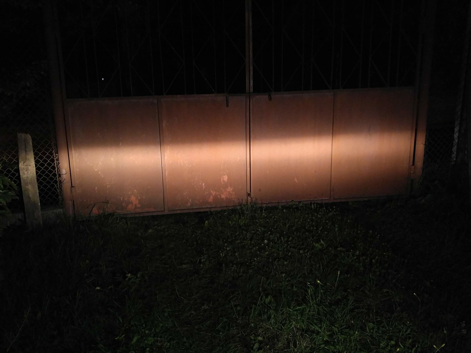

    @Steve Wright - about these new fog light - very nice finding indeed. If it's not too much trouble, may I ask you for a picture of the light pattern they produce on a near flat surface (wall, garage door, etc.)? I am interested if they have similar cut-off line as the originals.
    To illustrate what I have in mind, attaching a picture of the pattern made only by the left hand side fog light on my truck, from about 3 meters away from the door. The right hand one is gone; half filled with dirt, sand, salt etc.
