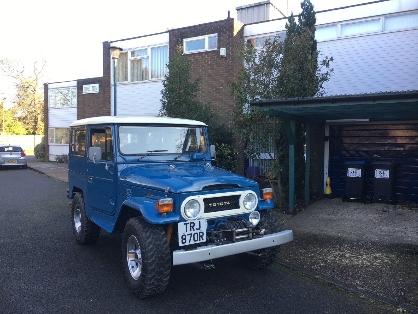

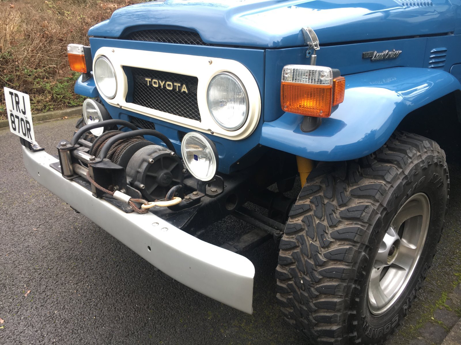

The truck is now back with me in Wimbledon. Had a good drive back up the A3, having only 3 gears wasn't as bad as I expected. Cruised along at 80km/hr hitting 100km/hr a couple of times no problem. Had the biggest grin.
Before leaving we'd taken it for a drive and had played around with the radio. On restarting after 5mins standing we had to turn the radio off to get it going. The garage had already suggested a new battery but I don't think they checked it.
I've had a mate jump start me over the weekend, but also had times when no one to help and had to leave it, but then it would start 20mins of several hours later. It sounds like the battery isn't turning the motor over quick enough, and drains away after several attempts. Earlier today I got it going but didn't let it run, turned it off but couldn't get it going again.
I did manage to flip the bezel all by myself!
Would have been great to have you help out, sadly Bognor is a bit far. Would be a good summer run though.
