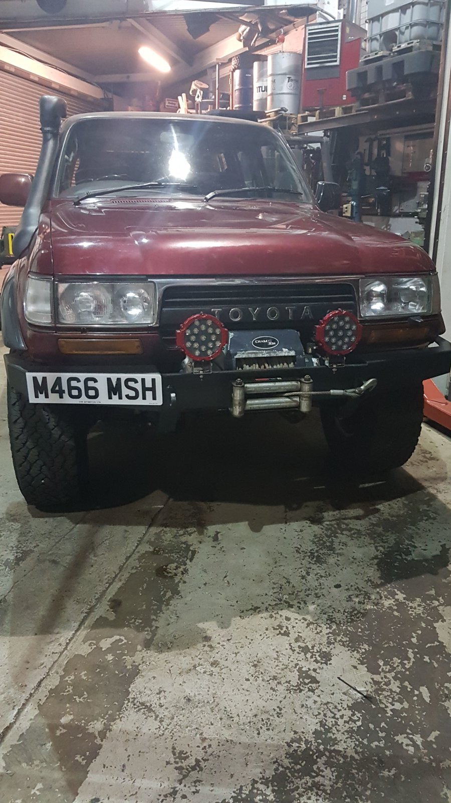

And so after 9 months the old beast finally drove out of the garage the other day. It's not 100% finished yet but the basis is certainly there. It's now structurally sound and has the main metal add ons that I was after. This thread is for the complete vehicle, ive done a few on certain parts like the back end and axles. I'll try and list everything that's been done but will definitely forget half of it!
-new clutch after it wouldn't drive home above 3rd gear
-removed back axle, rebuilt every single mount from scratch and made from 6mm metal
-new rear diff lock
-2nd hand rear backplates
-new handbrake cable and shoes
-cut 1foot off the rear of chassis as rotten. Now made from 5mm box and extended for winch and swing out carries
-custom rear wheel carrier
-twin jerry can holder
-rear winch
-rewired abs as light on (causing diff lock faults)
-both rear trailing arm mounts replaced on chassis as rotten (thanks mike)
-new 2nd hand front axle cheers Andy
-new 2nd hand front diff and locker cheers Andy
-replaced all axle bushes
-pedders 2inch springs and foam cell shocks
-pedders foam steering damper
-all new brake pipes, braided rubber and the metal ones
-complete swivel rebuild all bearings seals 3rd
-front winch bumper cheers Karl
-2nd hand pair of inner wings and front panel cheers Andy
-fuel tank gaurd and straps cheers Andy
-repairded various body mounts
-made new rear body mounts
-safari snorkel cheers Andy
-painted all chassis and axles and suspension arms por15
-custom made rear trailing arms 30mm solid bar
-new arb bushes
-4 new track rod ends
-new brake master cylinder as leaking
Off the top of my head this is all I can think of. Next plans are for a load of wiring, Alarm, tracker, split charge, winch wiring, lights, cb. Then make myself a rear organiser to split the boot up, already got a fridge slide. Maybe some mud terrains if the at2 don't bite enough. Hopefully get it tested next week or so them it's time to put some miles on it!
