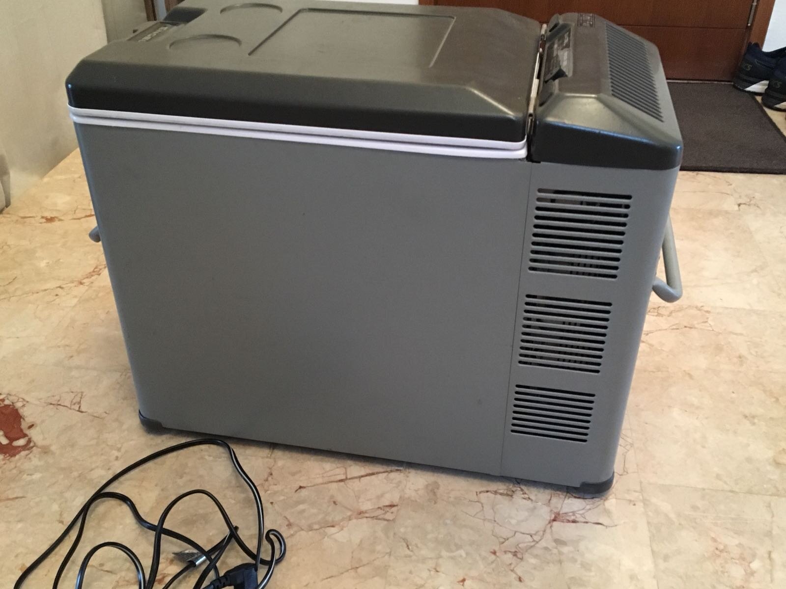

Just been offered a second hand yet hardly used Engel MT45F from the UK here in Cyprus. This looks like a good fridge / freezer.
Guy wanted £430 for it. Is that a good price guys?
Would appreciate your advice
WhatsApp Image 2018-02-17 at 16.37.0.jpeg WhatsApp Image 2018-02-17 at 16.37.1.jpeg WhatsApp Image 2018-02-17 at 16.37.01.jpeg
That's OK I'd say. Engel are good of course and unlike cheap units can be serviced and repaired. The only thing I'd say is that there are no internal divisions on there and from my experience, you end up with stuff just piled up in there. Worth looking for some alternative baskets or a divider to just keep things a little more orderly.
Yes Chris I'm aware of no divider maybe look into the if I feel its what I need later on.
Thank you
@Dervis Garip thats not a bad price, make sure you have all the leads, I didn't get the 12v lead when I bought mine and ended up having to get one sent over from the US which was still cheaper than getting it through APB, a total PITA.
Also the latch is a weak point, I've seen a couple where the latch is so loose it barely keeps the lid in place.
Thank you Rosy its has both leads 240v and DC with only being used three times the owner says so should be ok. Just one slight din on the side lid though :|

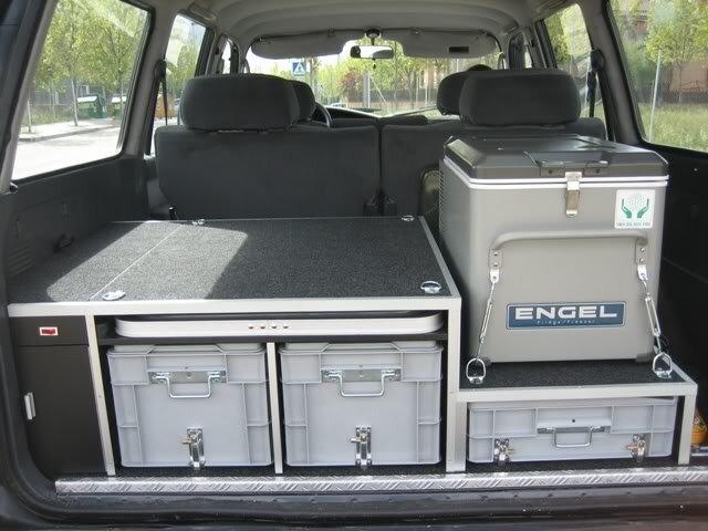

Definitely put the fridge on the floor, ideally on a plywood false floor and if you can afford a slide, they make accessing the fridge even easier.
This is my setup, which after doing it totally wrong on my first 70, where by I fitted a huge set of heavy drawers, then put my fridge on top which ended up getting mounted on a big heavy, awkward MSA drop slide as it was too high to see in, I think I've got it spot on this time. :dance:
I've found not filling the entire boot space and leaving some floor space empty has provne hugely useful for putting things like a bag of fire wood, the babies pram, heavy car parts I dont want to lift up high. etc. :think:

Thats a great setup thanks for sharing and yes I'm on a budget to make something work here. Defiantly gonna have the fridge low as its pretty tall like your setup.
Had a meeting with my carpenter today and upon measuring in detail and build requirements the margins appear to be smaller so its gonna be a one draw setup and pull out fridge now.
