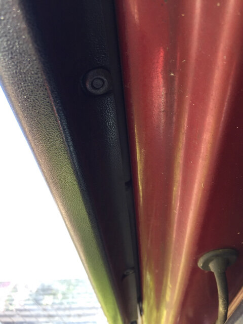

I have taken some photos of the light so that you guys can see what light I am talking about.
As you can see, they are busy with sanding and want to get that light out of the way as soon as possible, so any speedy advice would be very much appreciated!
There are no visible screws, clips or other on the inside and the entire roofline has been taken out. :confounded:
Hey there. Unfortunately it’s just a click off job, which always runs the risk of snapping some plastic right? The black plastic cowling just snaps off, made more difficult by the tapered ends. Then the base plate unscrews from the body. I’ve used the rubber grommet inside to feed electricity to my roof lights.[/

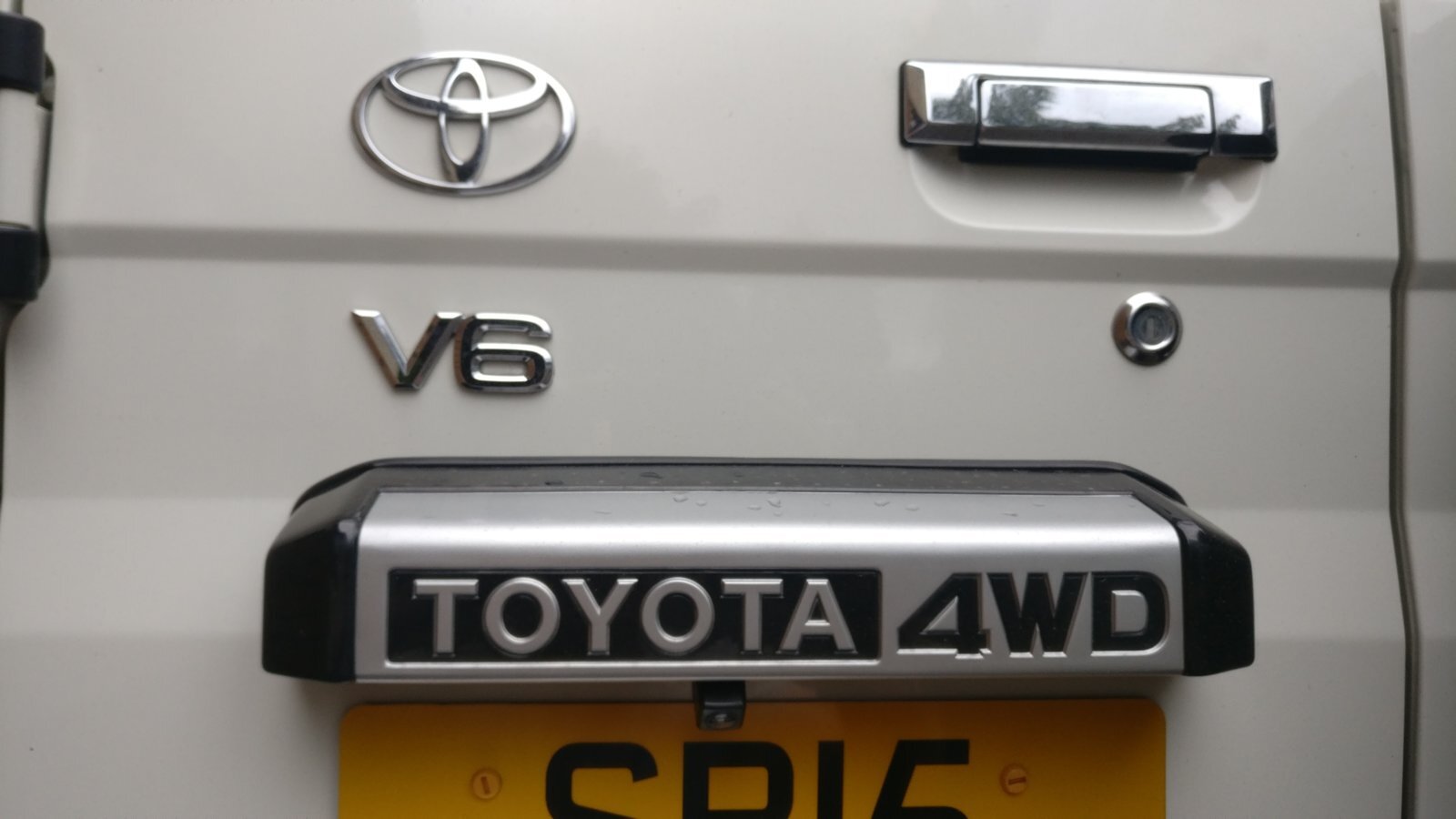

Hi mate, I found mounting mine here was straight forward enough for running cables and tapping into the reverse light for power / auto screen switch.
Viewing angle showing enough of what's going on and the edge of the bumper. Just got to remember about the spare wheel lol.

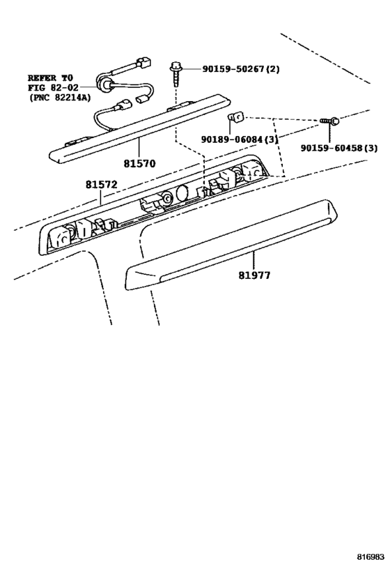

Found a diagram for the light. I wanted to remove mine so I could clean the bodywork around it. Haven't attempted it yet though.
Thanks Mike - Very helpful - I will give it a go and let you know what breaks and what doesn't - looks like there are 2 lugs on the end of the black surround that pull out - will spray with some lubricant first to loosen the dirt and assist in getting them out :)
Success! - Was extremely tight - I didn't think it was going to come off without breaking - I had to lever each end a couple of mm and then spray lubricant onto the 2 lugs - use a long thin directional tube on the spray can nozzle to get the lubricant in. Wait a few minutes to let it soak in and then at each end - then underneath push a flat bladed screw driver or such in between the trim (81977) and the mount (81572) - using the gutter with some shielding for leverage. I had to use a fair amount of force. I ended up with some minor scratches on 81977 as I couldn't get a grip on it with the flat screw driver as I levered it - If possible make a tool like a 7mm wide flat screw driver with a 1mm lip on the end of it to push in and hook it under the bottom of 81977 at each end and then lever out. (polish the end of the tool smooth so it doesn't scratch as you push it in) Lubricant is a must or it will break as it is very very tight. Good luck!
Nice one good effort. At least 81977 isn't too expensive to replace. Megazip want about 29 US dollars.
