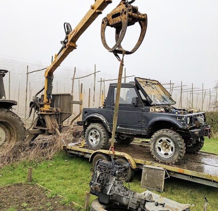

    Haha I try to conserve energy too, first lesson in forestry my old man taught me, don’t lift anything that doesn’t need lifting. I could always do it the way I put an engine in my SJ a few years back, it worked surprisingly well.

    That should do it...
