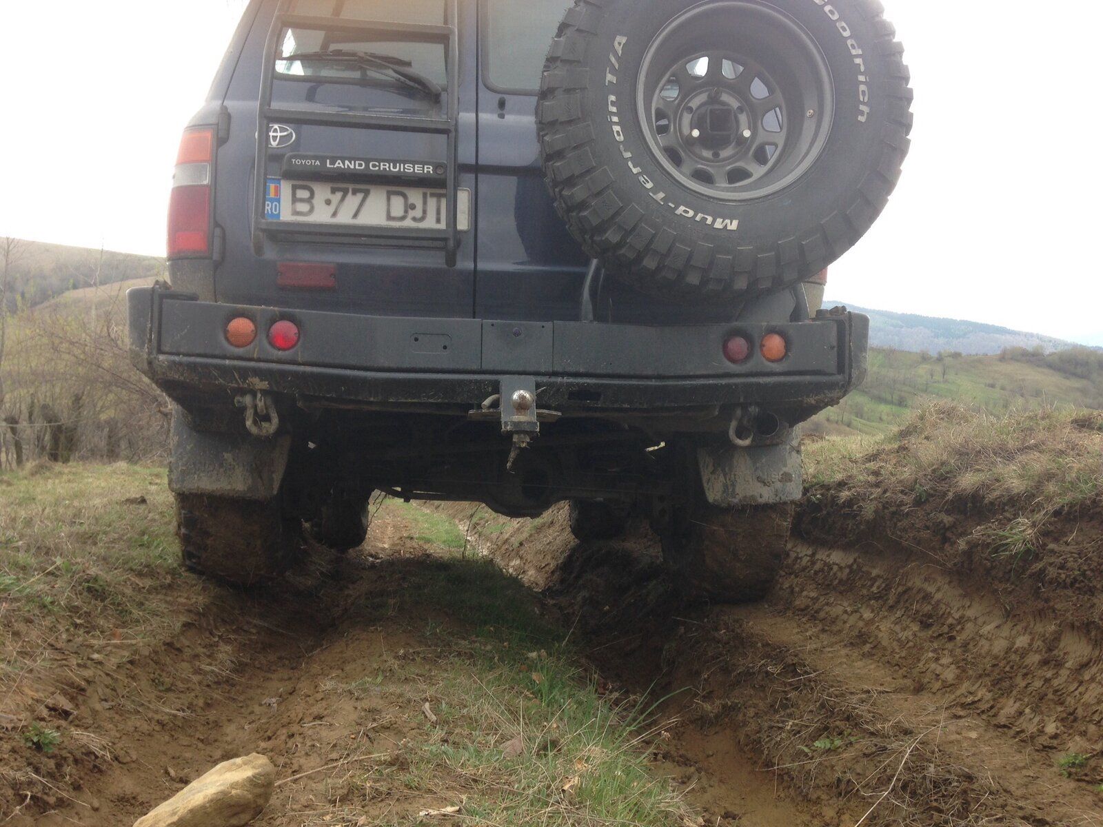

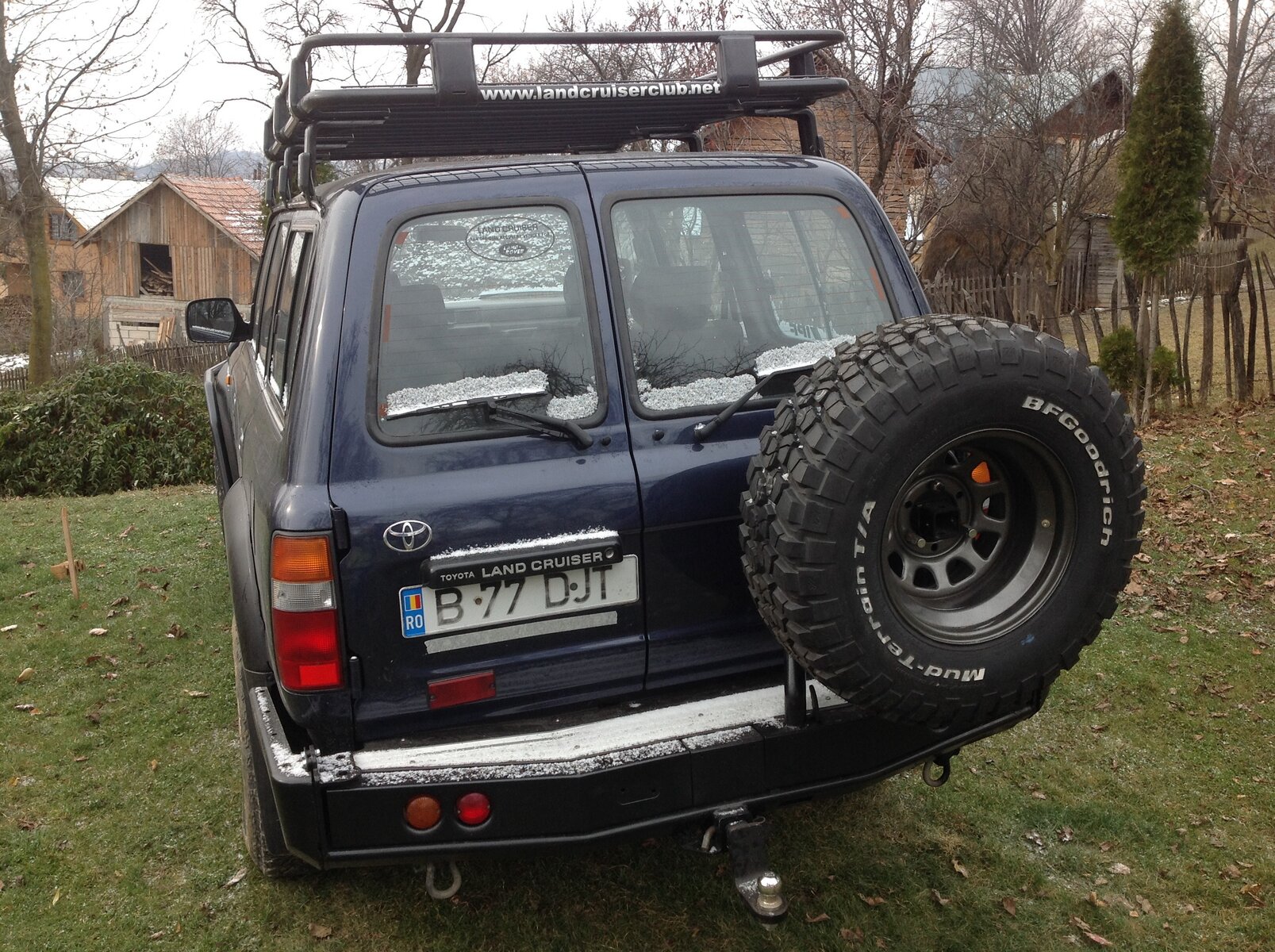

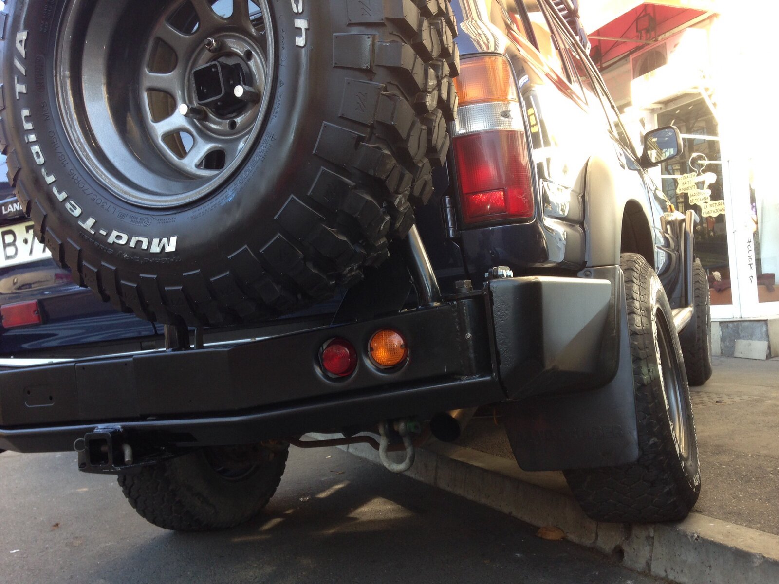

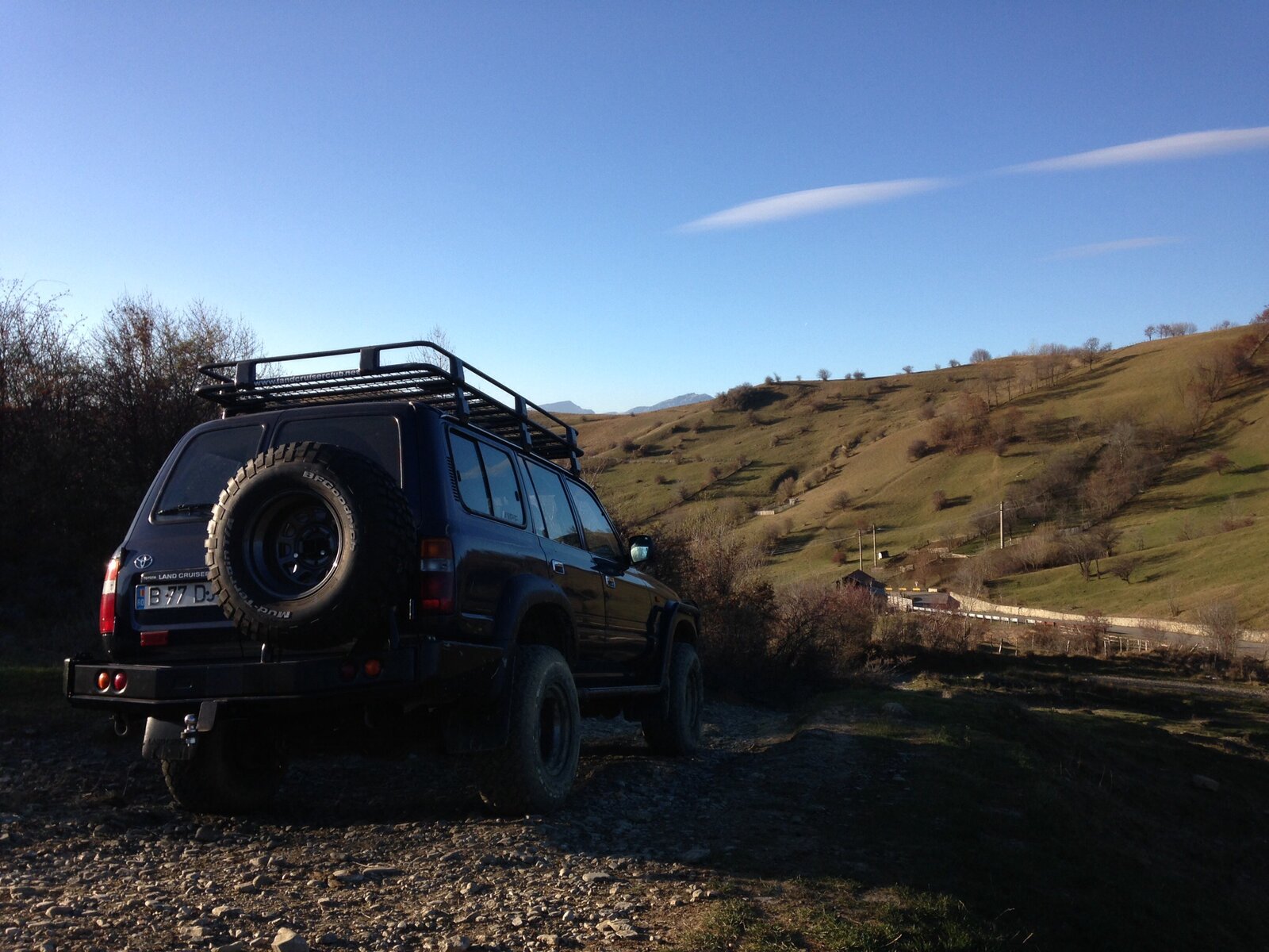

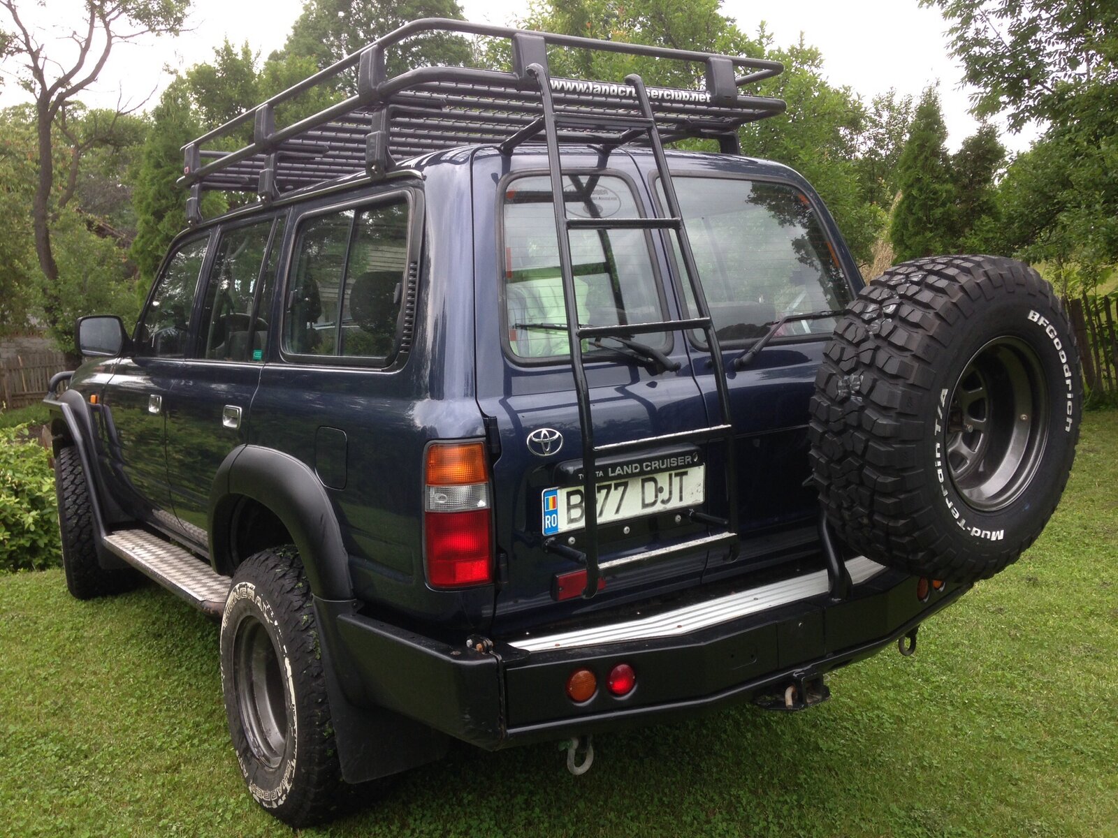

I added two swing outs on the frogs 4x4 bumper. Somebody else had done this before me. I know for sure because I stole his idea :):)
Basic package
On the 80.
Adding spindles.
Building swing outs.
Finished product. Basket with two jerrycans can swing away seperately so you can climb up.
You can take the basket off.
You can also remove the ladder and move the spare tire more to the center.

Geert - looks well. Ladder is a good idea
