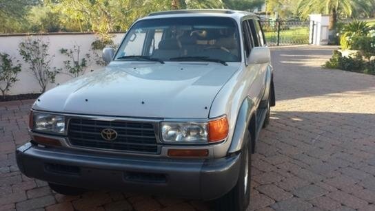

BTW, any idea what the "pips" are on the front of the hood? I guess not until you see it yourself up close.
Maybe for one of those wind deflector thingies Clive... I wondered that on the other thread :lol:
Yes, I've seen them Gav, or they could have been for a "cloth" usually PVC cover thingy on the leading edge of the hood (sorry, bonnet) to prevent stone-chips.
Yeah, I'm kind of wondering as well. I'm not really THAT curious, as those, as well as the plastic fender and rocker skirts are going in the trash as soon as I get around to working on it. Not a real big fan of plastic accents on cars.
