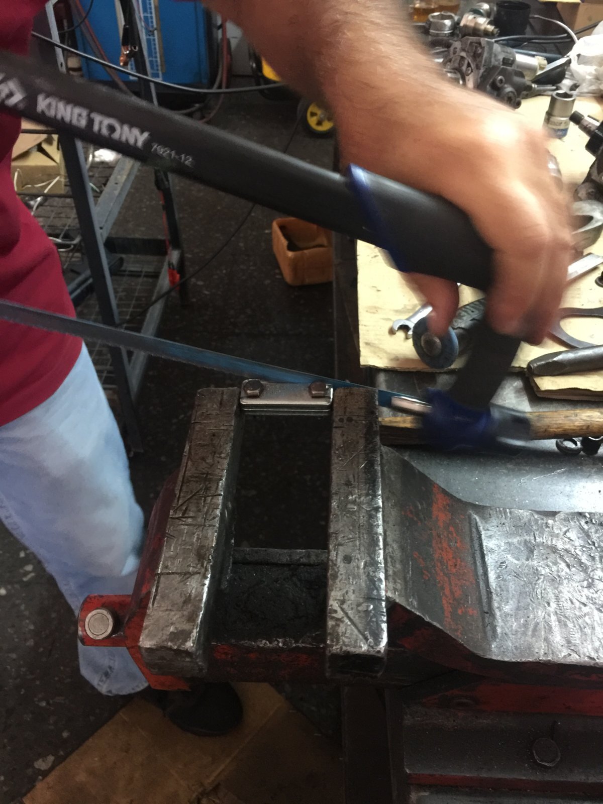

Firstly a leaking faulty steering pump was the first of the many tasks set about to remedy.

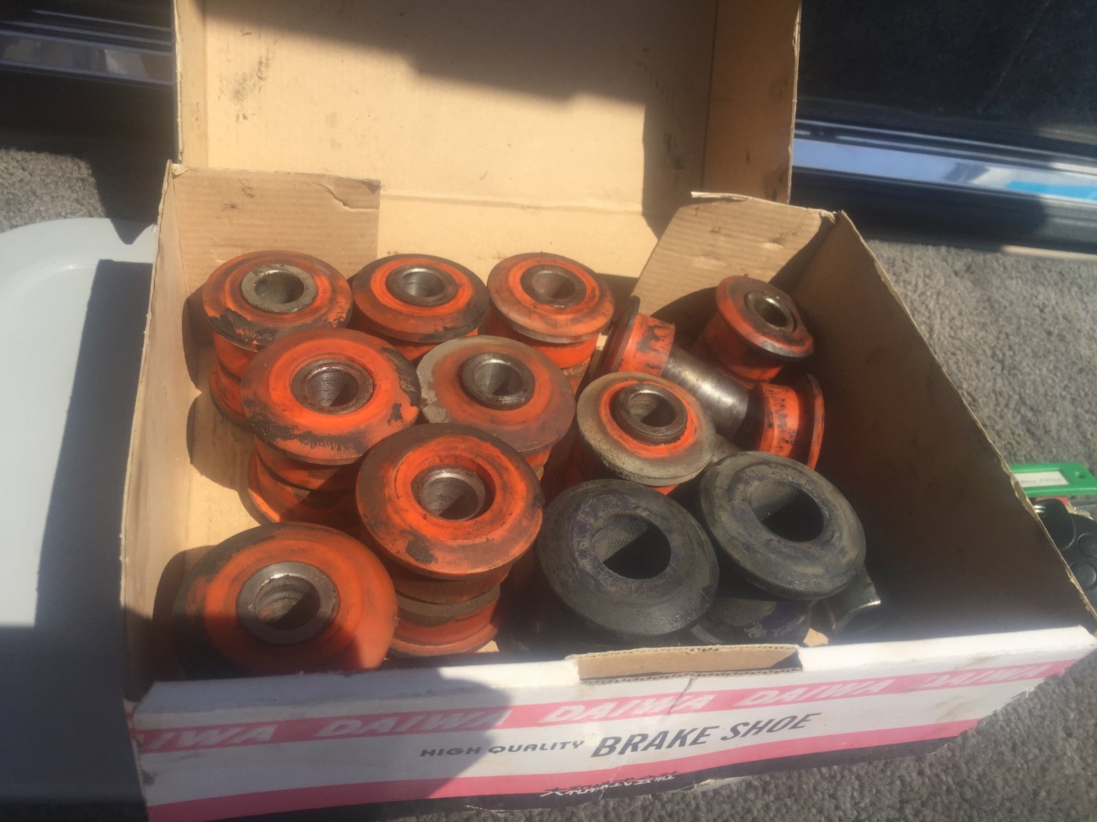

New seals were preordered and a second steering box was used for interchangeable spares to better perfect each section to original best . 33 bearings were noted for internals and 11 outside in the U metal cover.

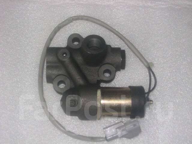

One section at a time the box was put together. One issue remained and this was the electrical valve on mine was faulty. Upon taking it a part wasn't the easiest to work out the fault although a current was not the issue.
With another 80 series in the garage and conformation of the steering being soft and good this one was borrowed to fit on mine and this made it all the difference. The steering became soft as butter for the first time ever in my ownership.
