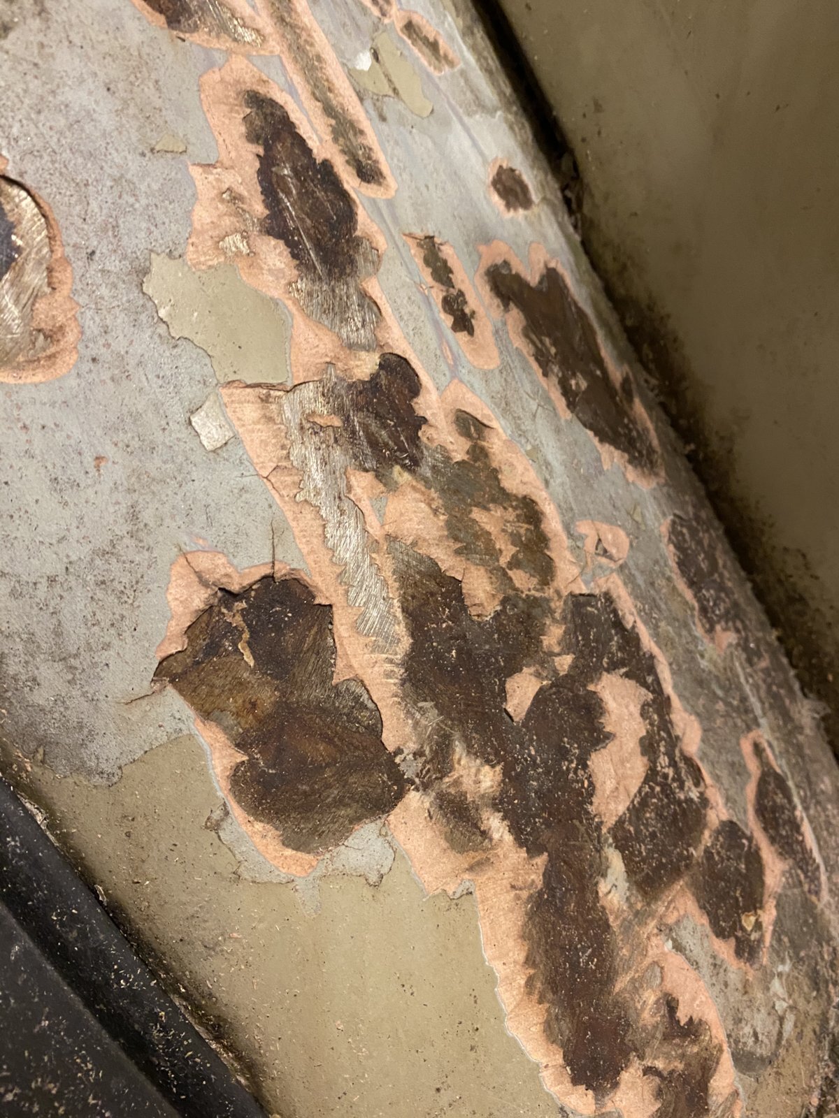

Quick question. Am looking at the vehicle now some serious layers of filler? On the body work. Is that normal? Decals are on top of them so seem old. Photos not uploading but it’s almost visible on the side of the vehicle shits above. Worried now!

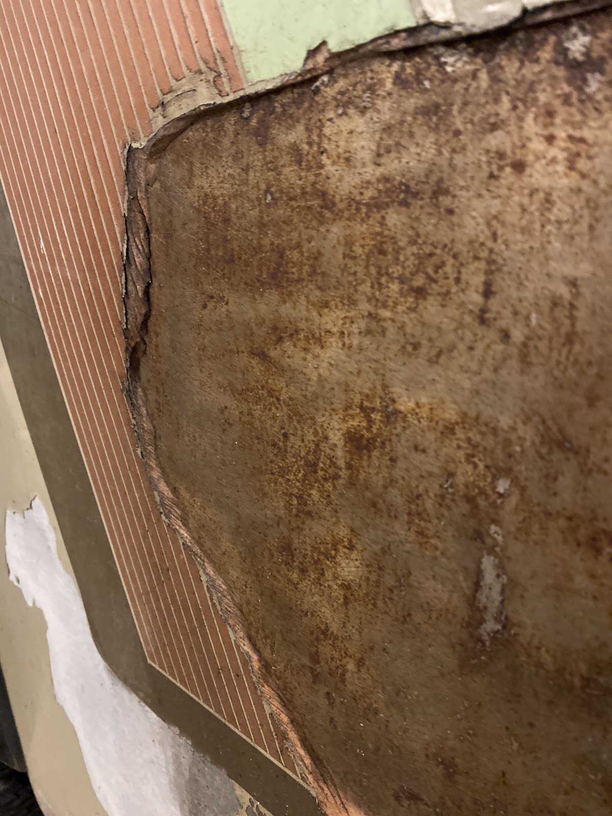

The front wing does look like brake fluid has been spilt but new wings are available - not cheap but they bolt on.
The side panels are a bit confusing but IMO :

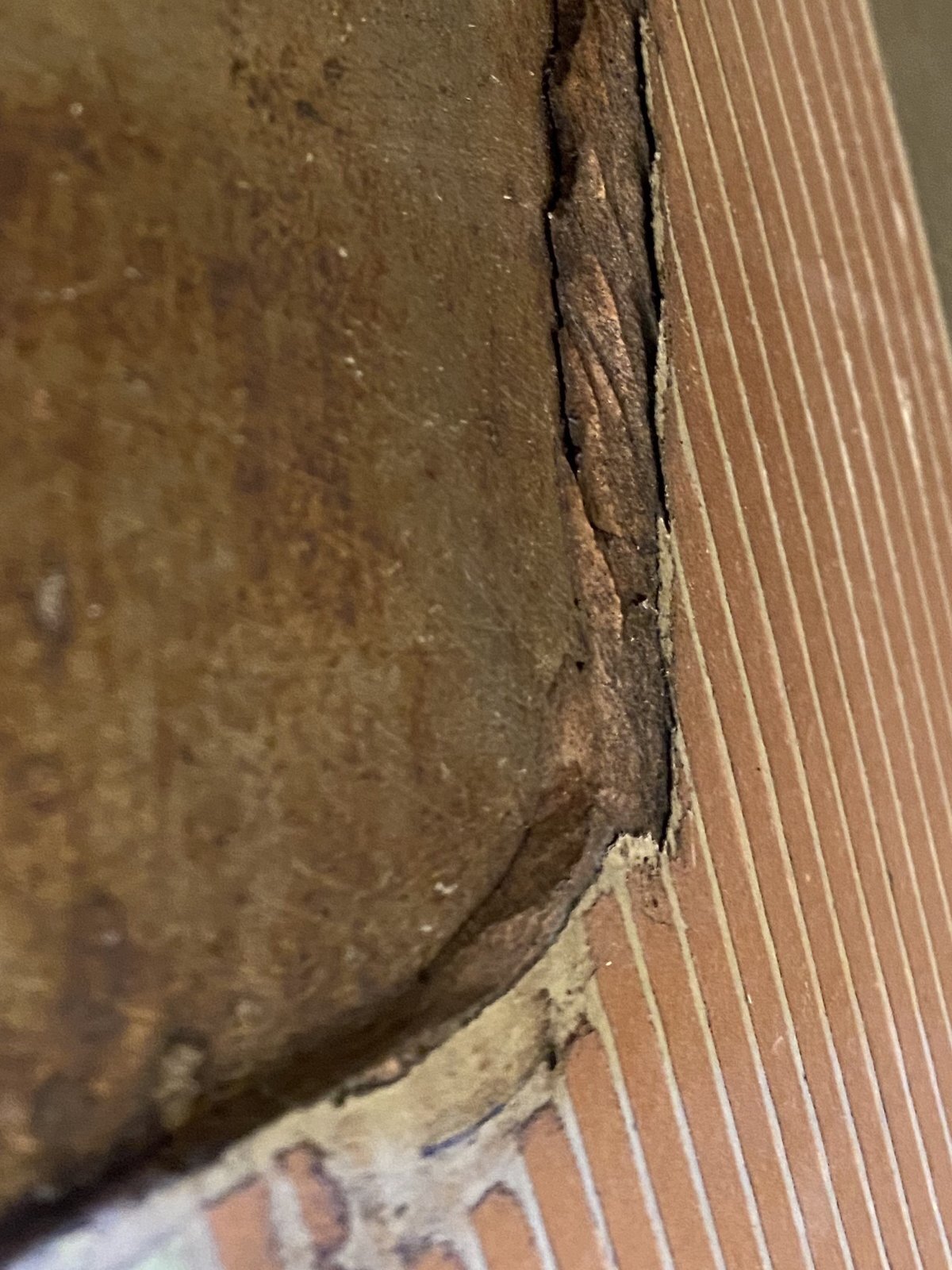

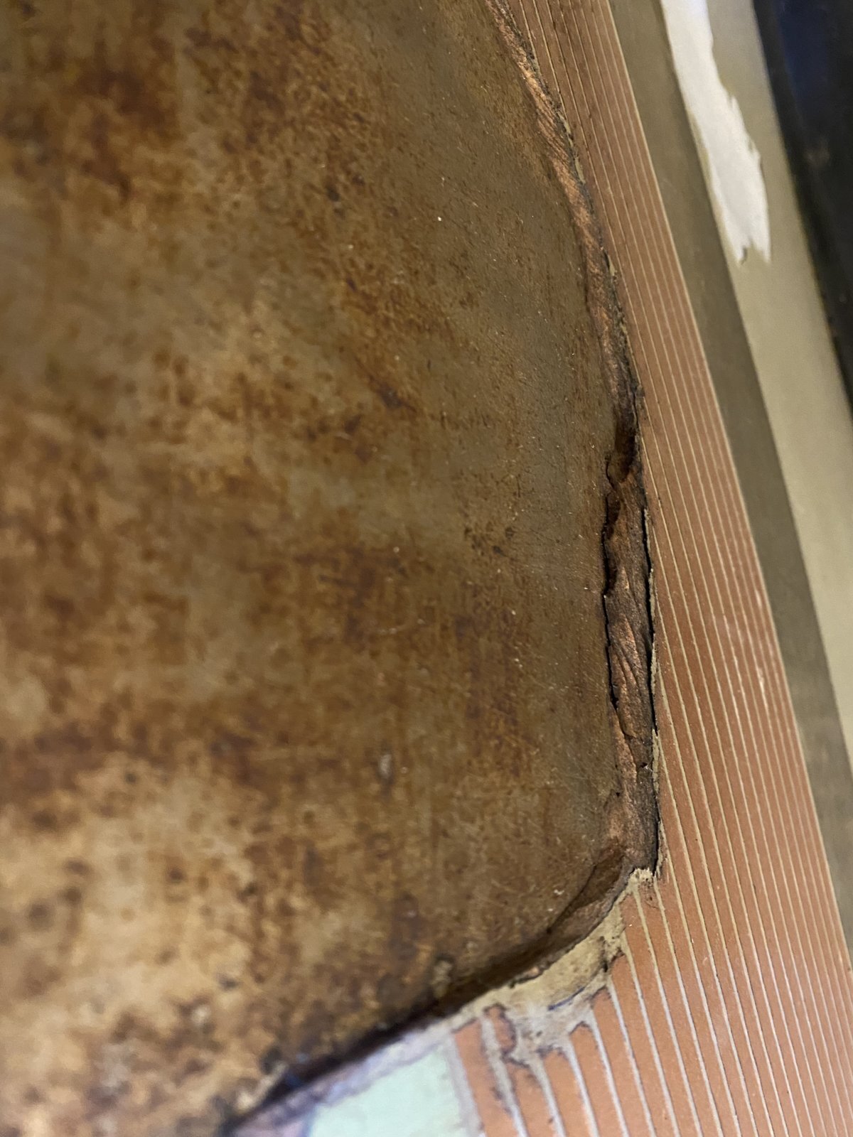

Square panel: There are no weld marks so I think that they cut out a big patch of rust and stuck in (not welded) a panel from the inner wing. IMO it is repairable but matching the stripes will be difficult so may entail removing them completely - you would be looking, ultimately, at a respray.
Odd shaped panel on filler side: Same in that they have cut out the rust and inserted a panel but that panel crosses the B pillar. You need to look carefully at the inside from underneath and inside the truck to gauge how much of that B pillar has been removed. With luck the pillar is in tack but again this will require some major correction work to get it right.
Of course you could treat the panels and edges and then filler them in and there are sign makers who could reprint the stripes.

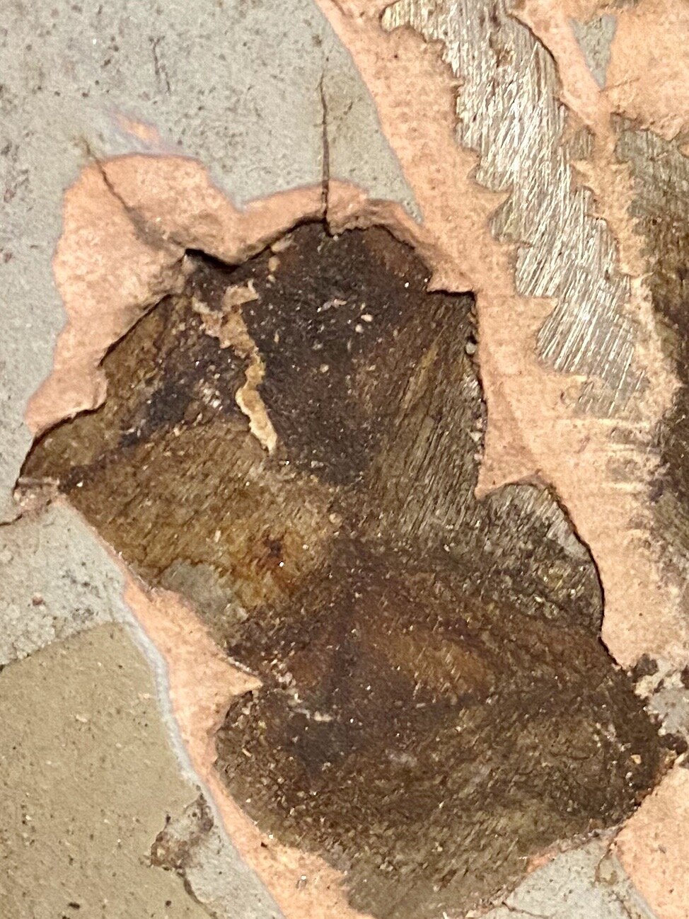

I’ll definitely need to sleep on it - but a question about the body work: normally paint would have applied in layers to metal at the time of manufacture? Would there be any filler used at all?
Thanks for your advice so far (and others) - it’s been really useful!
Filler would not be used at the factory under normal circumstances. I think, although you have seen it, that the cut edges are metal - badly cut. The metal used then was considerably thicker than that used in vehicle nowadays. e.g. I can stand on the bonnet of my 40 without it denting or deforming (Don't try it on a modern car!). In the pictures one can see the primer and top coat applied on top of the metal.

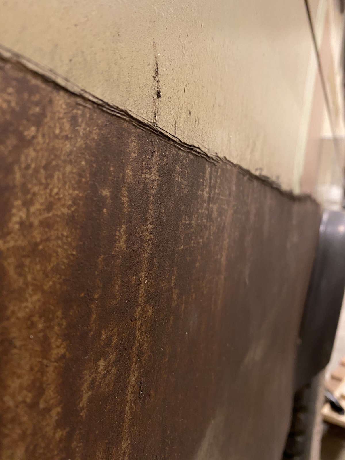

Yes it’s maybe hard to see on the photos. I didn’t see evidence of welds or joins looking up the inside of the side panels. The owner said he’d been digging down through ‘spackel’ (translates as filler) and it may be easier to see on the photo below. Shiny metal top left that looks like he’s been grinding away, then the pink coloured filler, cracked in places, then grey undercoat maybe and finally bottom left the top light brown paint.
The same layers can be seen on the side panel (second photo close up). This time with a decal on top of the paint layer. From what I could see most of the vehicle seems to be treated in that way.

I don't suppose it could have been originally done as a show vehicle so all the panels were completely fair.
Yes that could explain it - what do you think about the “Land Cruiser” decals along the side? Do they look original to you?

I am only like you, puzzled why there should be such a huge volume of filler all over the truck. That is absolutely not normal and sounds alarm bells. Looking at your photos the rust on exposed bare metal seems to extend under the filler in many places. It looks like you would have to chip off a lot more filler to find good sound painted metal all around before you could treat it and start building back again. What we can see is only surface rust, not rot, but it looks like it could be extensive. And who knows what lies hidden beneath.

.....Looking at your photos the rust on exposed bare metal seems to extend under the filler in many places. It looks like you would have to chip off a lot more filler to find good sound painted metal all around before you could treat it and start building back again. What we can see is only surface rust, not rot, but it looks like it could be extensive. And who knows what lies hidden beneath.
That’s a very good observation - you are right it the rusty almost oily surface does seem to extend under the filler - then places the dude with the grinder has removed that to expose metal. If it was factory applied filler then there surely would be clean metal directly under the filler.
So the body work is in a bad condition all over. But the chassis isn’t?! Very hard to get my head round what’s happened to this truck.
