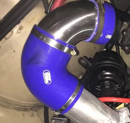

It had occured to me to cut away the funnel shape edge to the airbox - to make a round pipe and then find a silicone pipe of a larger internal diameter to secure to both existing parts thereby making the seal AND....... one that can be easily removed if I need engine access in the future. Something like the picture.
EDIT:- Just found this:- Forge Alloy Hose Joiner 75mm Length - [Leaving Land Cruiser Club]

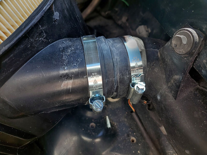

Firstly, I got hold of a normal inner tube and tried to stretch it out to cover the 65mm pipe work of the air box etc. - Too tight, but I didn't want to wrap it - even with mastic or silicone to help create a seal. So I managed to scrounge an inner tube of a "fat bike" tyre. I also drilled out the rivet holding the funnel type plastic from the airbox side (pic in original post) and got a 68mm UPVC pipe connecter to insert and extend the airbox "shoulder" which would give me enough pipe for a jubilee clip to grip on. Stretched the inner tube over two pipe ends and clipped it. This is both flexible and forms an airtight seal which can easily be removed for any futre work. Pic below.
