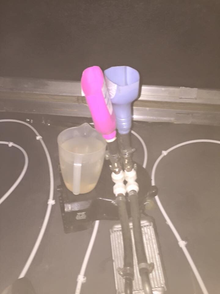

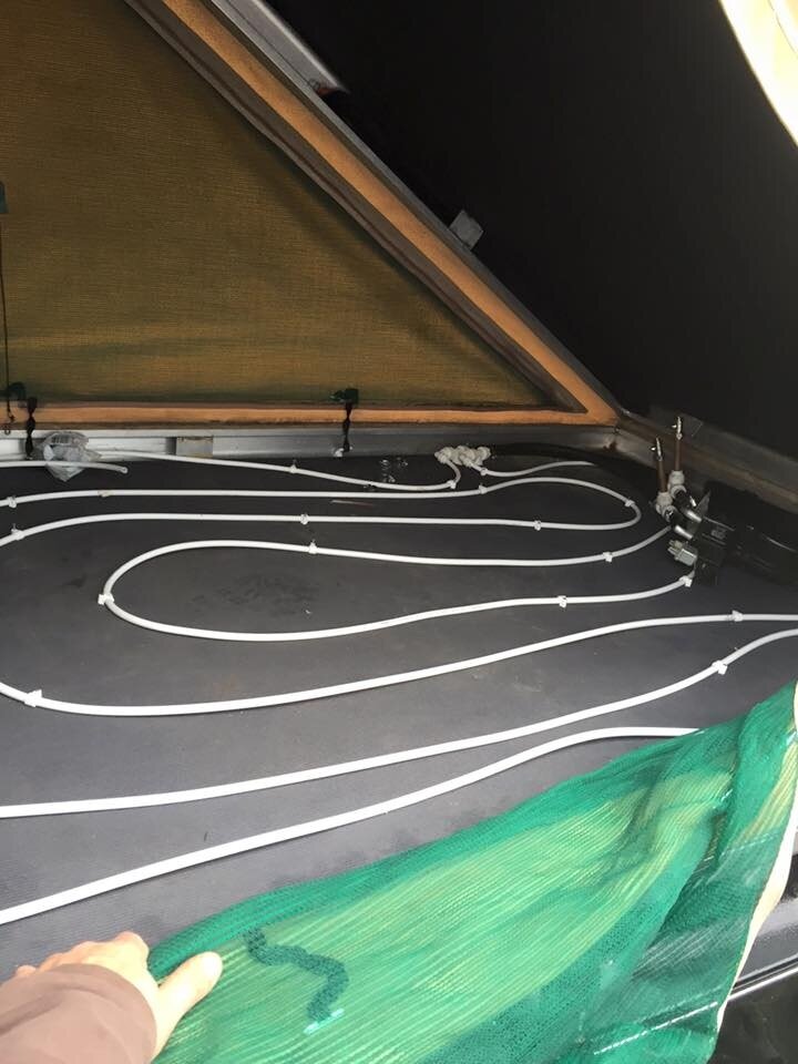

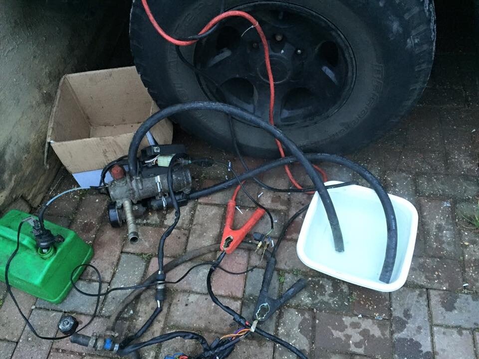

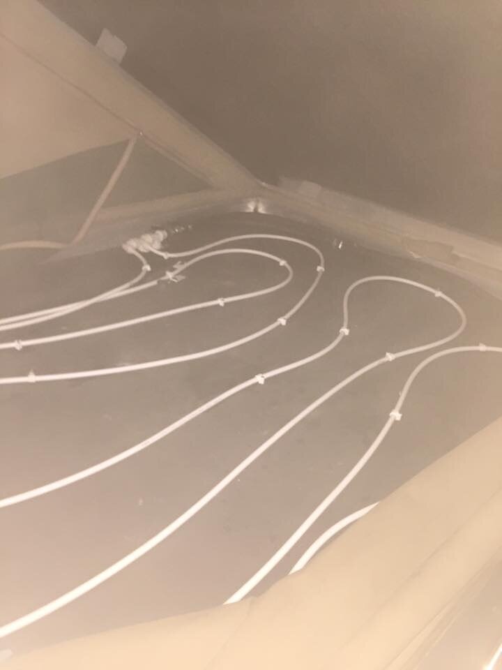

With all the above taken into account I've used a block heater. I have underfloor heating in the roof tent and also a underseal heater up in the tent. Makes it nice and warm.
We went to lincomb last weekend and tried it out. I found that I kept getting air into the system and had to bleed it before I used it. That was a pain. Once it was up and running it was fine.
I had a play with it the other night when it was lashing it down and pitch black and now I have got it that its working how I wanted.
So now,whilst your are. Driving around the engine coolent is circulating around the underfloor bed heating in the tent. So when you pull up at a camp site late and its cold you can put the tent up and the bed and bedding is warm. Most prob Dont find this a problem but with me wanting to put how water in the truck I thought I might as well do everything I could possibly want out of the system.
Ive done this cheaper so far than it costs to put a bushranger system in that will only use the engines heat.

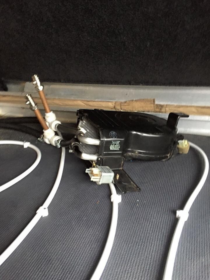

Next step is to get the system open again and add my heat exchanger under the drivers seat.
ill add to this as and when.
So far I'm happy with how its going. Didnt think it would actually work at the weekend when I was having to try and bleed the air out.
One downfall is the heater is loud. Fine for us in the tent as we can hardly hear it. People who your camping with can though.
Few pics (please note,this is not finished properly as I didn't go to the time of fitting it all properly with me not knowing if it would actually work)
