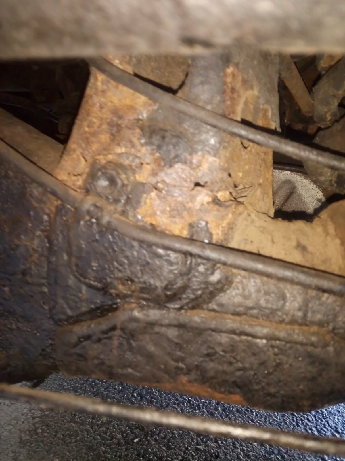

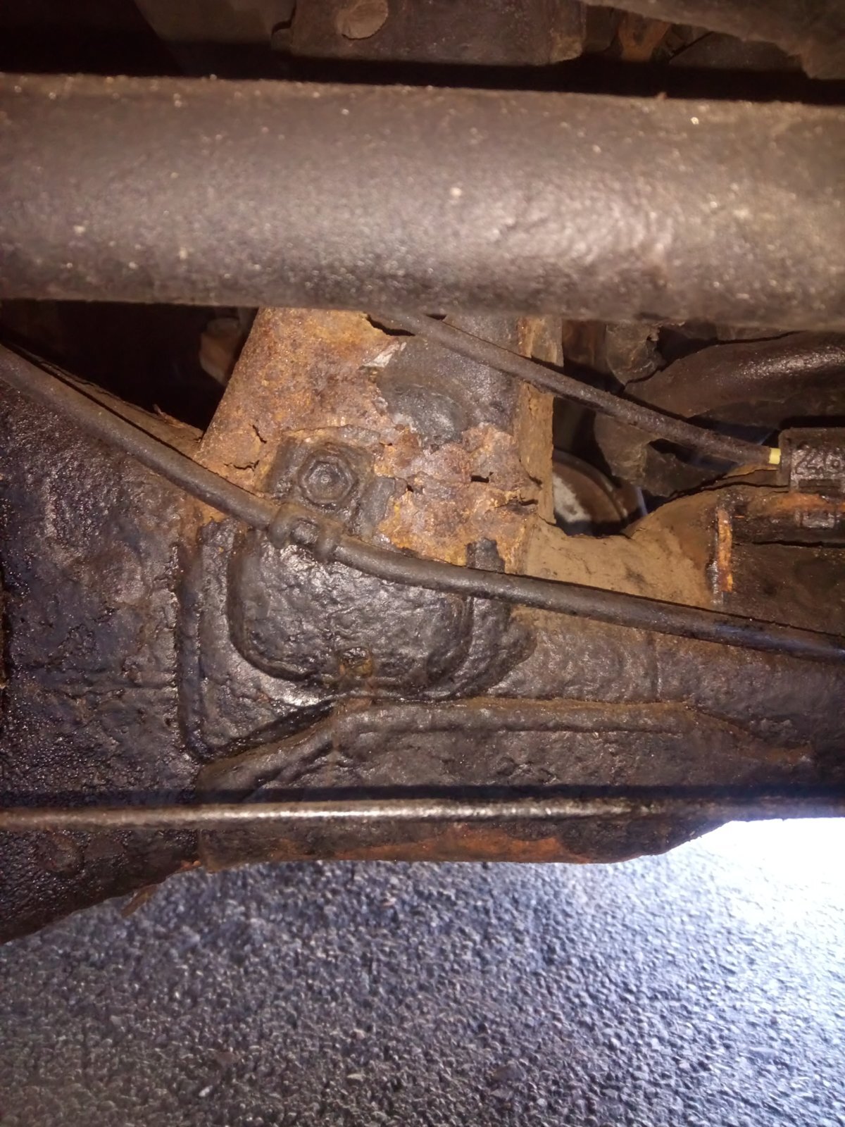

    Hi thought I would post a little update!! The vibration also happens when stationary!! I have just spent ages under the truck and noticed my rear axel looks a bit worse for wear!! I'm getting it welded on Monday so will see if this was the culprit

    Thanks Dervis my rear axel has always looked a bit rusty hope the rest of the suspension is OK! Like some one mentioned the Lc90 are 15yr old!! I've owned many a cars but none has give me as much pleasure than the Lc90!!

    Hi can some one please advise if they have ever had their rear axle brackets welded and what's the best way to get it done so I can instruct my mechanic !! I also noticed a few cables in my picture may they be are the culprits vibrating

    Had mine done a few years back but can't advise on how I'm afraid, I just took it too a local engineering place

    Hi mark would you be able to confirm if metal plates were used and has it survived ?? Thanks

    Yep metal plates and it’s survived very well. I gave the engineers my axle and a spare one I had and they repaired the mounts on the top and also reinforced all the other mounting points while they had it.
    That was summer 2013 and since then I’ve done 6 trips in Morocco and the Western Sahara with no further problems.
