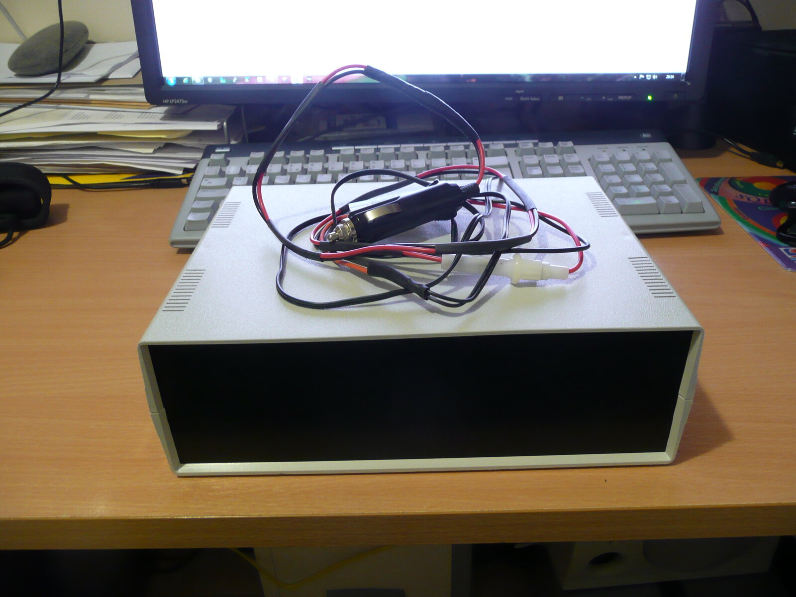

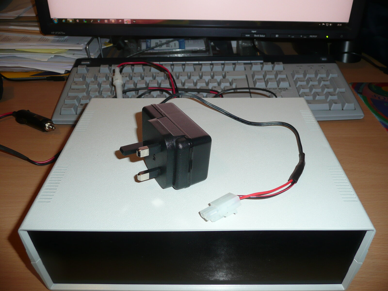

Purchased a cheepo box from Maplins.... and we now have this:
As you can see I used a connector on the power cable which allows me to power it from either the car or the mains supply (important for when we get there are the kids are bored with nothing to do).

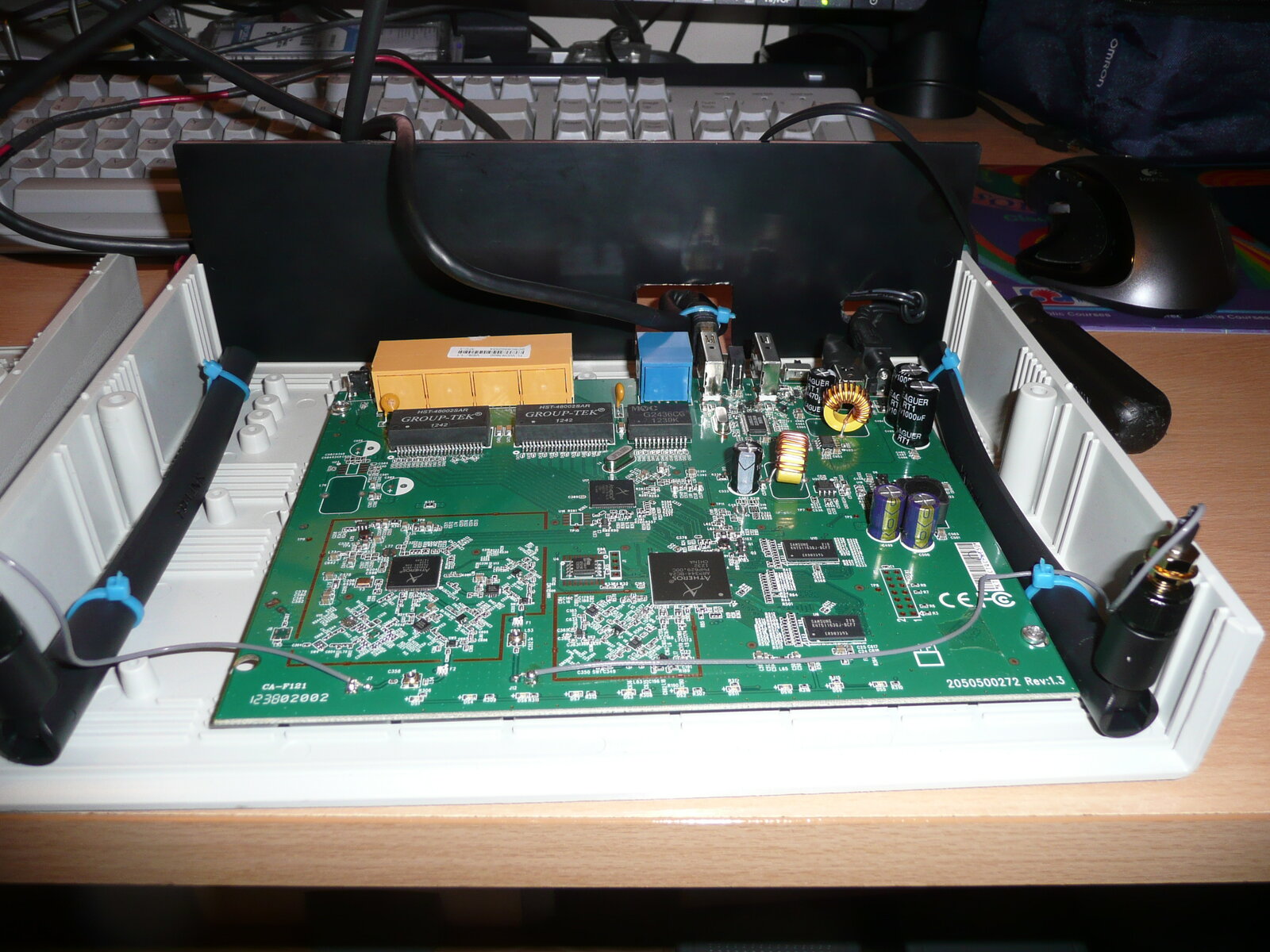

So, removed the router from it's box and fitted to new box:

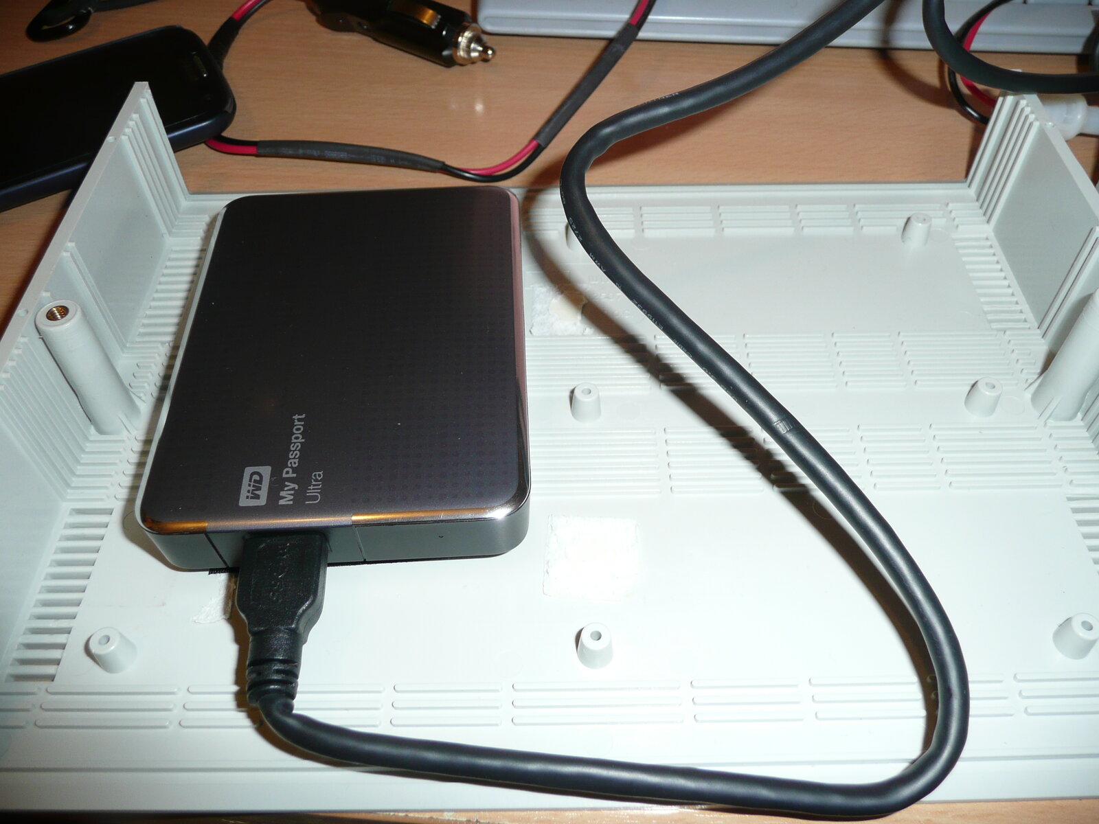

and then also velcro'd the HDD to the lid of said box:

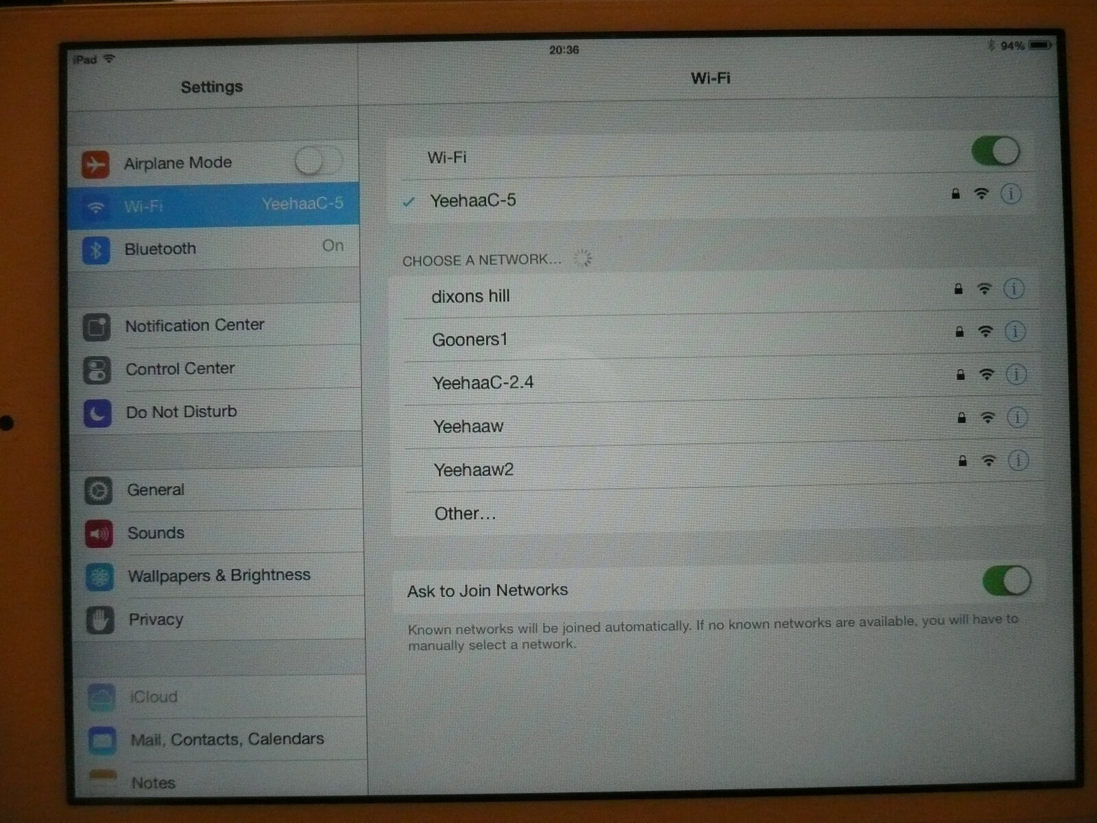

Once all connected up and the wifi setup with a basic password etc, I then shared out the HDD as a media share and connected the iPads to the router:

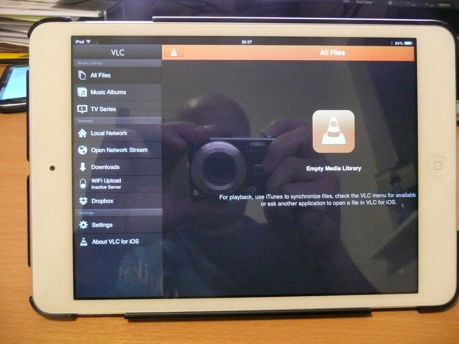

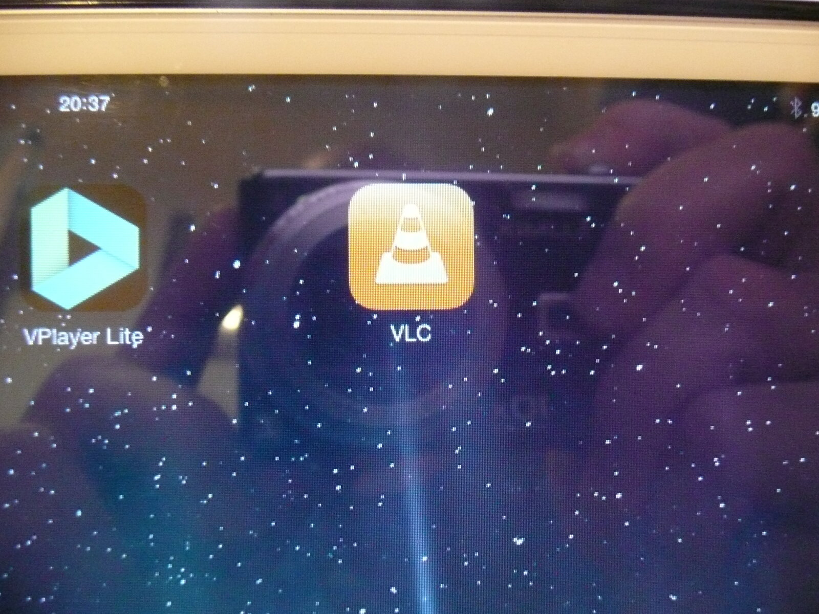

So the tricky part was finding a App for the iPads that would play the various formats that my DVD's were in (VOB, MKV, AVI). I tried quite a few and in the end settled on VLC player. Much easier on the Android devices (I used Bubble UPNP and VPlayer).

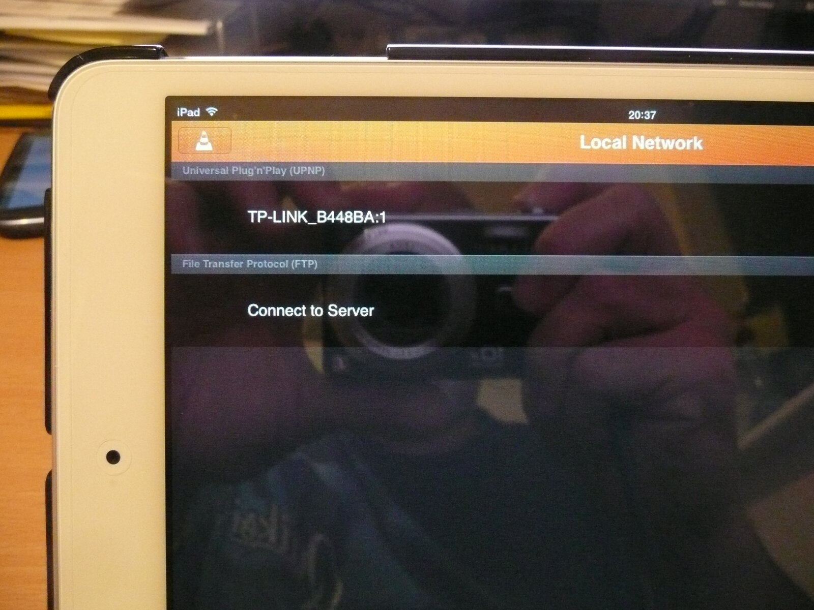

Browsing the network I find the router and can browse the folders/files:

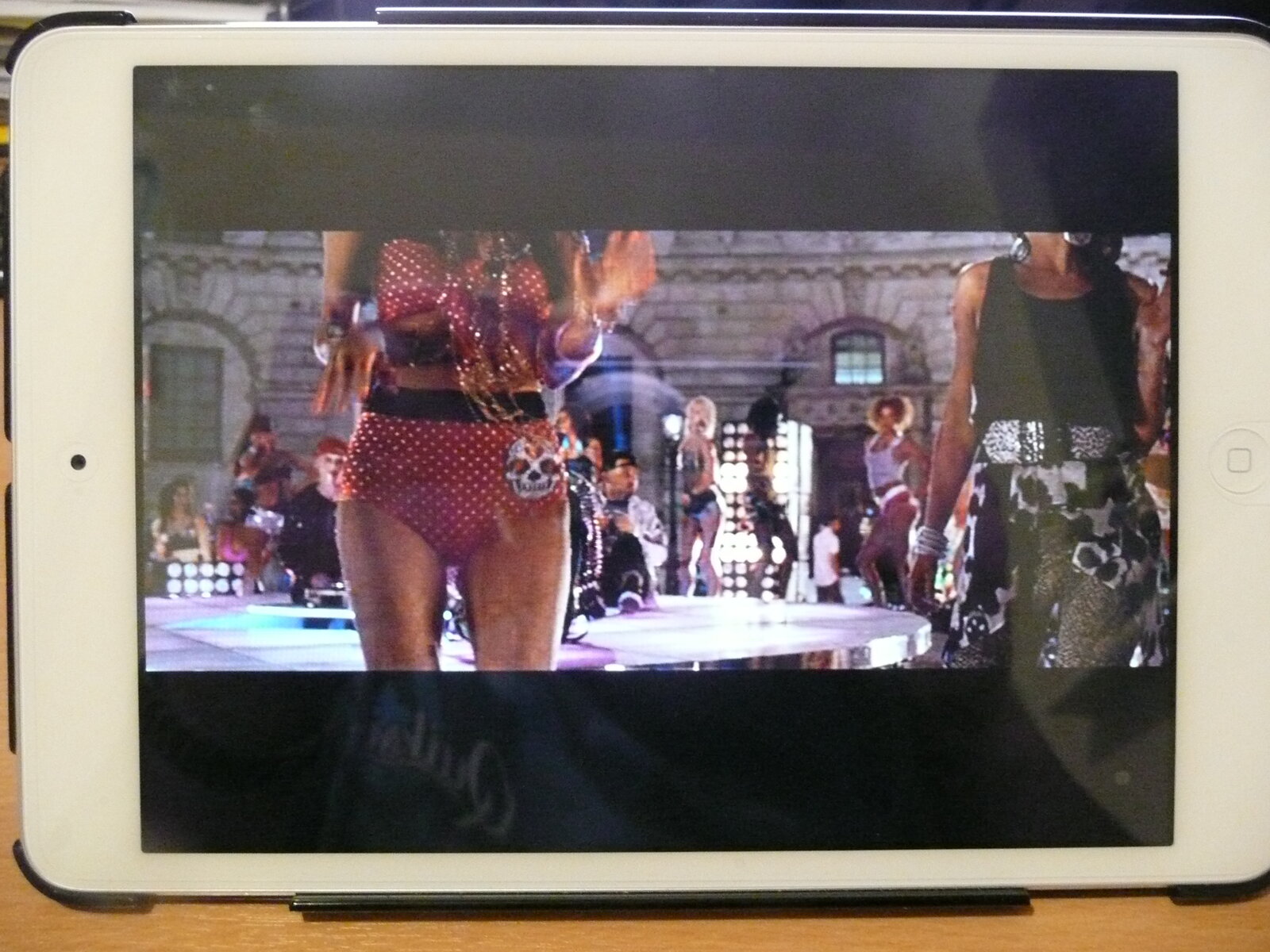

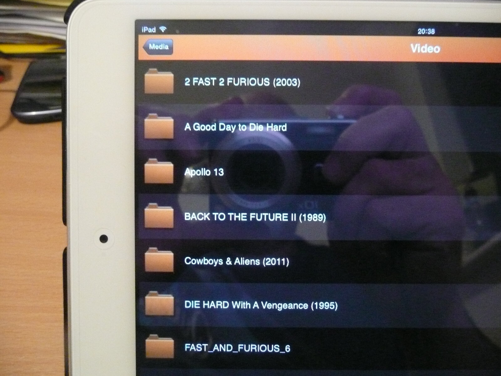

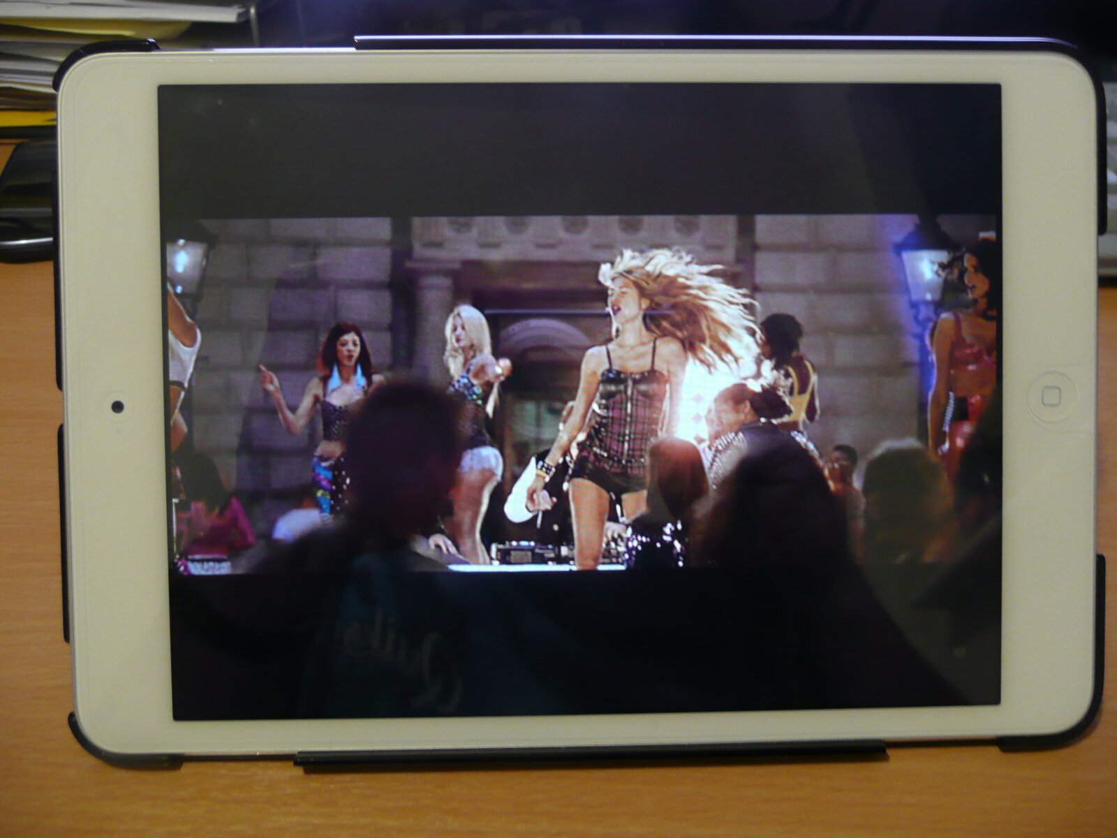

And play them:
It worked really well and kids were happy to watch what they wanted. Streamed different movies to each of them without a glitch for the 13 hrs there and back. When I was testing at home, I had it streaming to 2 iPads, 2 android devices and the desktop pc all different movies and all without issues :icon-cool:
