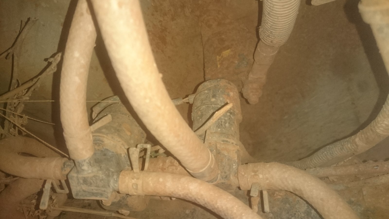

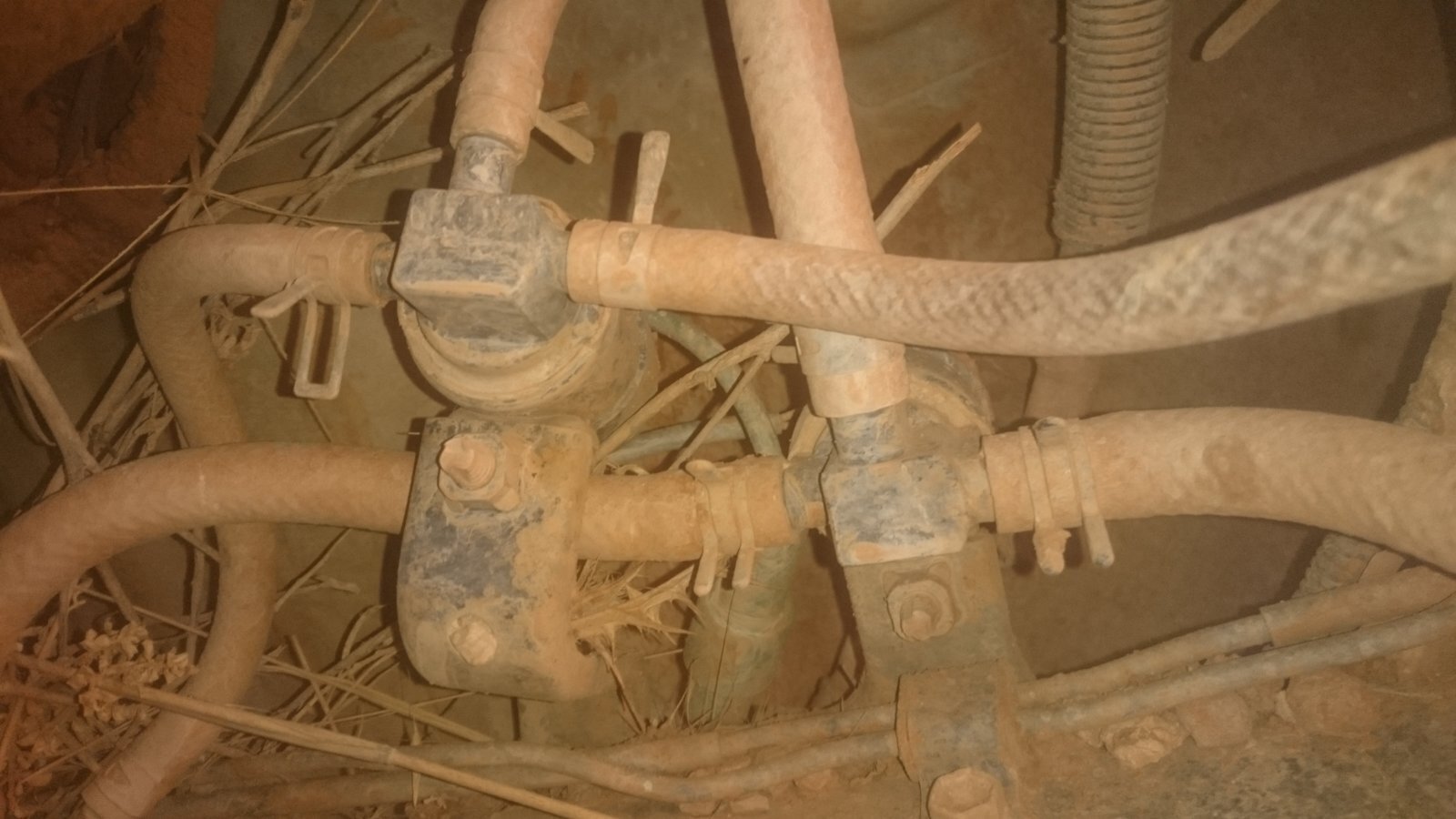

    Okay. So you will have two fuel lines, a large one which supplies the fuel and a small one which is fuel return.
    The factory way of doing it, is to connect the hoses from both tanks to a solenoid valve which is actuated by a switch on the dashboard. There is a solenoid valve for the supply line and another for the return line. The solenoid valves are quite expensive so a wrecker would probably be your best bet.
    If you don't want to do it this way, then you could hook up the hoses to taps that you have to get underneath and turn manually to swap tanks.
    Quite a bit of fuel circulates through the return hose for lubrication and cooling, so it is important to have the return going to the same tank as the supply is currently coming from.

    Here you go

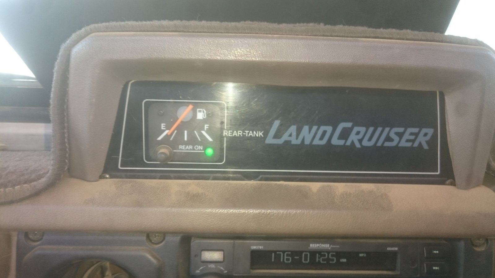

    They plug into two plugs of the main loom just above the RH chassis rail, about where the transmission is. Do you have the sub fuel gauge and switch on top of your dashboard like in the photo?

    No mate I wish (you didn't have a spare one do you?)
    So I was thinking I'll get the solenoids and wire them to a switch and then I would have to wire up a separate fuel gauge.
    Trouble is I'm not sure how, and if it'll work
    Might have to have a chat with an auto electrician

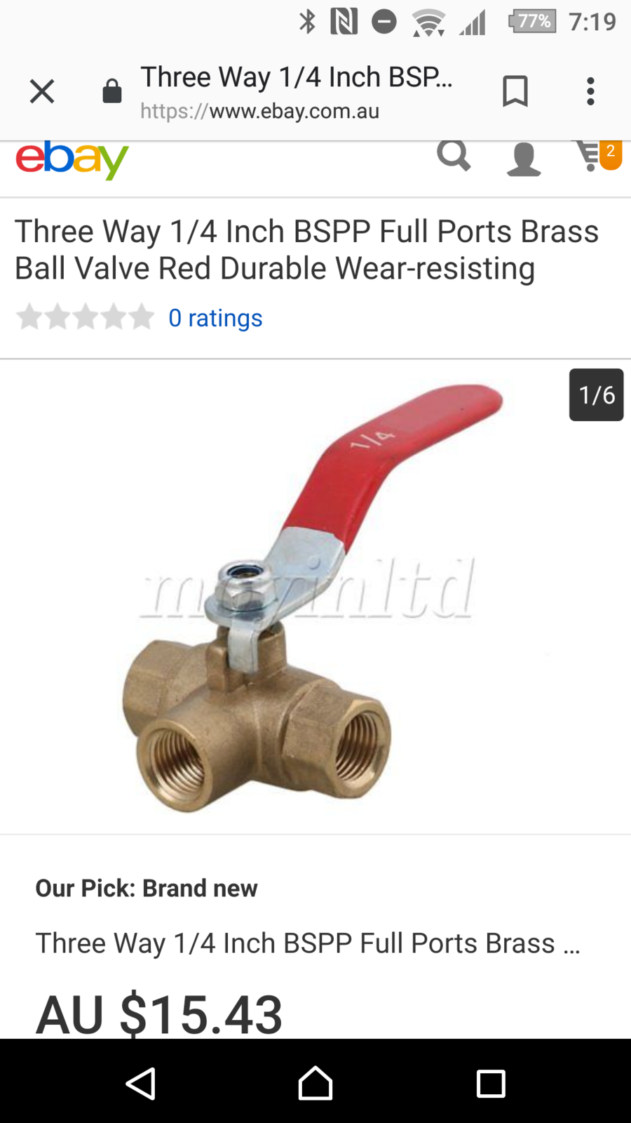

    Yeah righto, the reason I asked was that there is not much point connecting the solenoids into the loom if there is no switch at the other end to power it.
    It would be simple to just power the solenoids with a switch as you suggest.
    However, you may be horrified at the price of them, in which case a couple of three way taps might do the job for you? Bit of a hassle having to turn taps to swap tanks, but so is giving a Toyota dealer hundreds of dollars.

    Hey there One and all, I finally come across the parts for the sub tank and hooked it all up and seems to be working when I push the button and the green light comes on however the gauge is reading empty and not moving even though I've put about 30 L of fuel in the sub tank The sender is registering 50 oms but there's no power at the plug that fits into the sender.
    Might be a silly question but shouldn't there be 12v?
