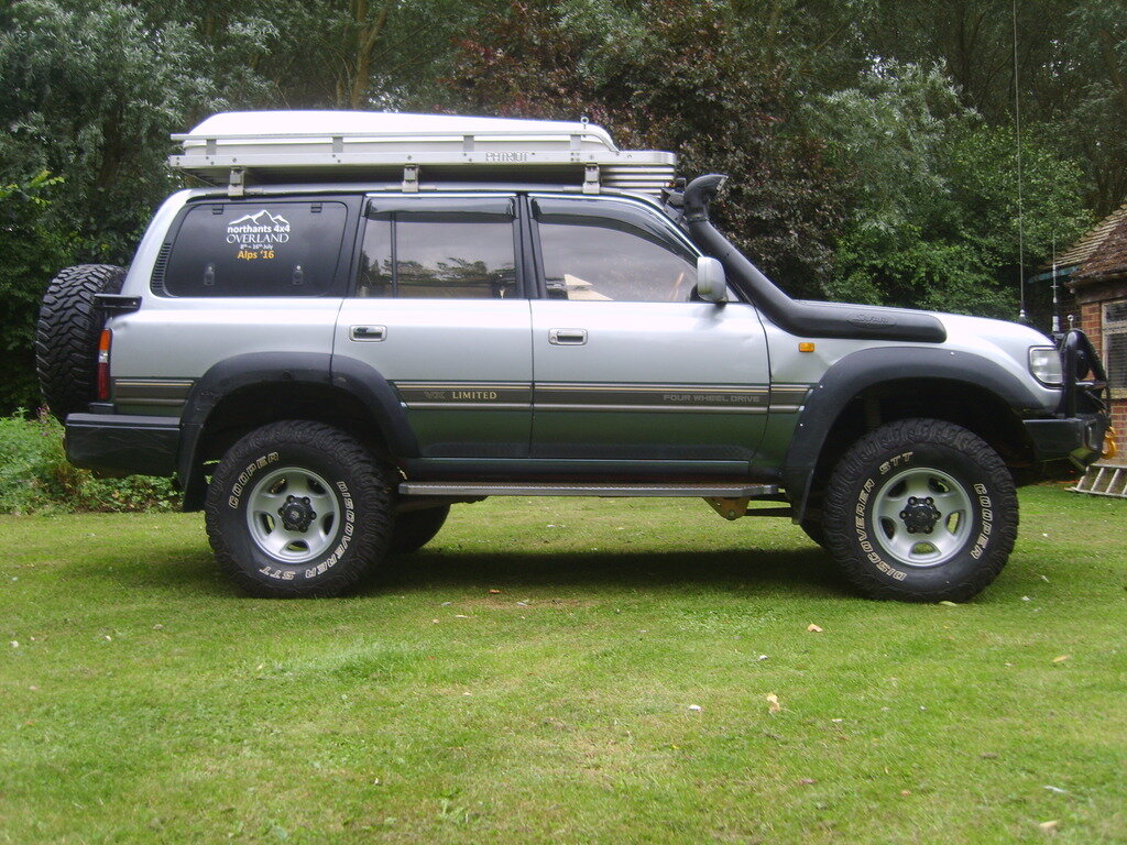

Raised Suspension 115mm:
EFS suspension kit, +115mm springs, EFS Gas shock Absorbers,
Front and rear anti-roll bar extensions,
Front and rear Bump stop extensions.
BOSS (FNB) radius arm drop boxes for castor correction.
Front and rear Adjustable Panhard rods.
New EFS Steering Damper.
Some Bushes Replaced with Polybush upgrades, anymore that need replacing will get Polybush upgrades.

ARB Heavy Duty front Winch bumper.
ARB Heavy duty Rear Bumper step with detachable towbar.

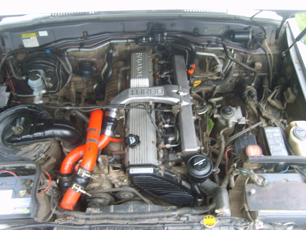

Intercooler
Safari Snorkel with snazzy BOSS stainless bullhorn cover
Autohome Columbus Variant series Rooftop Tent.
Patriot Alluminium Roof Rack
Oztent Foxwing Awning with 2xTapered side Sheets.
Toyota Winch with 50M Synthetic rope & HD recovery hook

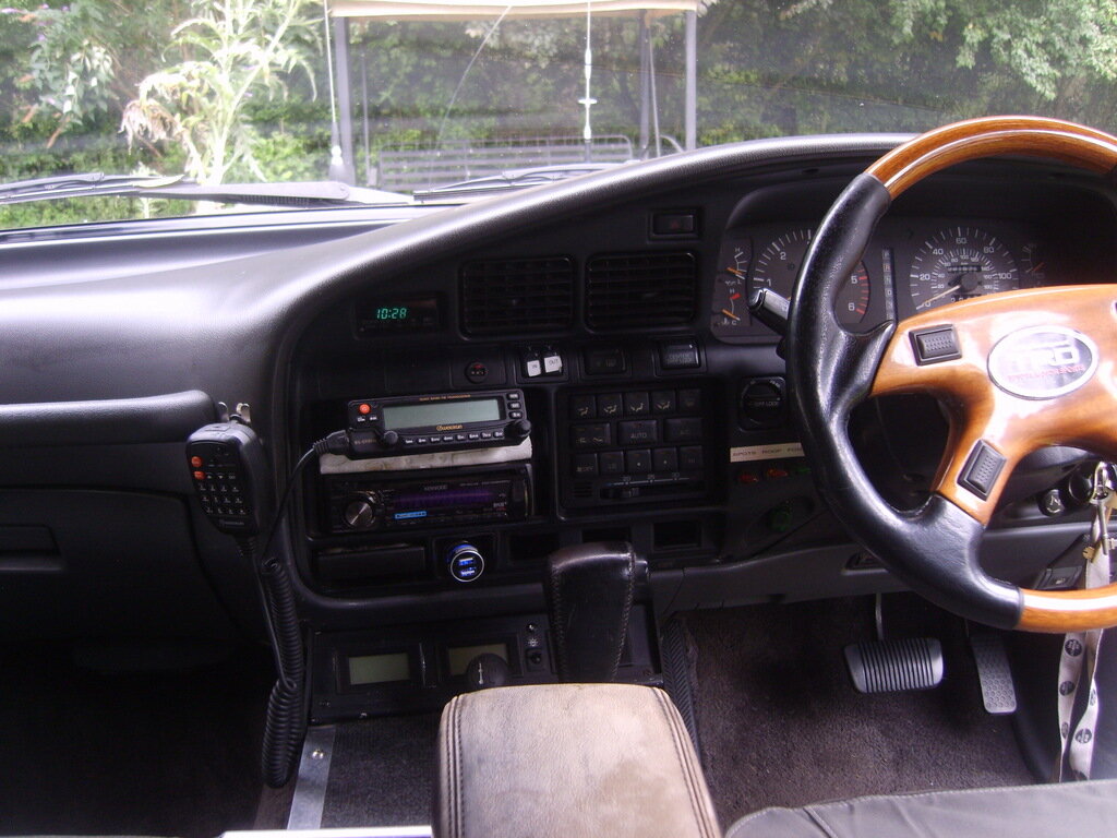

Kenwood KDC-DAB4551U CD player/Radio/MP3
Wouxun KG-uv950P Tranceiver
1xCB aerial, 1xVHF aerial, 1x aerial splitter

Bespoke LCD battery monitoring system in cabin

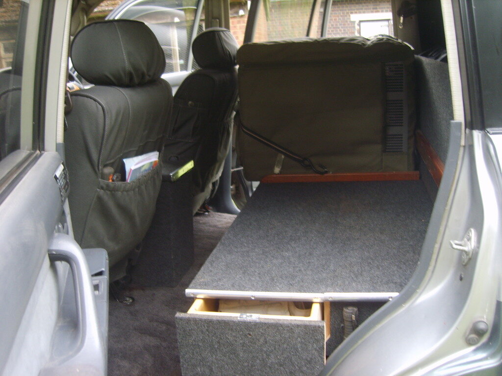

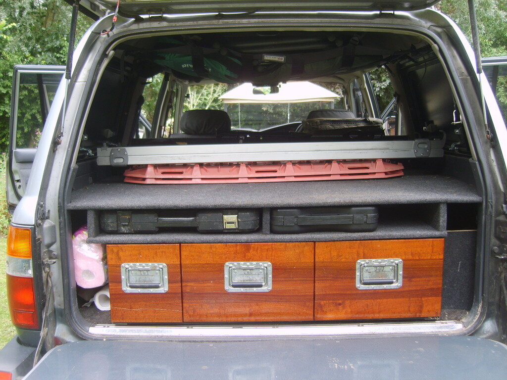

Bespoke overland storage system/draws/cupboards in loadspace/rear seating space

Bespoke front seat covers from Escape Gear S.A.

Don't know how I missed this earlier. Looking great Pete. Like the wooden drawers, very nice. Gullwings look good too. :whistle::clap:
