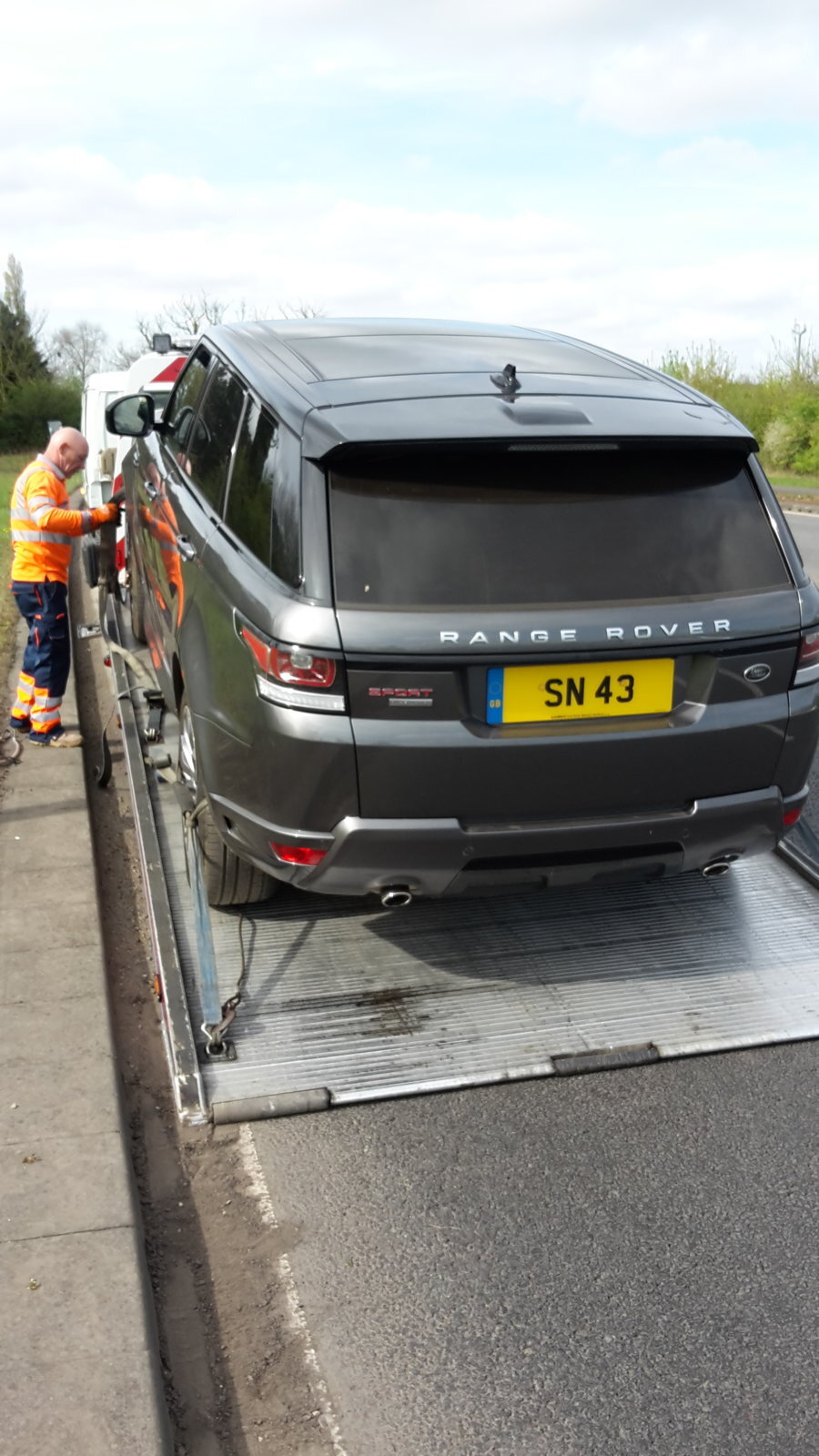

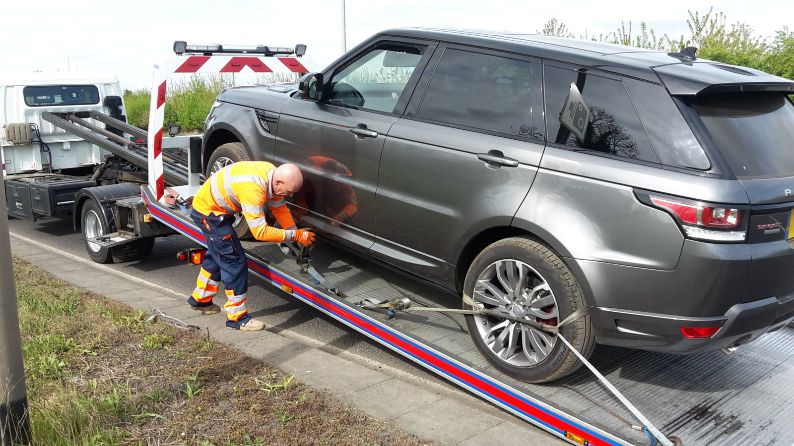

My aunts 18 month old autobiography. Fat end of 80 k when new. Gearbox shat itself on the dual carriageway, locking up and shearing all the timing gear. Result new engine new gearbox. Landrover assist did try the "well it has done a lot of miles!!! (70 000) high for age but all motorway work. Well made eh Julia! !!!!

Sounds more like the timing gear went, locking the engine solid and wrecking the gearbox as the weak link in the drivetrain.
But then I'm no mechanic. :whistle:
She was accelerating hard off a roundabout when the car kangarooed down the road in her words. Engine still ran but sounded like a bag of nails. Recovery couldn't drag it with the winch at first. When they started it and selected a gear was still solid then made lots of grinding and clanking and suddenly drove on to the lorry.
