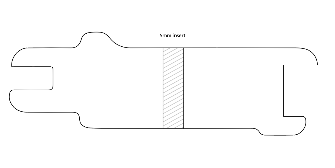

    So do this??
  9. Chris
    16,321
    3,342
    113
    Garage:
    Map

  10. THL
    THL Active Member I am in europe
    63
    43
    18
    Map
    Got it. thanks

    Now that drawing is interesting. My dog bones had a step in them where Chris has shown weld. One side about 1.5 to 2mm longer than the other. It looked to be made like that but are you saying it should be straight across and consequently that mine may have shown wear?

    I've only traced a picture from another thread on here and straightened it up so don't take my drawing as 100% accurate. If I do alter the dog bone I wanted to produce a full sized, accurate drawing that others with the same issue could just download, print out and use as a template.

    If you change the shoes 5mm can be too much, but a good starting point and can be ground down.
    2 mill wear on each shoe contact point and 2 mill either end of the dog bone. There's 8 mm, doesn't sound much but along with a stretched cable can make a big difference.

    I fitted new handbrake shoes, springs etc and new discs and modified the dog bones by 5mm and couldn’t get the discs over the handbrake shoes, so reduced the oversize to 3mm. I set up the correct adjustments with the handbrake cables disconnected and worked the cranks by hand to make sure it all worked correctly before reconnecting the cables. All adjustment off the cables when connecting up then took tension on the cables to reduce handbrake lever travel. Handbrake works a great now

    Yes 3mm is probably enough.
