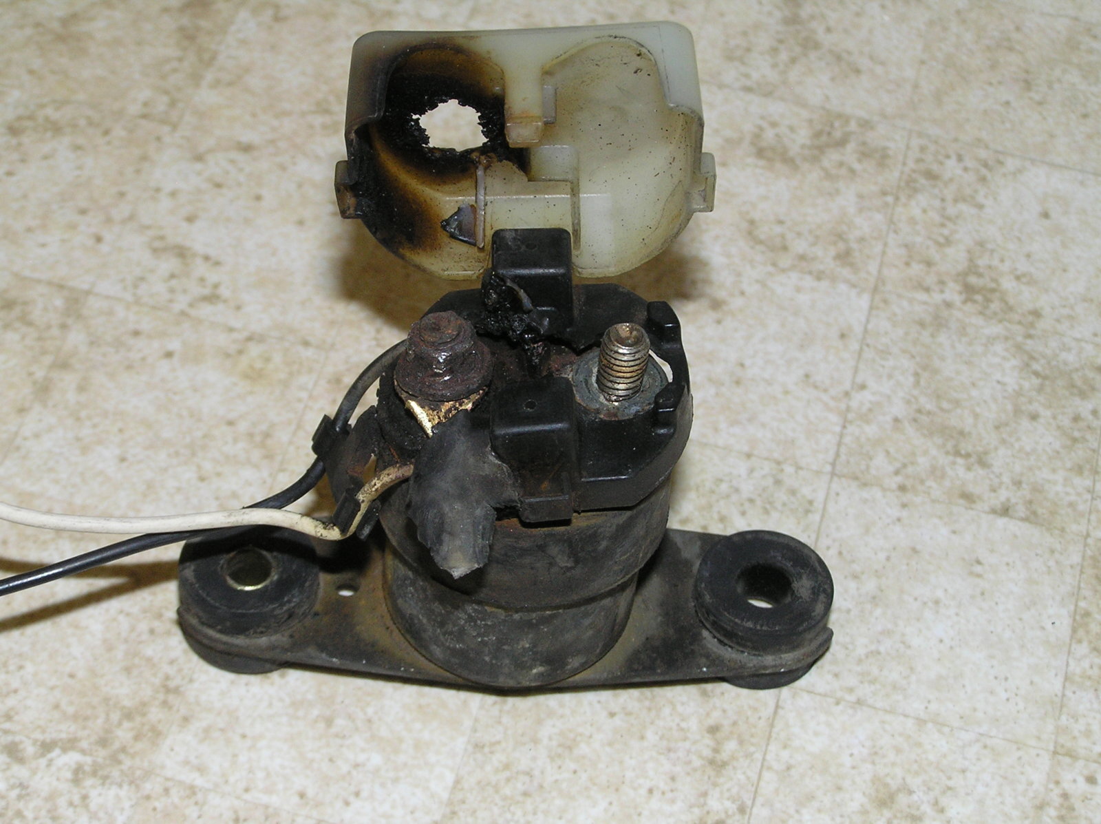

I don’t see how a dead heater relay will affect the dash warning light as it has nothing to do with it’s operation. It’s just a switch that turns power to the heating element on/off and has no control input. The warning light will work wether this relay is alive or dead. The heater circuit operates on a timer, linked to engine temperature which then activates the main heater relay. The only reason I discovered mine was dead was the fact that is was causing a battery drain fault when the vehicle was parked up, the warning light was operating normally. The heater circuit operates on all cold starts, even on warm Summer days so I wired in an overide switch to isolate the main relay and give manual control.
This was the state mine was in.......
Agree with Towpack , my light on the dash behaves normally without the relay fitted and in fact rarely comes on seeing as i'm a southern softie .
