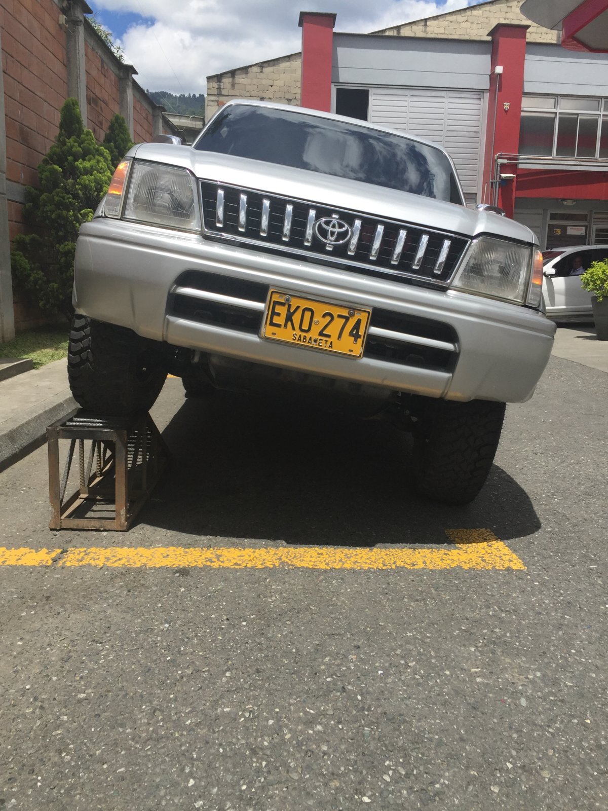

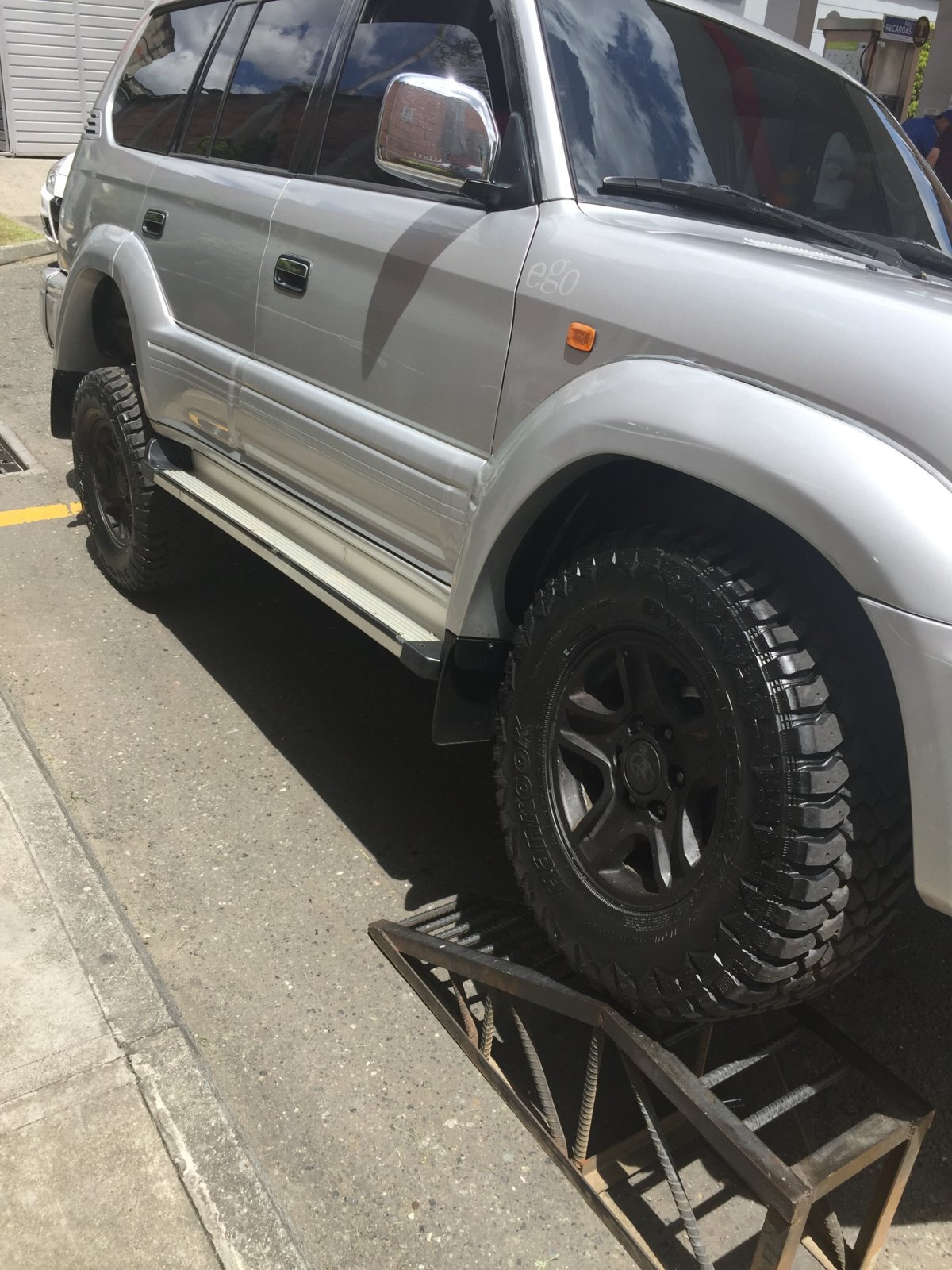

The front suspension of a 90 Prado has almost zero flex, what small changes can be done to improve this? Here are some pics

The easiest thing to do is adjust your driving style, fit front bash plates and slide the front over obstacles and use the articulation and locking diff on the rear to keep pushing you through.
Removing the sway bar is about all you can do but with a 2 inch suspension lift a 2 inch body lift and 33 inch tyres you won't much care about flex .
Or if you have the $$$ there are a couple US companies that make Long travel IFS kits for 96-02 3rd gen 4Runners that use the same suspension as these trucks! Aftermarket top and bottom control arms, coilovers ect and a limit strap and you get quite a bit of travel.
