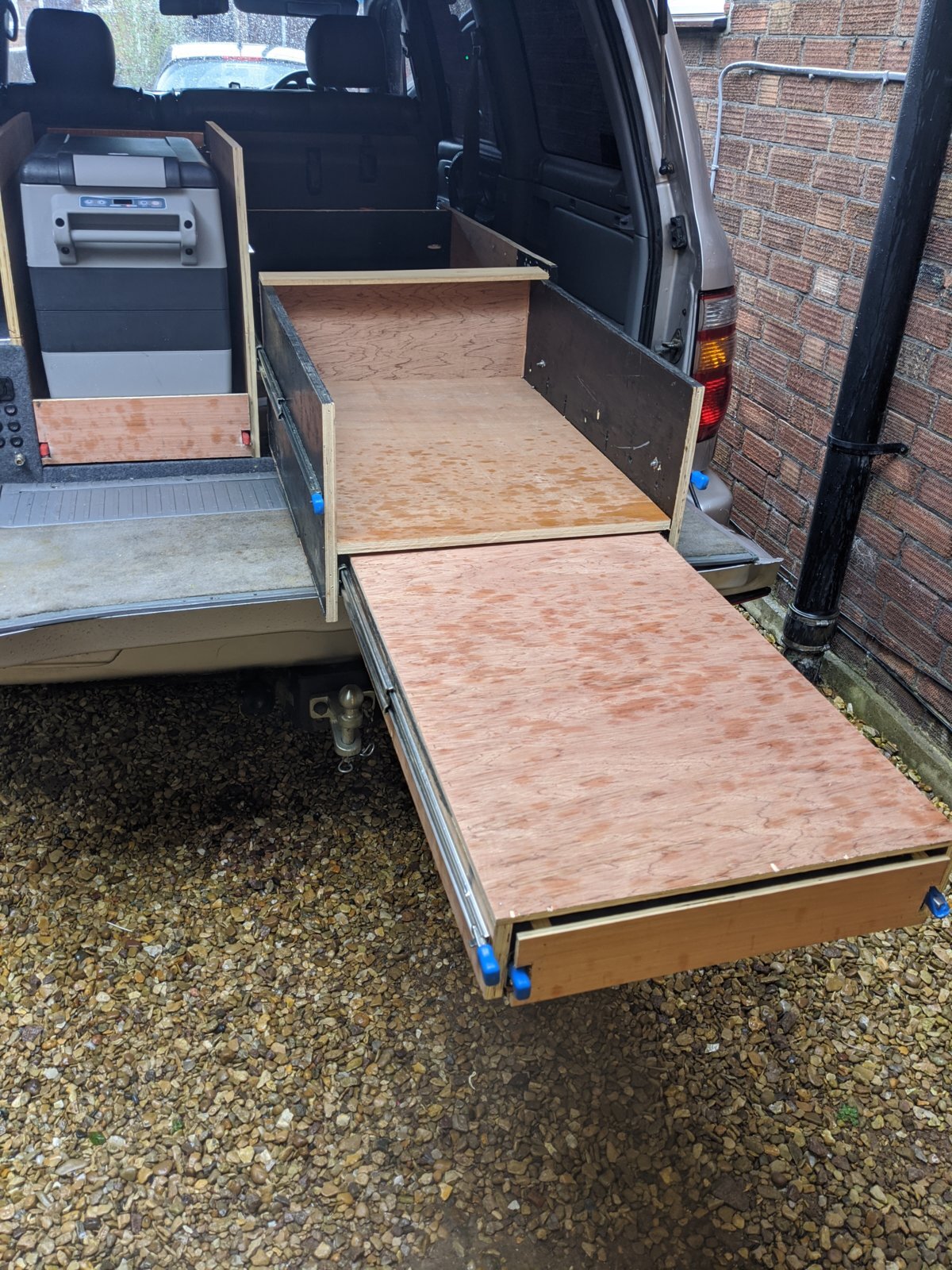

Following on from Lincomb last year and taking ideas from the various fitouts, I decided with the recent bad weather to redo Thomas's fit out to hopefully speed up setup/decamp and the lenghten self sufficiency
All the services are in and working, include 4 led service lights to help with visibility at key areas.
Now housing:
Obviously I still have to finish the wood work facia and top, may build in some box storage to, then the trimming (car carpet and some ali strips as runners).
Hopefully i'll get it all finished for Lincomb.
Now housing:

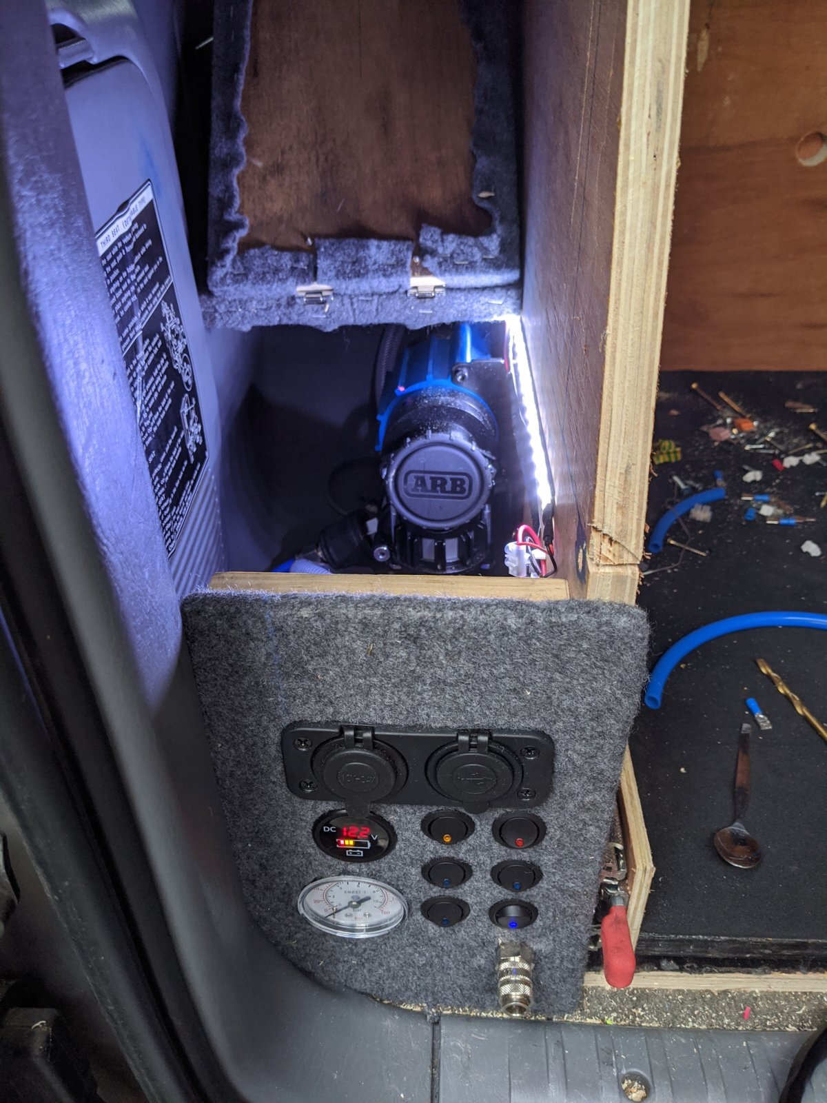

- ARB on board air compressor (rear QR conenction point + I have hardware to add one at the front), Not decided on wether to add a small receiver, seems to be ok currently without.

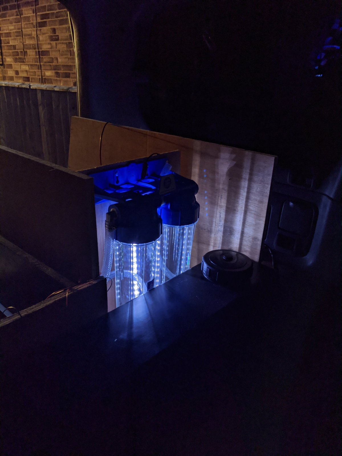

- 30L water tank, Shurflo 10LPM on demand pump with 2 stage filtration (5um Carbon block followed by 0.5um Ceramic) this will go to a QR stab in in the rear once they arrive from the states, just cant decide on what to put at the despensing end (open to ideas please, from garden hose gun to folding tap)

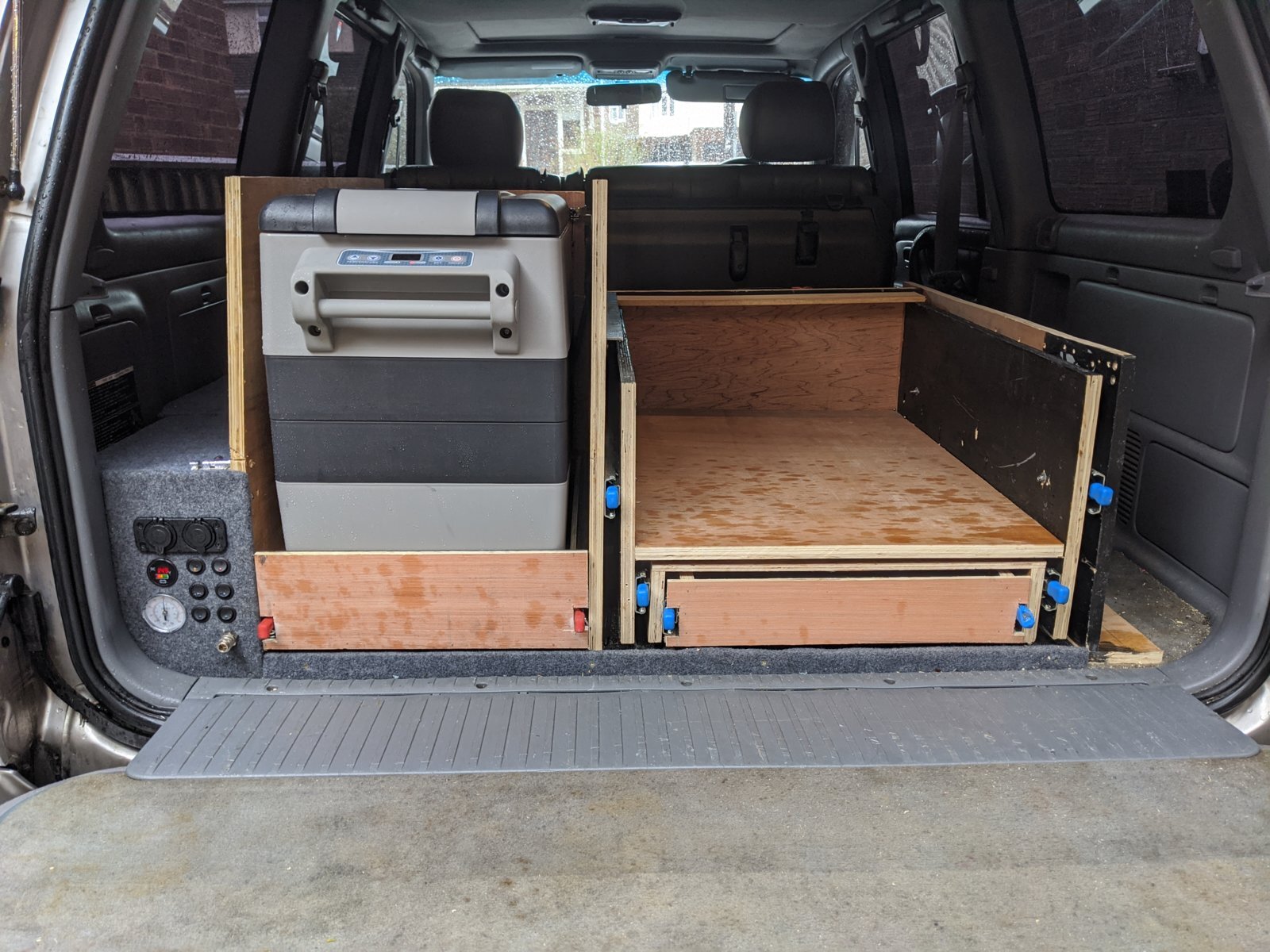

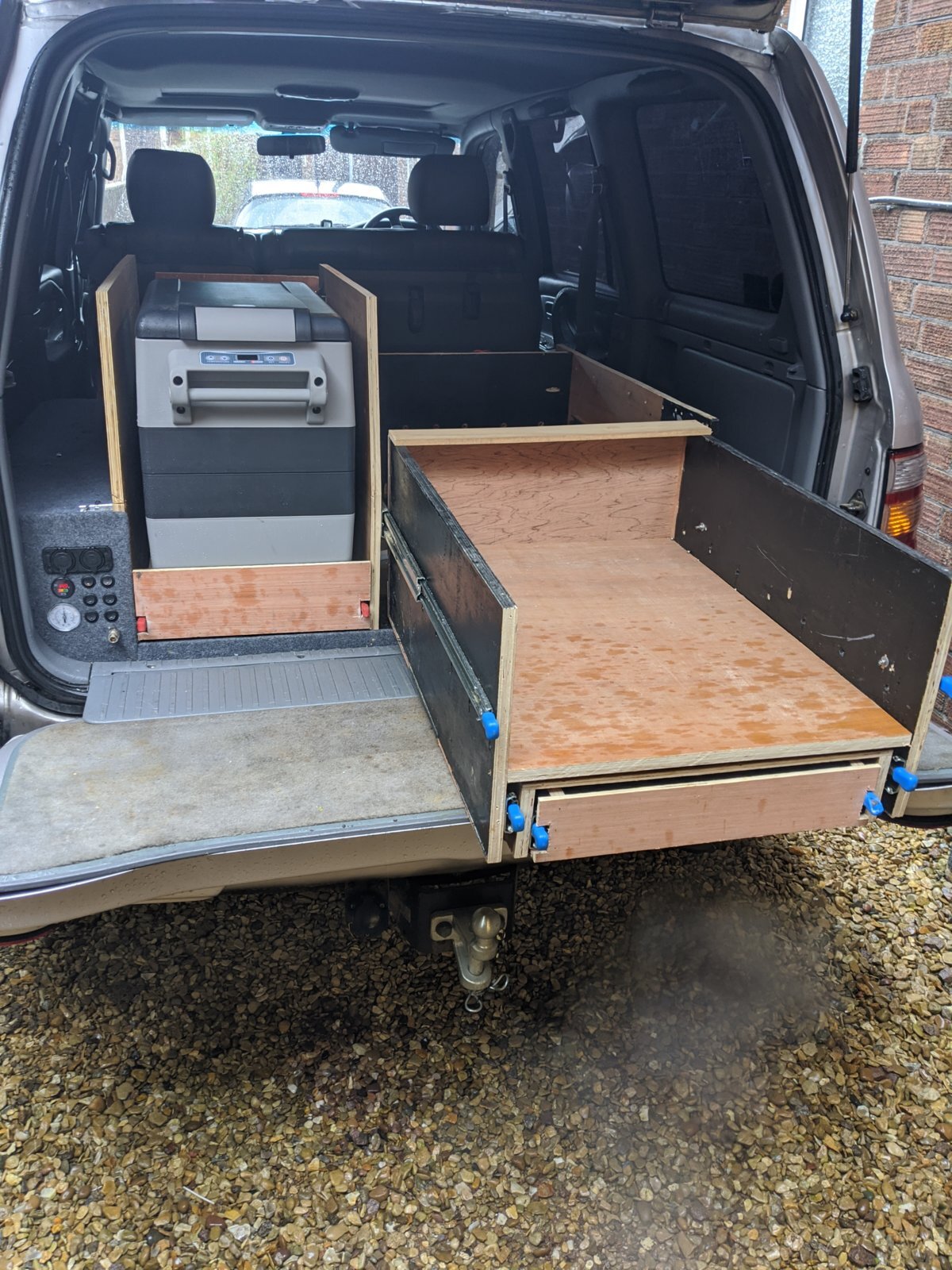

- Where as before I had to assemble a camp table for the kitchen i now have pull out drawers with work top and cooker area (might change the stove yet or have one made to fit)
- One of the big unnoticable changes is the thinning of the ply which has saved about 45kgs
