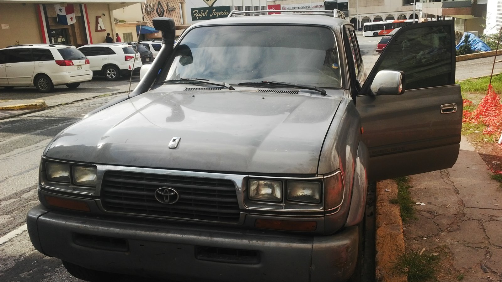

those headlights the aussies have..
Also, standard Toyota parts applied - the small rectangular lights were used in a lot of things, so nearly every small parts place has replacement sealed (or semi sealed) beam units.
For example, my preferred parts shop has in stock spare semi sealed headlights for anything that runs 7x4" units.

They may be functional for replacement when damaged (we do have a lot of gravel roads and wildlife here) but as a light they leave a lot to be desired. There is a common 'joke' that you would be upgrading if you bought a pair of candles! It isn't far from the truth, and is compounded by the fact that Mr Toyota was a little cheap with the wiring he installed, it is very light duty, and upgrading by installing more powerful globes (if you have semi-sealed housings) is fraught with danger as melted wires are a great possibility. LED upgrades are becoming common (I have them and they are great) because they don't draw much current and don't melt wiring, BUT you have to mess around when installing most LED lights (older ones especially) because of Toyota's negatively switched headlight system where the polarity is switched when you 'dip' or 'raise' your headlights, and LEDs are polarity specific. Some of the newer lights have smart electronics built in which can compensate for polarity, but the older ones don't.

Over here, the GX and the VX came with those lights (meaning all of them)...if you want to change them, be sure to order the side markers as they are different...the lights go on like this...the two outside for normal driving and all four on for high beam...also, it doesn't matter if it is a right or left hand drive...
