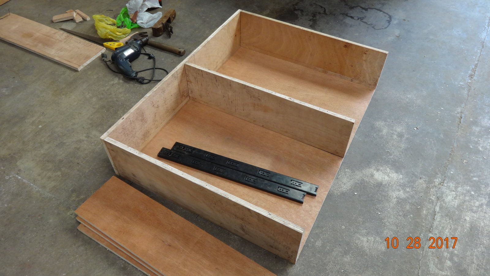

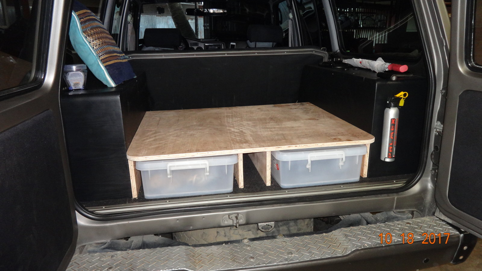

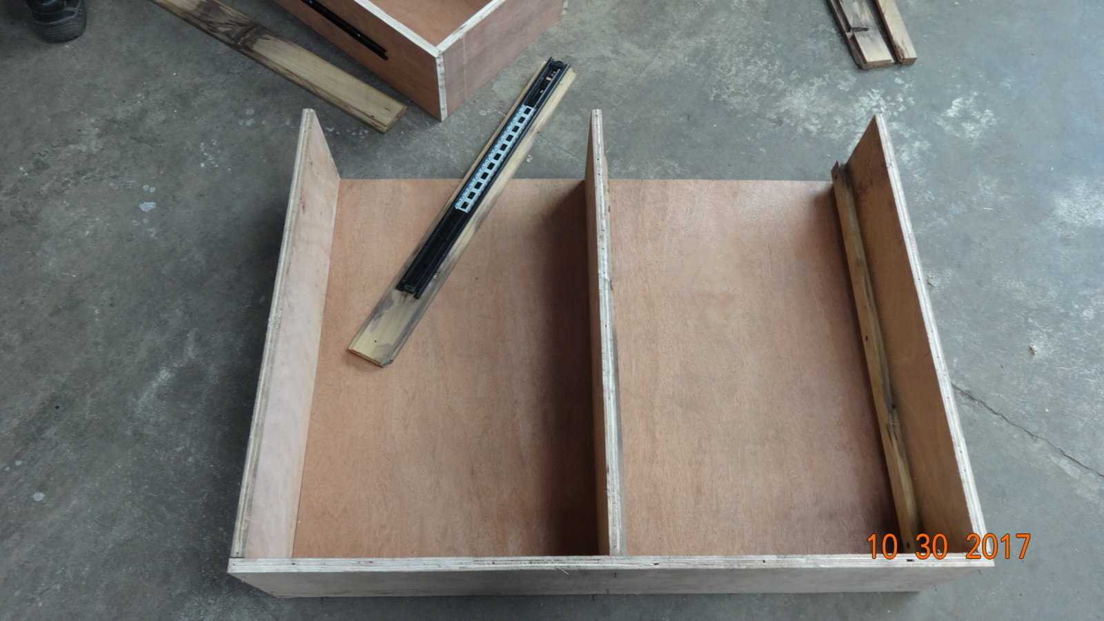

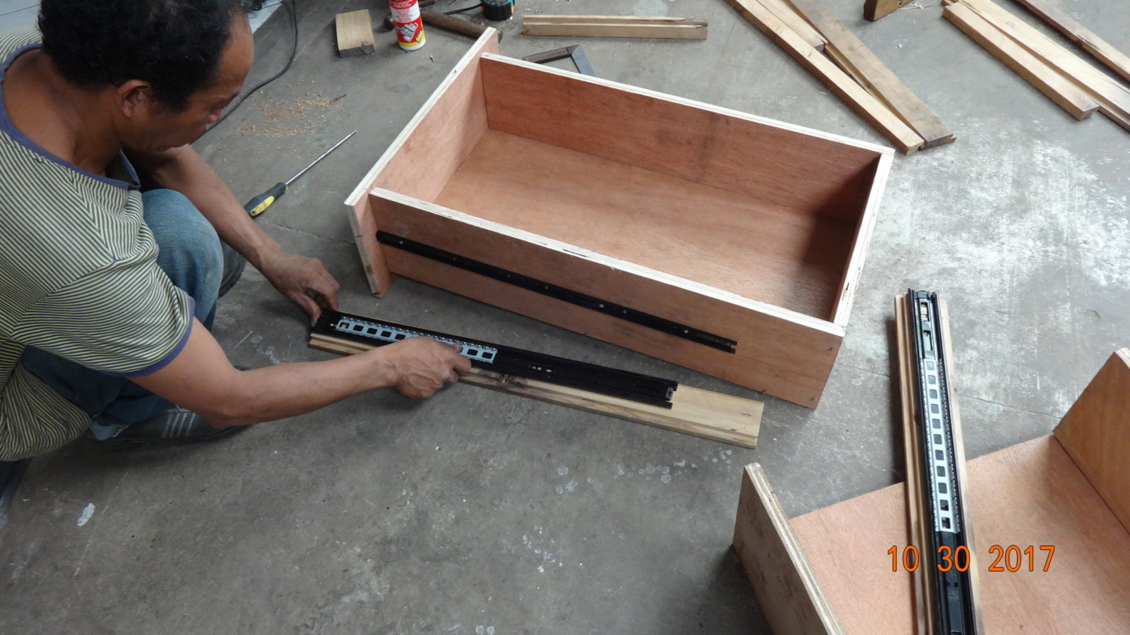

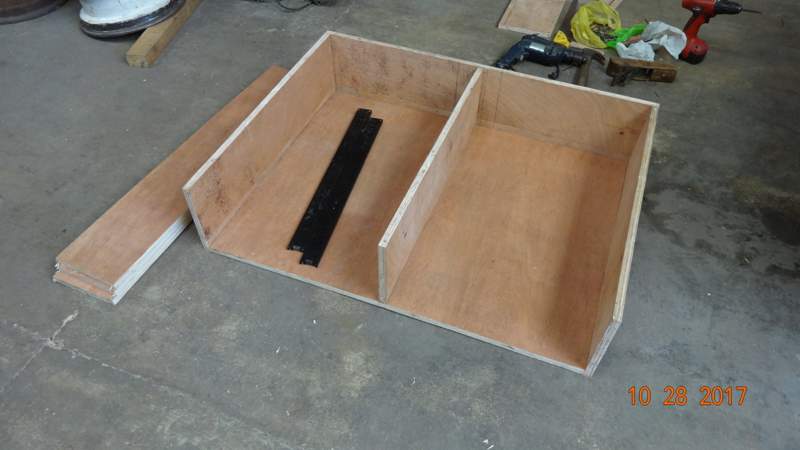

I started this drawer for the Willie. Since the longest telescopic drawer slide I can get locally is only 24" long, I had to do a little modification to pull the drawer all the way out. My drawer is 29 1/2" long. The first pic was an early design but decided to scrap the idea of a plastic pullout drawer. I used a combination of wooden slides with the roller slides.

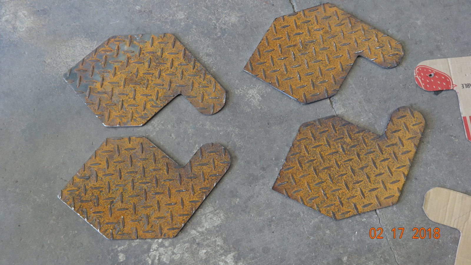

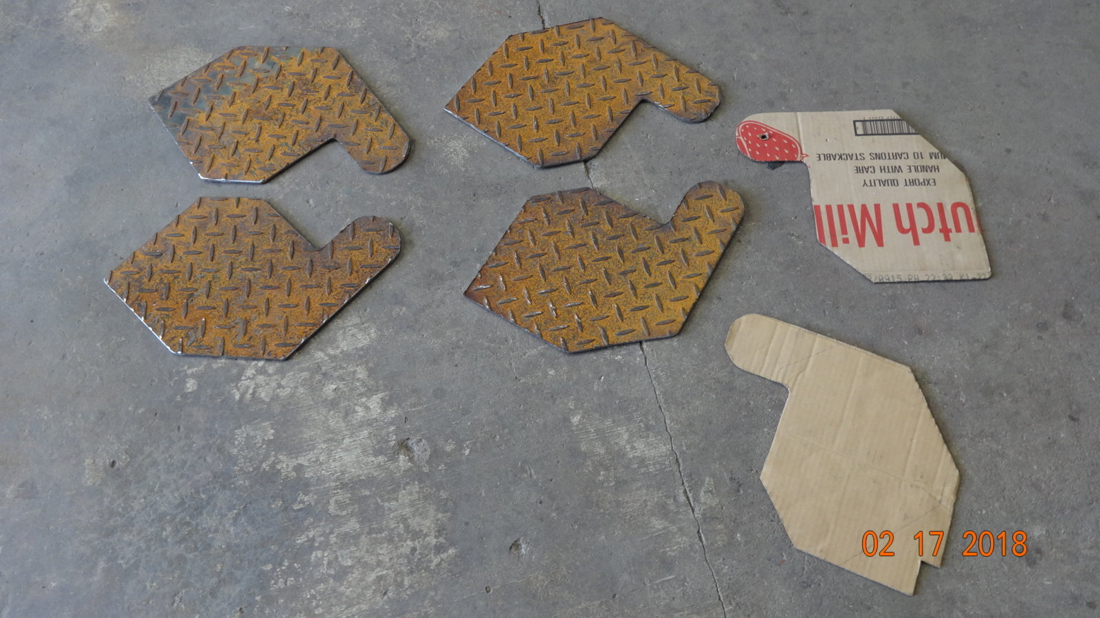

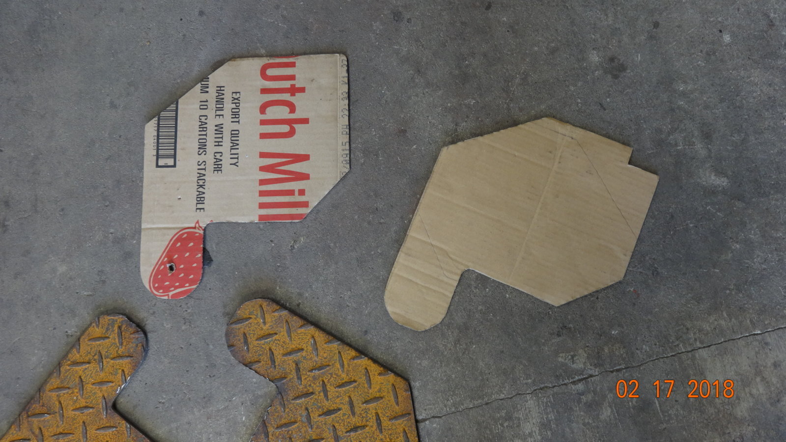

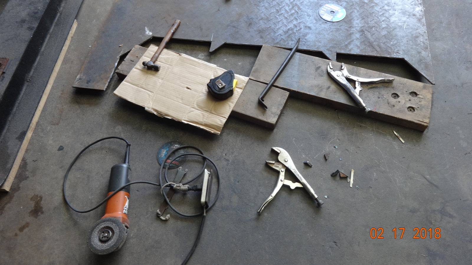

To preserve the originality of the Willie and the need to improve the rear tire carrier, I have designed an add-on carrier kit without too much altering the rear bumper.
I used a 1/4" checkered plate for the bracket.

Fitting it for adjustments.
The gap between the upper and lower plate was just to wide. There could be a problem of rigidity.
Below is a modified lower plate in which the gap has been narrowed down to 2".
